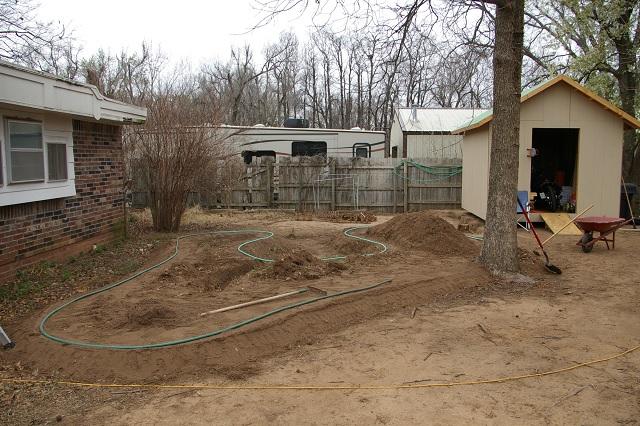

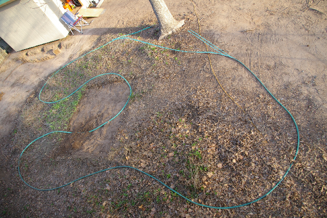

Beginning of the Nonaim Tramway, a Fn3 fictional narrow gauge line.
I used my high tech ROW tool (the garden hose) to draw out the new layout track plan of the Nomaim Tramway. Since it was a bit short for my aerial photo, I filled in the gap between the two ends in Paint.
The track footage comes out to about 100 feet of mainline.
At the trunk of the pecan tree at top dead center of the photo will be two town locations. On the left is the town of Figment. To the right side will be Imagination.
The two towns are connected by a short section of "hidden" main which will be used for those times when I just want to run trains round and round continuously. Otherwise, the two towns are not connected and the layout will be operated as a point-to-point railway where the hidden main not under a tunnel or vegetation canopy will function as short sidings.
This siding at Figment will be where the Figment Mine will be located. A second siding along the layout edge will enable switching the mine.
The counterpart siding at Imagination will be were Imagination Mill sits.  Two sidings will be located along the edge of the layout for switching and car storage.
Thus, figment ore is extracted at the Figment Mine and shipped around the layout to the mill at Imagination where it is processed into 'fiction', an essential ingredient necessary in the model railroad community.
The layout will be raised about 6 inches on the right (east) side and about 12 inches on the left (west) side. The track will be as kept as level as possible. The opening between the two loops on the left will be the mouth of a valley that will allow me to walk into the middle of the layout. Where the inner loop folds back the track will cross the valley (narrower at this end) on a trestle bridge. At this location there will be a short passing siding.
The topography within the interior of the layout will be comprised of low hills where the track will hug the hill sides similar to the High Line of the Durango and Silverton Narrow Gauge Railroad with the hillsides sloping down past the tracks to the existing original ground level.
At Figment and Imagination the plan is to use repurposed pressure treated timbers (from the small green house that I tore down... the faint square footprint of it's prior location can be seen in the center of the interior loop) cut to length and set on end to be used as retaining walls for the track and allow for me to get up close to throw the switches/points.
Overall, this is an extremely simple track plan. Point-to-point for when I want to actually perform switch ops and a loop when I want to just watch a train go in circles. Level track will make my single live steamer happy.

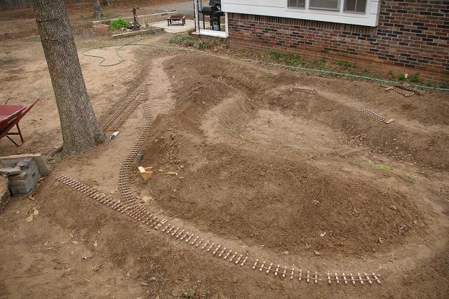

Pulled up all the track from the old layout and began moving dirt to the new location about 50' away. A full day at this task gave me the basic foundation.

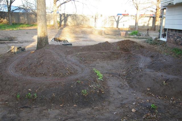

Temporarily laid out some of the old track to get an idea of how things are going to line up.
Figment side of the layout. Some scrap wood placed on the hillside to denote the Figment Mine approximate location...
Overhead view...

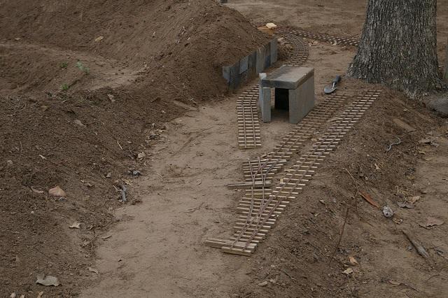

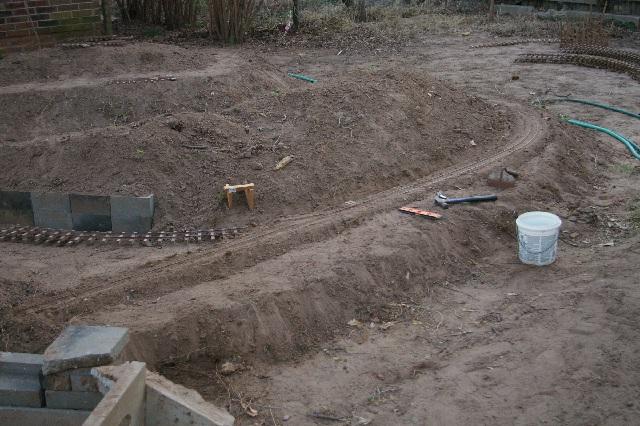

Imagination side of the layout looking towards Figment. Installed a row of concrete blocks (originally used as the walls of the tunnel on the old layout) to fashion a wall in the side of the hill for the hidden track between the two towns. I'm going to construct a wire mesh tunnel with the idea that the ground cover plants grow over it resulting in a tunnel of sorts. Just enough to hide the track and break up the two town sites.
Larger concrete blocks (originally used as the roof of the tunnel on the old layout) used to depict the mill at Imagination...

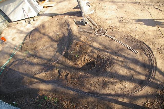

Weather here finally began warming again after being on the chilly side for the past week. So I began putting track down from the old layout this evening, starting at Figment. Worked less than an hour and managed about twelve feet including the switch that will serve the Figment Mine and doubles as the hidden track to Imagination.
Dwayne
Post by Dwayne » Fri Mar 17, 2017 2:07 am
More track laid this evening after getting home from work.

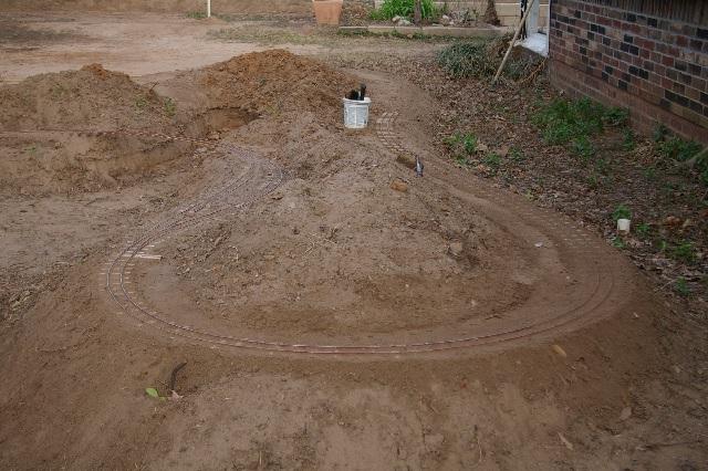

From the switch at Figment the track loops around Pecan Ridge then back up one side of the valley where it crosses the canyon (a bridge needs to be built to support the track).
On the other side of the canyon we reach the passing siding at Two Dogs which is as far as I got track laid before calling it a day.

Track up Two Dogs was quick to put down reusing the old sections. As these are used my selection that fits narrows down. The next curve will require stripping off the old ties and rebending the rail a bit then respiking to ties.

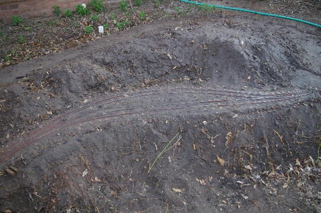

This evening I did have to assemble one 6 foot section from scratch curved to the appropriate radius starting at the west end of the passing siding at Two Dogs. So with the assembly of that section and simply dropping two more 6 foot sections into place I managed to get 18 feet down before calling it an evening.

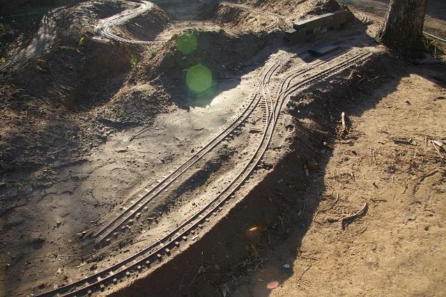

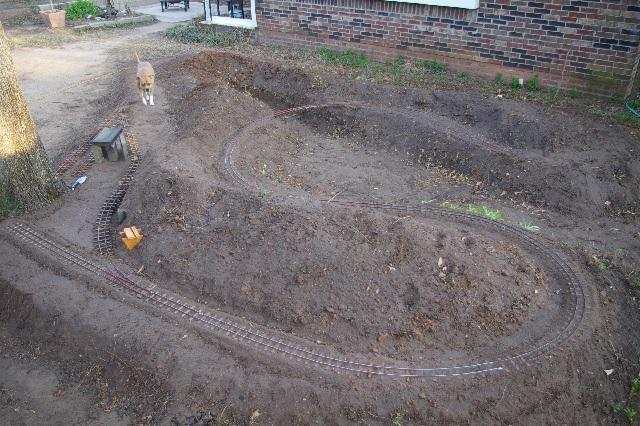

Continued laying track yesterday afternoon. Got as far as Imagination and the switch for the two sidings along the edge butting up against the pecan tree. I also bumped the layout base a bit on the curve leading into Imagination which allows for an additional siding inside of the curve. I'm thinking this would be a good place for the engine shop.
Dwayne
Post by Dwayne » Sun Mar 19, 2017 11:59 pm
Finished getting the last of the track laid this afternoon. :)
