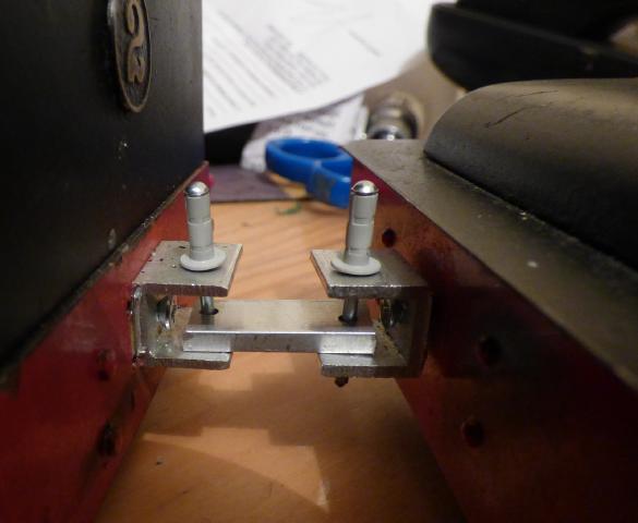

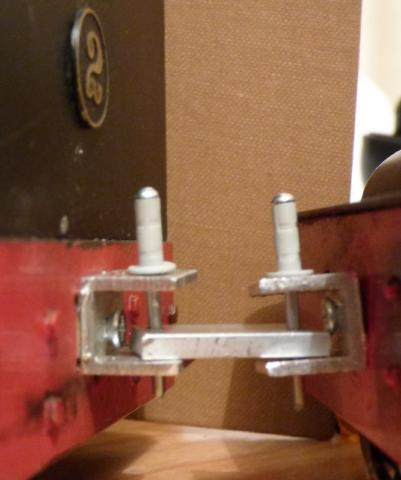

Post by sandy1000 » Fri Feb 17, 2017 10:41 am
I think that the orginal concept was from David Pinniger and if they are in wide use then this topic is a waste but if there is any interest here they are. I use this design as a permanent coupler between my 2 Motor Mules. The ones in the pictures need cleaning up and rounded of not to mention painting.

sandy1000:122881 wrote:I think that the orginal concept was from David Pinniger and if they are in wide use then this topic is a waste but if there is any interest here they are. I use this design as a permanent coupler between my 2 Motor Mules. The ones in the pictures need cleaning up and rounded of not to mention painting.
For a permanent coupling this might be fine, but when uncoupled the floating end of the plate will drop slightly unless all of the drillings are very precise and not at all oversized. When this happens lifting the plate to slide cleanly into the other uncoupled half to locate the locking pin will be little better than using a three link chain or two hooks and a drop bar.
