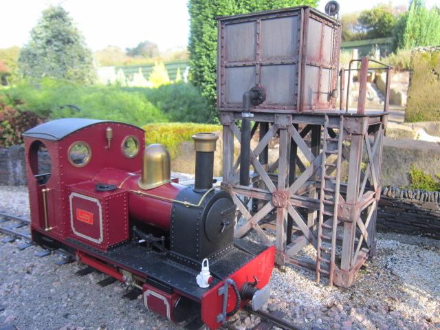

I used that GRS chassis for my scratchbuilt body MW. The motor is fine on battery and I used Deltang R/C ( before Rik got his RC Trains website operational). Given a free choice I think I'd have gone for a bigger reduction gearbox, but tbh its not worth the hassle of changing it.
My build is detailed in the thread at http://gardenrails.myfreeforum.org/abou ... s&start=30
