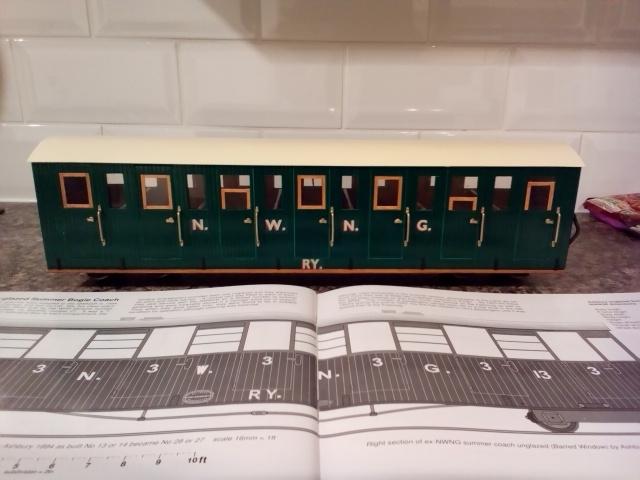

Hi all.
Been applying transfers to my NWNG Mystery coach this afternoon. From the very few photos available to scrutinise there is no trace of any lettering remaining on the coach sides. Opinion suggests that it was built in the late 1890s by Ashbury and adopted the number 3 to replace the 3 four wheelers that were scrapped around this time and that it was classed as a workman's carriage and not intended for general passenger traffic.
I have therefore applied the lettering N W N G RY as per other Ashburys of that date BUT if it was just a workman's carriage would each door have been assigned a number 3 or left blank?

Bit late to the party; but this might help - the NWNG did quite a trade in Workmens tickets, and it would appear from looking at their timetable that there were suitable paths in their diagramming that would cater for weekly and daily workmen. Given the nature of the quarries, I'm sure that there was a bias towards daily travel, so workmens coach goes out on the first train and returns on nearly the last.
I don't think that there would be any need for class transfers.

Thanks for that De Carabas . That's basically how my thoughts were going.
As for the transfers Piotr, they are the newly advertised ones by IP Engineering. They are water transfers not rub down ones so I would not use them outside without a coat of laquer to waterproof them. These have not yet been done as I was wondering about the 'class' situation. I tend to cover the whole coach side where possible to give an extra protection and gloss to the paintwork.
Be careful with these transfers however. 'Googling' suggests using tepid water BUT I found that the transfers became too soft very quickly and were impossible to apply before breaking up. I quickly changed go cool water and got on much better though it does mean I have to order some more to finish the three coaches I was doing.
David.

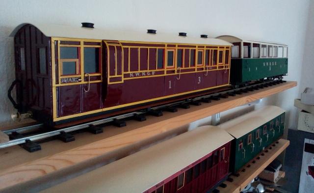

This is an example of the transfers applied to my home built NWNG Picketing brake and IP engineering Gladstone coach. (The Pickering is missing a '3' as this was one of the transfers that disintegrated in tepid water.)
David.

The third is the NWNG/WHR Pickering brake. This I made using a three layer sandwich method with the middle layer having larger window cutouts to accommodate and hold the window glazing. It is now deep maroon in colour with gold beading still.
The forth coach in this view, the first I made, is a NWNG. IP Engineering Gladstone coach kit.

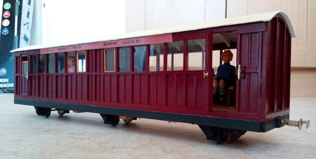

My fifth and latest coach is certainly my most ambitious. It is my version of the early NWNG all third Cleminson 6 wheel vehicle. I have attempted to replicate the crudely built original with a 3mm hardwood frame infilled with 1mm ply in a groove on the inside edge, leaving a boxey look to the outside as on the original. This has been my most challenging work to date as I had to devise a method of putting a rebate along 3mm strip wood to take the panelling below and individual glazing panes above the waist level. Other challenges I set myself were to make the articulating 6 wheel underframe, opening doors and opening droplights. I feel happy with the finished job but if I had the time again there are some things I would do differently.
David.

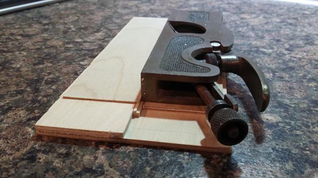

For making rebates in this stripwood for glazing and panelling etc. I made myself a simple jig from workshop scrap as the following drawing tries to show.
I then slid a strip of 3mmx3mm wood (yellow) into the slot and carefully planed with a shoulder plane lying on its side until just touching the top guide on the jig. This cut a rebate 1mm deep and 1mm wide.
What doesn't show, is that there is a thin ply stop glued at the far end of the jig to stop the strip sliding right through it.
Take care when planning not to cut sideways into the top guide as this will take out more than 1mm of wood over time. My guide has been replaced once already and I need to replace it again as it has worn away too much again.
One problem I did find was that the 3mm strip could be a little over size in some cases and not fit into its intended slot on the jig. I was lucky in that I had way too much of the strip wood anyway so could pick and choose which bits I used but it is worth bearing in mind to buy more than you need. I also found that although I was cutting the strip into 100mm lengths before rebating, the thickness along the strip may vary, so I could use some bits from the original length if maybe not all.
If you need a strip for glazing on both sides, make one rebate then turn the strip around to rebate on the other edge to end up with a 'T' section.

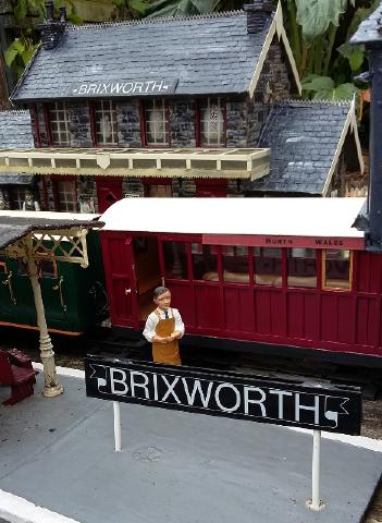

Sorry to disappoint Piotr but the station buildings are not mine I am afraid. Being a member of the Association of 16mm NGM, here in England I have the very enjoyable pleasure of visiting and running on other members lines in the South Leicester area. That particular station is on the Brixworth and Lamport garden railway.
David.
