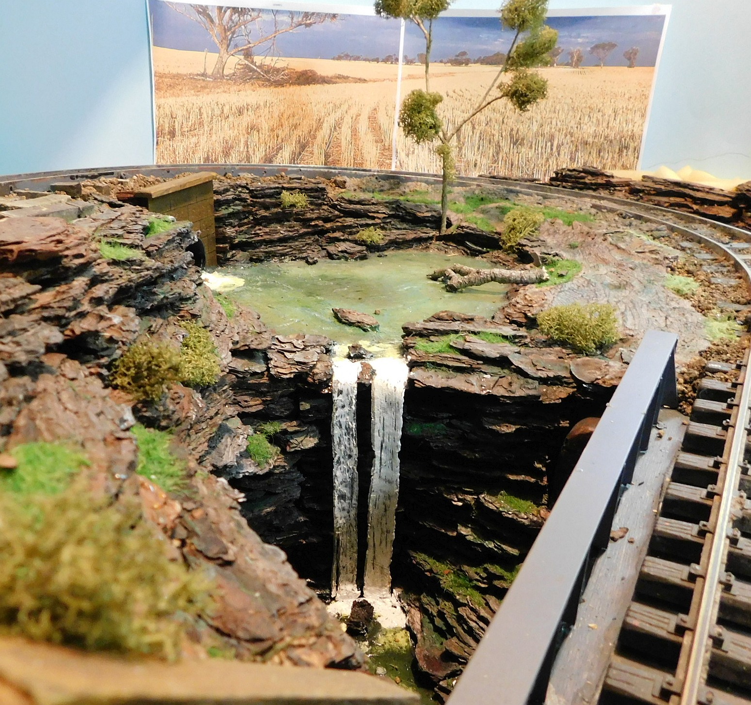

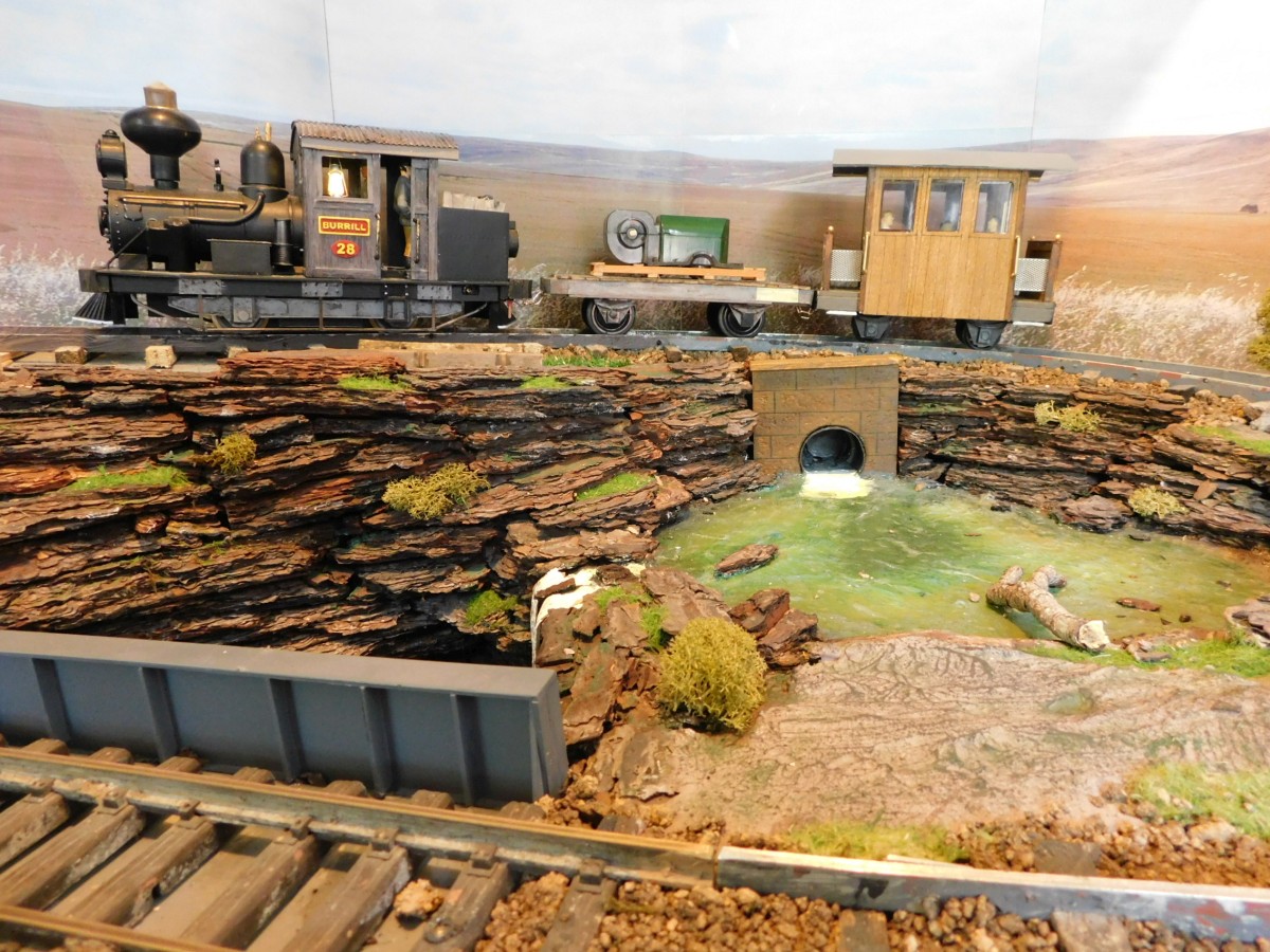

Scenery progresses slowly on the line, with a 'lake' and waterfall and river gorge complete. Some track ballasting done too.
Here's a video of a 'pretend' operating session showing just the scenicked bit.
https://youtu.be/b3jd8w6tz28
and the gorge
(not happy with the waterfall yet)
and lake
I still haven’t progressed on any backscene painting, but have ‘finished’ the pine bark rocky gorge, lake and waterfall. The lake is more of a pond – only 12” across and the river more a creek as it is only 3” (ie 6’) wide.
The waterfall is PVA glue poured onto clingwrap plastic, painted with thick acrylic white. The lake and river are made using marklinofsweden’s web tutorials with toilet paper and white glue over a timber base – thus giving ‘ripples’ in the water, then painted with acrylics and a couple of coats of clear polyeurethane (which I use on my house slate flooring)
Marklinofsweden has a great website and youtube tutorials...
https://www.youtube.com/@marklinofsweden/featured
https://www.youtube.com/watch?v=8b7H3xuEhW8
I need some more trees and scrub along the lake edge. And maybe a fisherman and his campfire. (or a Jolly swagman camped by the billabong?)
Re: A tiny G gauge indoor layout
Posted: Sun Mar 12, 2023 6:18 am
gregh wrote: Sun Mar 12, 2023 3:28 am
The outfall from the culvert and the final section of rapids both look brilliant, but the two main waterfall drops don't yet 'work' to my eyes, they look too 'solid' and white. IMO you need to inject some transparency... maybe go back to using the good old 'crinkled cellophane' type base with white flecks added to taste?
Having said that, the overall effect is fabulous.
Posted: Sun Mar 12, 2023 5:33 pm
gregh wrote: Sun Mar 12, 2023 3:28 am I need some more trees and scrub along the lake edge. And maybe a fisherman and his campfire. (or a Jolly swagman camped by the billabong?)
It is looking really effective. I love the way the stream cascades over the rocks.
Didn't you once have an animated swagman poking the fire?
Posted: Sun Mar 12, 2023 9:39 pm
by gregh
philipy wrote: Sun Mar 12, 2023 6:18 am
........ but the two main waterfall drops don't yet 'work' to my eyes, they look too 'solid' and white. IMO you need to inject some transparency... maybe go back to using the good old 'crinkled cellophane' type base with white flecks added to taste?
Thanks Philip. I did make some 'test' pieces using the PVA system but discarded them - now I think they look better than what I finally used.
Cellophane is an idea. And I just noticed the opaque corn flakes 'bag' might be good too.
First problem is how to remove the existing waterfalls.
ge_rik wrote: Sun Mar 12, 2023 5:33 pm Didn't you once have an animated swagman poking the fire?
Yes I do still have it but it makes me realise how things that are small in the garden take a huge space indoors! It is only about 6"x9" but I don't have that space on the indoor line! Here's the link to it...
http://youtu.be/jw1xwUXWhuI

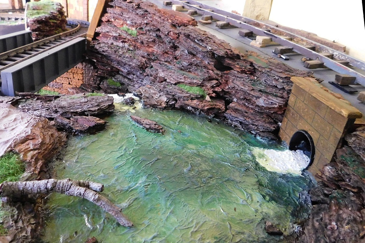

Posted: Mon Apr 03, 2023 10:23 am
by gregh
I think I have improved the waterfalls by just putting a few vertical scratches in the white.
Compare to pic a few posts back up the page.

The pic also shows my first rough attempt at printing a backscene from a photo. They are A4 landscape size and will be two sheets high when I decide whether I am happy. I need to blend the foreground better. Suggestions?

Posted: Mon Apr 03, 2023 11:48 am
gregh wrote: Mon Apr 03, 2023 10:23 am I think I have improved the waterfalls by just putting a few vertical scratches in the white.
.... I need to blend the foreground better. Suggestions?
Yep, the waterfall looks a lot better, well done.
To blend the foreground/background, I'd suggest a (very?) thin hedge attached to the base of the backscene but coloured to match the 'real' scenery. Failing that, you might get away with a fence? I'm not sure what the local field fences would be like in your neck of the woods, but something like a post and rail job with grass around the posts, might enough to take the eye away from the joint?

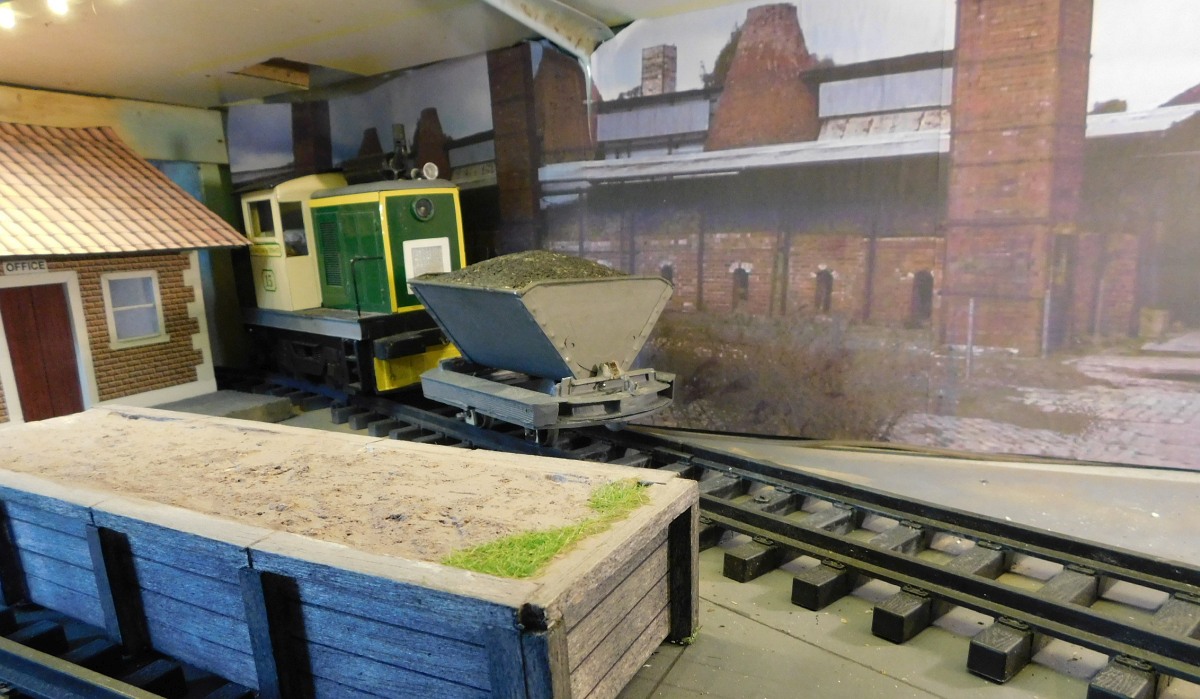

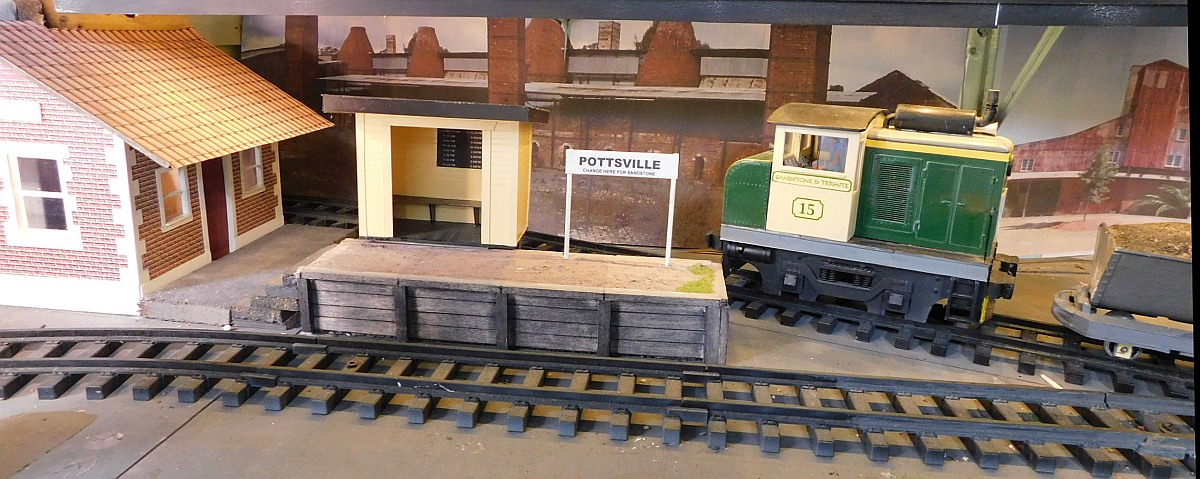

Fences should be just a few strands of barbed wire, but maybe a post and rail would be the ticket in front of a wheatfield. I'll try raising the scene up a bit and then add some bushes (not hedges !)

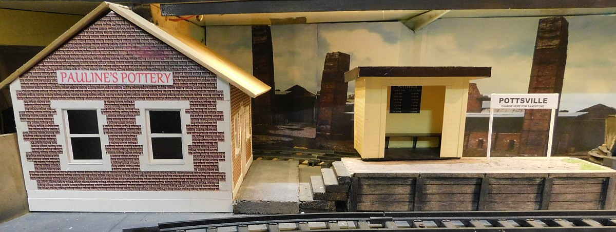

Meanwhile, after much experimentation I have got a backscene for the pottery works at Pottsville. And I have made an office building and a new station waiting shed.
The pottery scene is a picture, much repeated, and stretched - four A4 sheets in portrait as only 220mm high under the shelf.
pottsville backscene finish (2).JPG (219.71 KiB) Viewed 38725 times
I will build a 'real' chimney where that shelf support is behind the loco, to hide it.
This scene has the station building removed to give a better view of the scene.
pottsville backscene finish (4).JPG (221.29 KiB) Viewed 38725 times
This is the Pauline Pottery Office building. MDF covered with printed brickpaper (the internet is amazing for resources!), and lots of styrene. Note the backscene here was my first attempt and too small)

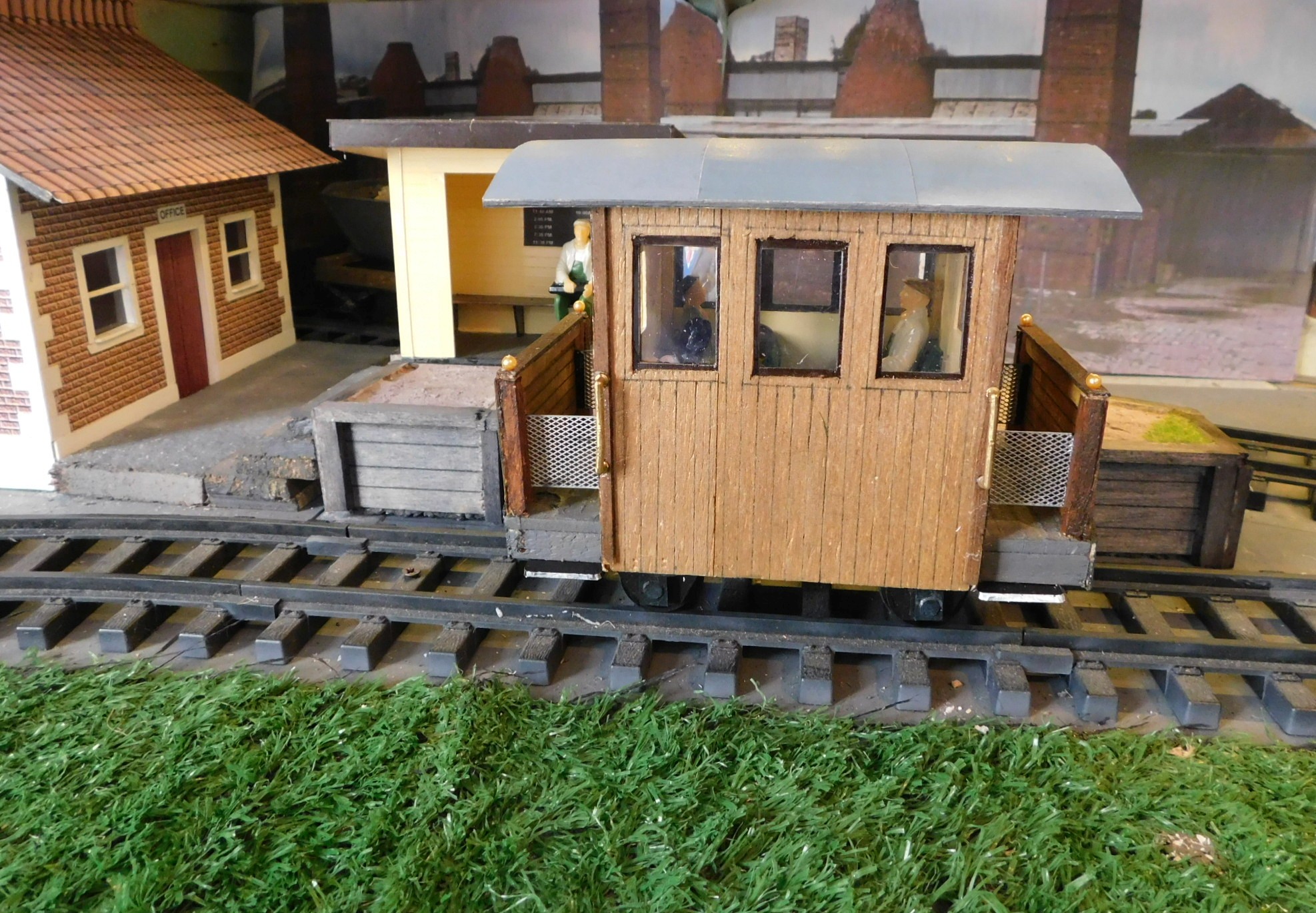

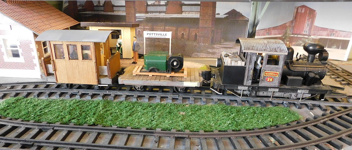

I saw a picture of a tiny passenger carriage, which immediately said “I need one” for my indoor line. It was in this Topic Yr Hen Felin & Yr Orsaf Newydd by gilfachphil.
https://gardenrails.org/viewtopic.php?f ... &start=120
so thanks to you and Plateway Models for the inspiration!

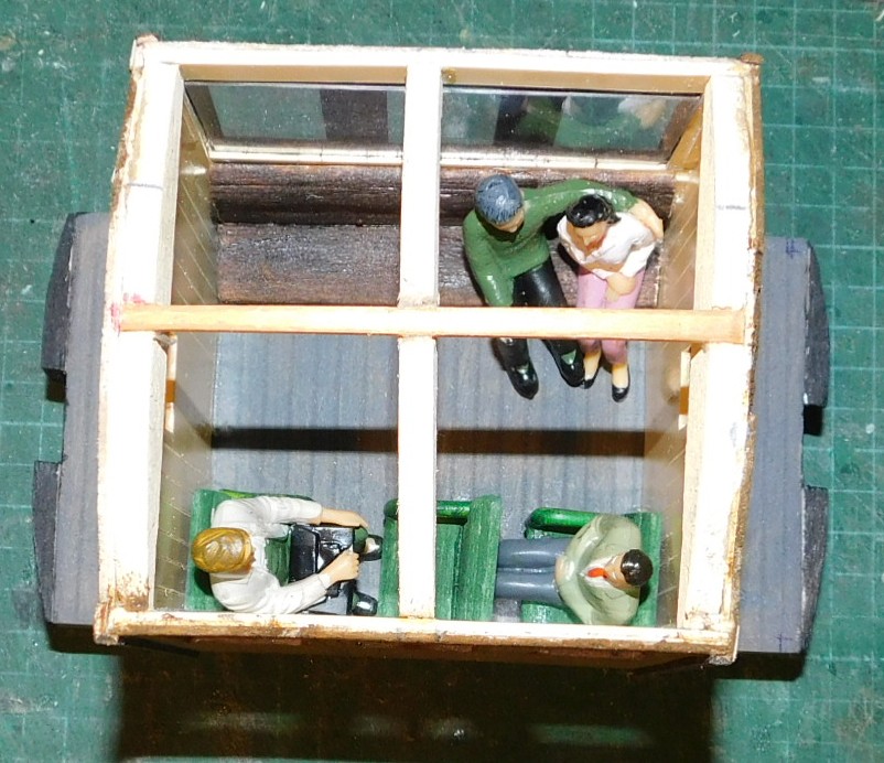

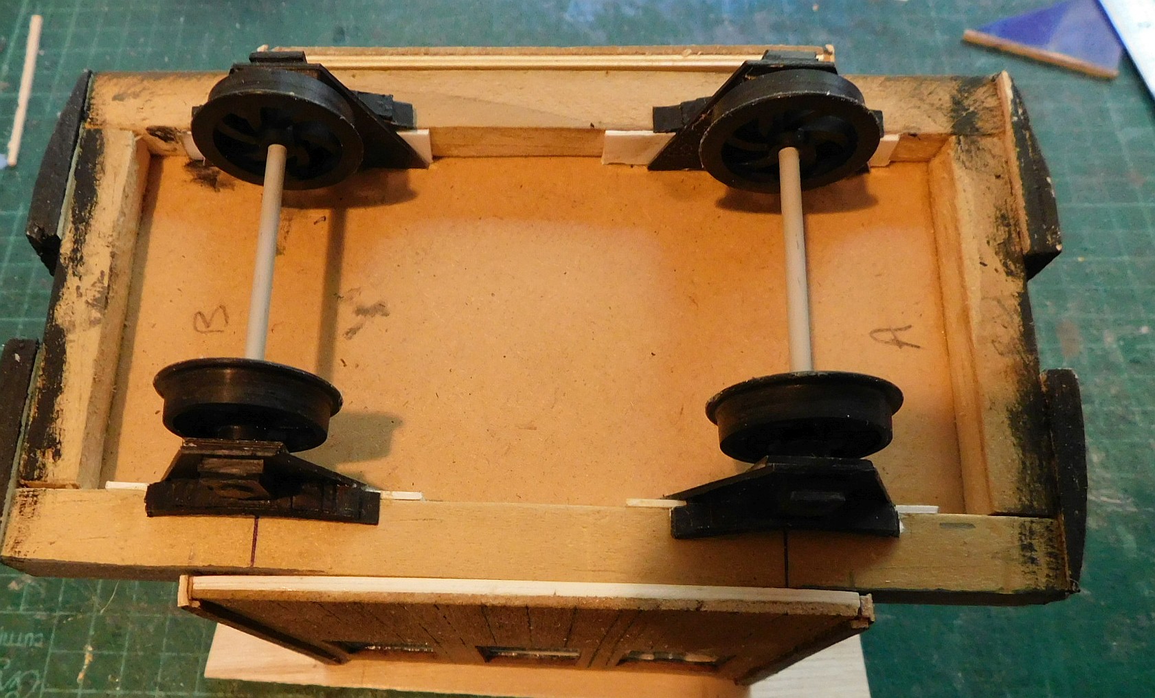

It’s been a while since I scratchbuilt anything and I seem to have ‘lost my touch’, but finally I have completed it. (Not to my complete satisfaction, but good enough.)
I built my standard frame from 8mm thick pine and 3mm MDF floor. I decided to build the passenger compartment separately to ‘slip on’ to the base.
I made the carriage from a laminate of styrene sheet and balsa on the outside – a big mistake as the contact adhesive I used caused the ends and sides to warp. So lots of bracing was used!
There is 1st and 2nd class seating
tiny carriage (1).JPG (159.86 KiB) Viewed 38751 times
tiny carriage (3).JPG (380.02 KiB) Viewed 38751 times
tiny carriage (4).JPG (399.48 KiB) Viewed 38751 times
So it’s finally complete and had its first revenue run from Pottsville to Claymine.
tiny carriage (7).JPG (663.01 KiB) Viewed 38751 times
tiny carriage (8).JPG (246.46 KiB) Viewed 38751 times
tiny carriage (9) sml.jpg (320.12 KiB) Viewed 38751 times
And the video. https://www.youtube.com/watch?v=h1CIK_pZYvc
Notice the new backscenes too – more on that soon.
