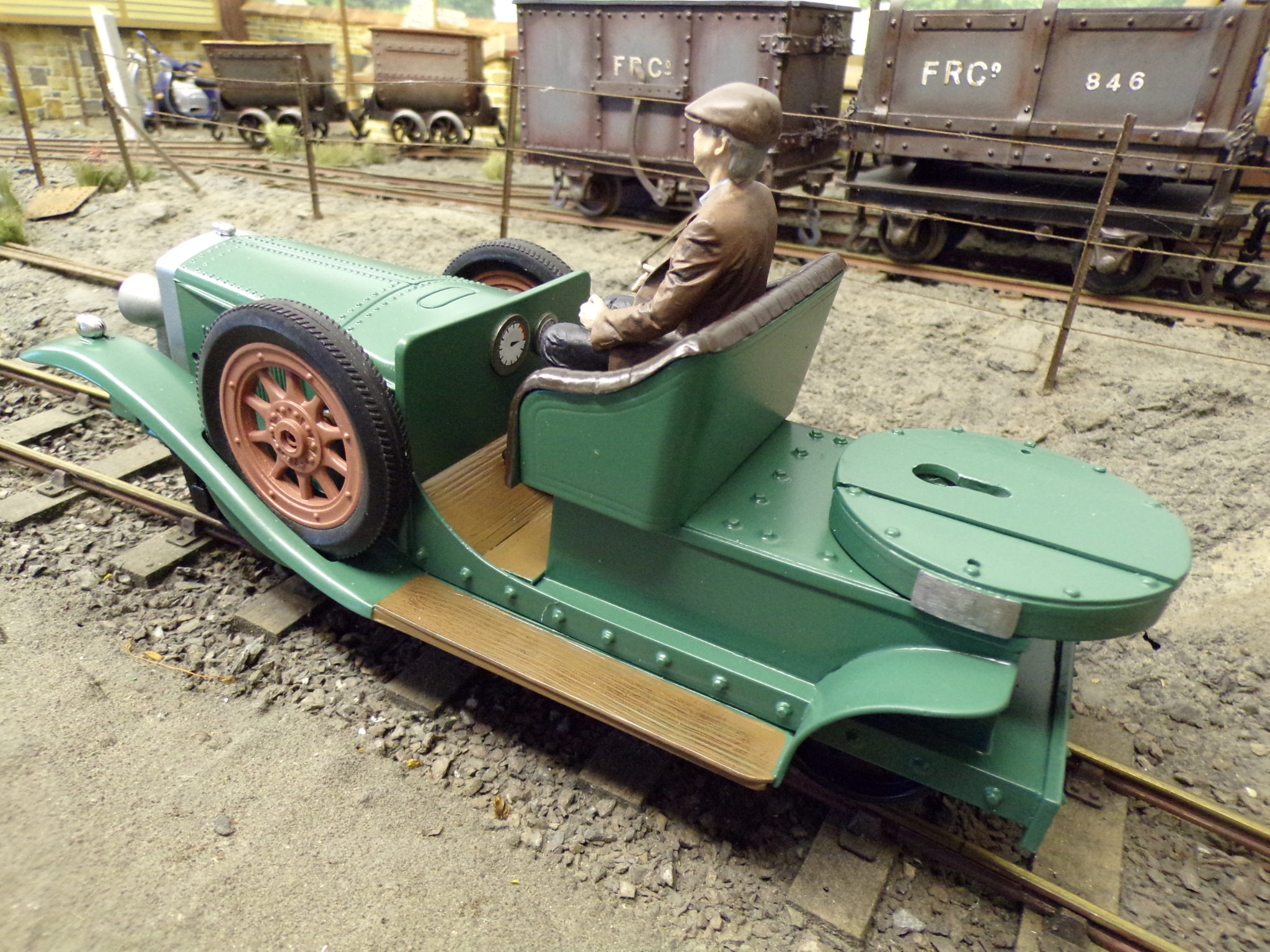

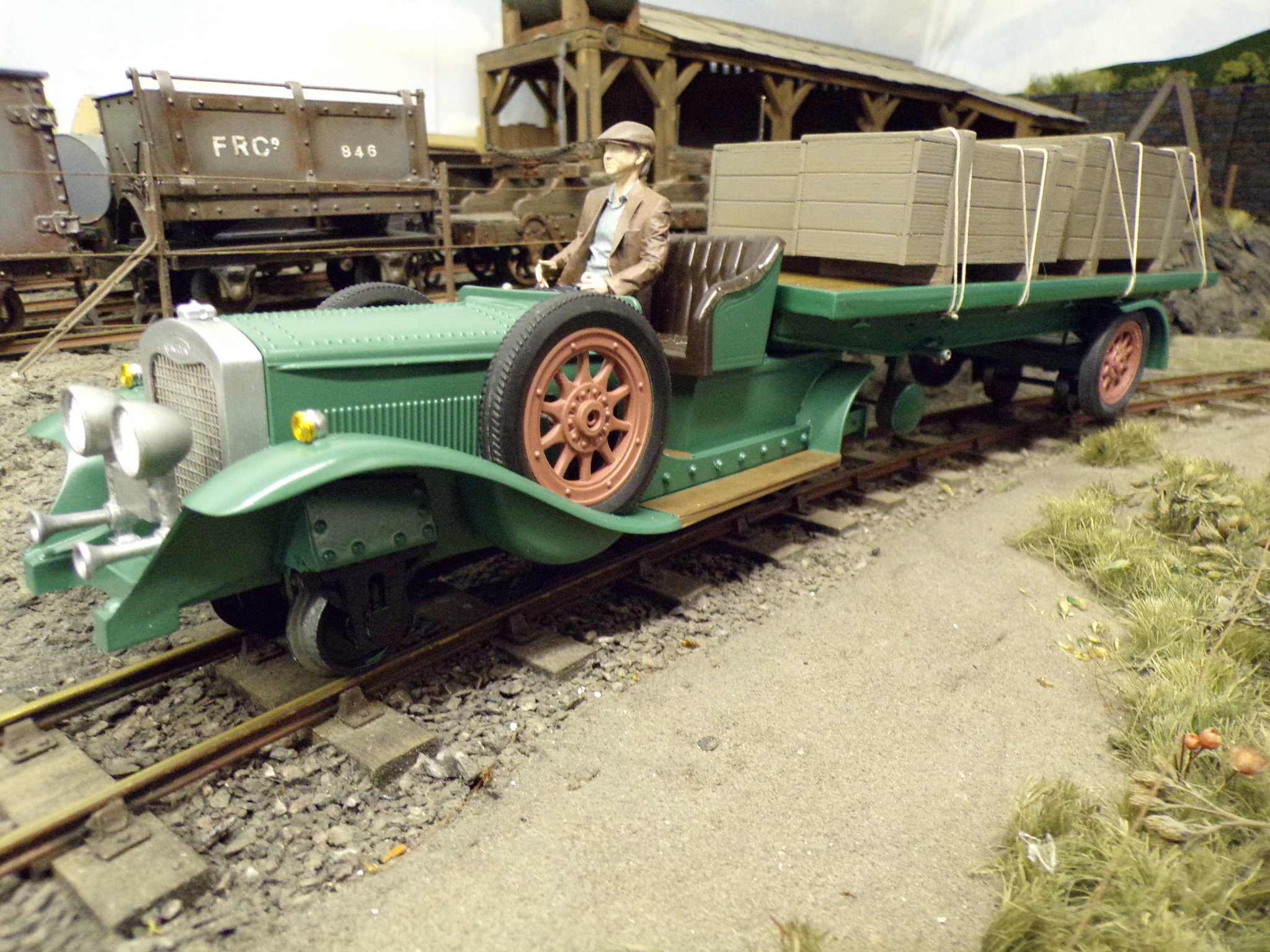

The image shown at the top of page 183 shows a vintage road vehicle design for an articulated tractor unit (car) and trailer. This gave me the idea of transferring the trailer from road to rail use with one of the converted radio cars as its power source. Work on this project has been shown on previous pages and has now reached cosmetic conclusion...
The trailer is detachable by a keyhole 'fifth wheel' device allowing the power unit to travel light or haul another load if ever I get around to building one..

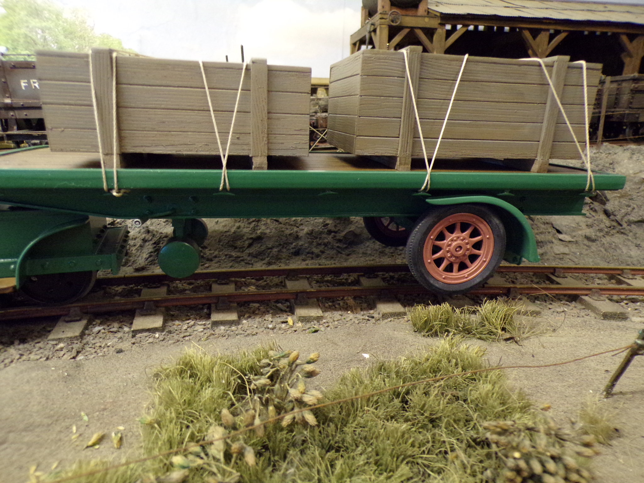

The trailer's road wheels are raised for rail travel with hidden flanged wheels set between them. There is also a jockey wheel set so that the trailer can be lifted from the tow vehicle awaiting collection by a road unit.
No... they don't work!
Just to fill the space I have fitted two additional artillery wheels to the 'car' in case of puncture on the trailer.... why not?

A unique model, Peter. Beautifully crafted!

That looks great . I like how you have modelled the 5th wheel hitch, and the colour really suits it.

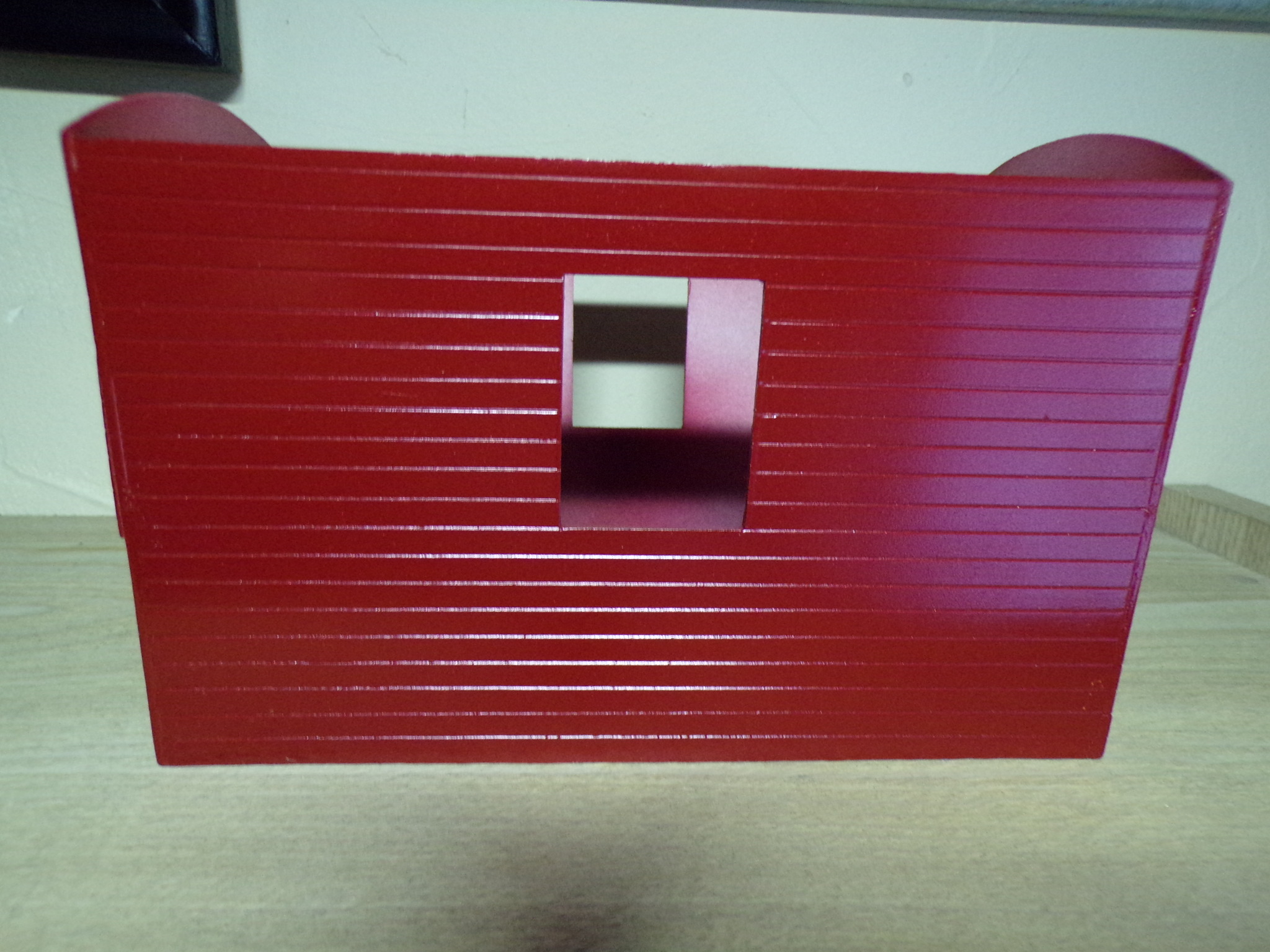

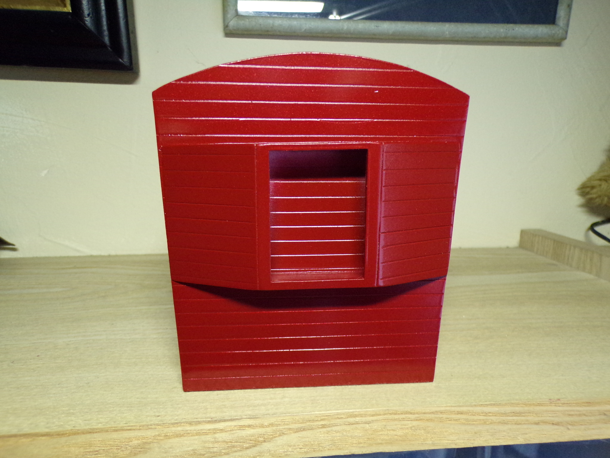

Another new scratch-build has hit the workbench. I found a vacant space in my storage shelves, so why not?
This is a subject I have been interested in for so many years but never thought how to represent it on my railway. Now I feel I have a cunning plan to do so.
Firstly, the main structure, very simple and basic....

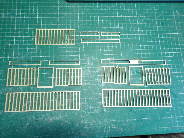

It will incorporate some of these, which my son made for me with his laser cutter.

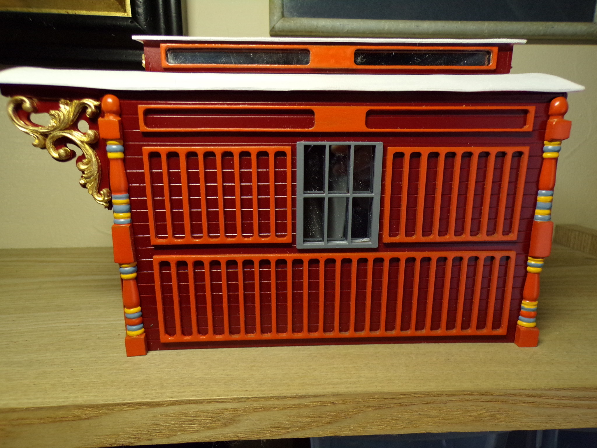

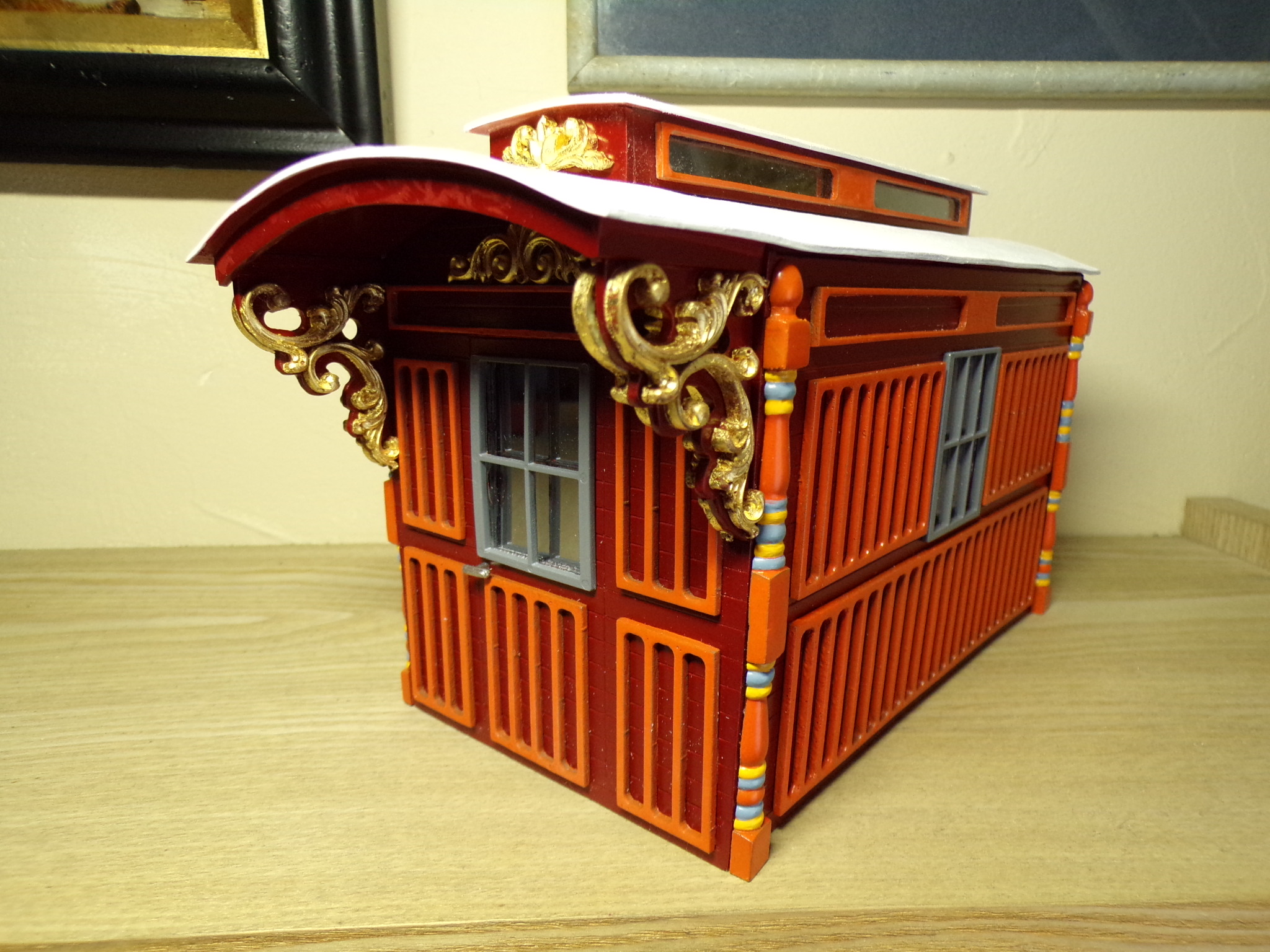

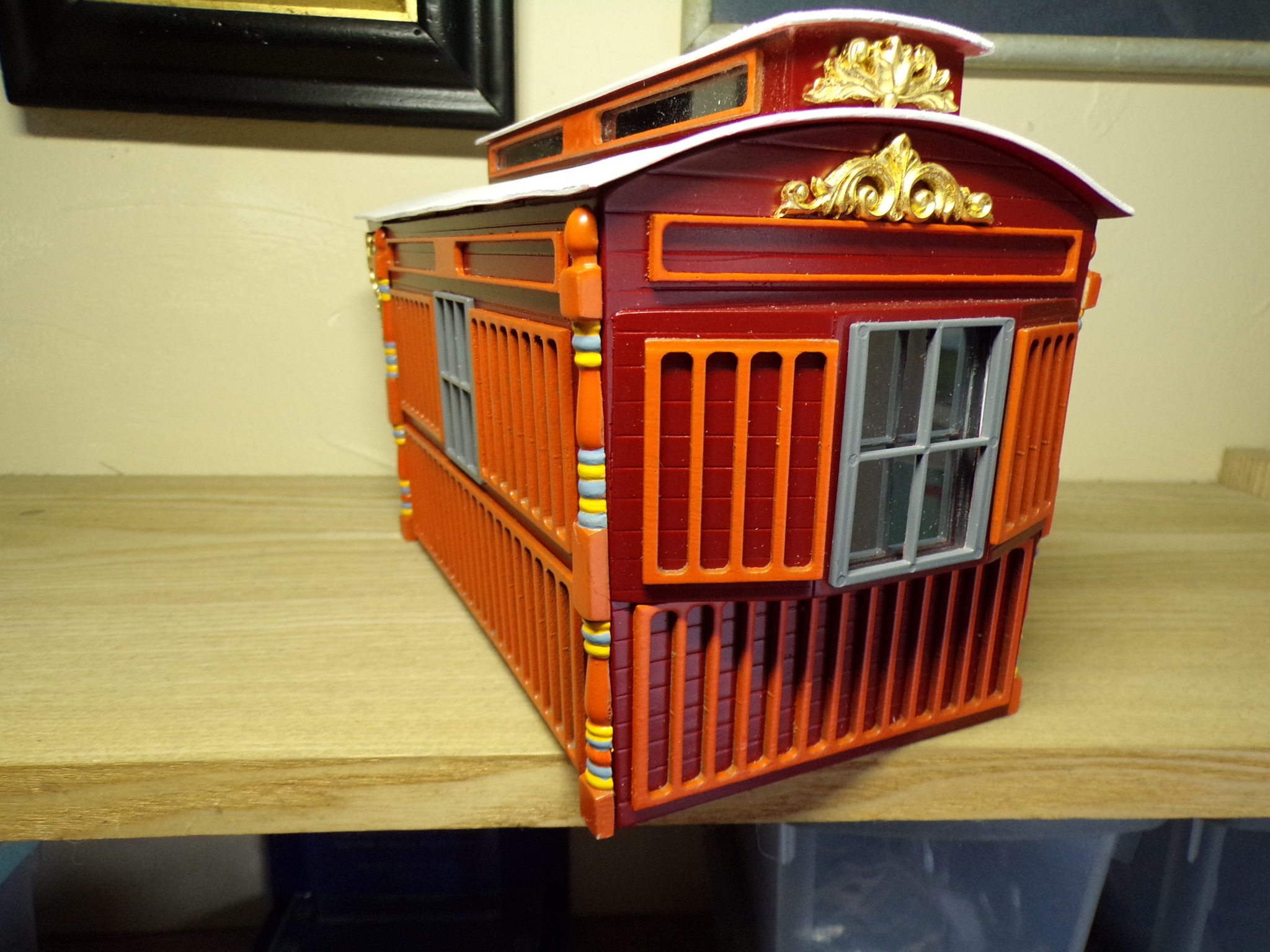

Some more detail to complete the appearance of elaborate carving and gilding usually associated with such period pieces.
I just couldn't resist the temptation to build it as companion to my 'Morgan the Organ'.
Included is a typical clerestory roof.... (let's not go through that again!)
