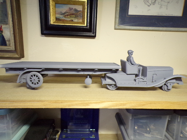

Durley wrote: Mon Jan 19, 2026 9:09 pm ... looking forward to see it progress.
And so you shall....
Much more detail added, namely Jockey wheels, external gear selector, bolt heads, rope cleats and drop-down Artillery wheels for road use.
A quick coat of grey primer and ready for top coat.
I know what colour to use but currently out of stock amongst my rattle cans.
A driver figure has been selected and is awaiting some paint, I can be getting on with that soon.
