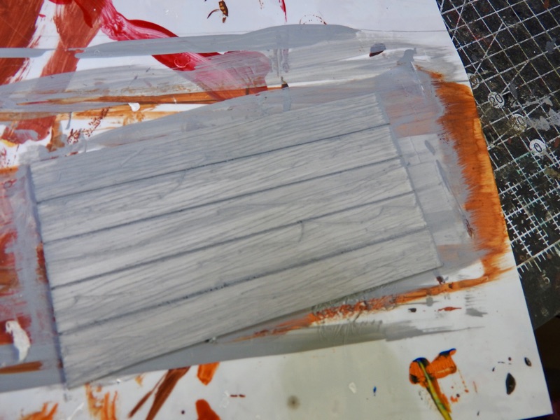

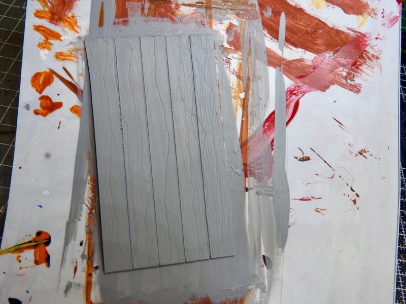

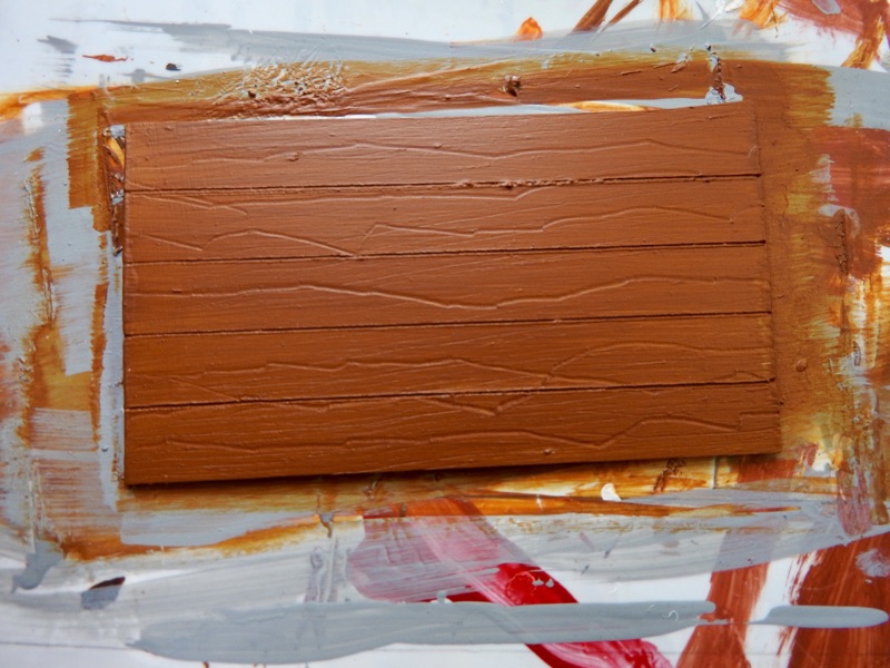

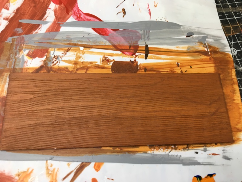

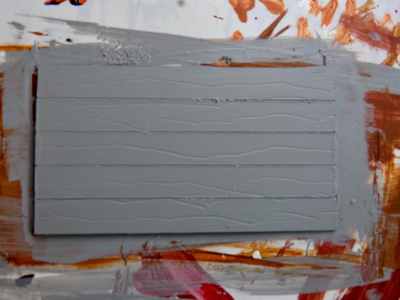

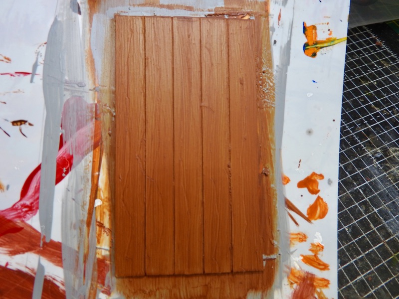

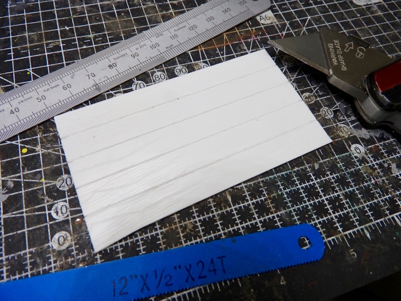

Post by FWLR » Thu Apr 04, 2019 9:49 am
This is how I do my Plasticard with the help of Peter's sample he had.
This is what I use for my card.
Then I paint it with grey paint. I try to put it on with one stroke if possible, though depending on the length, one will end up with darker patches, but sometimes it works well with them.
!st Coat,
JPEG image-2734E0191EA6-1.jpeg (126.51 KiB) Viewed 12536 times
The following are different shades depending on how many coats you put on and how, don't be to heavy handed with the amount of paint on your brush. I try to put a little bit on a flat brush and then brush it out going down the piece I am working on.
Forgot to rotate this one.... :roll: :roll:
JPEG image-A3EEAFE3C2F4-1.jpeg (128.53 KiB) Viewed 12536 times
JPEG image-8B879C1D0C3E-1.jpeg (85.92 KiB) Viewed 12536 times
You can see how much darker it gets.
Now for what ever colour I want to use. Different shades going darker with the grey I put on. Although by experimenting with the amount of coats you can achieve the same shades with just how much you put on with the first coat of grey and the colour of your choice...

I hope this helps in some way, it all trial and error really, but if you take your time and be careful with what ever colour your using, you can achieve similar results to Peter's.....Hopefully.... :lol: :lol:
Posts: 5688
Post by Peter Butler » Thu Apr 04, 2019 1:41 pm
Well done Rod, you are a much better teacher than I could ever be. Your detailed and illustrated description shows the process and the finish can be left to individuals.
Thank you.

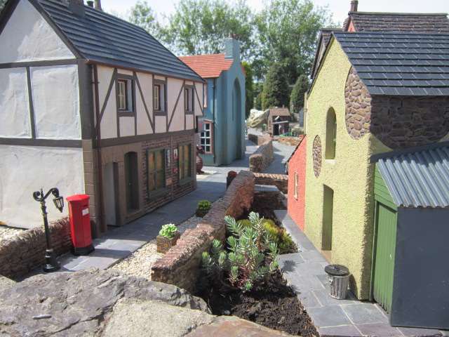

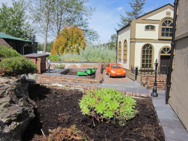

Post by Peter Butler » Wed May 15, 2019 10:46 pm
Although I have been reading and posting on other threads I haven't added to this one for weeks, so here is the latest news.....
The weather has been wonderful for a number of days now and I took the opportunity to set out all of my structures and accessories which have been in the shed over winter. A few recent additions have been made and it is such a great feeling to see them all out again after such a long time.
New plants have also been put in the ground in the hope the frosts have now either finished or are not too severe.
I even ran some trains, although I didn't bother to photograph them....... only my garden railway in a garden railway....
...and the village.....
