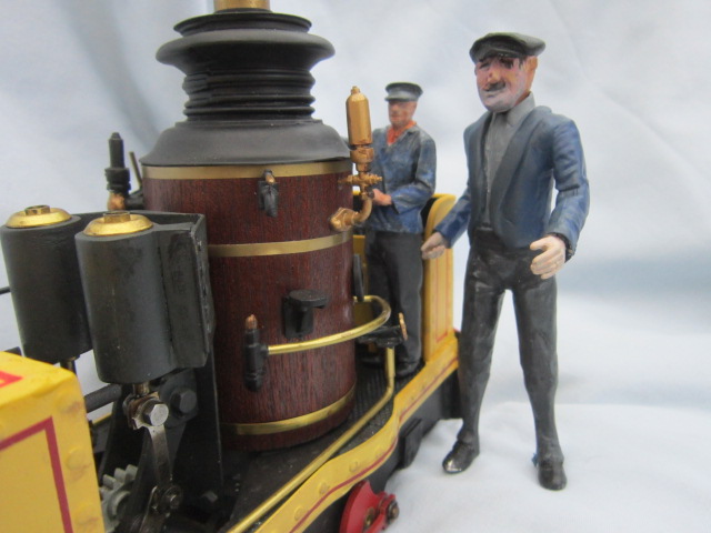

Now that my vertical boilered loco, 'Snail' has been reduced in scale I put the old driver figure next to the new one to see the difference. Looking at the picture it seems as though the larger one is superimposed but he really is standing next to the loco.......
Quite a difference between the scales of my BURPS stock and the Emetts.

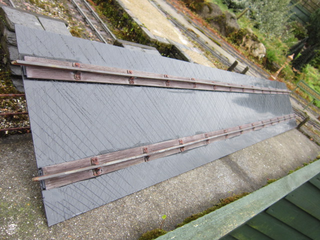

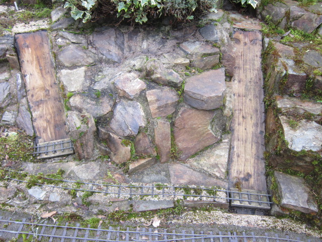

Some years ago I installed two inclines for my disused stone quarry workings. Since then the ballast has gradually washed away down the slope revealing the underlay. It was time to fix the problem but the cause is the fact that dropping loose ballast on a slope and expecting it, and the SBR, to stay put is asking too much.

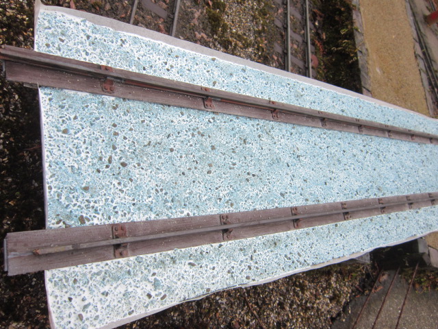

Time for a re-think on design options and the solution is to make the trackwork and ballast on a flat, horizontal surface first and then apply to the incline when finished. So a black, 1mm thick HIP sheet was cut to size and the track laid on long, raised strips of HIP sleeper strip which was grained, painted and weathered..... As can be seen, the HIP has been scored to give the SBR a 'key' and mix of fine ballast and waterproof cement applied and well soaked in neat SBR and left to dry..... Looks alarming when it is wet but will dry clear.... eventually!

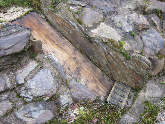

The two sites for the bases, when ready, look like this and they just slide down on top......
Time for something different.

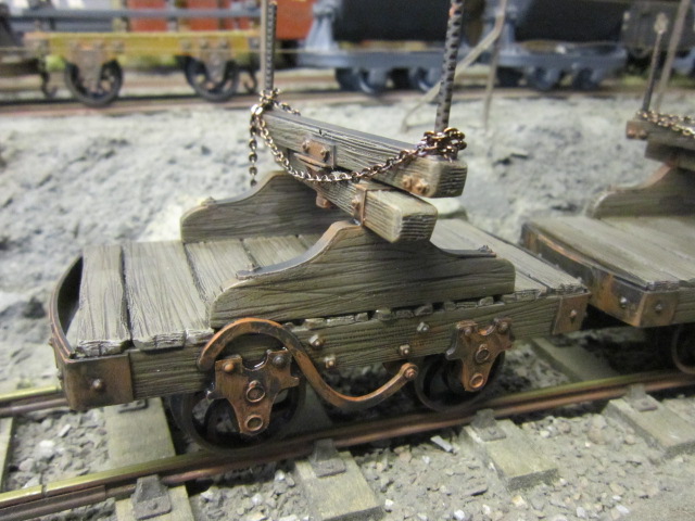

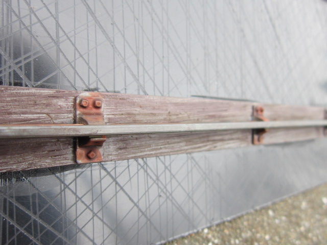

That wood effect looks amazing! I've always struggled replicating aged wood. What does your paint palette include for creating that effect?
- Posts: 5717
Thanks George, the effect I create for aged wood has been covered somewhere back in my thread but briefly the main concern is to make the material (HIP) look like it has a grain. This is done with a razor saw scraped sideways along the length with additional deep scratches done with a Stanley blade, again sideways. After a light sanding I spray grey primer and allow to dry. In this instance I have dry brushed with Citadel acrylic paint (Dryad Bark) to show highlights and after drying a wash coat of Agrax Earthshade to settle in the grooves. I find this works well and can be enhanced with other colours if you want to alter the tone.

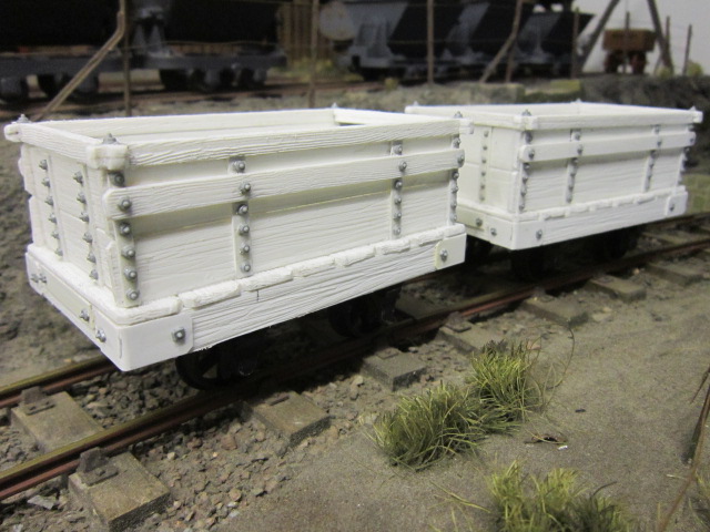

I use only Citadel acrylic paints for all my buildings and much of my stock...... The paint is of the highest quality and has dense pigment and will withstand being left outside in all weathers for many years...... Other wood effects could look like these.....
