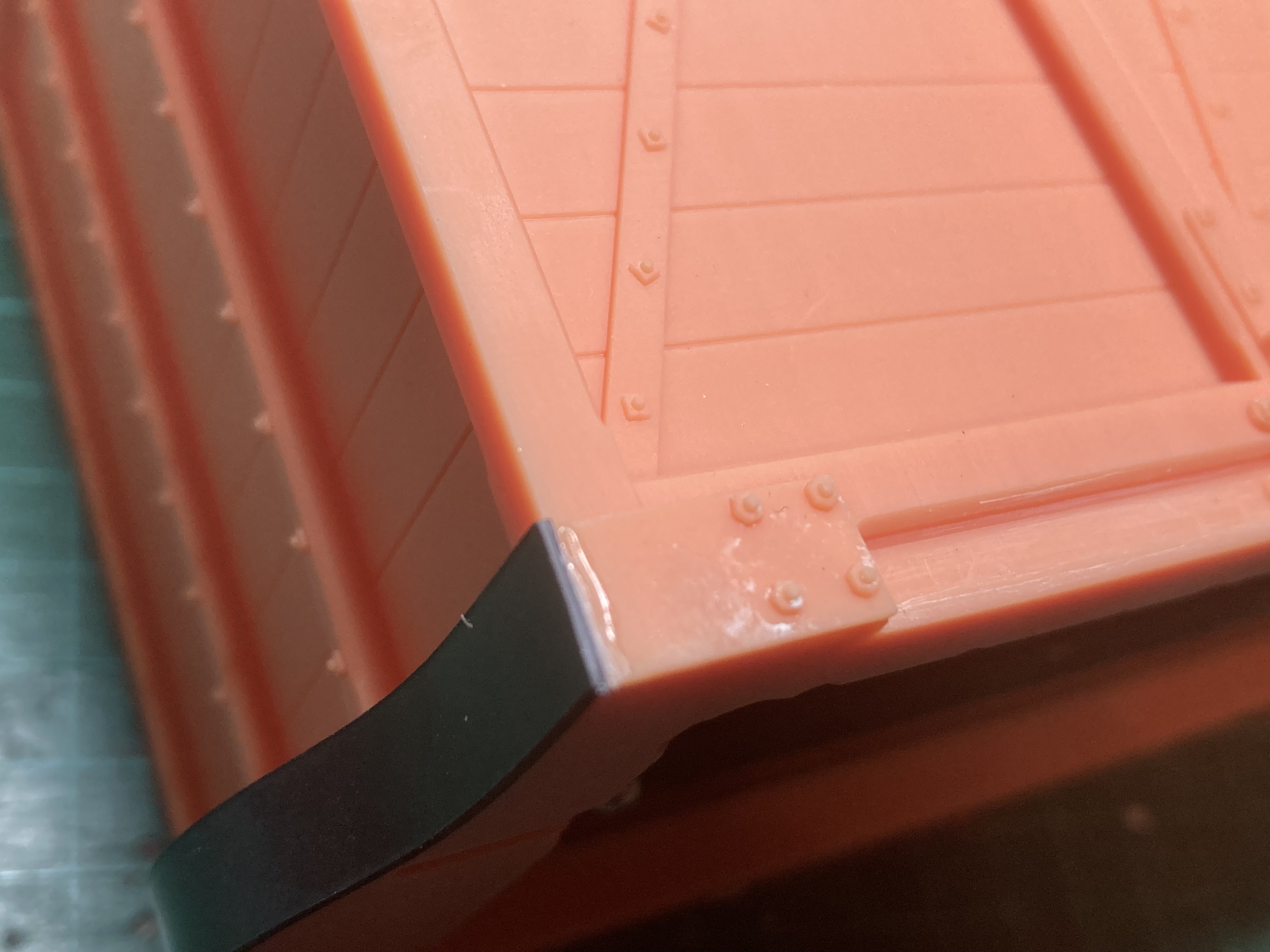

Note the printed bufferplates represent the side extensions to the iron strip that wrapped around each headstock on the prototype. They are handed pairs, oriented with the 4 bolts in the inboard top corner.
Next I cut a strip on black 30 thou platicard using the printed bufferplates as guides for the thickness. Black plasticard was used to avoid coloured resin showing through if the paint was worn off the buffer strip face when the wagon was coupled to other stock.
This strip was left over length then glued to the headstock with superglue. I found it best to glue one end first, with the body flat on the bench, before bending the strip around the headstock and holding whilst the glue cured. Applying the glue to one face and accelerator to the other face before bringing them together makes this a quick process.

I then glued on the bufferplates which could be butted up against the over length plasticard strip. I deliberately allowed the superglue to ooze out at the joint, filling any gap between the strip and plate. Once the glue was dry, the strip was trimmed back and the joint sanded smooth, with a slight radius on the corner to represent the continuous iron plate of the prototype.

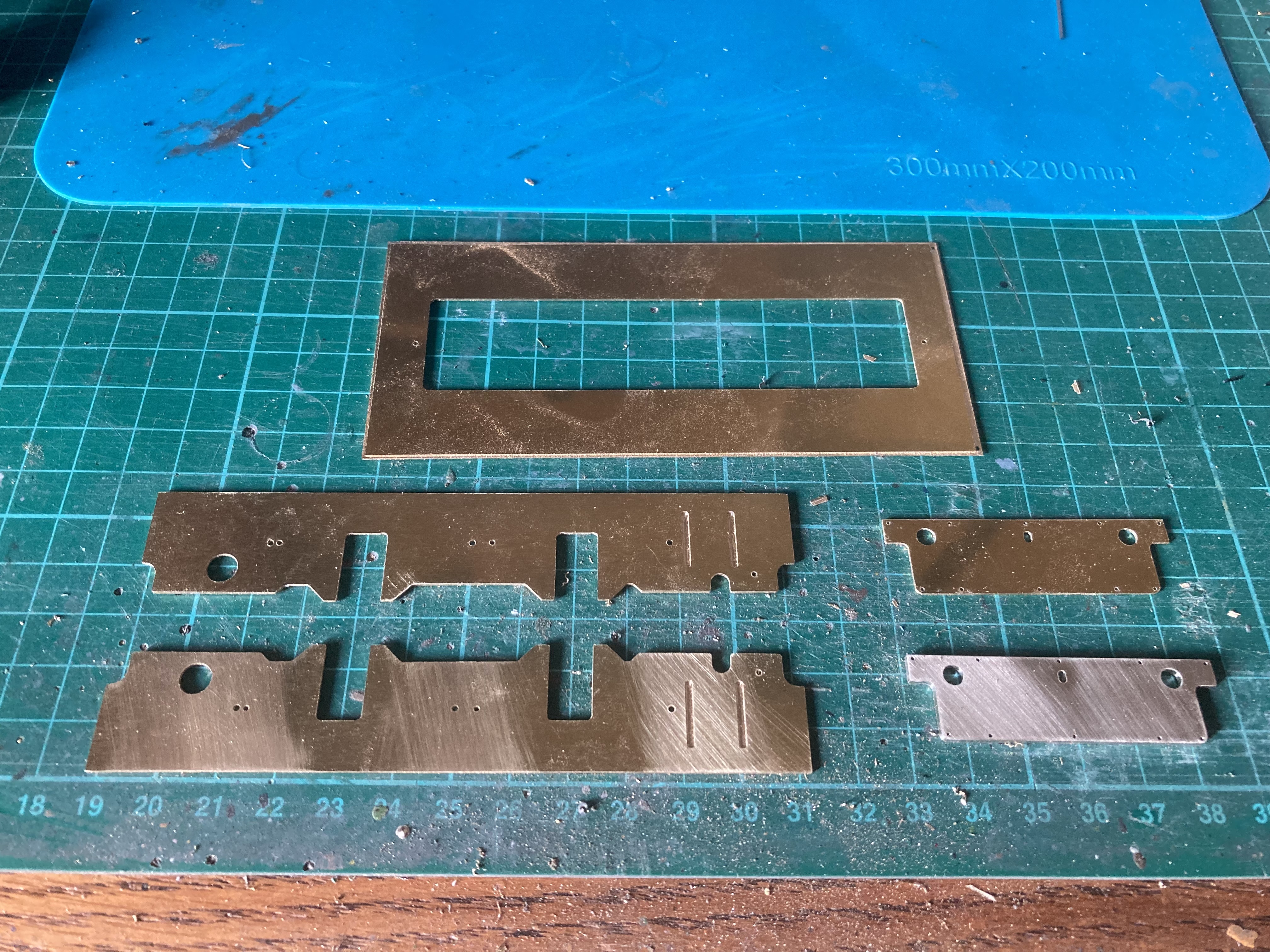

Next stage is the floor. The floor is 154mm x 74mm which I have cut from 3mm Perspex. I use Perspex in preference to ply or MDF so I can easily wash the model before painting. I also cut a 145mm x 13mm rectangle that acts as a jig/spacer for the two longitudinal in the centre of the vehicle.
I cut my Perspex on my CNC milling machine. This is a Genmitsu 3020 Pro Max V2 (https://www.sainsmart.com/products/3020 ... RlZ1mOTwIX) and is a really useful machine that is capable of high precision cutting, carving, boring in a variety of materials. It’ll cut softer metals up to and including mild steel, but I mostly use it for brass and aluminium where cuts of up to 1mm per pass are possible, allowing complex shapes to be cut in reasonable time.
Here’s the CNC machine in action, it helps to have a vacuum cleaner on hand to remove the chips/swarf.
After cutting the parts are held in the sheet by tabs that can easily be cut with a knife and the part tidied up with a file or sanding stick.
The two parts are screwed together and then glued to the body from above using superglue.

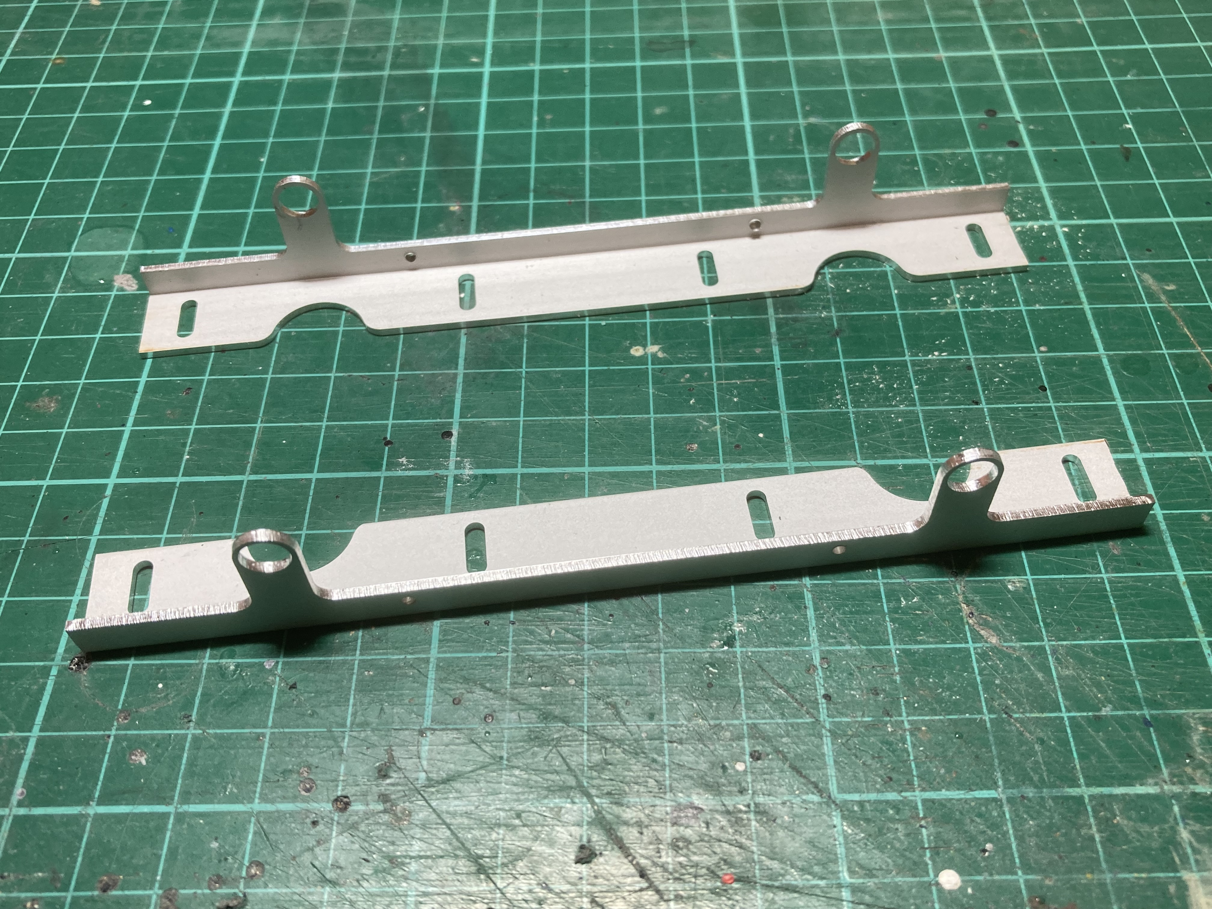

I also used the CNC machine to cut the bearing holders/solebars from a piece of 15x25x1.5mm aluminium angle.
I first cut two pieces of angle slightly over length on my Proxxon mitre/chop saw. These pieces are then clamped to the CNC machine using a pair of bending bars as a rudimentary vice.
I cut the two pieces at the same time, first cutting the top that includes mounting slots through which they can be screwed to the underside of the floor. The crescent shapes are to provide clearance for the wheel flanges, I should have raised the floor mount in the body print a few mm higher and then would have had sufficient clearance! I then unclamp the pieces and flip them over to cut the sides with the 6mm holes for the bearings to mount in. Using the CNC machine ensures the pair perfectly match and will mount the wheels level and square.

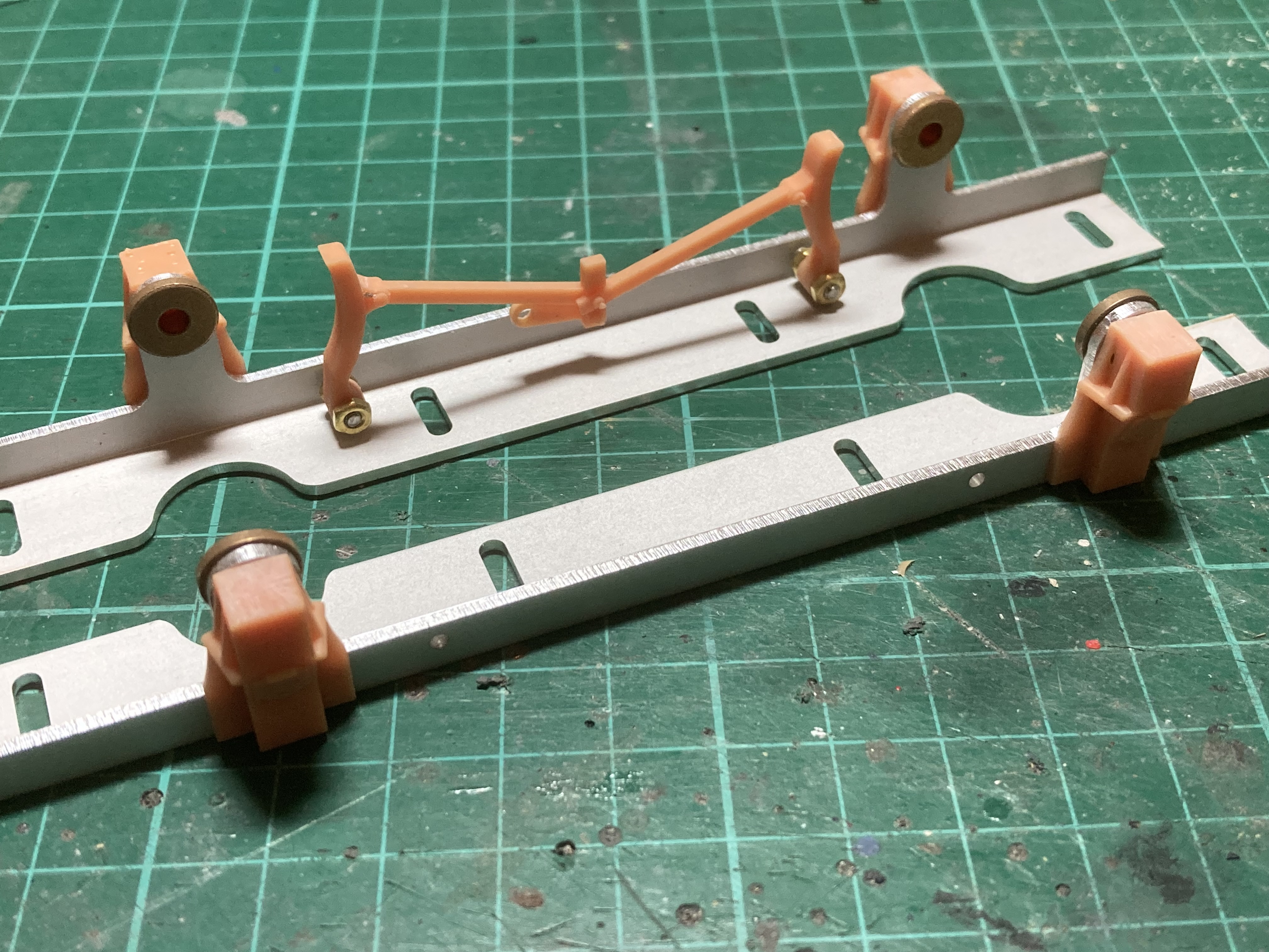

I then glue in the bearings, the Axleboxes and screw in the brakegear using M2 screws tapped into the aluminium.

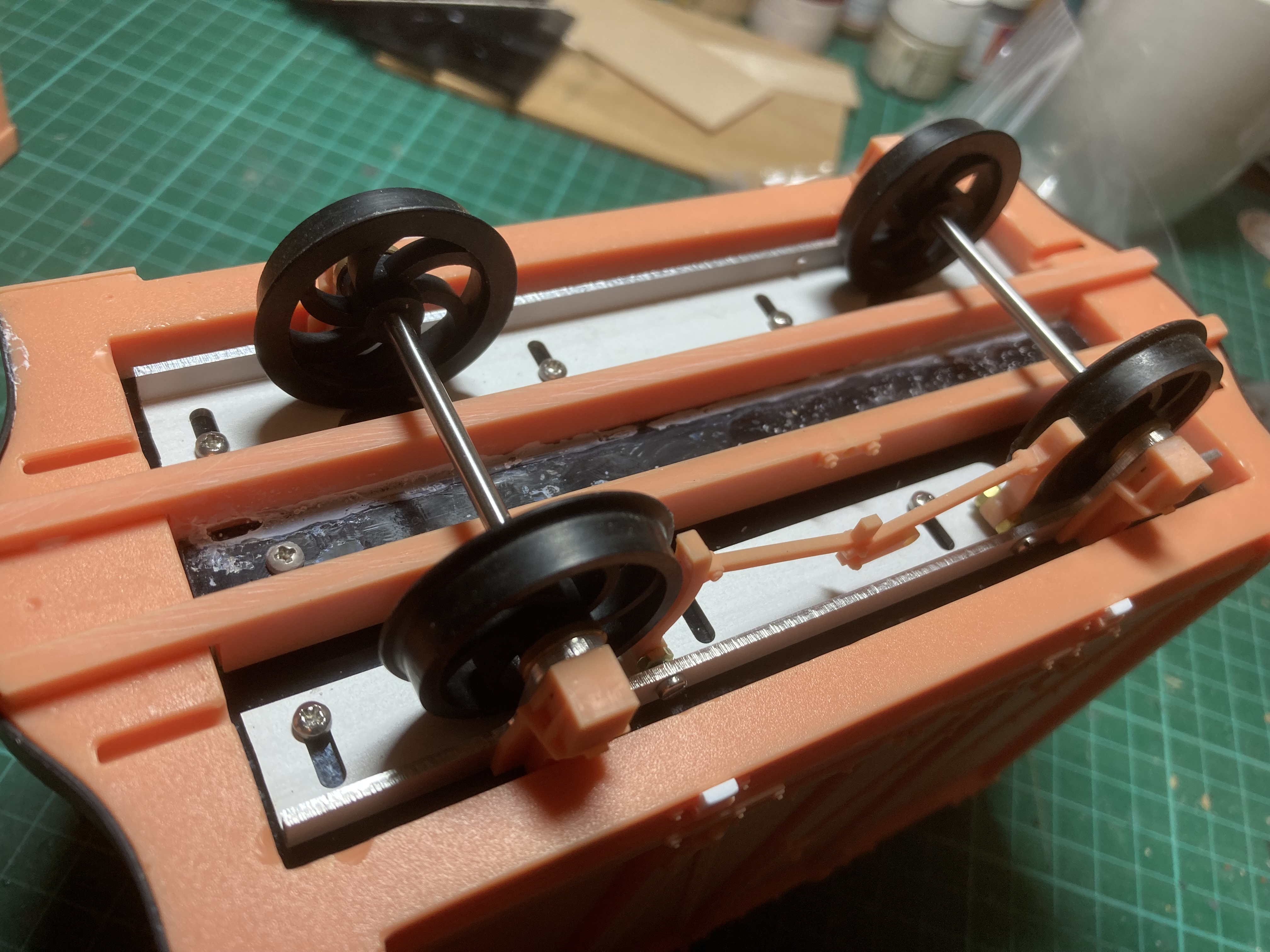

A bit more progress. The two longitudinal are glued to the floor. The spacer helps to align them and also helps straighten them out as printing them flat on the build plate resulted in them taking on a slight curve after curing. I also added the bottom of the door posts using some 60thou plasticard trimmed to size.
Binnie wheels and axles are prepared. I have used 65mm axles and set the back to back to 40mm for 45mm gauge track. The 3mm id bearings are from Houstoun Gate Loco Works https://www.hglw.co.uk/misc_accessories.html
Next the solebars are screwed to the floor. The slots allow some fine adjustment on the side play to optimise running.

I have been really impressed by my CNC machine. There are a lot of 3020 type machines on the market but the Genmitsu is definitely one of the better ones, being rigid enough to cope with metal milling and accurate to better than 0.1mm which is plenty accurate for most tasks. Other than needing to bolt the two main parts of the machine together, fit the spindle motor and wire in the controller (about 30mins work) it is pretty much ready to go, I’ve not needed to adjust anything since I got the machine 2 years ago.
I use the free version of Fusion360 for CAD which produces the G-Code programmes that the CNC uses. The files are transferred via an SD card.
Establishing what combination of settings (cutting speed and depth of cut) to use on different materials has been the main learning point but I now have my own rules of thumb that work well enough. I use single flute endmills for non-ferrous metals and Perspex, purchased from here:
https://www.shop-apt.co.uk/1-flute-carb ... inium.html
My most used bit is the 1/8” which I run at the same 300mm/min in all materials, changing the cutting depth to 0.1mm for brass/nickel silver, 0.5mm for aluminium and 1mm for Perspex.

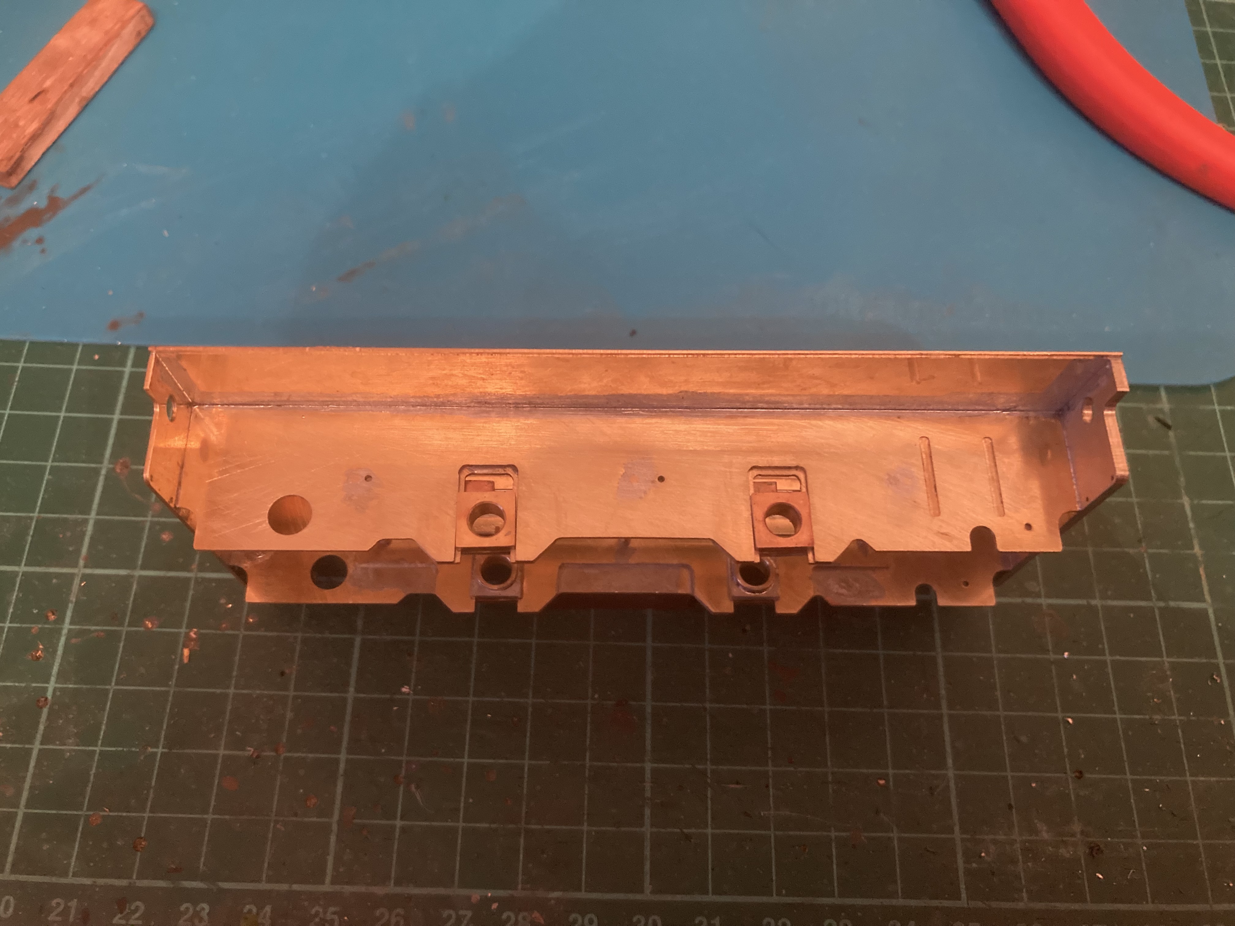

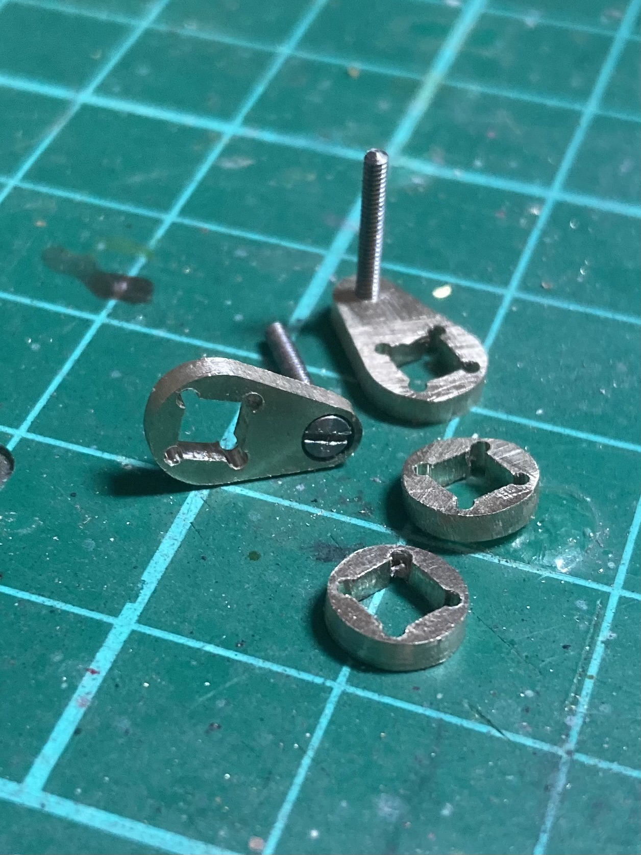

To show what the CNC is capable of, here are some examples of parts I cut for an O gauge loco chassis which used 0.7mm brass sheet for the frames, 1.5mm nickel sheet for the coupling rods and 2mm aluminium stock for the fly cranks. The chassis is sprung with hornguides cut into the chassis frames to mount the slaters hornblocks. This chassis ran perfectly with no fettling needed to any of the machined parts, which is testament to the CNC accuracy.
And a video cutting some smaller parts using a 2mm bit

To answer Simon’s questions, the parts are cut out using multiple passes, each deeper into the material by whatever depth of cut you set. For harder metals like brass and nickel silver, I use 0.1mm depth of cut so it takes 10 passes to cut through a 1mm sheet. In practice, you’ll need more passes as, unless you are using ground flat stock, you’ll need a few passes above the top surface of the stock to cut through any high points and a few passes below the bottom of the stock to make sure it is cut right through. In aluminium which is a lot softer than brass, I work with a depth of cut of 0.5mm so it needs fewer passes to cut through and is therefore quicker to complete the operation. Aluminium is also a lot cheaper than brass! To get a really nice finish on the cut edge, you can choose to do a finishing pass at full depth, which then means the preceding passes (roughing cuts) leave some stock material around the part so the the finishing cut has something to cut into. All these are settings in the manufacturing module of Fusion360, that can be altered to suit.
In the video I used the masking tape and superglue method to hold the parts on the machine bed. This just involves sticking masking tape to the entire bottom surface of the stock material and all over the top surface of the machine bed. I then use medium superglue on the non-sticky masking taped surfaces to glue the stock material to the bed, holding the stock flat on the bed. Once machining is finished, the machined parts can be removed by peeling off the masking tape to release the parts. Clamping stock to the bed using screw clamps provided with the machine or in a separate vice are also options, but the superglue and masking tape approach is generally easier for sheet stock.

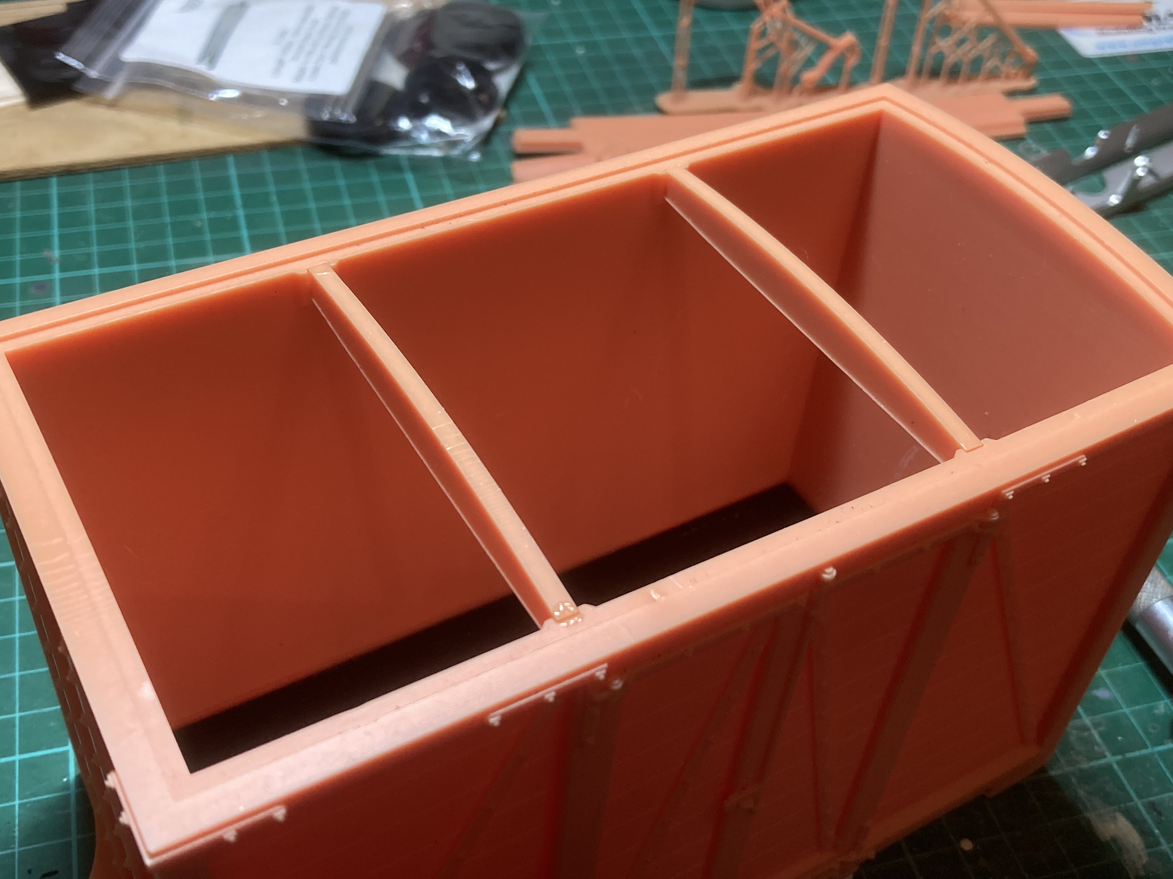

After a bit of distraction, the final steps in building the van. The roof supports are glued to the inside of the van, aligned in the slots included the printed body.
I chose to paint this van before adding the roof. I’ve used Army Painter Angel Green aerosol as my best guess of what shade GVT holly green may have been.
The roof is made up from two laminations of 0.8mm ply. The lower one is 157x79mm and is superglued in the rebate in the top of the body. The upper laminate is 169x89.5mm and is glued to the lower laminate with wood glue (I used waterproof Gorilla wood glue) and glued around the perimeter where it overlaps the body using superglue. This results in a very strong and secure roof. I made up a jig using some pine strip wood screwed to an off cut of chipboard to support the roof while the glue dried. The body is weighed down with a 2l fizzy drink bottle resting on the wheels.

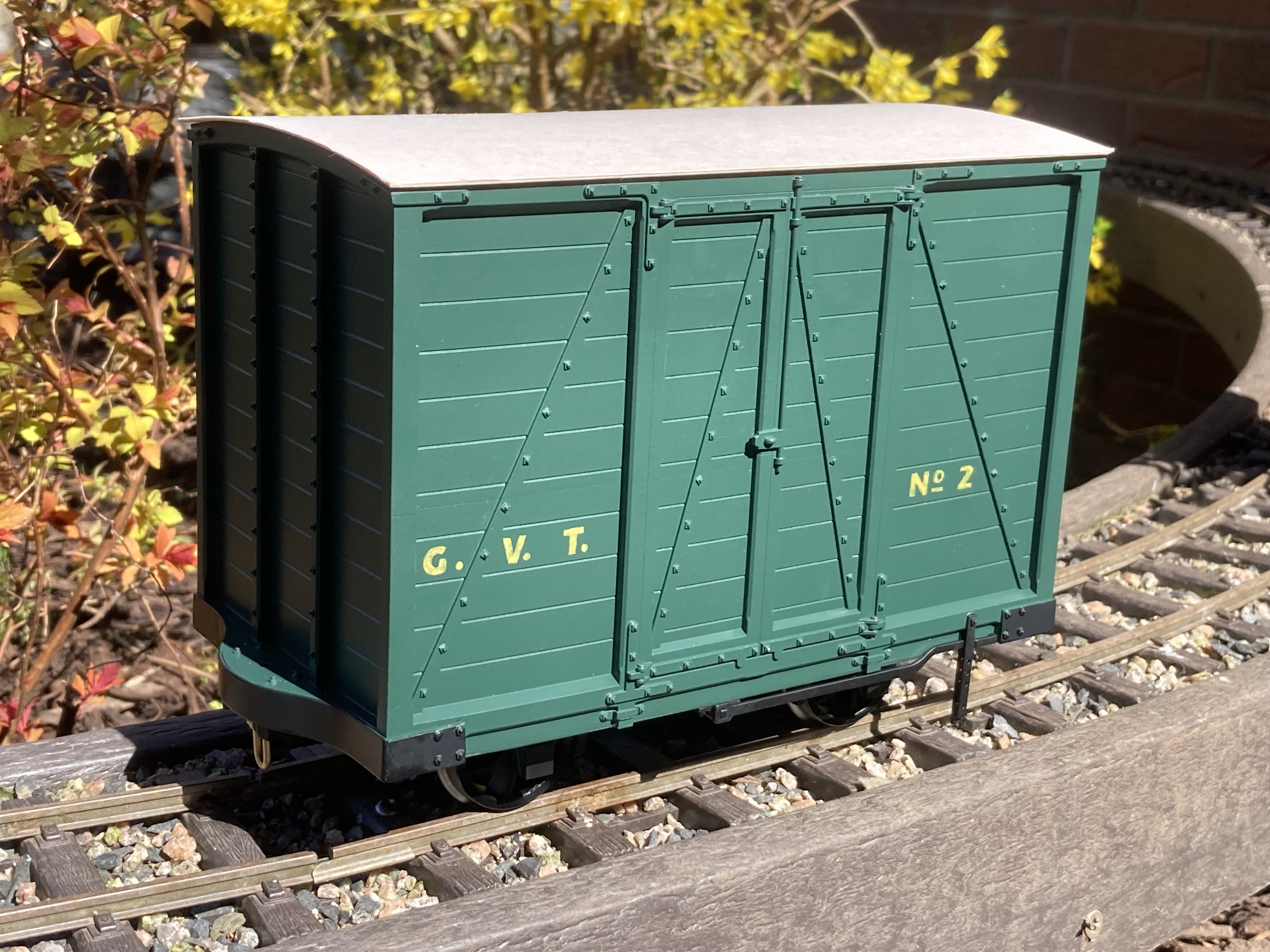

And that is pretty well it. Here’s the finished 19mm/ft version, lettering added with a gold Posca paint pen using washi tape masks cut on my wife’s Cricut machine.

Beautifully finished! What a fascinating and (to me) instructive project, and a great final result.
