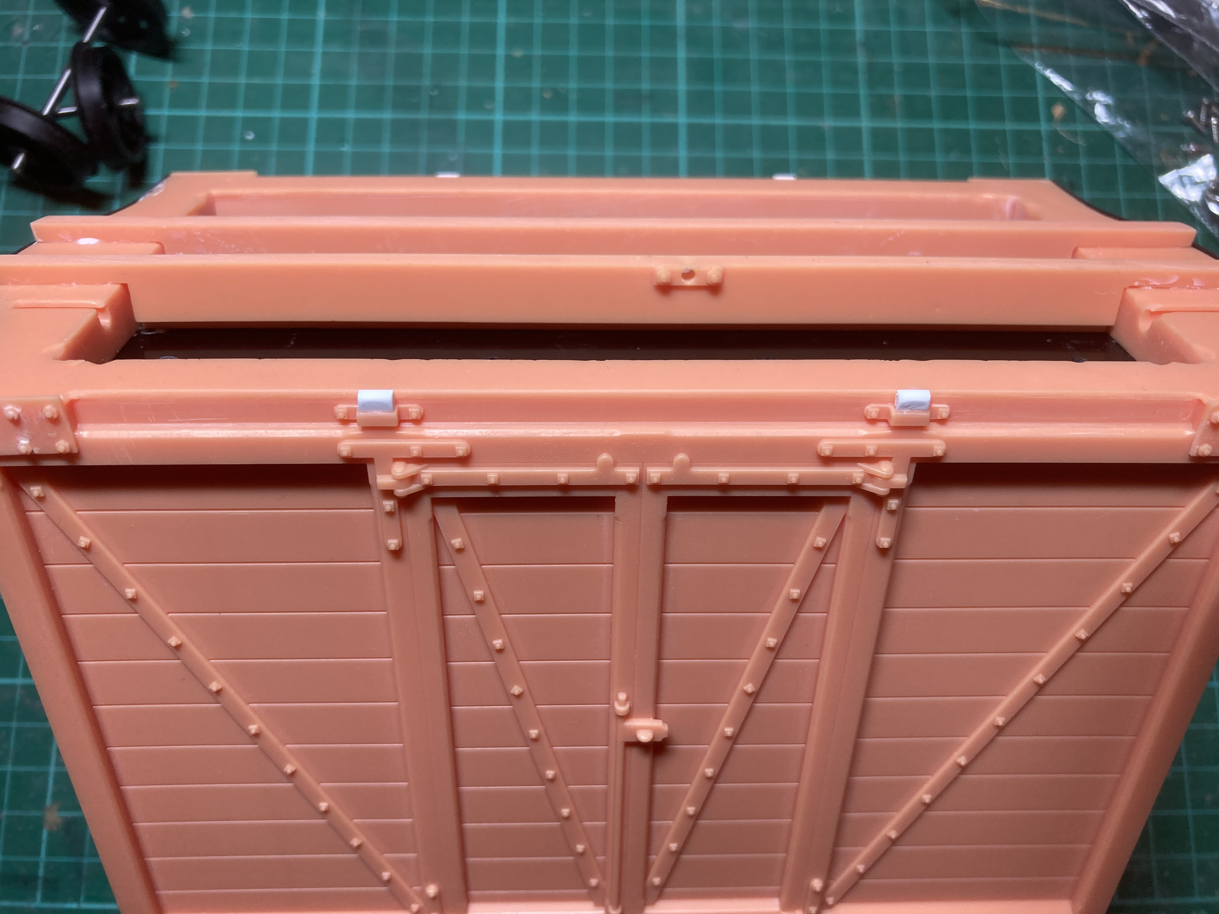

Next I removed the false floor from the body by scoring around it with a scalpel run along the inside faces of the body which then allows the floor to be flexed and snapped out. The ‘ears’ were removed in the same way and the lower edges were then filed smooth to remove any remnants of the false floor, ears and the lip around the bottom edge (referred to as the ‘elephant foot’ effect). The ‘elephant foot’ is caused by the need to overexpose the first few layers of the resin print causing the surrounding resin to cure and leaving a small lip where the body was adhered to the build plate of the printer.

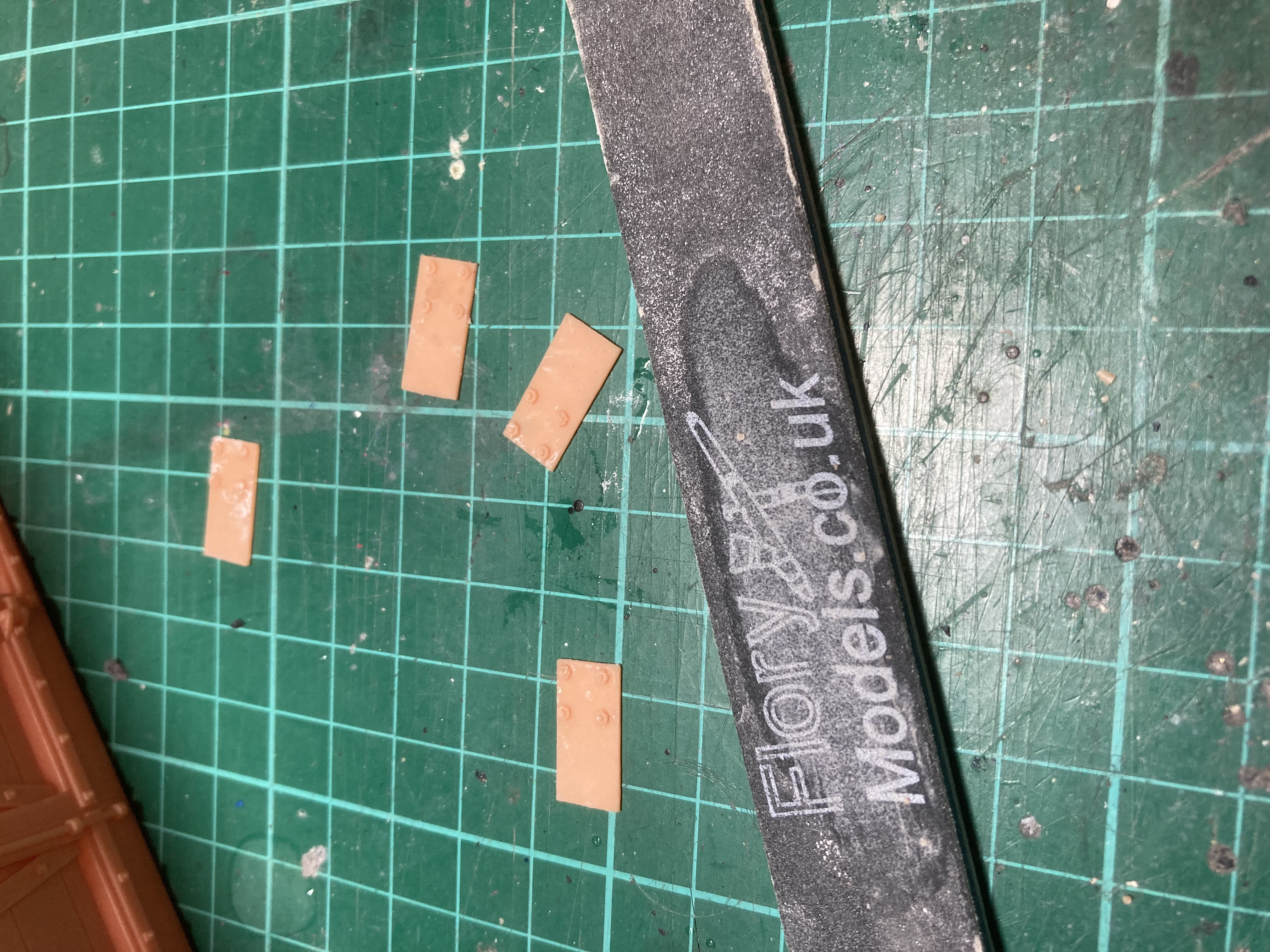

I then removed the supports from the printed bufferplates and cleaned up the rear face with a wet sanding stick.
Note the printed bufferplates represent the side extensions to the iron strip that wrapped around each headstock on the prototype. They are handed pairs, oriented with the 4 bolts in the inboard top corner.

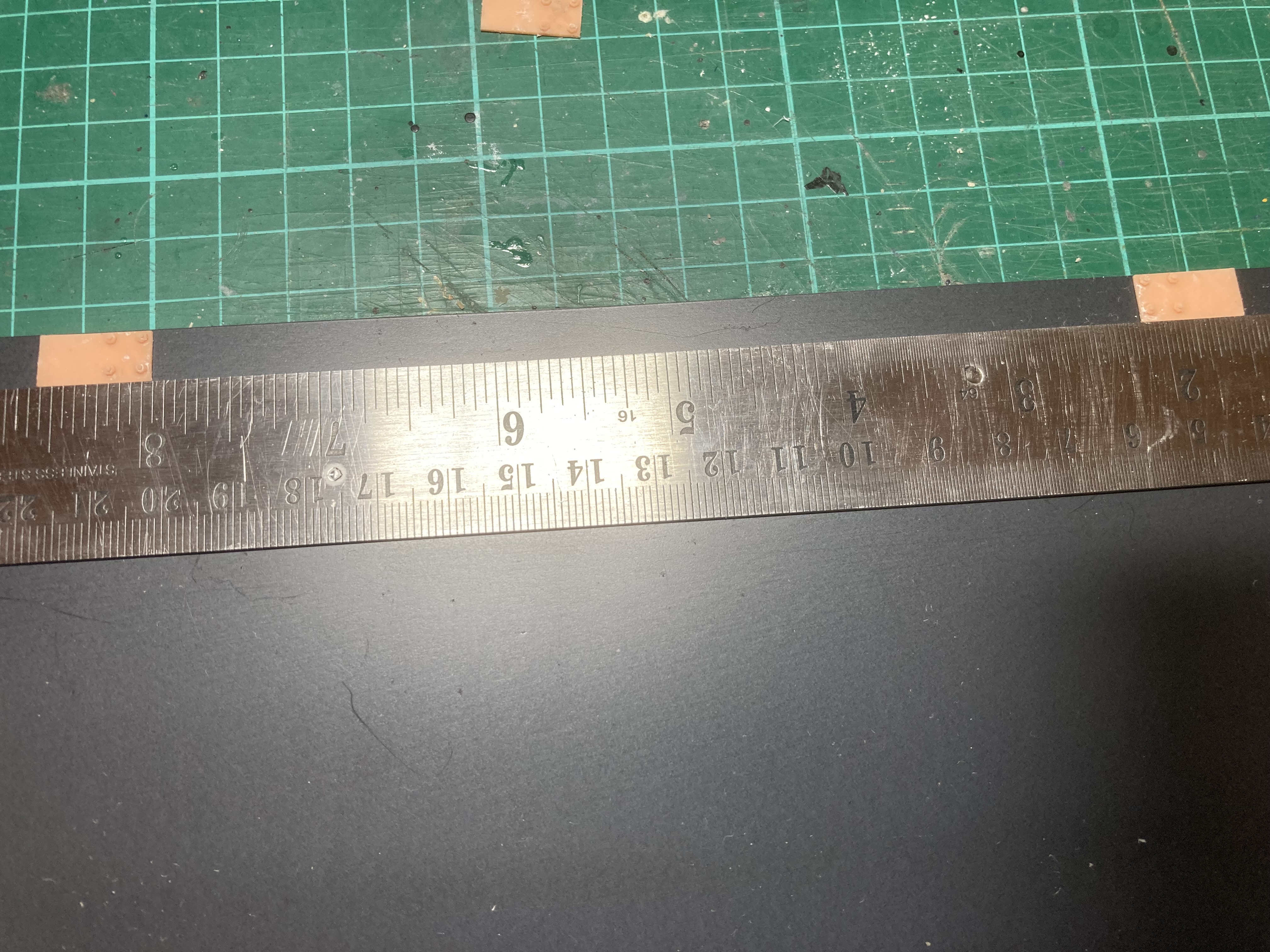

Next I cut a strip on black 30 thou platicard using the printed bufferplates as guides for the thickness. Black plasticard was used to avoid coloured resin showing through if the paint was worn off the buffer strip face when the wagon was coupled to other stock. This strip was left over length then glued to the headstock with superglue. I found it best to glue one end first, with the body flat on the bench, before bending the strip around the headstock and holding whilst the glue cured. Applying the glue to one face and accelerator to the other face before bringing them together makes this a quick process.

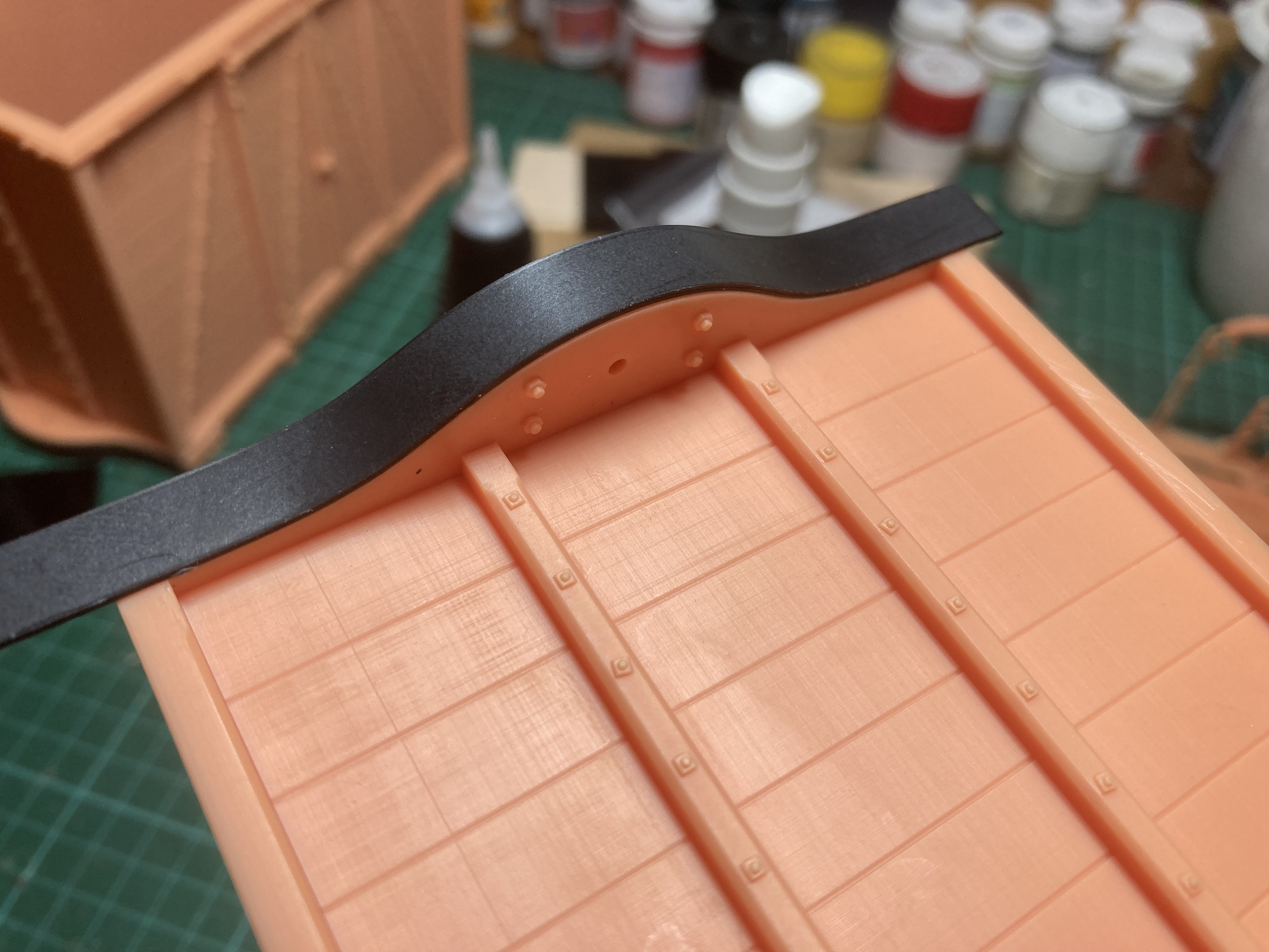

I then glued on the bufferplates which could be butted up against the over length plasticard strip. I deliberately allowed the superglue to ooze out at the joint, filling any gap between the strip and plate. Once the glue was dry, the strip was trimmed back and the joint sanded smooth, with a slight radius on the corner to represent the continuous iron plate of the prototype.

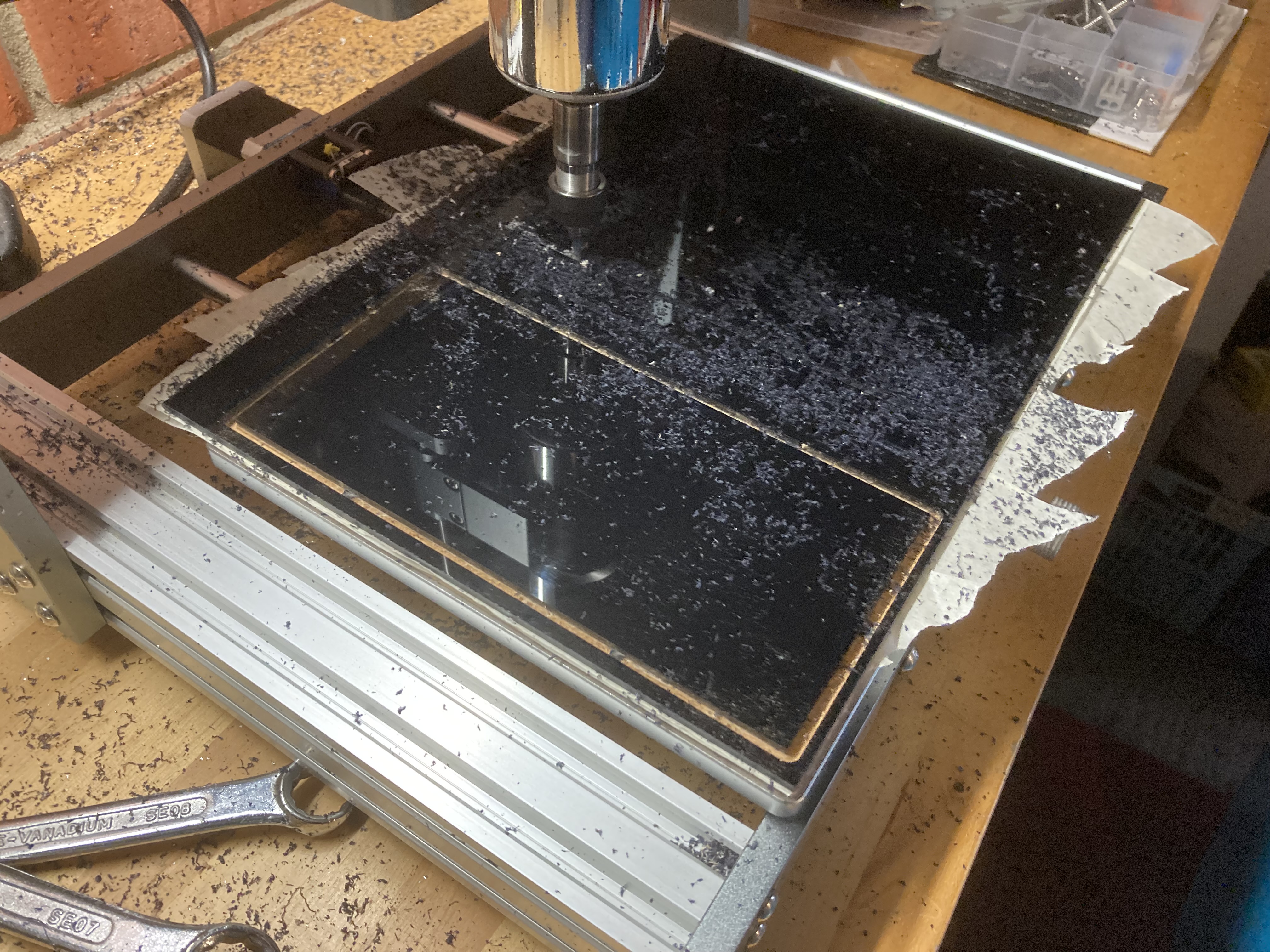

Next stage is the floor. The floor is 154mm x 74mm which I have cut from 3mm Perspex. I use Perspex in preference to ply or MDF so I can easily wash the model before painting. I also cut a 145mm x 13mm rectangle that acts as a jig/spacer for the two longitudinal in the centre of the vehicle.
I cut my Perspex on my CNC milling machine. This is a Genmitsu 3020 Pro Max V2 (https://www.sainsmart.com/products/3020 ... RlZ1mOTwIX) and is a really useful machine that is capable of high precision cutting, carving, boring in a variety of materials. It’ll cut softer metals up to and including mild steel, but I mostly use it for brass and aluminium where cuts of up to 1mm per pass are possible, allowing complex shapes to be cut in reasonable time.
Here’s the CNC machine in action, it helps to have a vacuum cleaner on hand to remove the chips/swarf.
After cutting the parts are held in the sheet by tabs that can easily be cut with a knife and the part tidied up with a file or sanding stick.

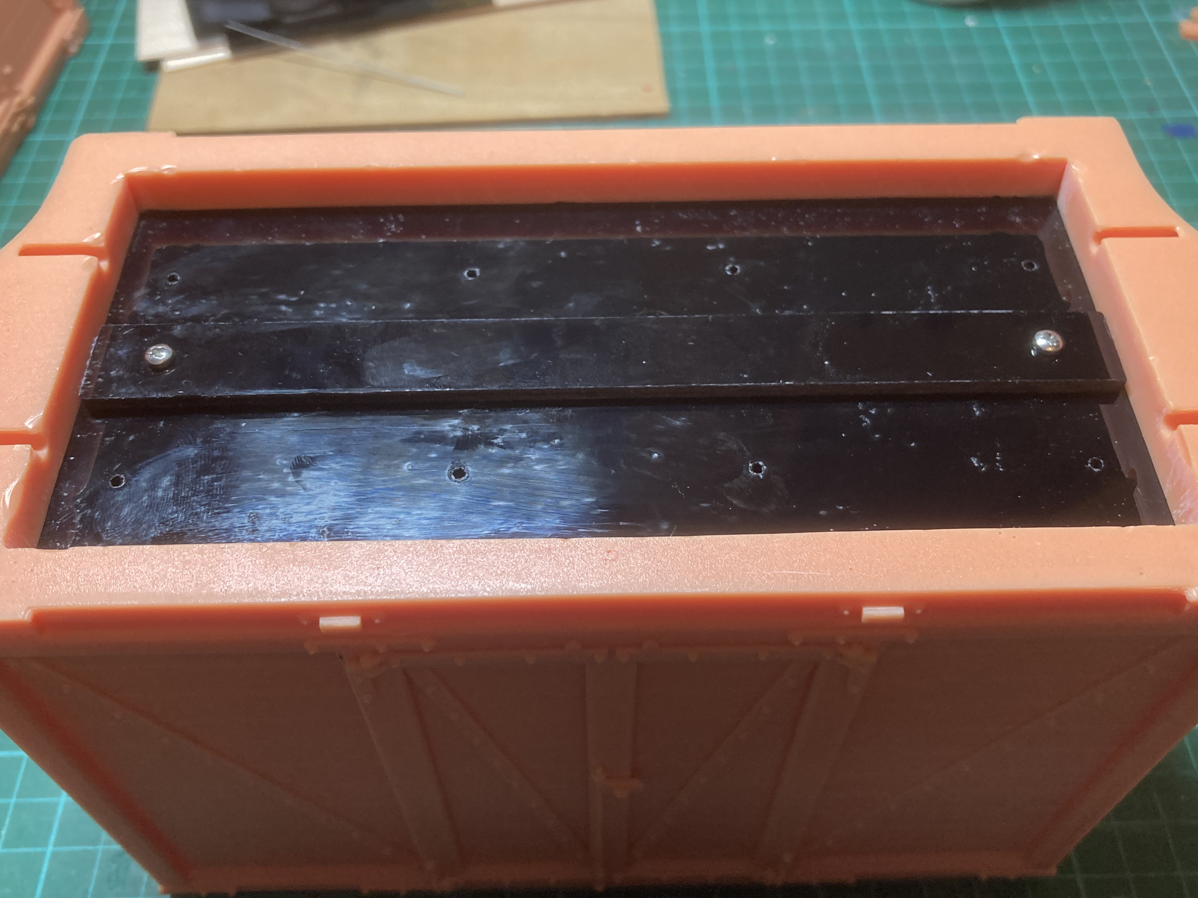

The two parts are screwed together and then glued to the body from above using superglue.

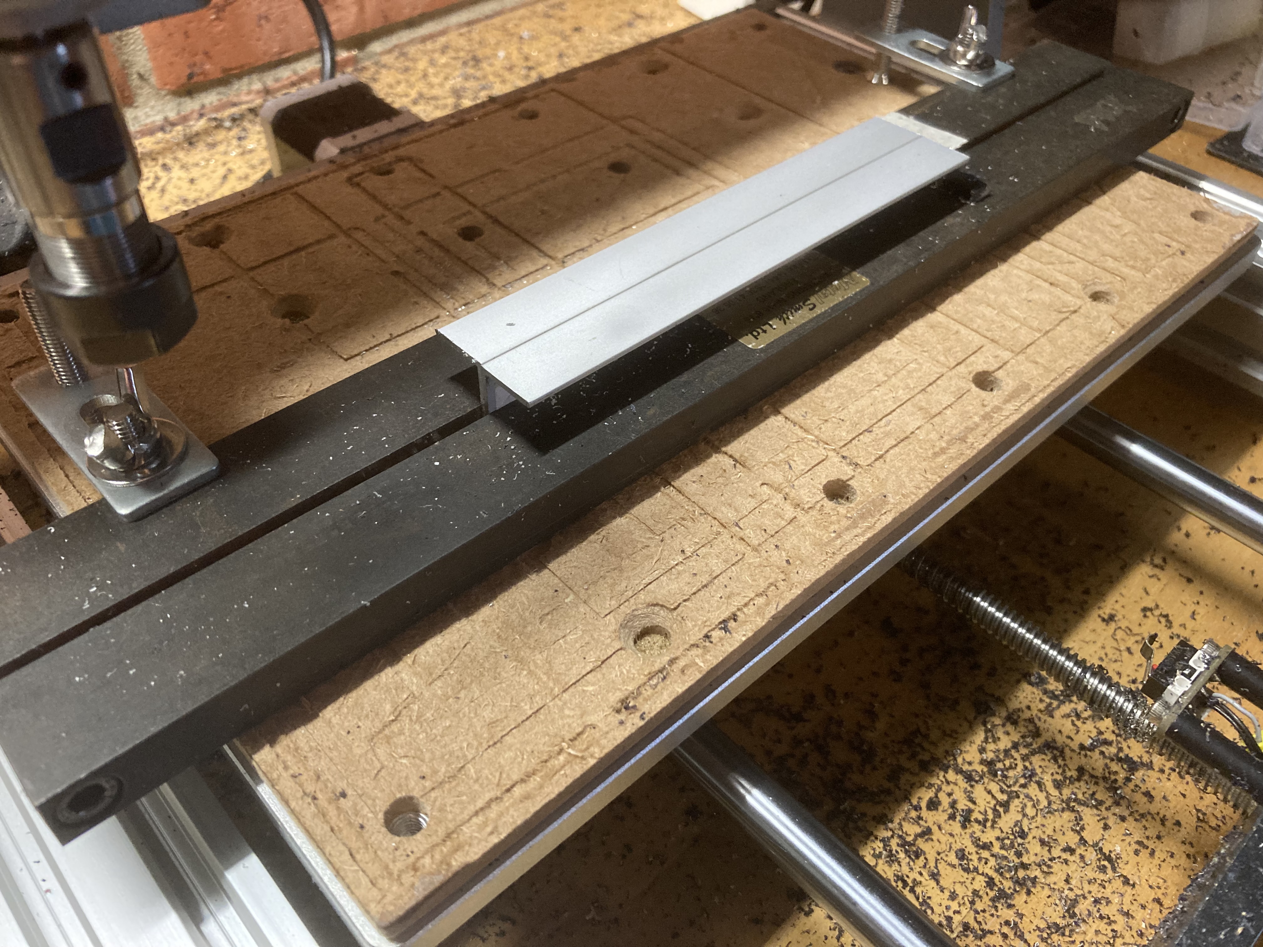

I also used the CNC machine to cut the bearing holders/solebars from a piece of 15x25x1.5mm aluminium angle.
I first cut two pieces of angle slightly over length on my Proxxon mitre/chop saw. These pieces are then clamped to the CNC machine using a pair of bending bars as a rudimentary vice. I cut the two pieces at the same time, first cutting the top that includes mounting slots through which they can be screwed to the underside of the floor. The crescent shapes are to provide clearance for the wheel flanges, I should have raised the floor mount in the body print a few mm higher and then would have had sufficient clearance! I then unclamp the pieces and flip them over to cut the sides with the 6mm holes for the bearings to mount in. Using the CNC machine ensures the pair perfectly match and will mount the wheels level and square. I then glue in the bearings, the Axleboxes and screw in the brakegear using M2 screws tapped into the aluminium.

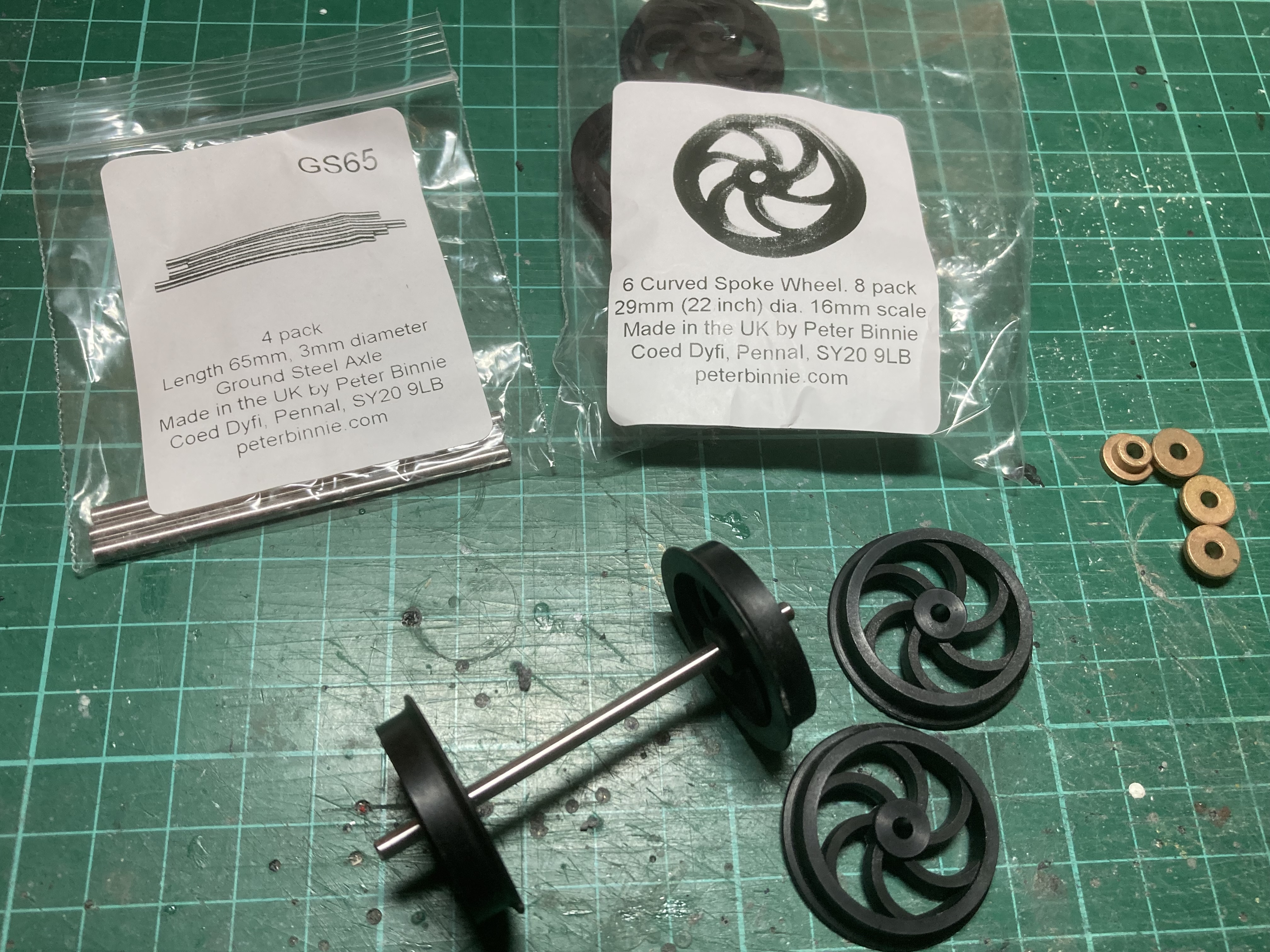

Binnie wheels and axles are prepared. I have used 65mm axles and set the back to back to 40mm for 45mm gauge track. The 3mm id bearings are from Houstoun Gate Loco Works https://www.hglw.co.uk/misc_accessories.html
