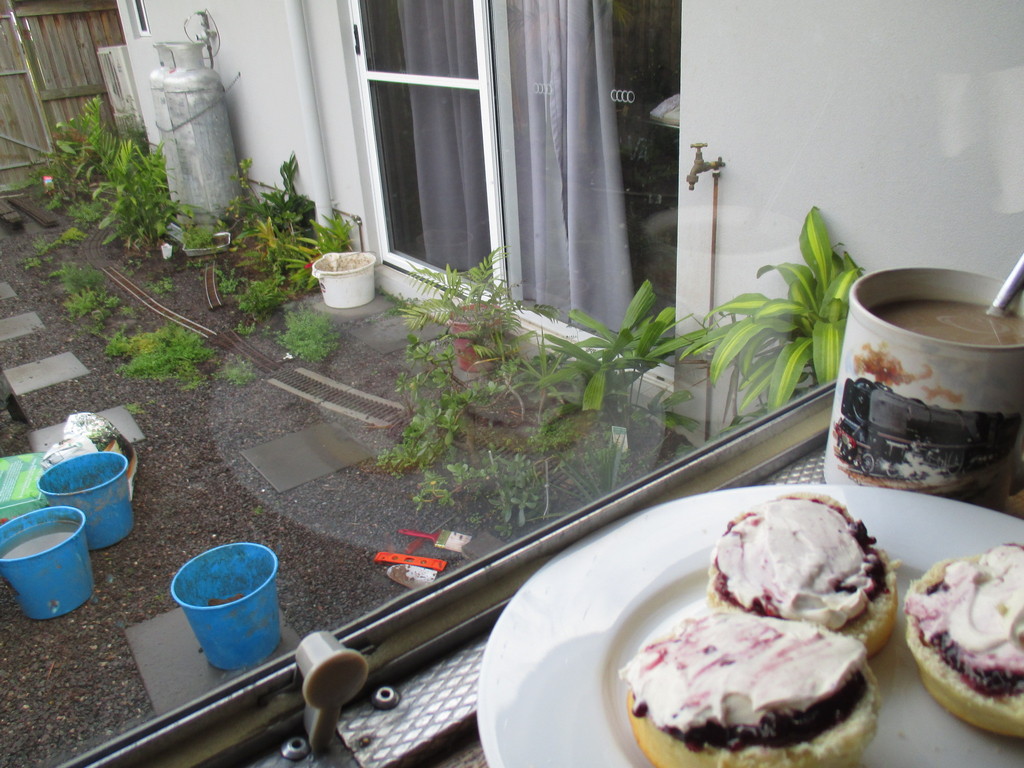

Some more plants delivered, (always need more though) and in trying to use up that pile of gravel (yes, I over-ordered again) I got to starting on the gravel-filled trench roadbed as well.
Mum's a bit of a "tropical enthusiast" and has a number of Dracaena plants, that I've noticed to resemble scale palm trees if kept small. To that end, I've been watering and fertilising them for some months, cultivating the offshoots. I've been doing the same with her Jade plants, which make reasonable miniature "trees".
I left most of these in their pots when I planted them. This will limit their size and make it easier to take them with us when we move out.
I must say, I like where this is going..

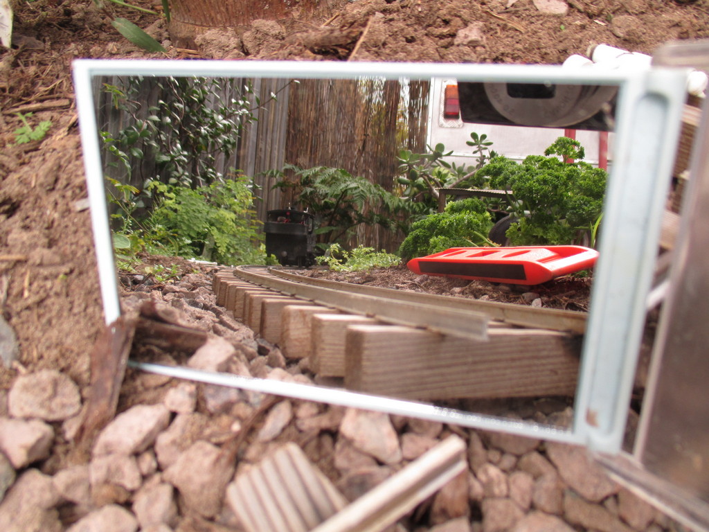

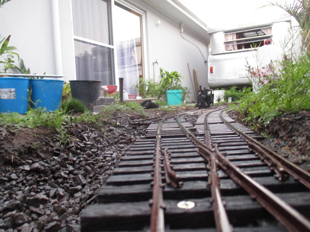

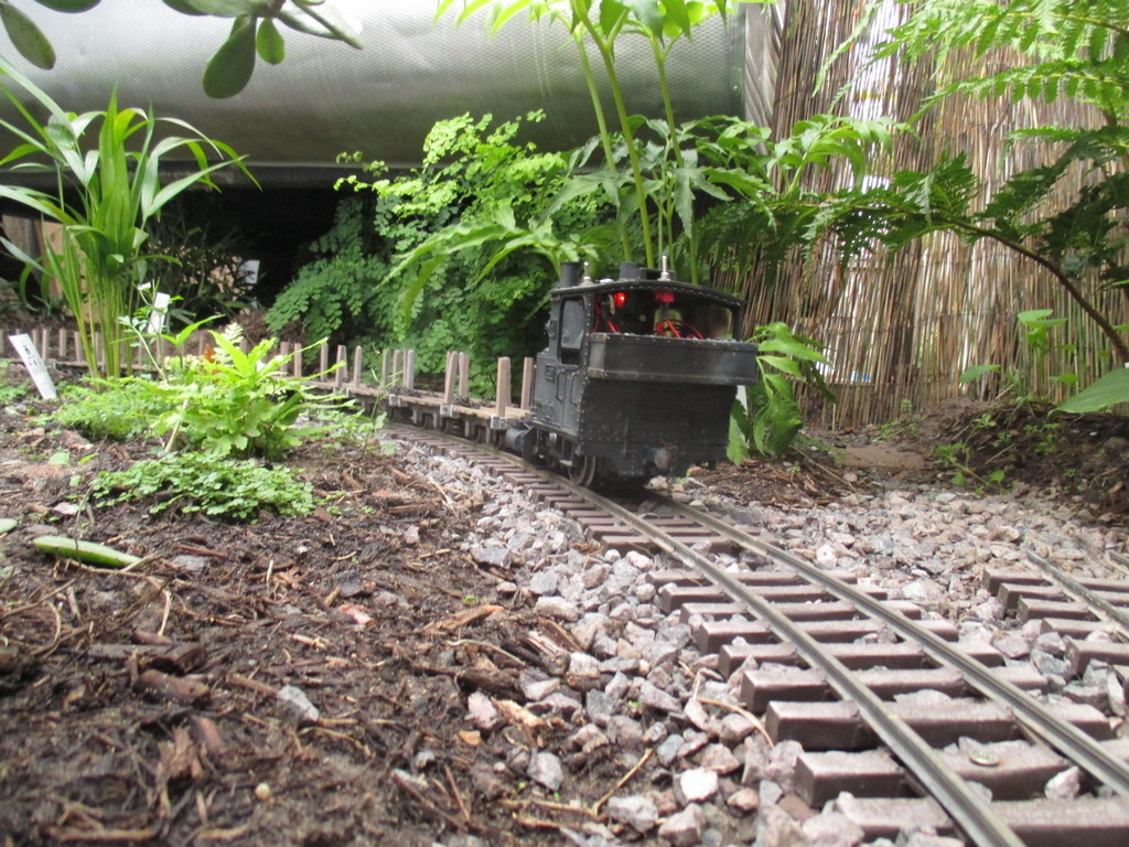

Another few yards are down, allowing for the first train on the tramway. The trucks were thoroughly tested at all speeds, pushed and pulled in both directions, loaded and empty, etc etc. Only problems were from some of the permanently-link-coupled trucks, (because they don't like being pushed) and the odd cane load snagging on weeds, which were subsequently trimmed.
The line to mid-right will be laid as part of Stage Two.

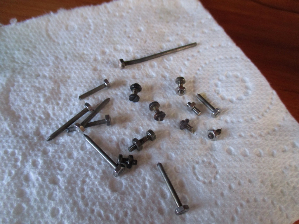

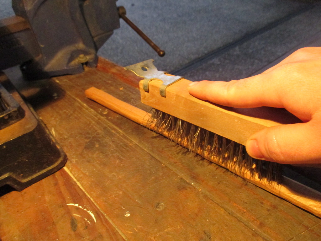

The bridge in the Southeastern corner of the yard will be built from cedar. When I built the handlaid track some years ago, I set aside a bundle of sticks ripped down from cedar planks, for use as point and bridge timbers. The term for of milling both sides of a log, so it doesn't roll away, is unknown to me, so unless anyone knows the correct term for it, I'll just call them "paralleled" logs. A pair of sticks had two sides each, whittled down to look like "paralleled" logs. Whittling's rather enjoyable, though I don't see myself carving anything more than miniature logs..
A scale grain effect was added with a wire brush.

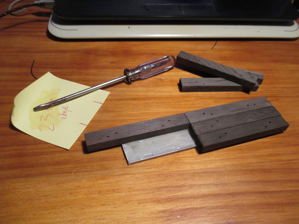

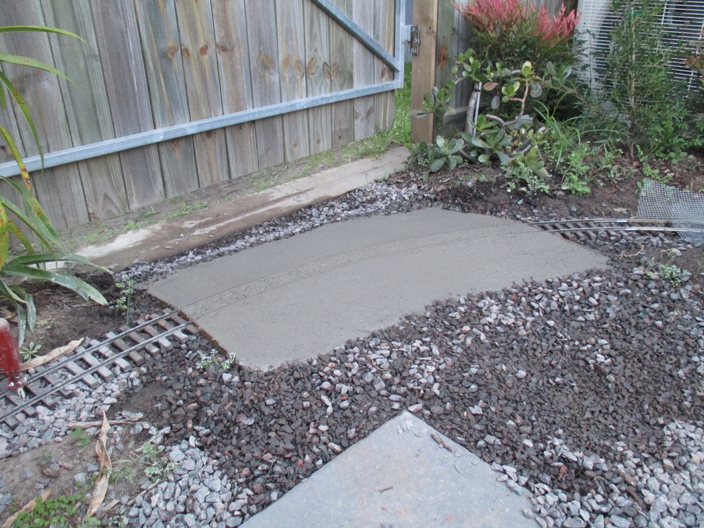

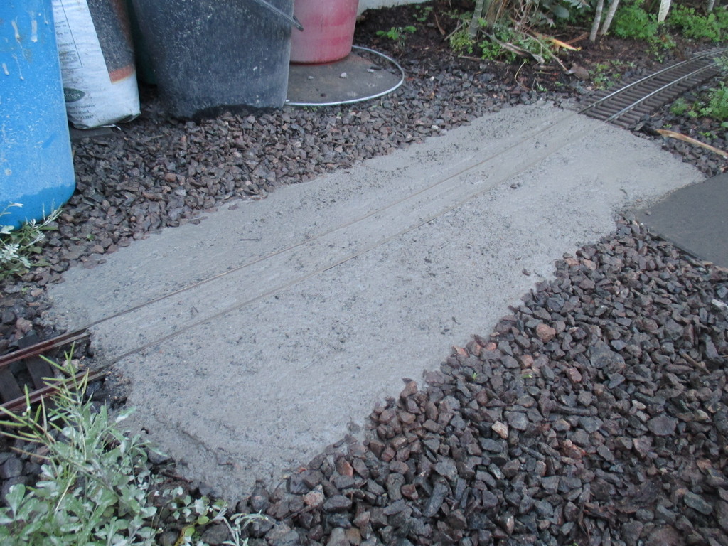

Once the crossings had turned "green", flangeways were carved with a screwdriver. The edges of each crossing were straightened, and the surfaces of the second two smoothed, somewhat. During mixing, I'd forgotten to add some brown oxide to tone down the starkness, so I thought I'd try mixing some oxide with water and brushed it over the partially-set concrete. Weather or not that works, remains to be seen.
Just to see how it looks, some crusher dust was spread over a short section. Looks great, but certainly too well-maintained in appearance. Will pack this lot down a bit, paint the rails, then apply the "proper" ballast mix, in time.

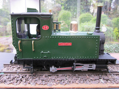

I have a bashed Stainz on the PLR. As has been said already, they are more or less bullet-proof.

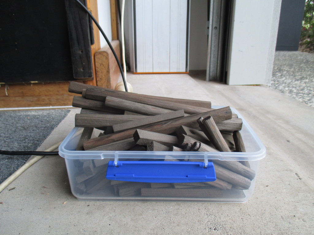

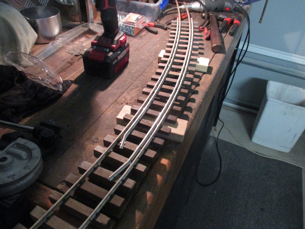

04/08/2020

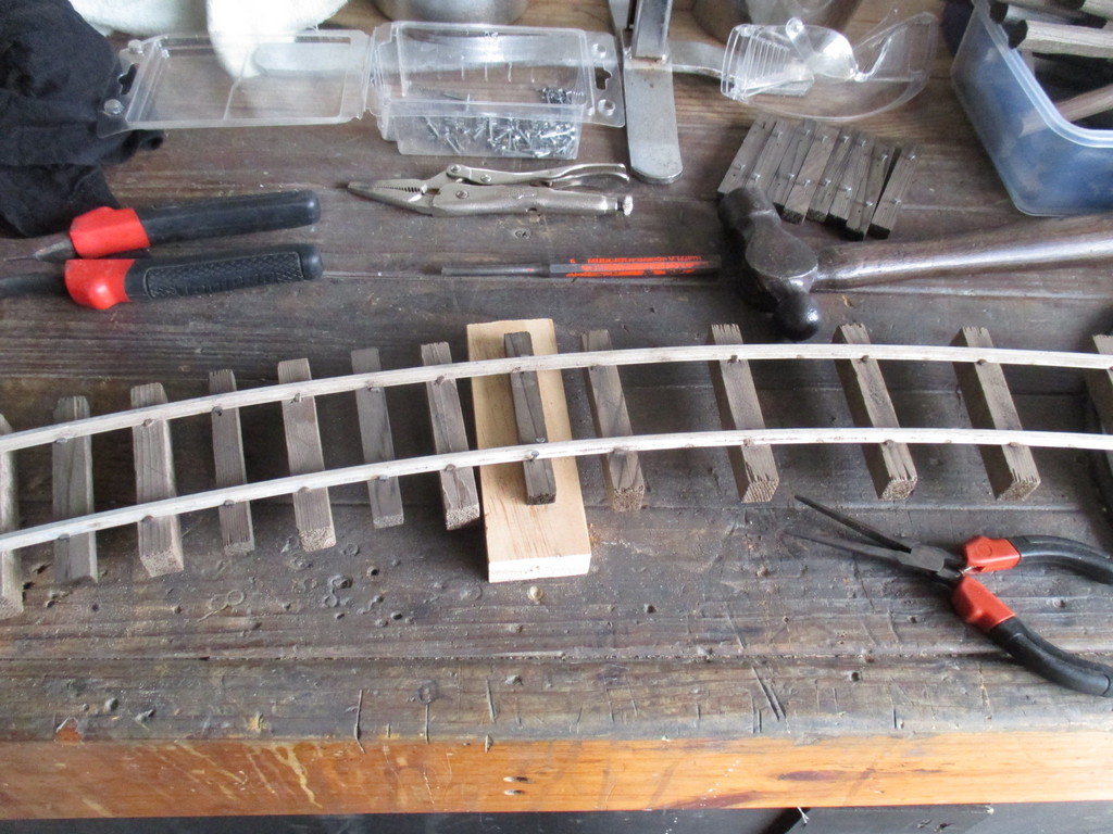

Whilst the bridge parts soak in vinegar, the navvies press on with laying track. I find the job painful and exhausting enough, so a cheap mirror from evilbay is a lifesaver for laying track. A great way to find flaws in the alignment as one goes along, that are often otherwise invisible from the usual viewing angles. I can't recommend it enough.
07/08/20
The bridge parts took far longer to stain than expected. The piles and to a lesser extent, the stringers, were somewhat resistant to the stain.
There's a few virgin-wood-coloured streaks in these components, but they don't look awful and will further fade in time.

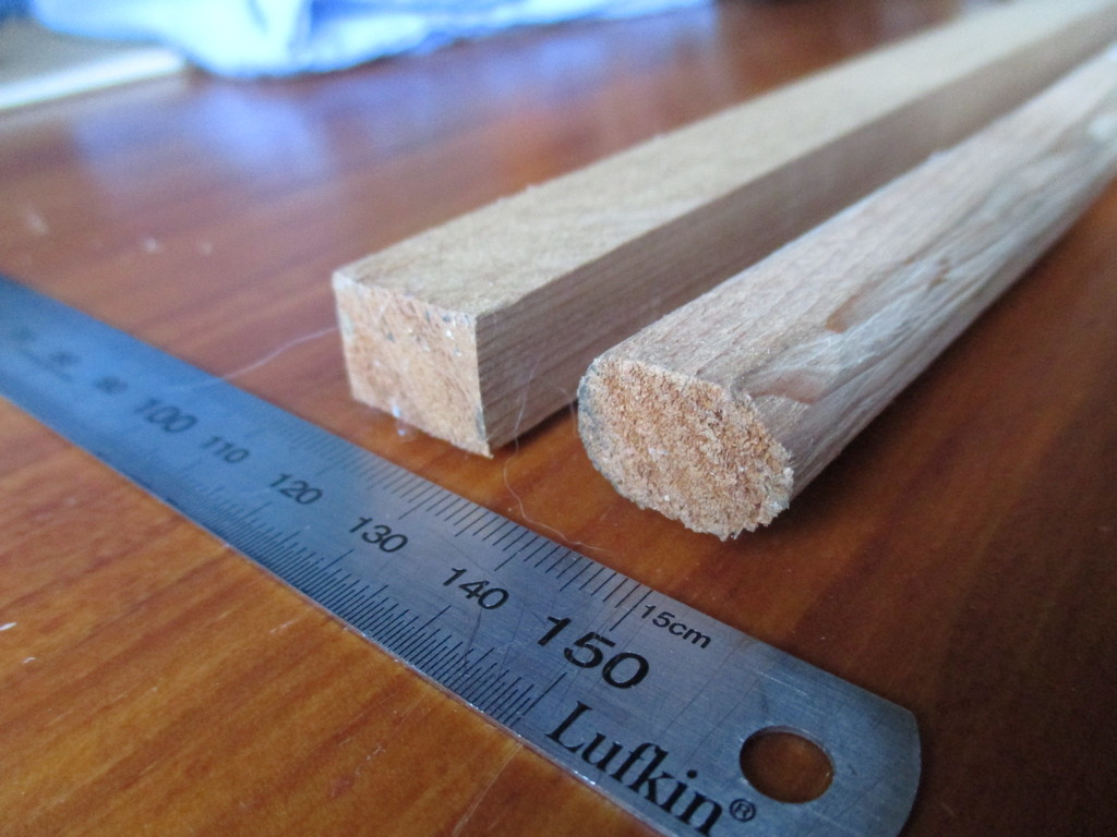

When I ripped down cedar boards to make sleepers, I had only an 11" table saw - which was of course too large to safely split the sleepers to a scale-ish depth. So the depth of my sleepers were the full 18mm thickness of the boards I'd used. I can get away with that when ballasting track, but on bridges, I'm replacing the sleepers with spares, that have been split on my new 2" table saw. To maintain the gauge, alternating sleepers had their dogspikes cut away with the dremel. I was surprised at how well the newly distressed and stained sleepers, matched the originals that had been stored outdoors for two years.

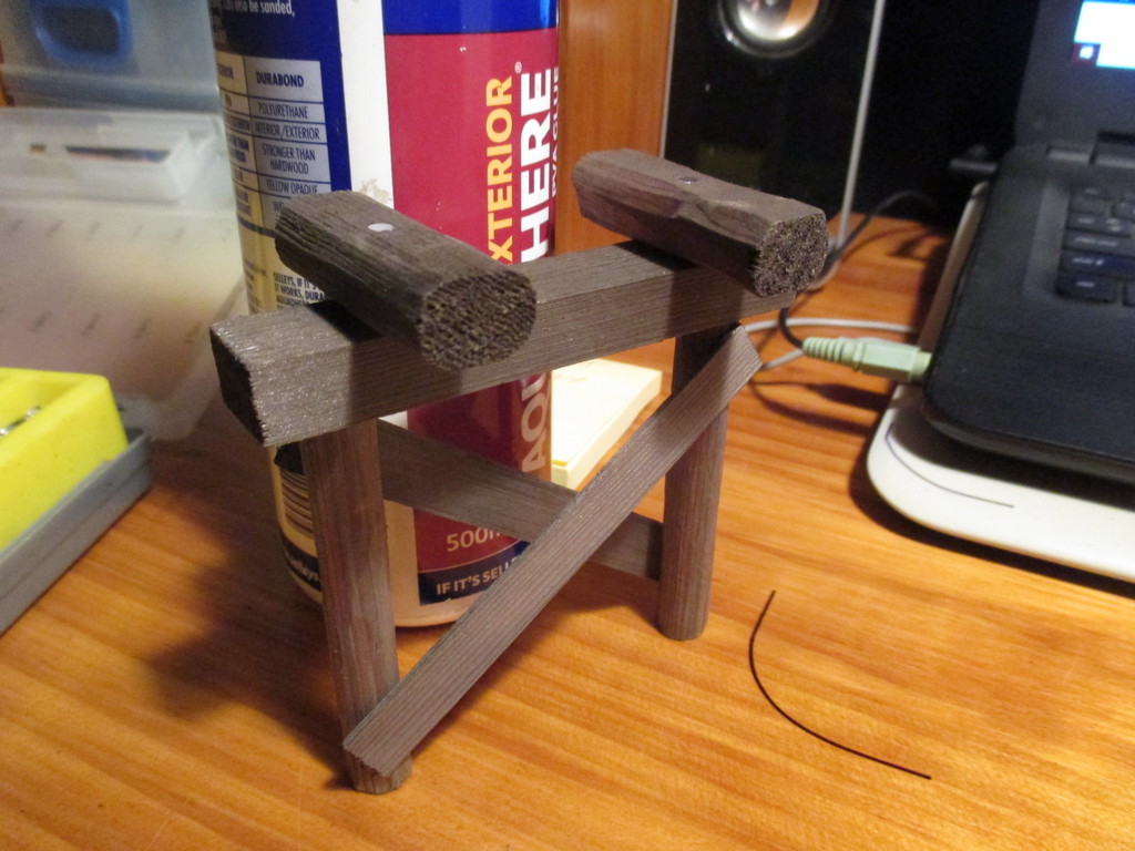

The bents have been assembled, and although I cut sway braces (the diagonal planks) for all four bents, I realised only one was going to be standing high enough over the terrain, to warrant the sways being fitted. After the glue had dried, the spacer blocks on top were drilled through, and panel nails fitted as reinforcement.

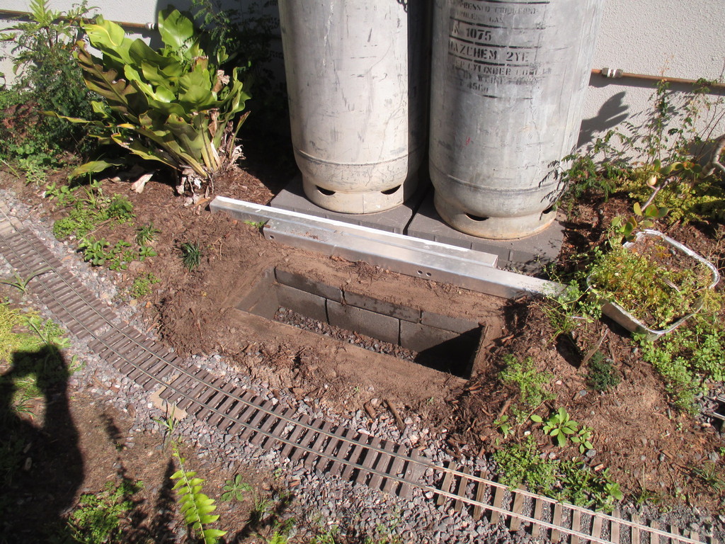

Gas man's coming to change the bottles tomorrow, so out came the planter box from it's brick-and-gravel socket.
These bottles only need changing 3-4 times a year - the bloke's doing them as I write this on the 12th, and he doesn't seem to be having any trouble with the setup. I was going to make a nicer-looking portable one-piece ramp with this marine ply, but I might just keep plonking it down like this.

Forgot to consider abutments, but had some spare sleepers. These were epoxied to a piece of aluminium, using the traditional mixing stick/spatula.
I knew I had a reason to keep that annoying bundle of short rail offcuts.
Prototype sway braces are attached with bolts. Before realising I only need sways on one bent, I'd cobbled together enough dummy nuts/bolts for all four..
I'm resisting the urge to buy nut/bolt/washer castings here, because if I start now, I'd have a higher standard to maintain, and never stop using them - NBWs are great, but in my hands they'd become a real money pit. Not to mention all the inevitable hold-ups when such popular items are out of stock.
Mark my words though - I will cave one day.
Using the bents as a guide for the stringers' spacing. Each stringer had been marked with a letter, to ensure each piece ends up in the right place. Firebricks weigh the parts down overnight.
These bricks actually came from a Perry 0-6-2T, that had been converted to diesel-firing, and ran at a theme park. It was donated to the Woodford Railway where I work, in 2014. It's been converted back to wood/coal, so with no need for these firebricks, I took some home, where they see plenty of use.
11/08/20

I like that mirror idea, use it myself. It's good to see nicely laid track, level and with smooth curves. Really makes for trouble free running later on.

Poor old screwdrivers, they occasionally get used for their intended purpose as well. I keep saying to myself every time I pick one up, "really shouldn't be using this" but I do.

Aaron, looking good, I too think the mirror is a great idea, and as for the screwdriver, I have a box of coffee stirrers that do just the job, for this type of thing
