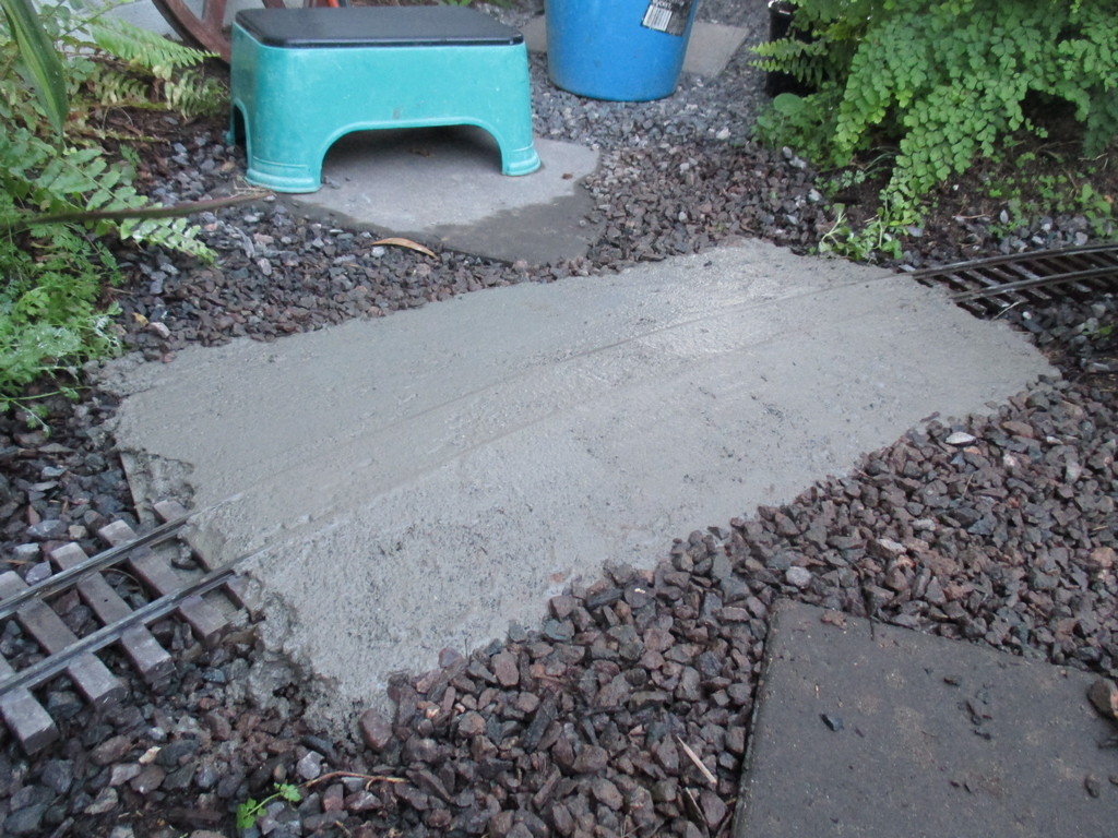

One of the gas bottles is about empty, so I switched to the other bottle, and we'll have to order a replacement for the first, soon. In readiness for that, the crossings have all been concreted. In the initial batch of concrete, I used leftover gravel from the pathway, which was unsurprisingly too coarse for use between the rails. That was dumped elsewhere as fill, and a new batch mixed using crusher dust instead. The first crossing turned out very nicely. We'll see how it holds up once cured..
The second was awful. A new batch was mixed each time, and for whatever reason, this was the best surface finish I could manage.
The third came out somewhat better.
31/07/20
Once the crossings had turned "green", flangeways were carved with a screwdriver. The edges of each crossing were straightened, and the surfaces of the second two smoothed, somewhat. During mixing, I'd forgotten to add some brown oxide to tone down the starkness, so I thought I'd try mixing some oxide with water and brushed it over the partially-set concrete. Weather or not that works, remains to be seen.
Just to see how it looks, some crusher dust was spread over a short section. Looks great, but certainly too well-maintained in appearance. Will pack this lot down a bit, paint the rails, then apply the "proper" ballast mix, in time.
