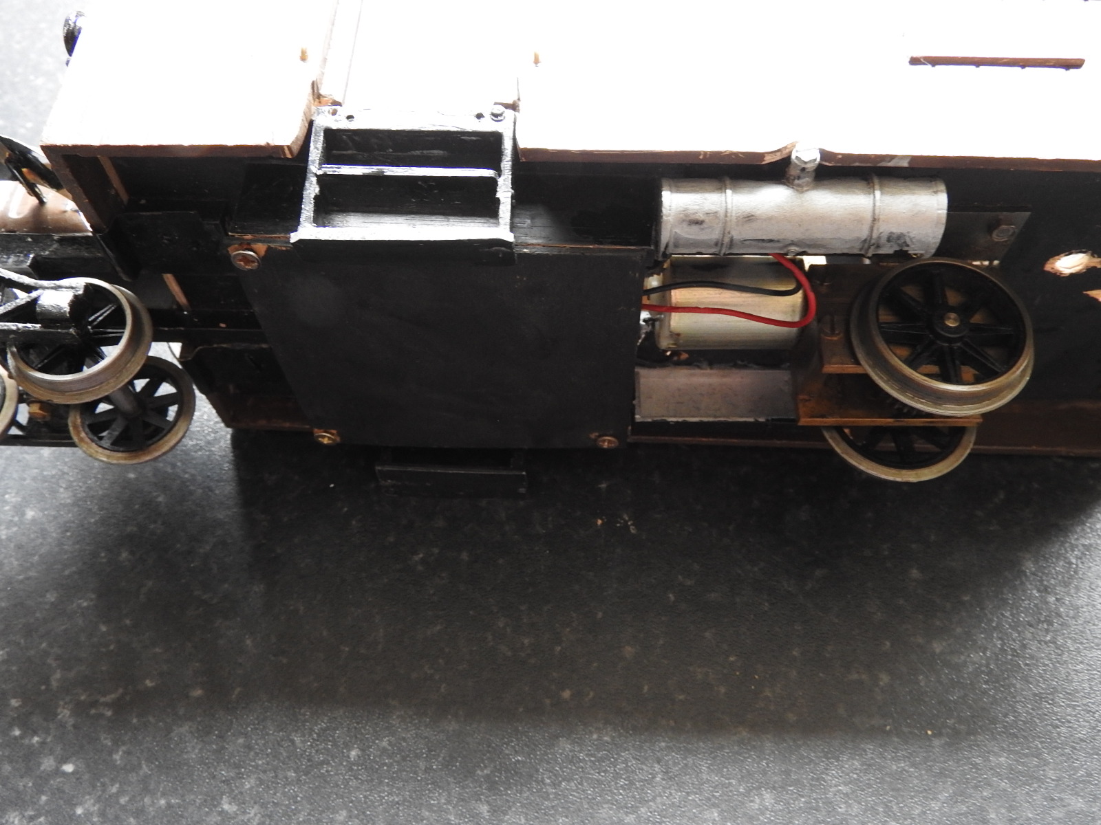

Something for this Steve.
Cranks wouldn't be needed really, just the ability to move like front and rear bogies. Yes the ones I have seen are all with the motor pointing up. I want to replace the one in my Railcar with a power bogie. I would be using the motor as is, so it's a question of if it can be done.... :thumbright:
Re: A bit of time in the shed
Posted: Wed Jul 17, 2019 3:02 pm
by -steves-
FWLR wrote: Wed Jul 17, 2019 8:04 am Something for this Steve.
I would think anything is possible, but for something that specific I would need the entire railcar at hand to measure and see what would fit. A shame you are not closer or you could have popped over and we could have seen if we could have made something to fit.
What is wrong with the one that's in it?

by FWLR
-steves- wrote: Wed Jul 17, 2019 3:02 pm
Well apparently the wheelbase on the Railcar is a bit to long and it was suggested to try a powered bogie to try and get it to run on curves, it at the moment only needs to see a curve and it starts getting nervous..... :lol: :lol:
Not to worry mate, I will perceive with it and see what I can come up with. Thanks anyway... :thumbright: :thumbright:
