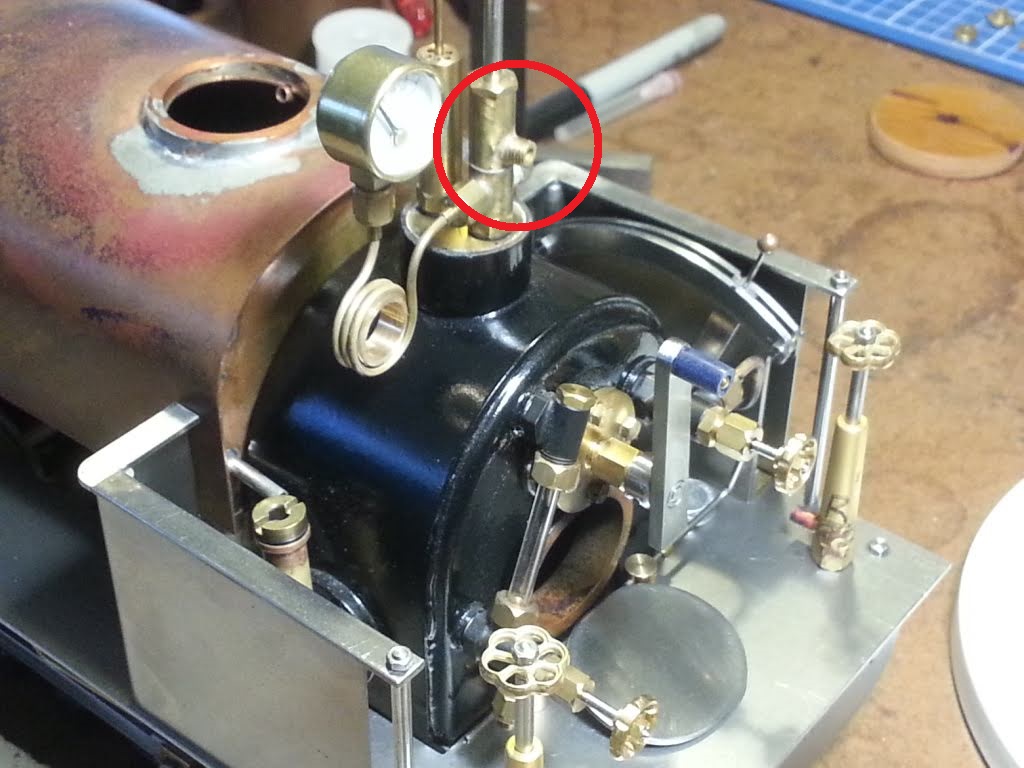

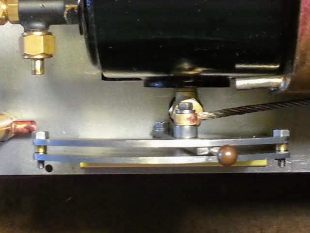

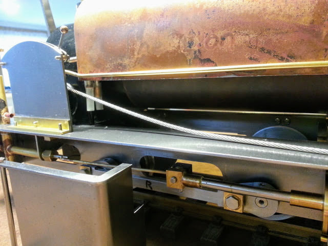

Just as Stephen King linked the novels "Delores Claiborne" and "Gerald's Game" I have linked the live diesel and this loco by using a 3/16" bronze ball on a control lever
The blower pipe needed a gentle detour out of the way of the mechanism...

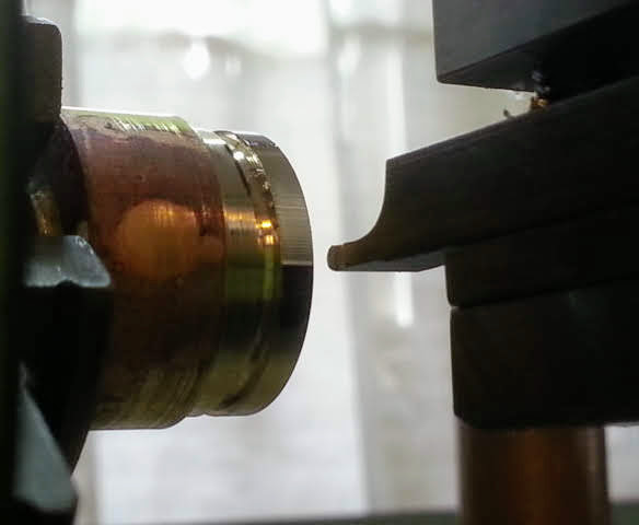

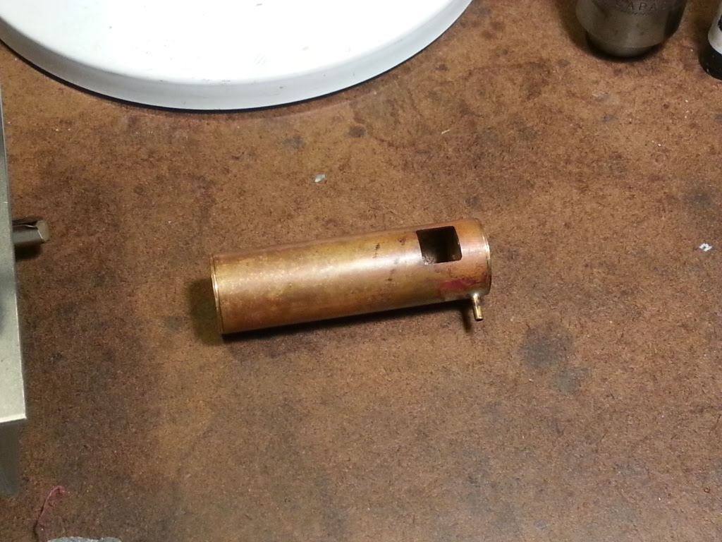

"An engine isn't an engine without a whistle". So I'm starting on the whistle. Being time rich, I love using up scraps of material. I had a nice piece of brass just right for the whistle end caps, but far too short to chuck. So I drilled it though and sliver brazed it to a long piece of brass rod. Instead of filing a flat to channel steam over the mouth of the whistle tube I'm racking a lathe tool on its side as per the picture indexing the chuck by hand. I used this method on the large De Winton's whistle.
