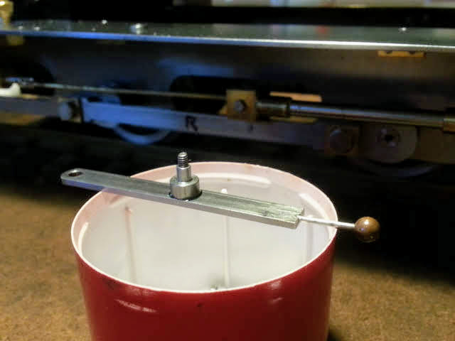

Just as Stephen King linked the novels "Delores Claiborne" and "Gerald's Game" I have linked the live diesel and this loco by using a 3/16" bronze ball on a control lever :D
The blower pipe needed a gentle detour out of the way of the mechanism...

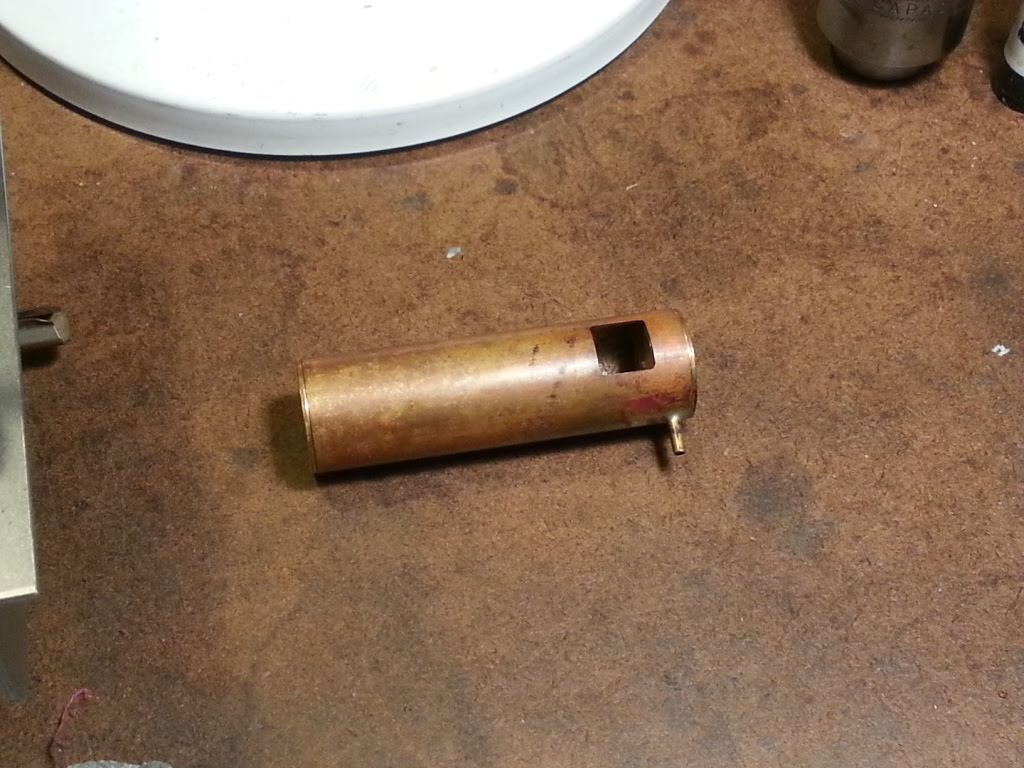

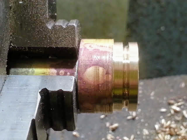

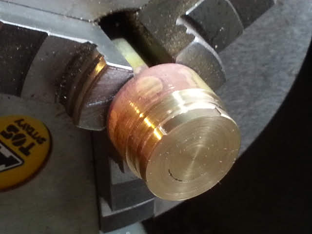

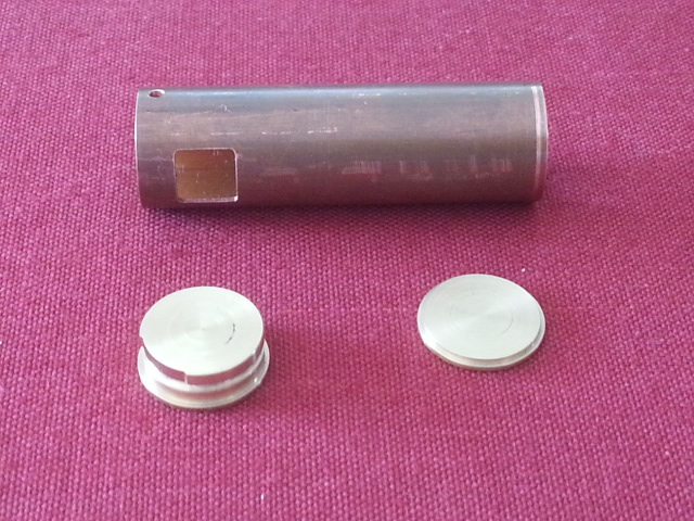

"An engine isn't an engine without a whistle". So I'm starting on the whistle. Being time rich, I love using up scraps of material. I had a nice piece of brass just right for the whistle end caps, but far too short to chuck. So I drilled it though and sliver brazed it to a long piece of brass rod. Instead of filing a flat to channel steam over the mouth of the whistle tube I'm racking a lathe tool on its side as per the picture indexing the chuck by hand. I used this method on the large De Winton's whistle.
Best wishes,
Dave

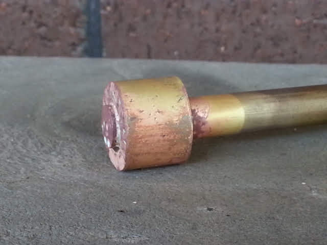

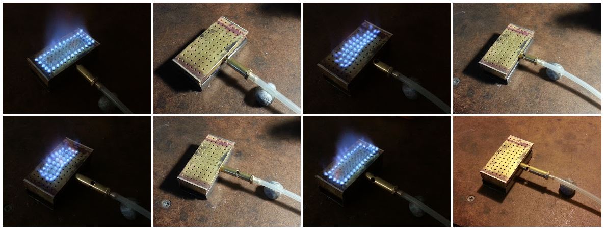

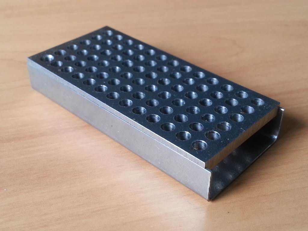

Getting back in to it now! I've been working on a gas burner to slot-in instead of the grate. Had some success in the end lighting it inside the firebox.
Burner without end caps

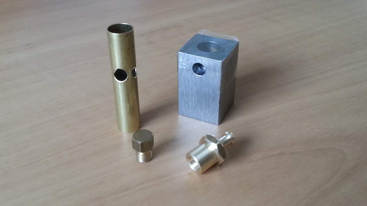

When I made the steam powered diesel I made a nifty jig for drilling the 4 cross holes in the thin tube, I copied the jet holder too
Best wishes,
Dave

Thank you lads. When I built the steam diesel I bought a wide selection of gas jets that are spare parts for camping stoves from our local big box store. They range from 0.11mm to 0.23mm, the steam diesel is using the 0.23mm jets
Yesterday I was testing this new burner with a 0.17mm jet and it wouldn't light at all outside. I tried it in the firebox and got a great big backfire :bom: (Mrs B thought it was from out on the street) I swapped the jet for the 0.11mm and it lit easily as seen on the video.
Todays testing the burner with this same jet outside of the firebox showed some interesting results. It doesn't matter how far in the burner the tube is, the result is the same. But when I flipped the burner tube around to use the wrong end for the jet holder the flame was much better. For this burner having the entrainment holes further than usual from the jet helped.
Burner tests.JPG (97.67 KiB) Viewed 12507 times
Best wishes,
Dave

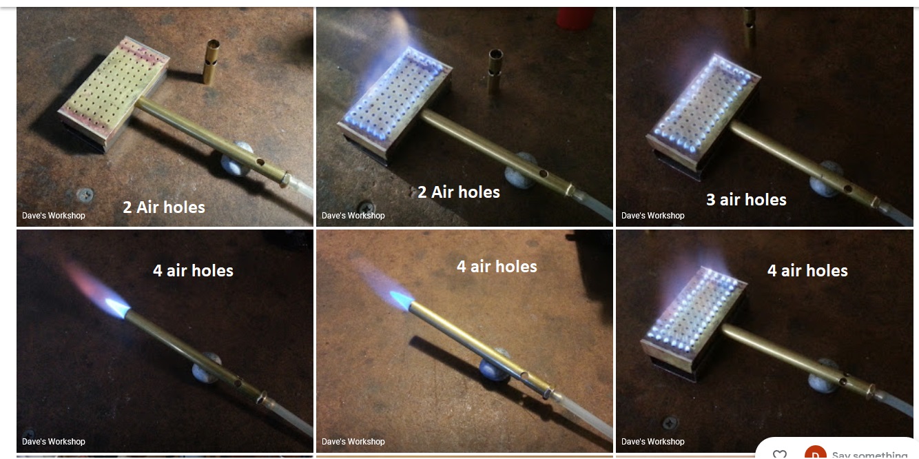

Well, what an interesting subject this is.
I thought I'd have some fun with an overly long gas tube, first with 2 air holes then 3 then 4. With 2 air holes the gas tube made a great bunsen burner, but with all 4 only a small flame could be maintained before it got blown out. The long tube gave the best gas burner burn too.
Best wishes,
Dave

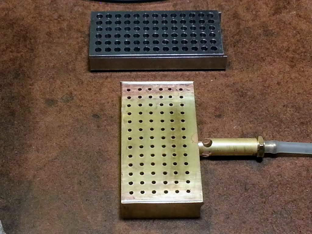

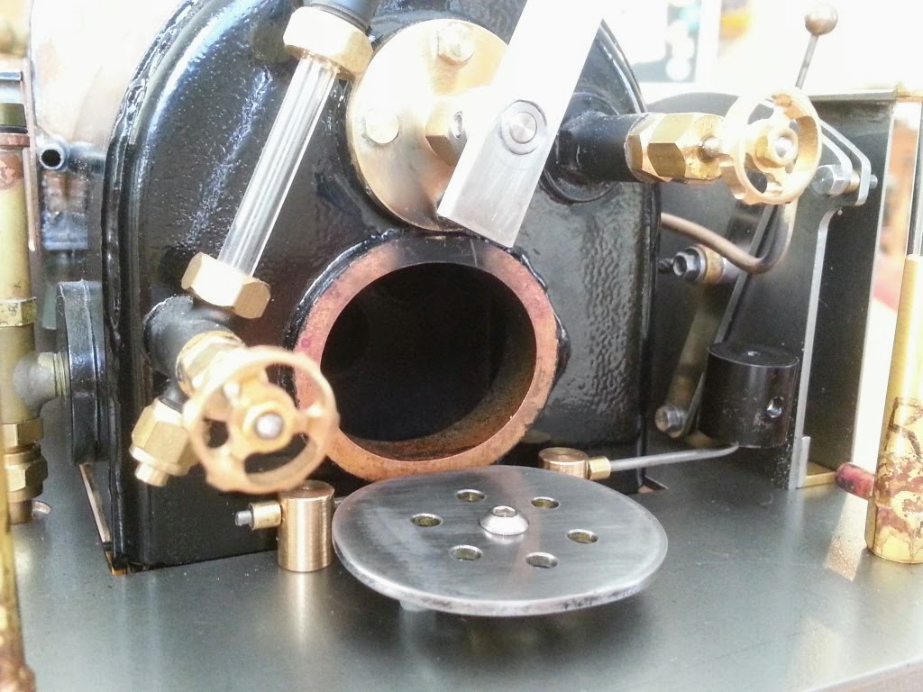

Here's one I prepared earlier, the rosebud grate and ash pan. I used the grate as a drilling jig for the gas burner. There was no way I was going to drill those holes the hard way again :D
Best wishes,
Dave

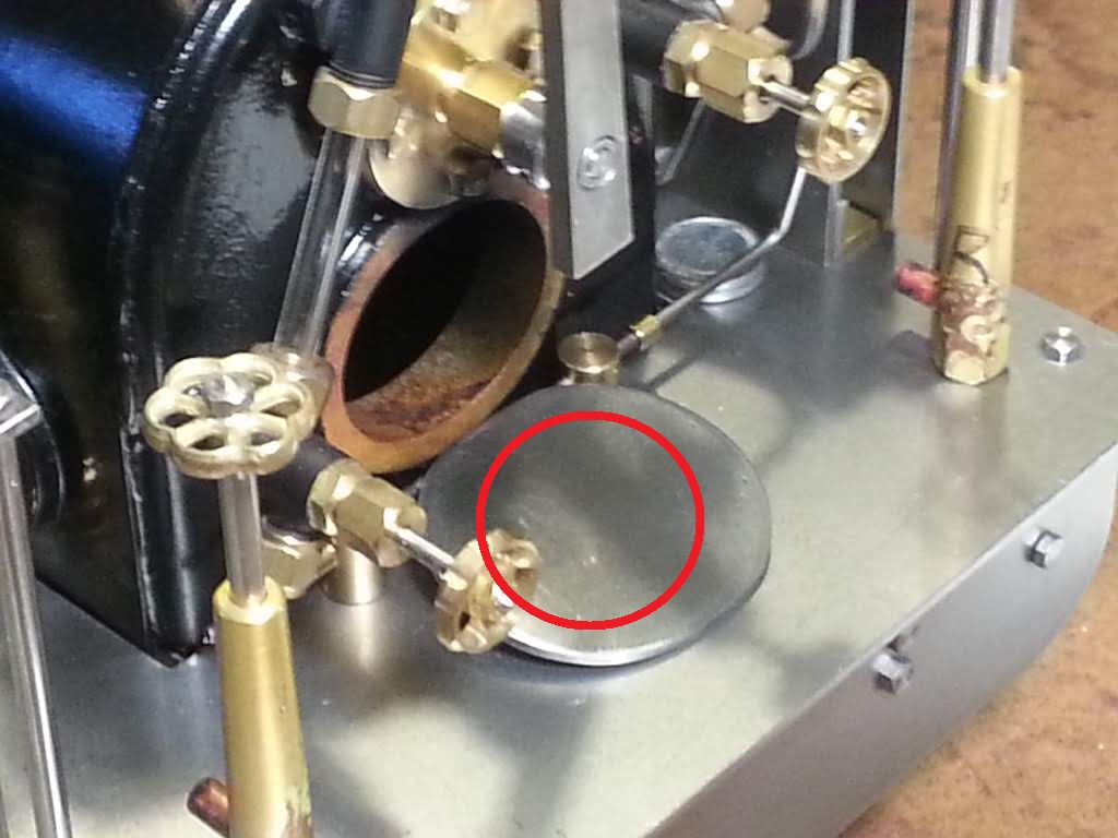

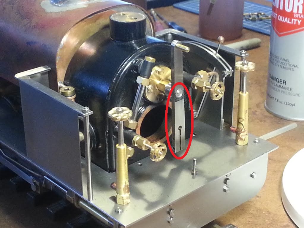

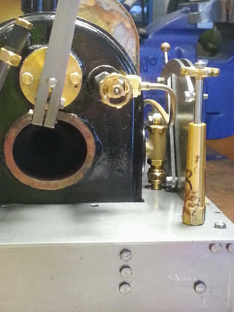

Post by dewintondave » Wed Jul 17, 2019 8:14 am
What I've done
Recently I've reduced the length of the regulator handle, it was far too long
What I've got to do
Finish the firebox door
Mount the whistle
Plumb-in the whistle
Make mountings to secure the grate and gas burner
Best wishes,
Dave

Re: Wild Rose ~ Quarry Hunslet
Post by tom_tom_go » Wed Jul 17, 2019 9:04 am
Regulator handle looks much better, I didn't realise it was the large before.
The cab layout is very organised, I like it.
