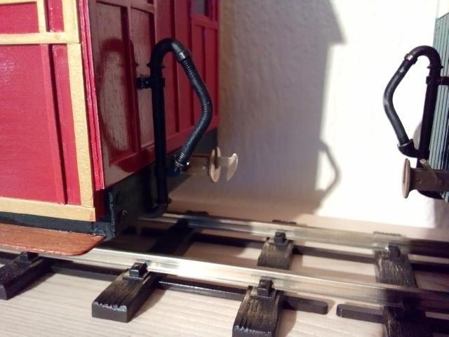

The hoop over the horn of the chopper is the usual solution to the problem of them jumping and uncoupling. The Norwegians favour a cast iron ball on a length of chain, which must be pretty effective as they only seem to use a single safety chain. I would imagine a short length of fine-ish chain with a decent size round fishing weight on the end would work, but I have not tried it yet. Reasonably even track and consistent buffer heights are more important to keeping things coupled together. You would need to put the chain through the hole where you had taken the south end chopper off. I remove the south end hooks on all my rolling stock as I find I have less trouble coupling and uncoupling if there is only one hook per vehicle with which to contend.

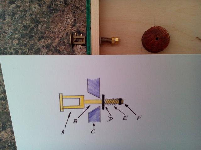

David, those Slater's are great looking couplers. And I like the "locking" hoop.
Question: I noticed you mounted them so that just the outer shank is showing, only about 12mm or so. But the rest of the shank is quite long and the threaded portion is only about the last 7 or 8mm on the rounded shank portion. How do you mount them? Do they come with a bracket to attach behind the buffer? How did you do the square hole?
Thanks.
Greg
Thanks.
Greg
- River Lin
- Posts: 411
- Location: Leicester
Hi Greg.
To answer your questions.
Above is a coupling on a coach with a drawing to make things clearer how I am doing it.
A - coupling head.
B - square portion on shift.
C - coach body with hole widened to the outside.
D - washer. Size to slide along round threaded portion of shaft but will not go onto square section of shaft. This washer is to stop the shaft sliding out of the coach body. This washer is not included in the kit.
E - spring on the round, threaded portion of shift.
F - nut to retain spring. I added a second as a locknut.
No bracket is included to attach the coupling to the underside of the coach.
I had a small hole drilled already for a buffer coupling so I squared this hole with a square needle file to accept the square shaft and then angled the hole width ways to allow the coupling to swing horizontally.

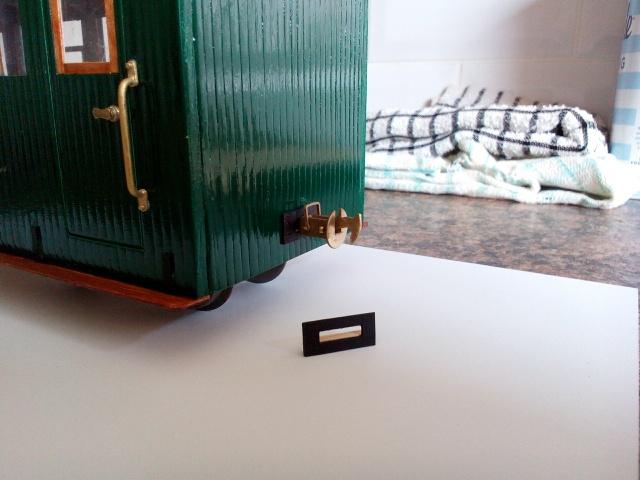

Here is a photo with the coupling in place with a rectangular plywood plate added to neaten up the look of the hole. I think it looks like a backing plate for the coupling. I might make some tougher plates in brass at a later date.
Sorry to ramble on but hope this helps to show how I fitted the couplings. There may be other methods and I might make modifications in the future.
David.
