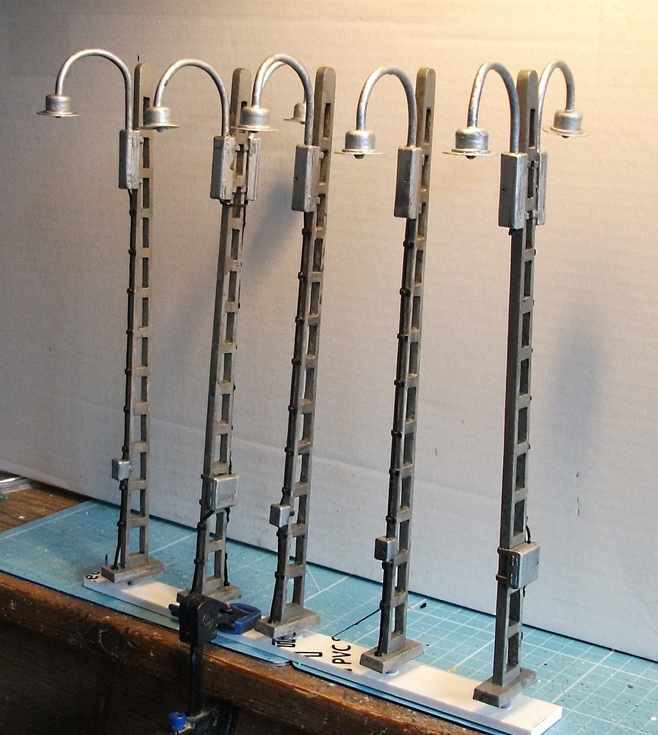

I’ve just finished the varnishing of some lamp-posts (made from foamboard, plasticard and bits of electrical wire), which will be going to the Railway tomorrow.
I’m not sure exactly where each one will be positioned yet, and if they should be left out or find a place for a box in the shed.
J0hn

FBGR wrote: Mon Aug 27, 2018 3:22 pm I’ve just finished the varnishing of some lamp-posts (made from foamboard, plasticard and bits of electrical wire), which will be going to the Railway tomorrow.
J0hn, Impressive lamps, well done. I'm not sure what the posts are made of, are they foamboard? If so, I think I'd be reluctant to leave them out if they were mine. I made some fence posts from foamboard and they didn't last very long when the local cats and other wildlife came visiting.

by FBGR
Thank you Philip,
The posts are made from 5mm thick foamboard, and the bottoms are reinforced with a 20mm panel pin (in a pilot hole). I have recently been using foamboard for post and rail fences, with 5 x 5 posts with panel pin up them, and these stay out and, so far, have come to no harm. For the fence posts, the foamboard, being a little flexible, seems to be better than using plasticard at taking minor knocks in exposed locations.
J0hn

by IanC
Great looking lamps. They're going to look good lit up.

by FBGR
Sorry Ian, they don’t actually light up, and the wires are purely cosmetic.
I have enough trouble with doing the electrics on the locomotives.
J0hn

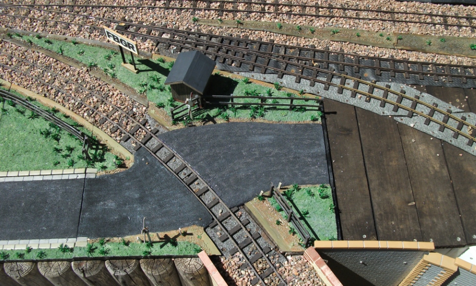

Another panel of the road has been done. The original intension was to have a skew level crossing over the siding, but now the road has been bent round to go off the edge of the timber board and onto the plastic decking.
The plastic decking is somewhat lower than the timber deck, with the track packed up to keep it level. This should provide a little bit more flexibility with regard to the scenery levels, so the step between the levels is next to be sorted.
We acquired a VW van recently, as shown. It is 1:24 scale. There doesn’t seem to be much in the way of vehicles available suitable for our date and location – racing cars and modern lorries just look wrong.
J0hn

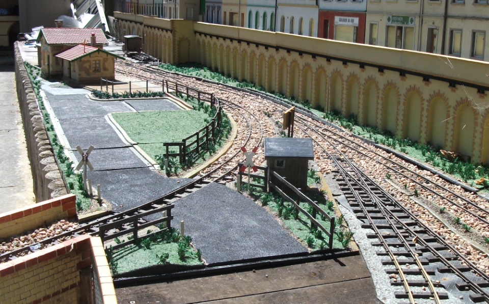

I have been slowly progressing, adding more bits to the road/grass/fence panels between the running line and the siding. I have now reached the bridge, so I thought I had better do an update.
This is the last portion fitted coming up to the bridge.
DSCF5237 cropped sharpened.jpg (207.3 KiB) Viewed 12163 times
And this is looking back from the bridge towards the Station area.
DSCF5240 sharpened.jpg (217.22 KiB) Viewed 12163 times

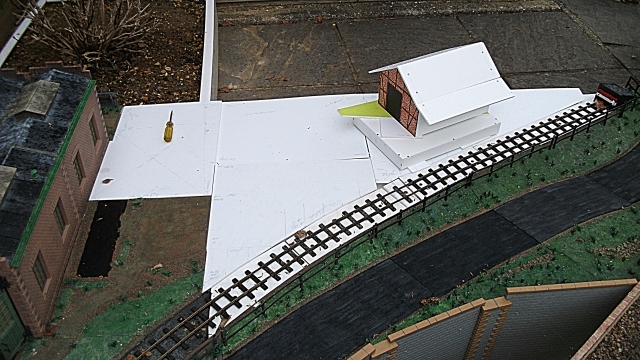

This is the sorting out the next lot of panels for the area between the siding and the loco shed.
DSCF5243 sharpened.jpg (197.11 KiB) Viewed 12163 times
I mocked up a building and platform to see how it all fits together and check sizes. The mock-ups were made in foam PVC board, screwed together. The structures will be made in plasticard however, as I have found that the foam pvc moves and shrinks in sunlight.
