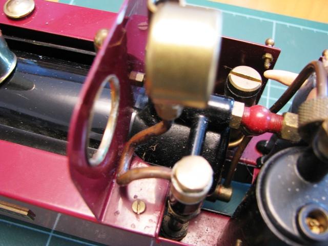

Here is the pressure gauge fitted to my IP Jane.
I had some difficulty establishing the thread size for the plug fitted to the top of the sight glass assembly. It is 1/4" x 40ME and this is the boiler made by Cheddar Models for IP Engineering. The later IP Jane's were fitted with a slightly different boiler but it has the same size fitting.
I do not like the syphon tube that Dream Steam produce, and of course it could foul the pipework for the displacement lubricator on the other side of the boiler. I got my banjo bolt & syphon tube off eBay, and I had RWM make me one to fit the PPS boiler so that I can use the same pressure gauge on both locos.
Chris Cairns.
