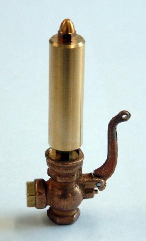

PPS Steam Whistle - Doug I assume you mean the one that PPS fitted as an option to the PPS De Winton for a short period, and sold them separately.
Well the good news is it is not a PPS made whistle, it is a PM Research steam whistle so you can either buy it from a USA trader, with the risk of being stung for import duty and the Royal Mail admin fee, or buy it from Forest Classics.

PPS Whistle - I was under the impression it was for te horizontal locos too. It explained why PPS sold their copper boilers with two extra plugs - one was for the pressure gauge and syphon and the other supposedly for the connection to this whistle.
Roy has modified his Janet boilers so now that they only have the one plug for the pressure gauge, but as I bought mine in Dec 2010 from PPS, my engine has two plugs. I'm sort of interested as to whether I might be able to find the whistle and the appropriate connecting pipe but then lies the question - where were they supposed to be situated on a Janet/mamod loco?
