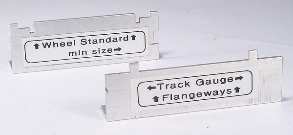

I've always used check gauges in my HO modelling and when I moved to large scale I made up a set of wheel and track checking gauges so I can check every wheelset before it runs. Until I have a track of my own, the track gauge is used to check the turnouts on a layout before I decide whether I can run on it or not.
These were milled from some bits of aluminium angle, but they aren't too difficult to make with hand tools if you are careful about marking out.
