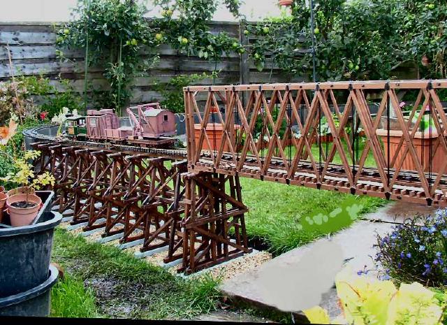

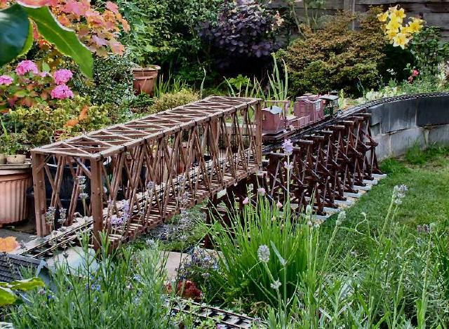

Hi,
I have just about finished what has been taking virtually all of my time recently! I now have a 6 foot trestle, and at one end of that a 4 foot Howe Truss bridge, These will with another aluminium bridge complete the extension.
It took rather a longer time than I anticipated but that is due to an excess of precipitation (even for the rainy Northwest!) that stopped play, as my large circular saw, that was the only thing to cut up the red cedar from and old greenhouse was being used for the 10 bent trestle and 2 bent bridge support at the end . The saw makes a great dwl of sawdust so I was using it outside in the garden; needless to say it was swiftly hidden in the shed when necessary.
The trestle is 6 feet long and the end has a pair for the Howe Truss to sit on. The bents are sat on a couple of layers of 8mm thick PVC foam sheet which is painted grey to represent concrete, and the whole thing has a bed of 10mm gravel, in a trench and a hidden soakaway underneath it: in today’s very heavy rain it worked perfectly – there was no surface water.
The Howe Truss bridge is made from my (lots of) 5mm PVC foam with tension rods from 2.4mm silicon bronze welding rods, sold in 1kg packs and I still have some left, it absorbed over a hundred brass nuts with half of those being soldered to the welding rods, the rest are glued on. Hidden underneath are a couple of square steel tubes from B&Q, that will provide some strength & stiffness. There are lots of fake scale nuts all over it that were individually added, having been made from plasticard and square tube with rod in the centre of the tube. It absorbed more than half a 750 ml can of paint.
Here are some photos of the pair, apologies for the mess in the garden: rain as usual is the main offender in not letting me tidy it up!
The little Porter is an LGB one with a scratch built tender with a couple of scratchbuilt wagons posed on the trestle.
Taken from the other side - the bridge has Hillman bridge clamps so it is instantly removable.

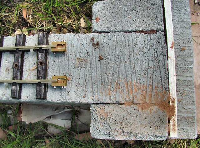

Here is my photo of them - they are fixed to the fixed track and the bridge fits into the wider section, there is a little spring loaded steel ball to continue the current through the bridge.
Ther result is an instantly removable bridge.
Mine came from Glendale Junction, they are available in both code 250 and code 332. In the Glendale site, have a look under products, then Hillman for them, they are selling them at £14.50 per pair.
They are also made by 'Splitjaw clamps'  as well, and the Garden Railway Centres shop in Cheltenham also sell them. Their presenty price is £13.50 a pair, and you would want 2 pair for a bridge

Ahhh now I see, had never heard of them before. May need something like that for my lift out bridge although no need for electrical continuity with mine, just the clamping action for alignment.

In that case what about making some locators like an upside down 'pi' symbol? To sit under the track and hold the ends in alignment.
Make them from black plasticard and that will assist in hiding them perhaps?
