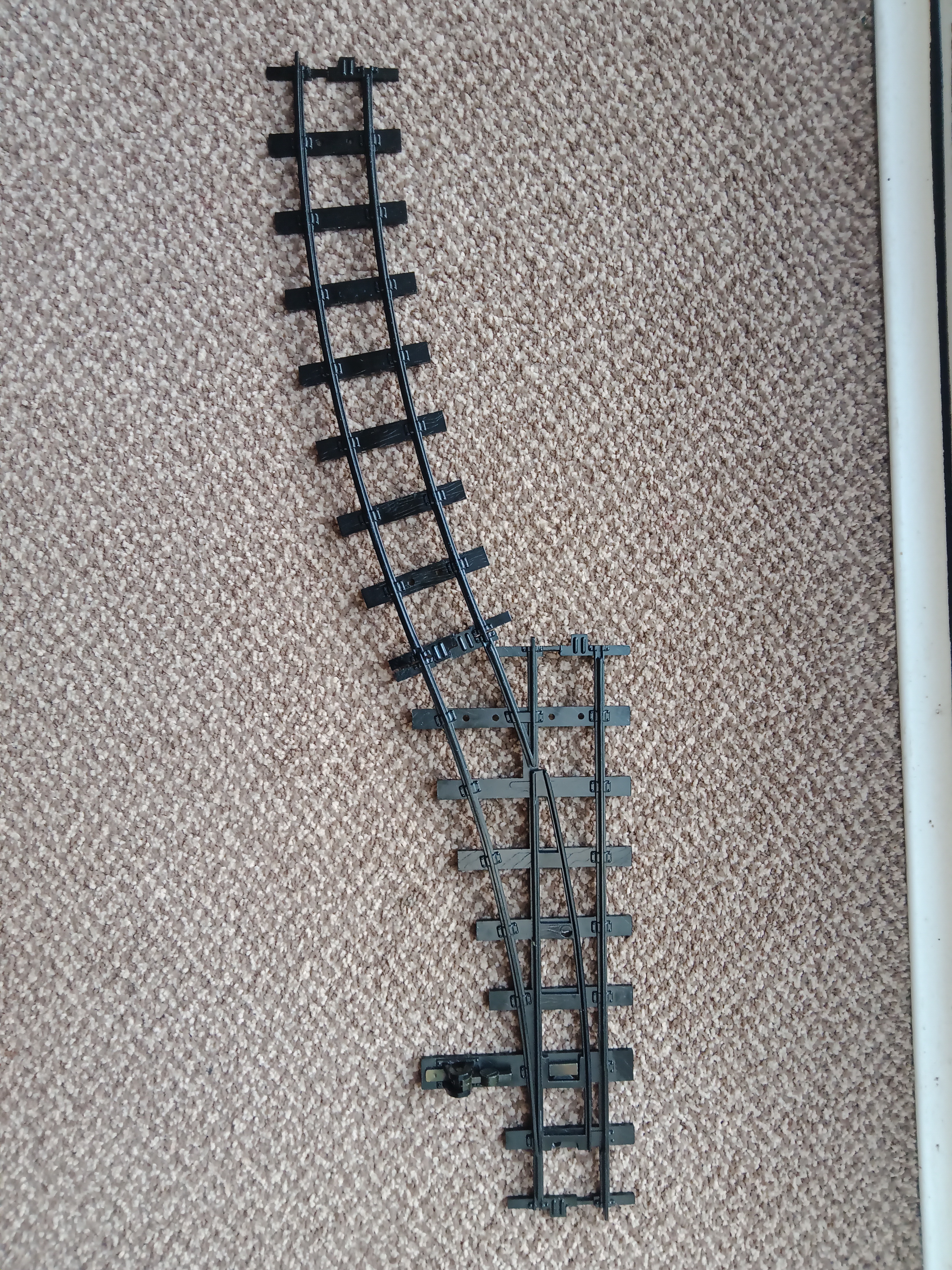

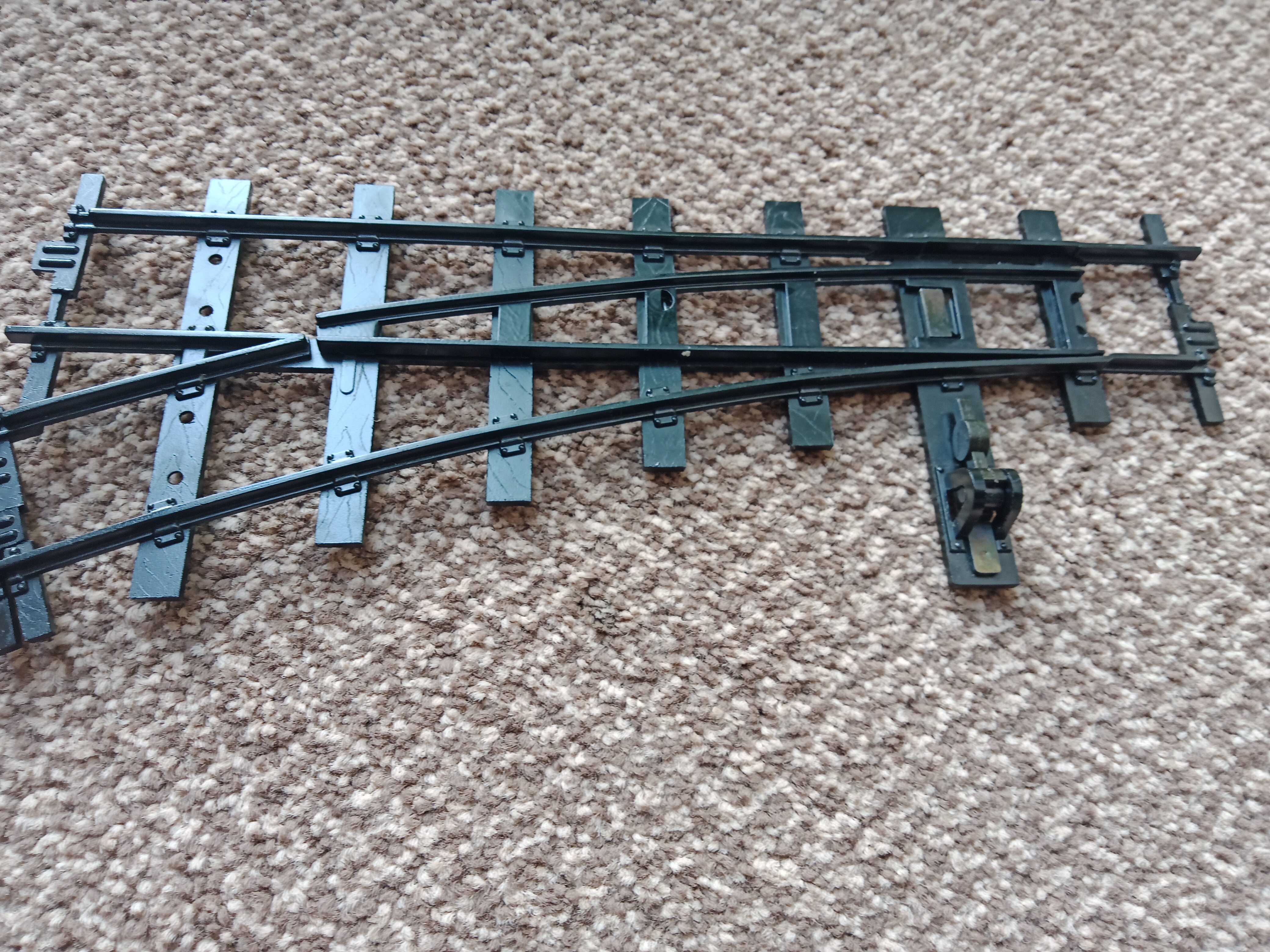

I've just bought one of their points (for £35) and a curved rail (for £7.30) with a view to using the on my revamped Copper Mine feeder.
They are cast in Mazak but it looks like the tie bar under the point is steel. Just wondered if anyone has had any experience of using them outdoors. I've emailed Dream Steam to find out about their suitability for outdoor use but not yet heard anything.

Just had this reply from Dream Steam
Good morning,
The MSS track is made from Mazac and can be left in the garden all year round without rusting.
