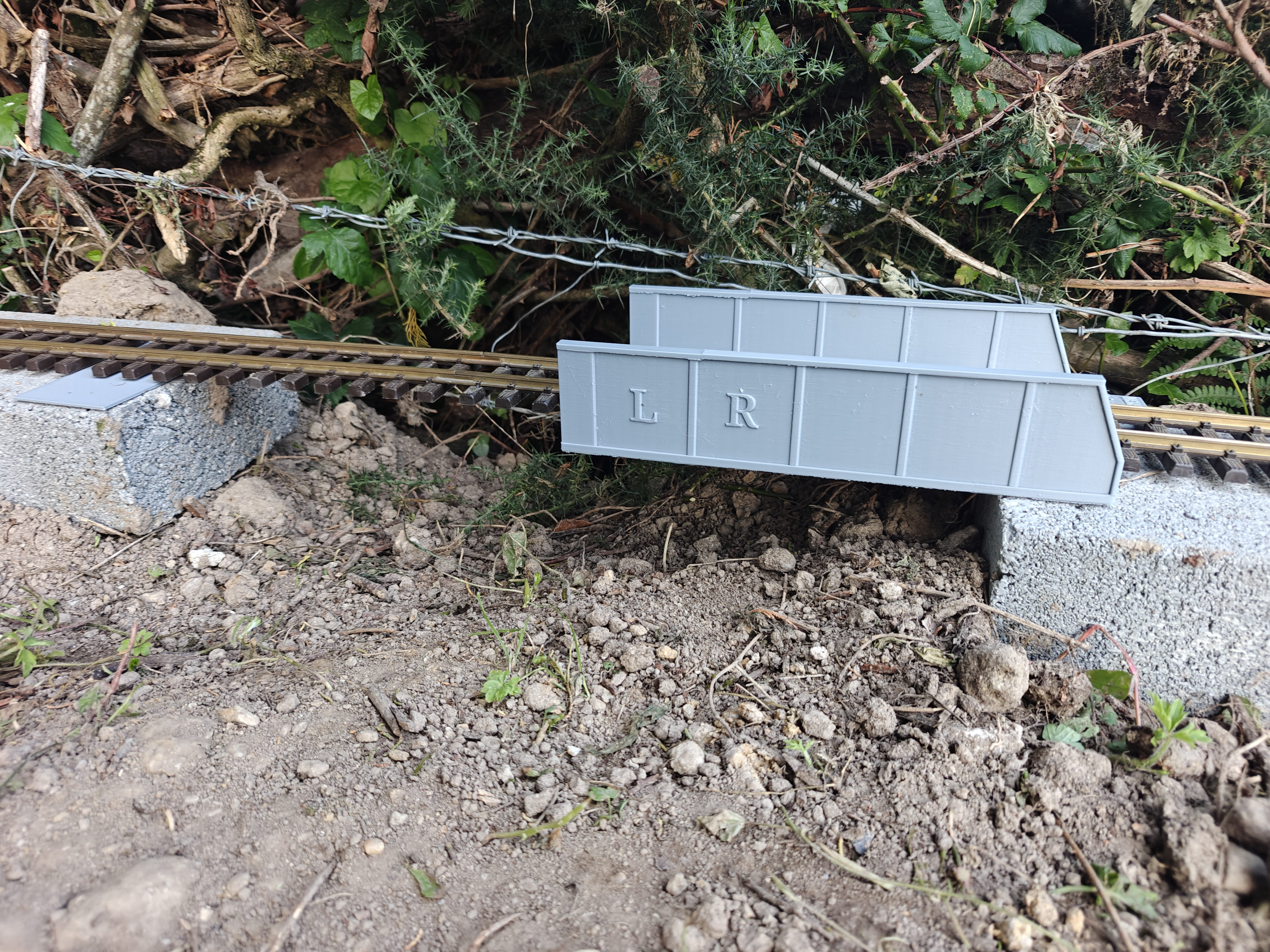

So today I bought twenty more bricks (it's the most I can fit in the boot of my saloon car!) and laid those this afternoon, taking care to lay them firmly so there will be no subsidence.
I had time to sit back and watch some trains go around! I apologise in advance of the high speeds of the trains as they had to deal with some sharp inclines on other parts of the loop I have yet to lay the track bed.
The gap in the track bed in the video is to put in a bridge which I am 3D printing as we speak a prototype in PLA to see what I like and dislike, I have to get some ASA later to print the finished product which will do better in the sun - Thanks to Trevor Thompson of this forum for the inspiration to get a proper 3D printer and see what I can do.

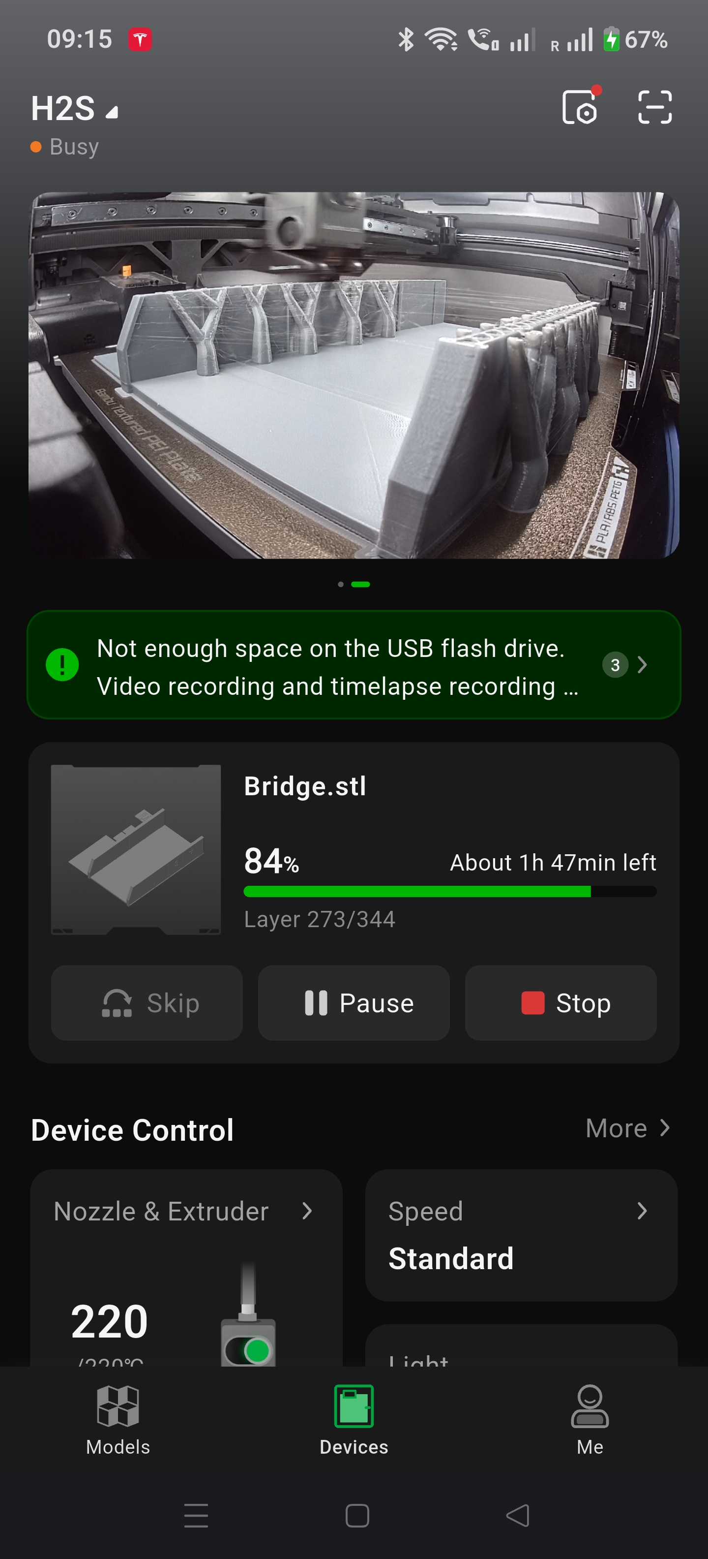

I have a Bambu Labs H2S, the inbuilt camera is going to prove very handy. I specifically picked this printer because of the large bed size for g scale and the enclosure to enable easy ASA printing as it needs a high temperature environment to set well. The printer was a used purchase at about half the current RRP with an AMS2 included.
Had some bed adhesion problems last night, wiped the bed down with warm soapy water and still problems. I took the bed downstairs and gave it a boiling water soapy wash. Seems to of cured the issues for now...

I had an incident with the 3D printer... the old filament broke off in the print head, I accidentally tore one of the ribbon cables so I have that on order now to replace, along with the new build plate. I am off travelling the end of the week so it'll be a couple of weeks before the next update on that I would say.
I relevelled the bed a whole load and it made no difference, but I do hope the new print bed fixes the issue once I have repaired the print head.

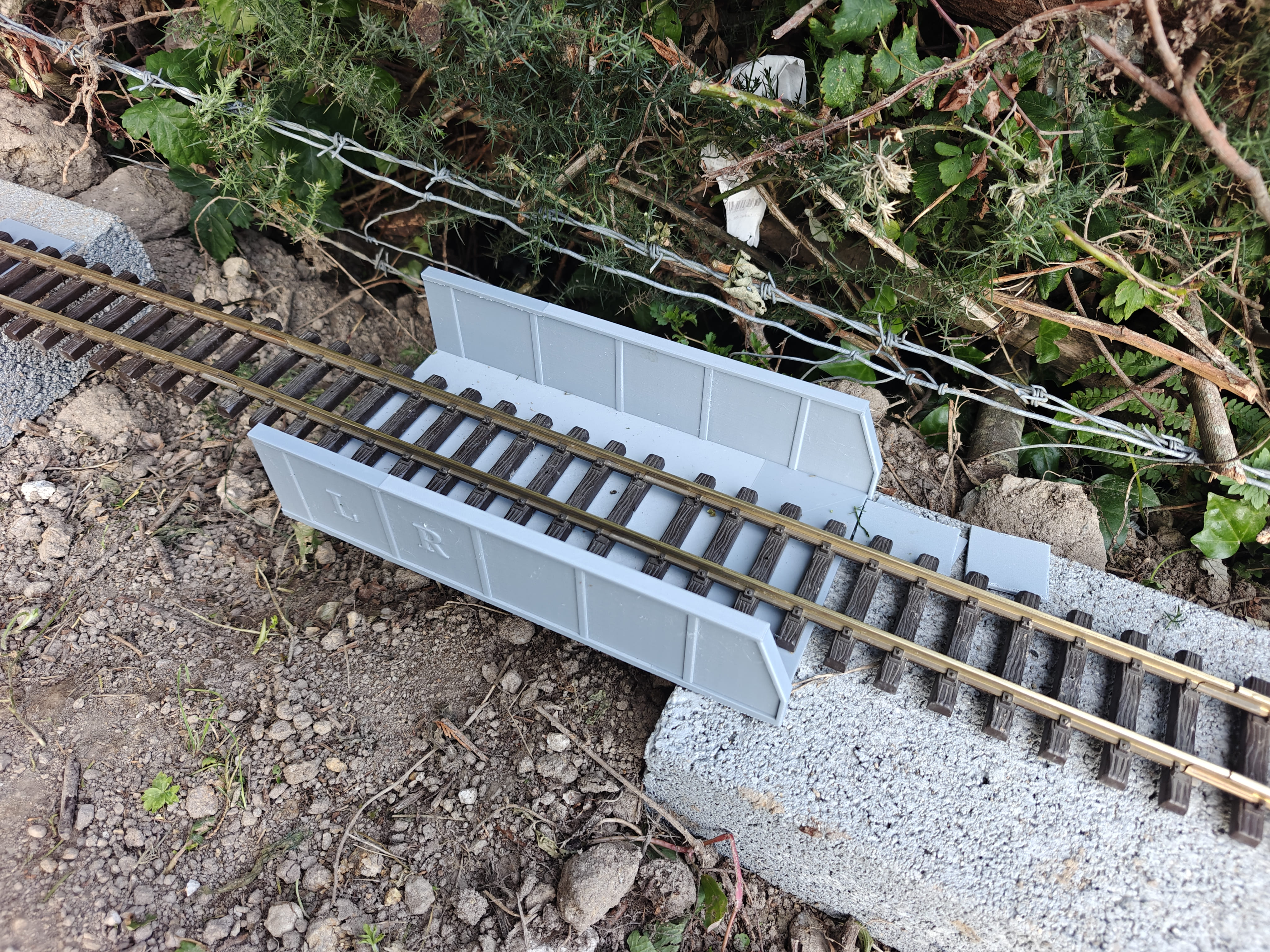

I took some videos yesterday of the loop as it currently sits, half 3d printed bridge in place as well. You can even see where the bed lost adhesion but the printed part was heavy enough to hold on just, but it's made an indentation...

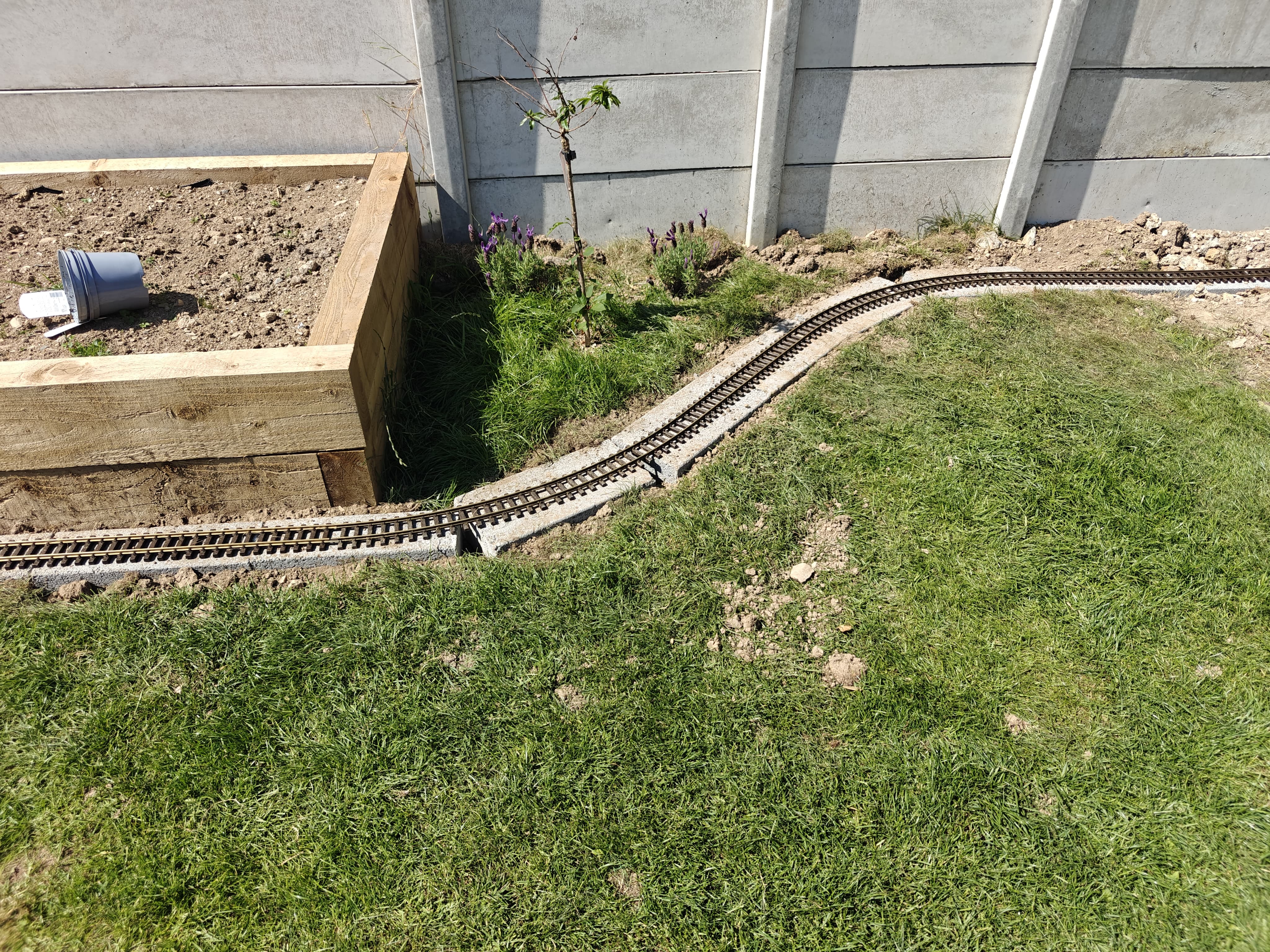

I got 40 more bricks and laid about 25 of them, mixing some narrower soap bar bricks with the larger ones.
The left over large bricks I shall use to make tunnel on the right hand side where the concrete fence finishes.
The plan for passing loops etc is to have it run through a shed near the house on the R2 corner, and immediately outside the shed have a passing loop and head shunt for a station.
The gaps on the curves in the brick I plan on filling with concrete later once I am happy with where everything is, then laying a suitable sharp edged ballast.

In other good news I have repaired the printer somewhat, new build plate and a new extruder sensor and it's printing like new again! I got it at half the price of a new one plus a free AMS2 Pro so it was still a brilliant deal. It came without the glass lid, which I have also replaced. I reckon the last owner got angry and shattered it when their poor repairs kept failing, and they really did try to repair it without replacement parts... a lot...
The old owner of the printer seems to of had it apart and screws are missing here and there, I have made do and it all holds together just fine now.
It needs a new extruder cable chain and base, but that can wait a while.

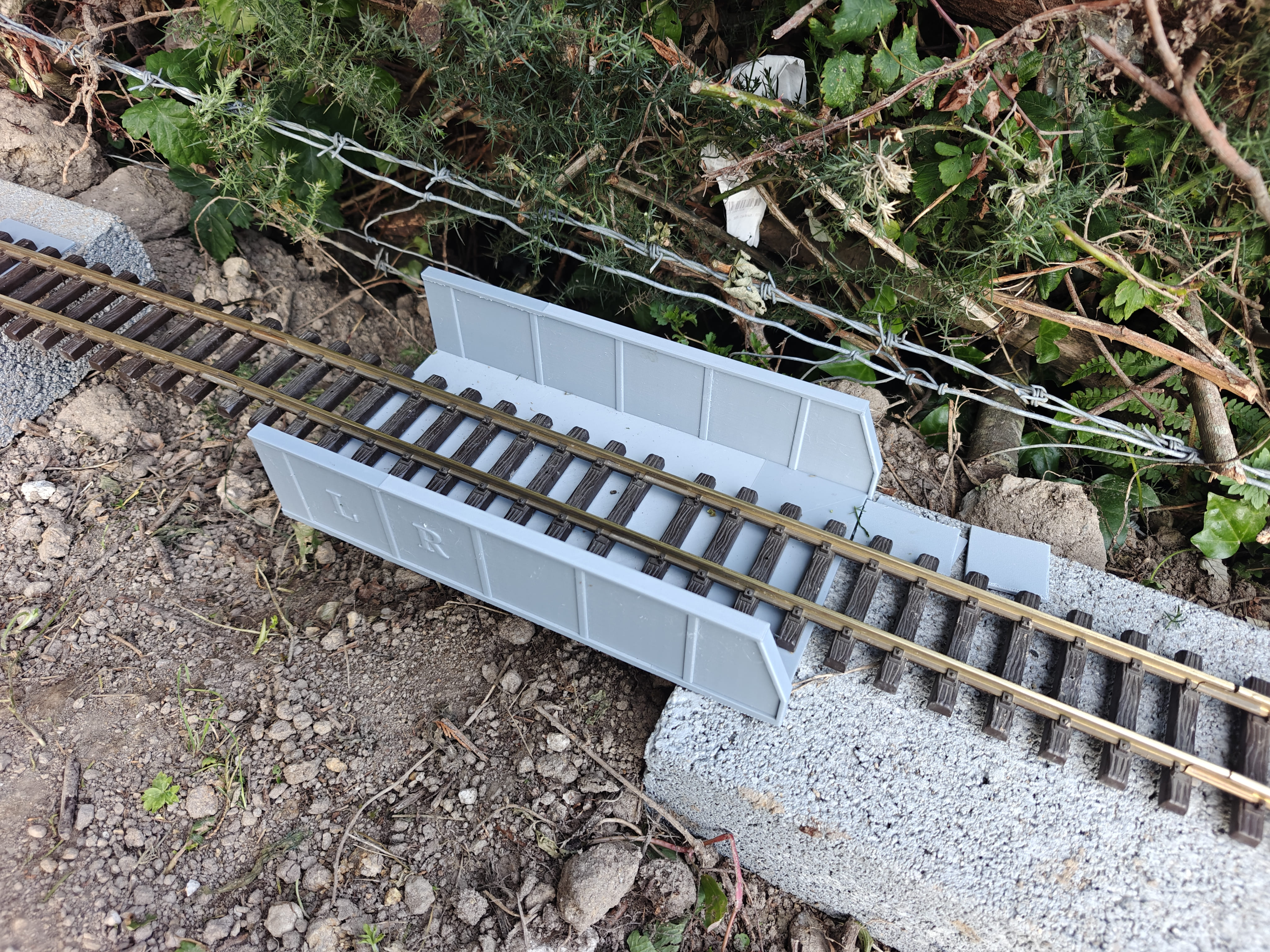

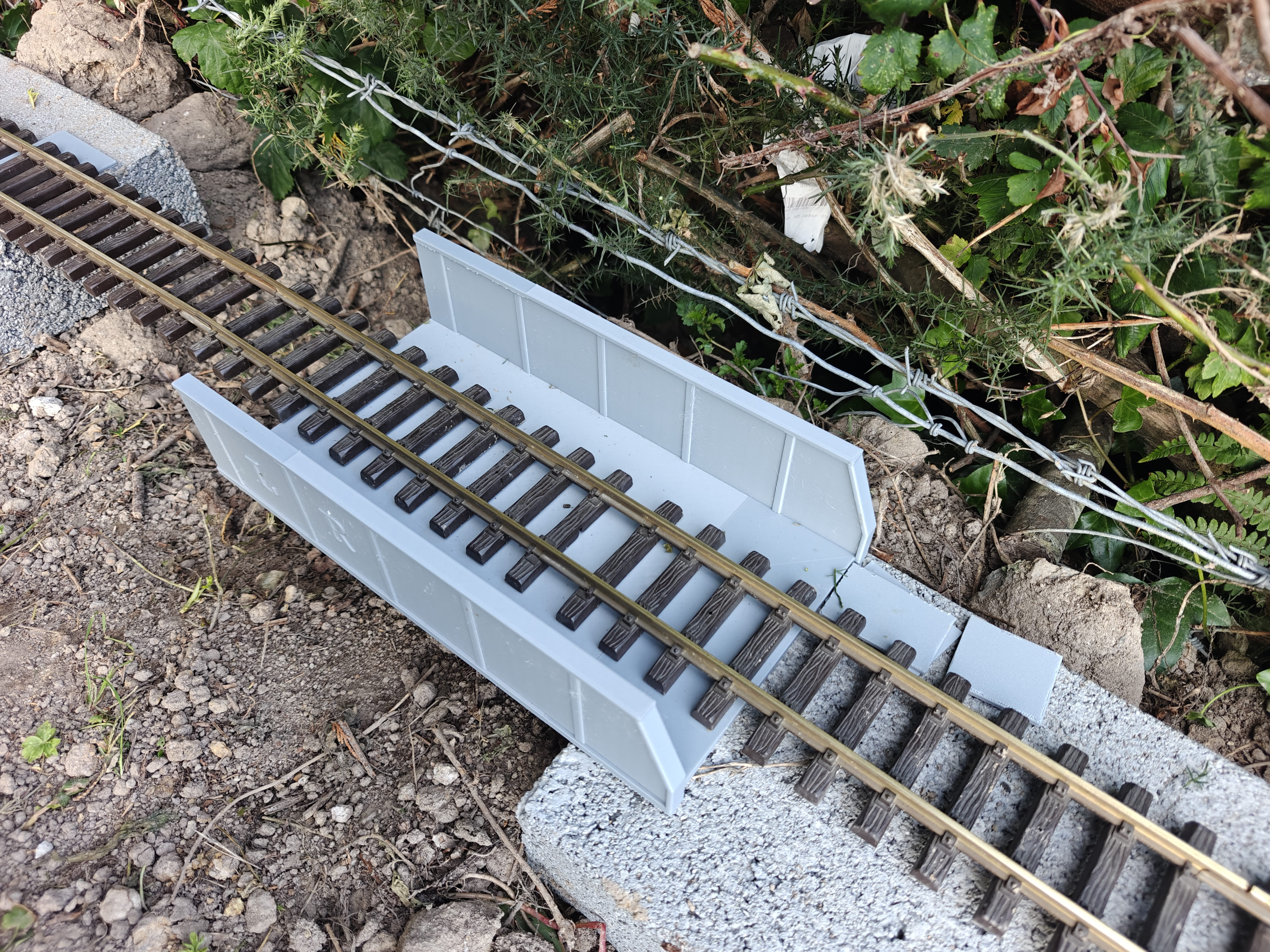

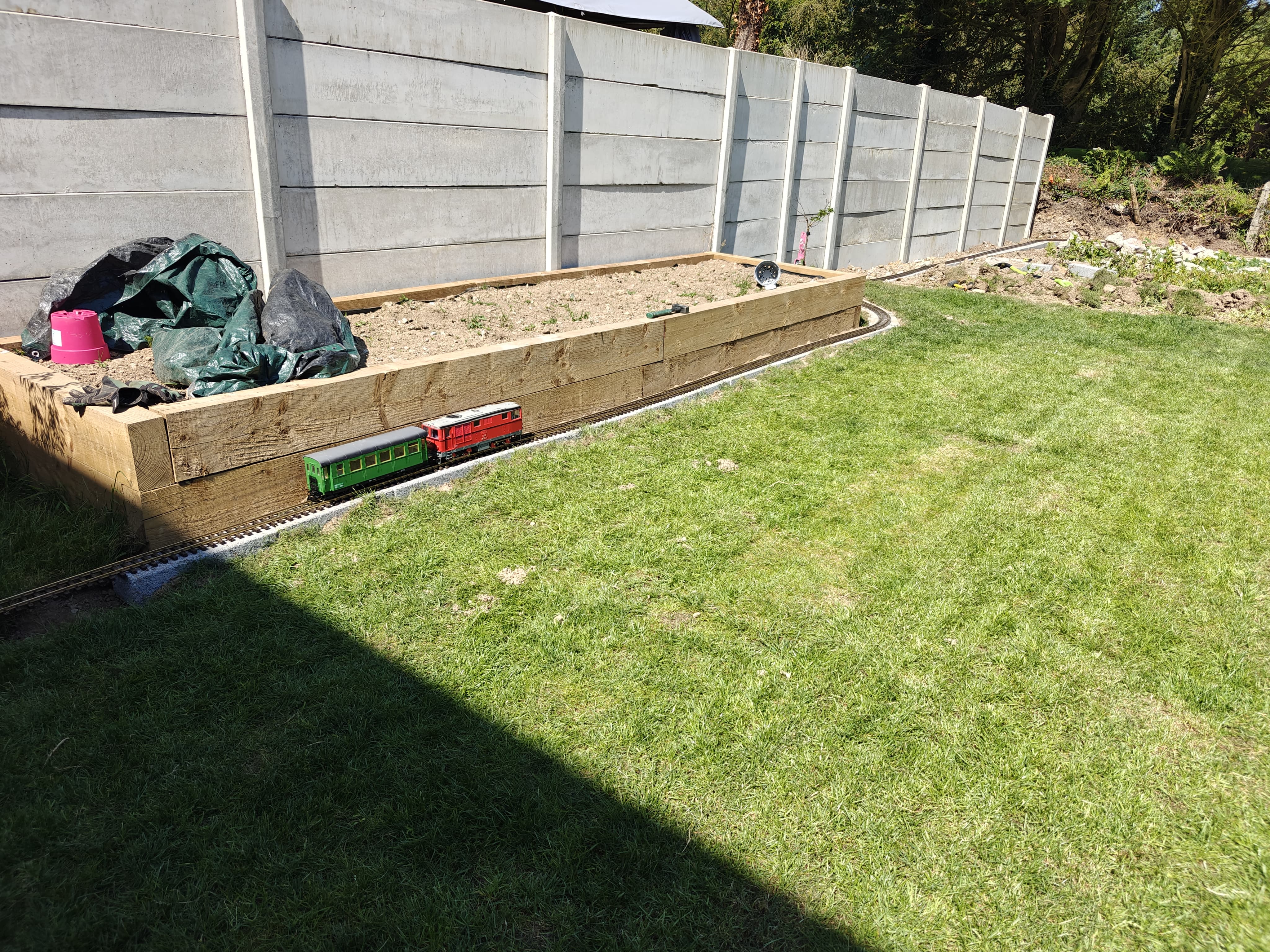

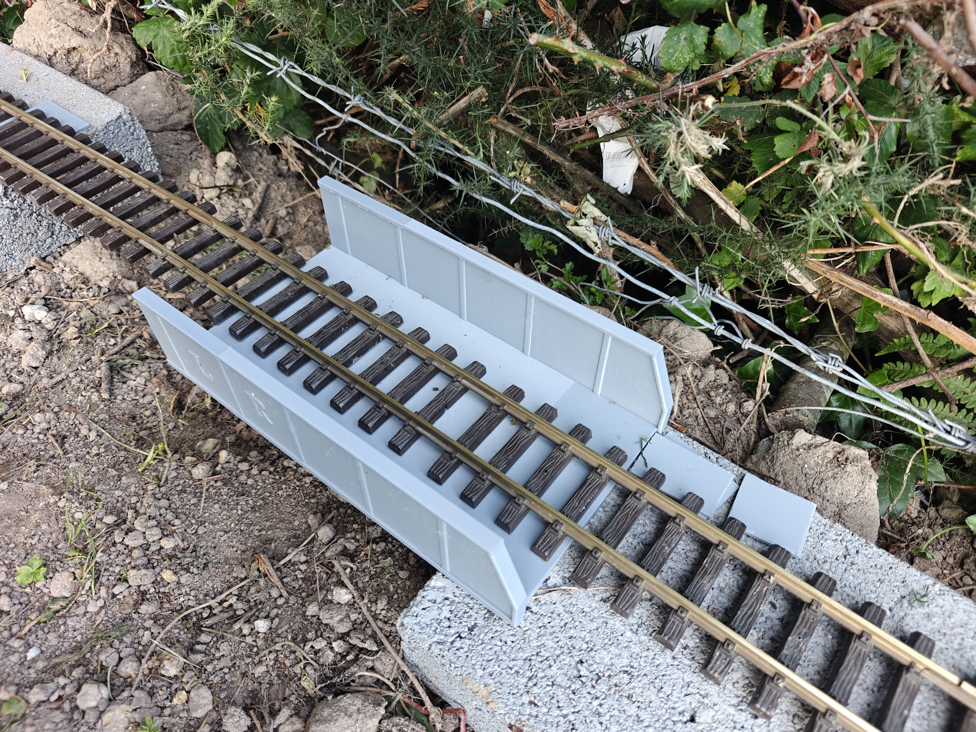

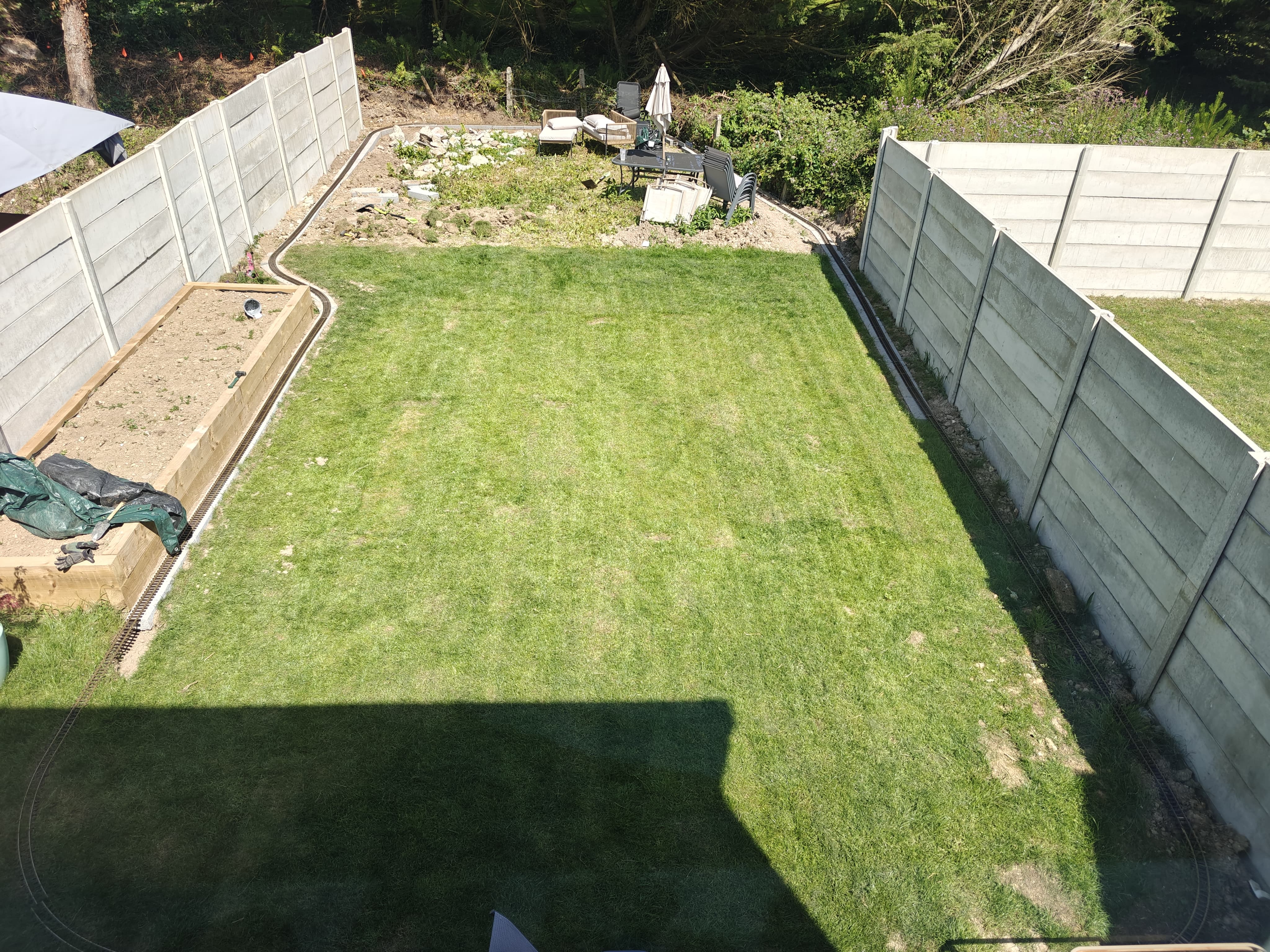

WhatsApp Image 2026-07-10 at 21.07.491.jpeg (2.71 MiB) Viewed 6271 times
WhatsApp Image 2026-07-10 at 21.07.5511.jpeg (2.24 MiB) Viewed 6271 times
WhatsApp Image 2026-07-10 at 21.07.55147.jpeg (2.08 MiB) Viewed 6271 times

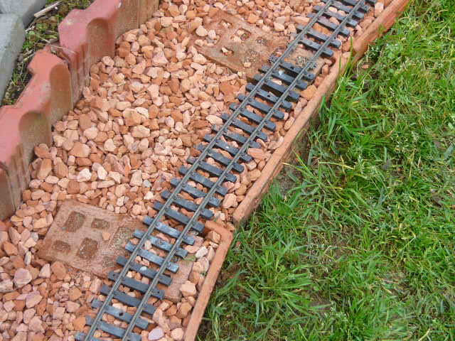

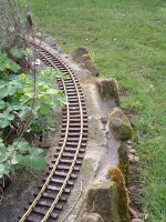

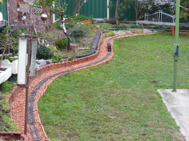

From personal experience I highly recommend some form of edging along the track to;
1. Keep the ballast in place and
2. keep the lawn from growing over the track
Down here we can get cheap plastic edging in rolls from the garden centres with pegs and believe me for the cost, the time saved from weeding out lawn from the tracks an edge will be worth it. I used old terracota roof tiles (got 5 trailer loads for $50 from a house demolition place) for the edge and crushed ones for ballast.
