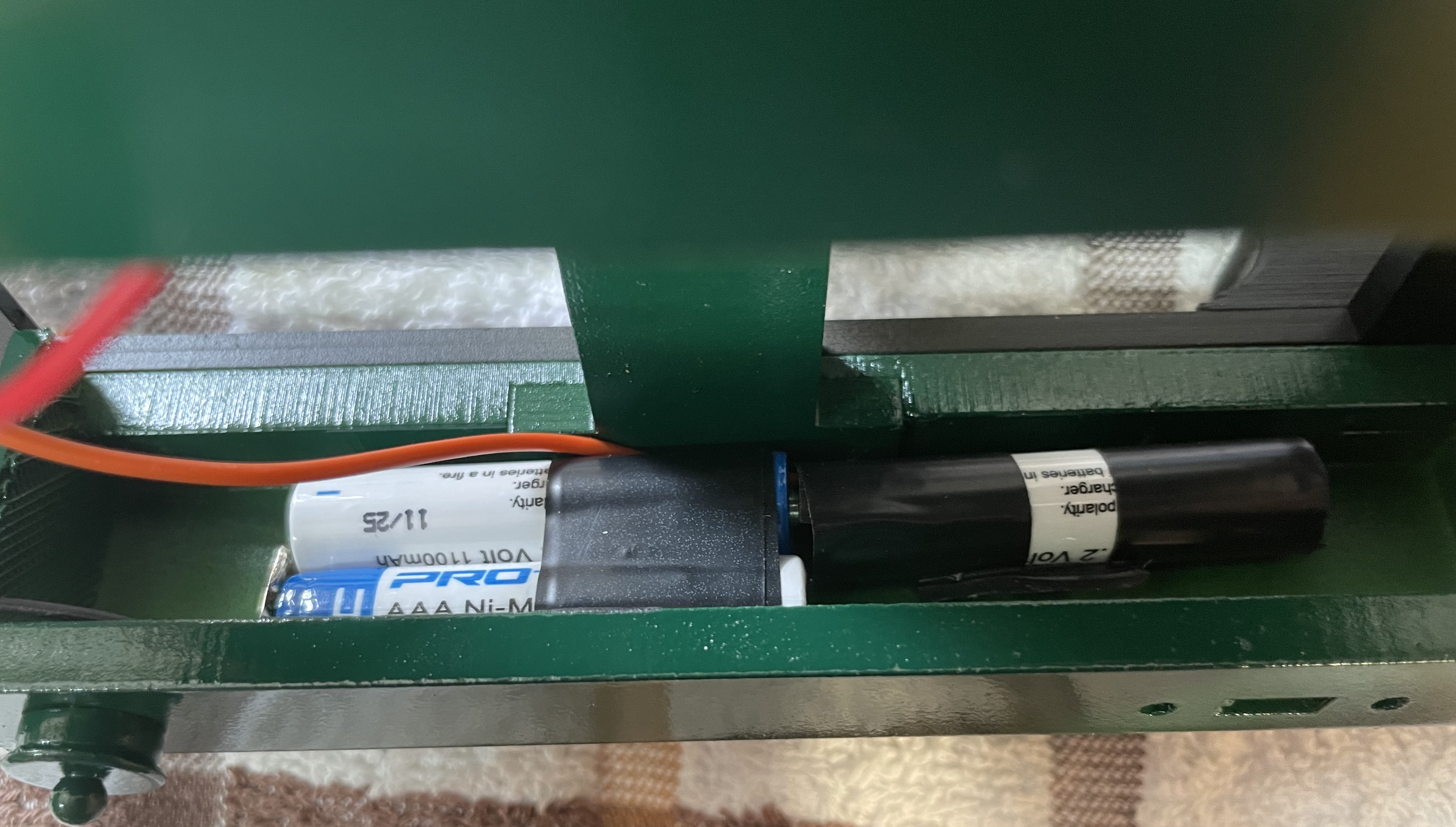

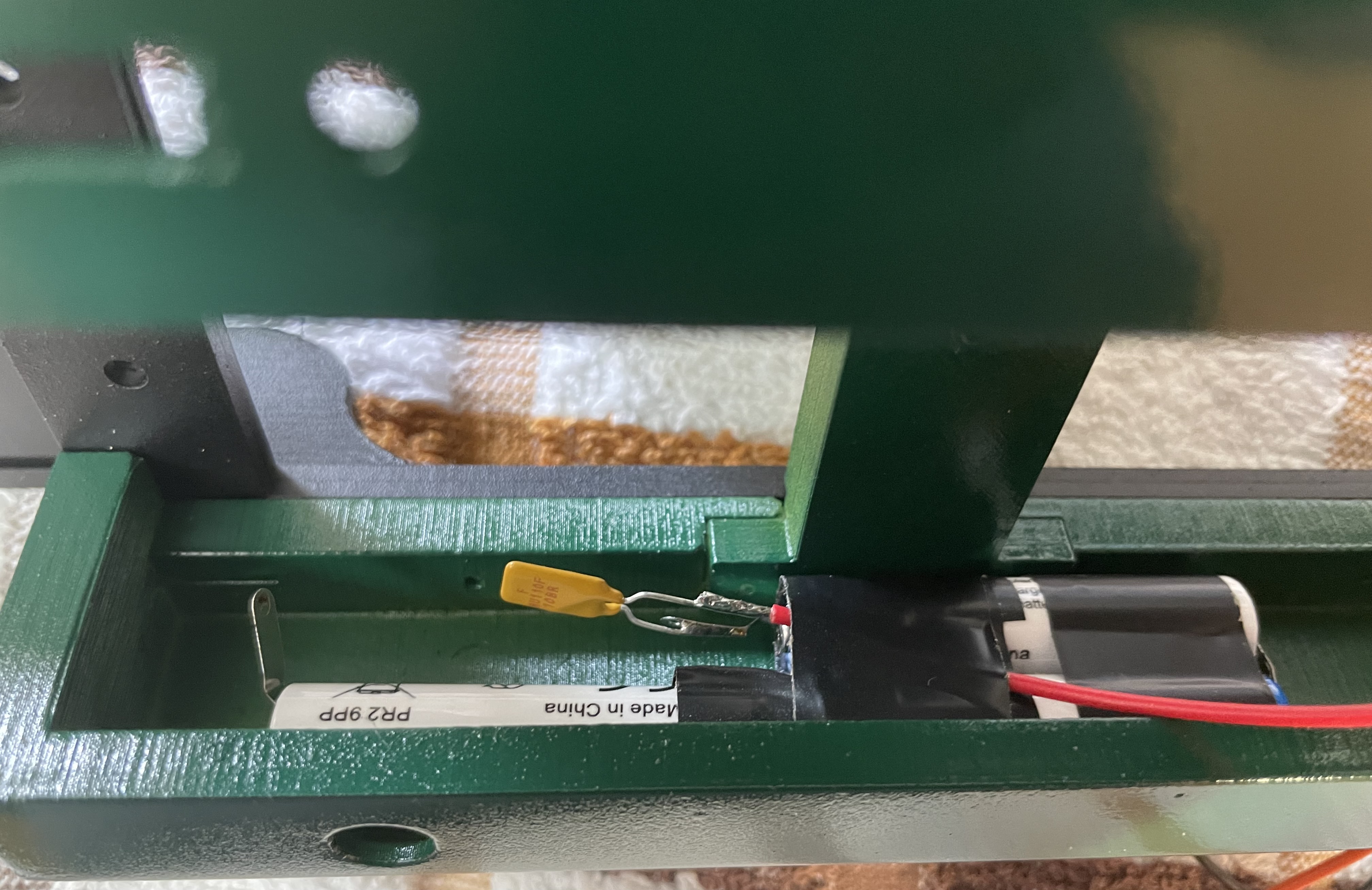

Battery placement is often an issue. Here's my solution in this case:-
The orange wire in the upper photo links to the empty tag in the lower one, a black wire is not visible in the upper photo. I find it easier to use AAA cells than AA as six are needed to provide sufficient voltage for the receiver and with 1100mA cells the running time is sufficient for normal use.

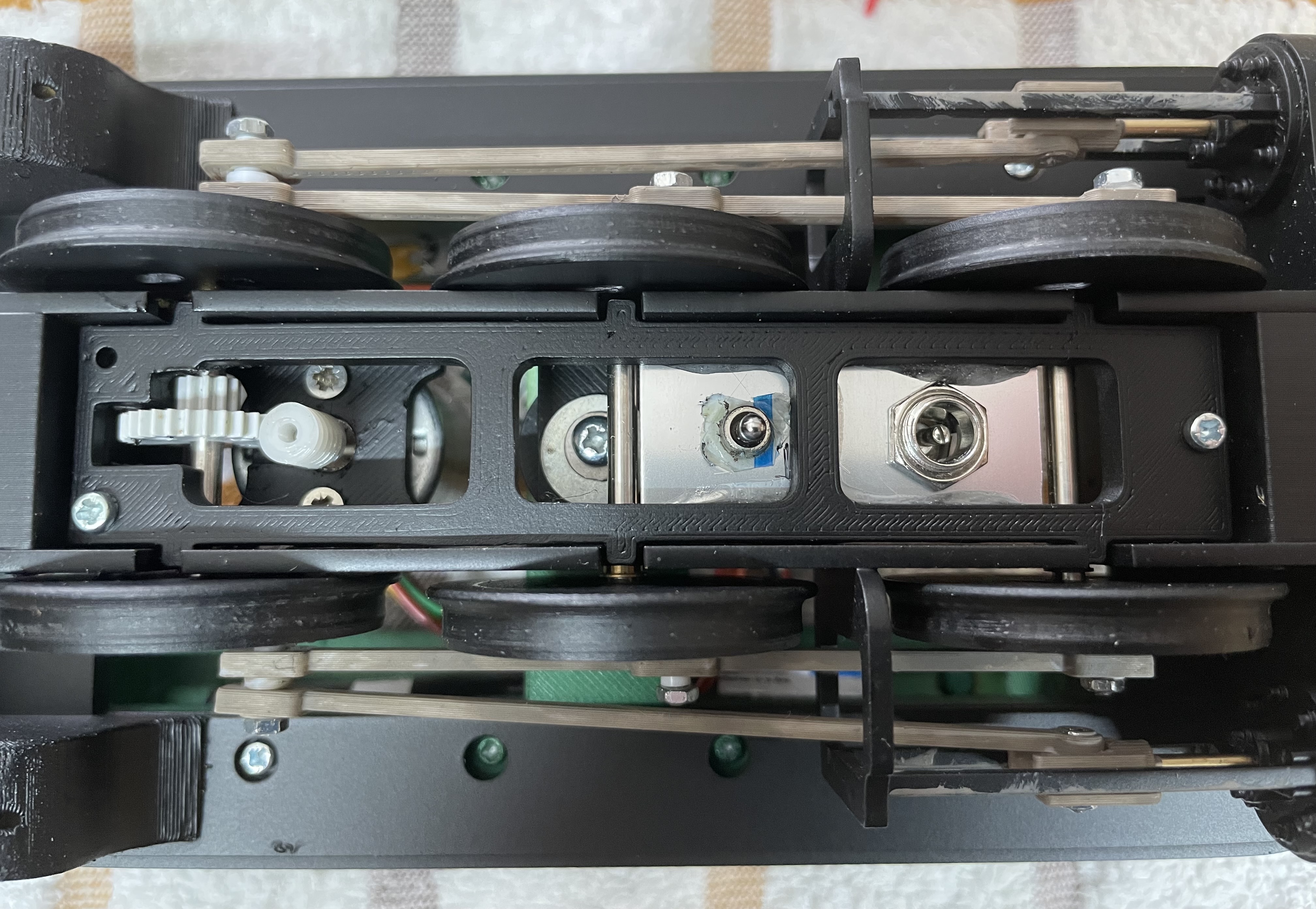

In this kit there is provision for the switch and charge socket to be mounted in the side tanks, I prefer to put these underneath the loco so added a small aluminium pate to the wheel keeper plate to accommodate these:-
amongst my electrical bits I have some very small DPDT switches, no idea where they came from ages ago. I like to use a double throw switch so the centre is always OFF and either other direction is ON
this is the view from above, the receiver obscures wiring detail of the switch and charge socket. With hindsight I think it would have been difficult to install the wiring with these two items in the tank tops,

Well, this has just blown my mind. It had just never occurred to me to allow this kind of redundancy to make it easy to remember, and check, that a loco is actually off. Brilliant. Going to replace all my switches now!gilfachphil wrote: Sun Oct 04, 2026 11:21 am amongst my electrical bits I have some very small DPDT switches, no idea where they came from ages ago. I like to use a double throw switch so the centre is always OFF and either other direction is ON
Finish is looking great, by the way. Good tip about the nail files too!
