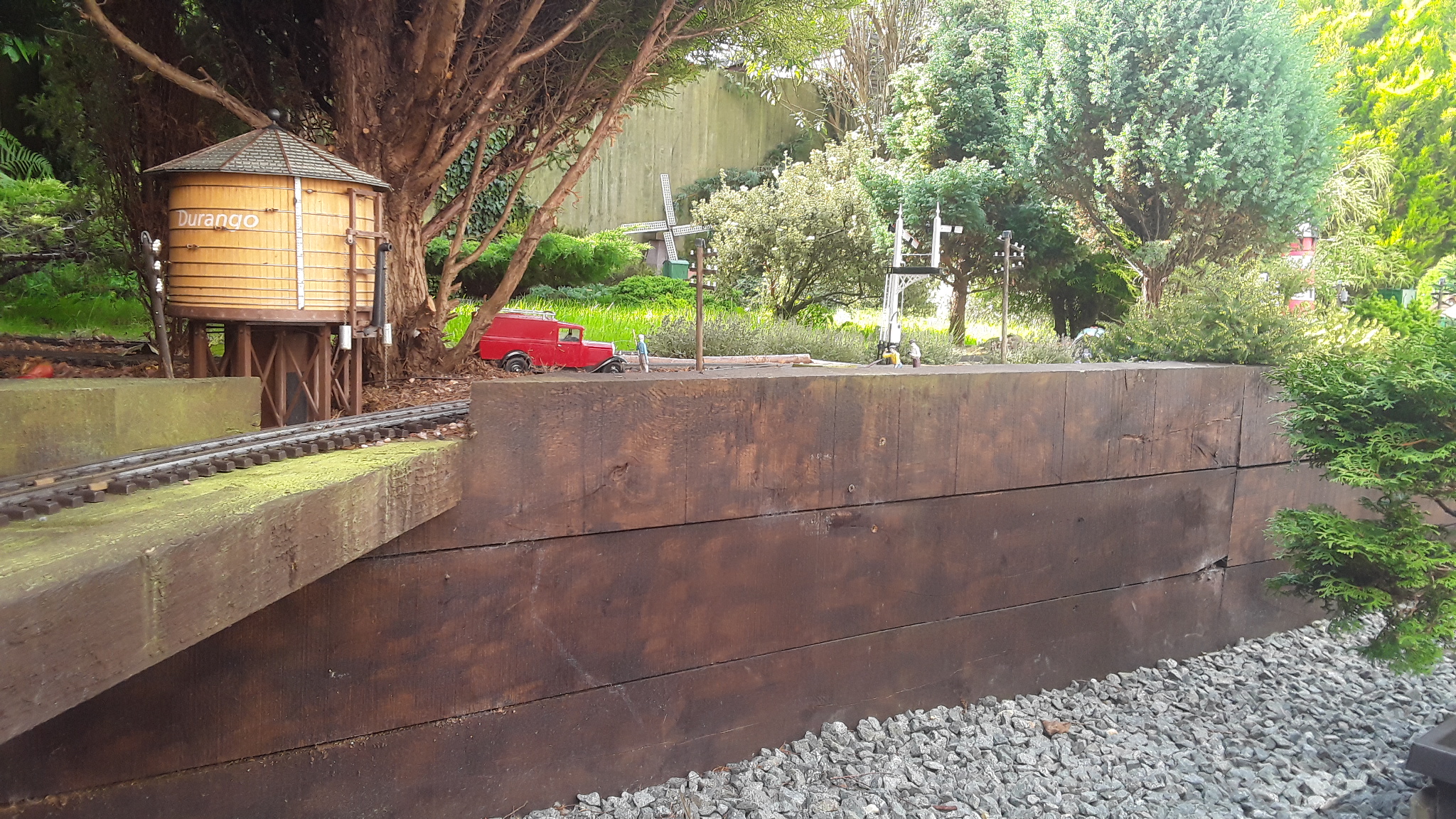

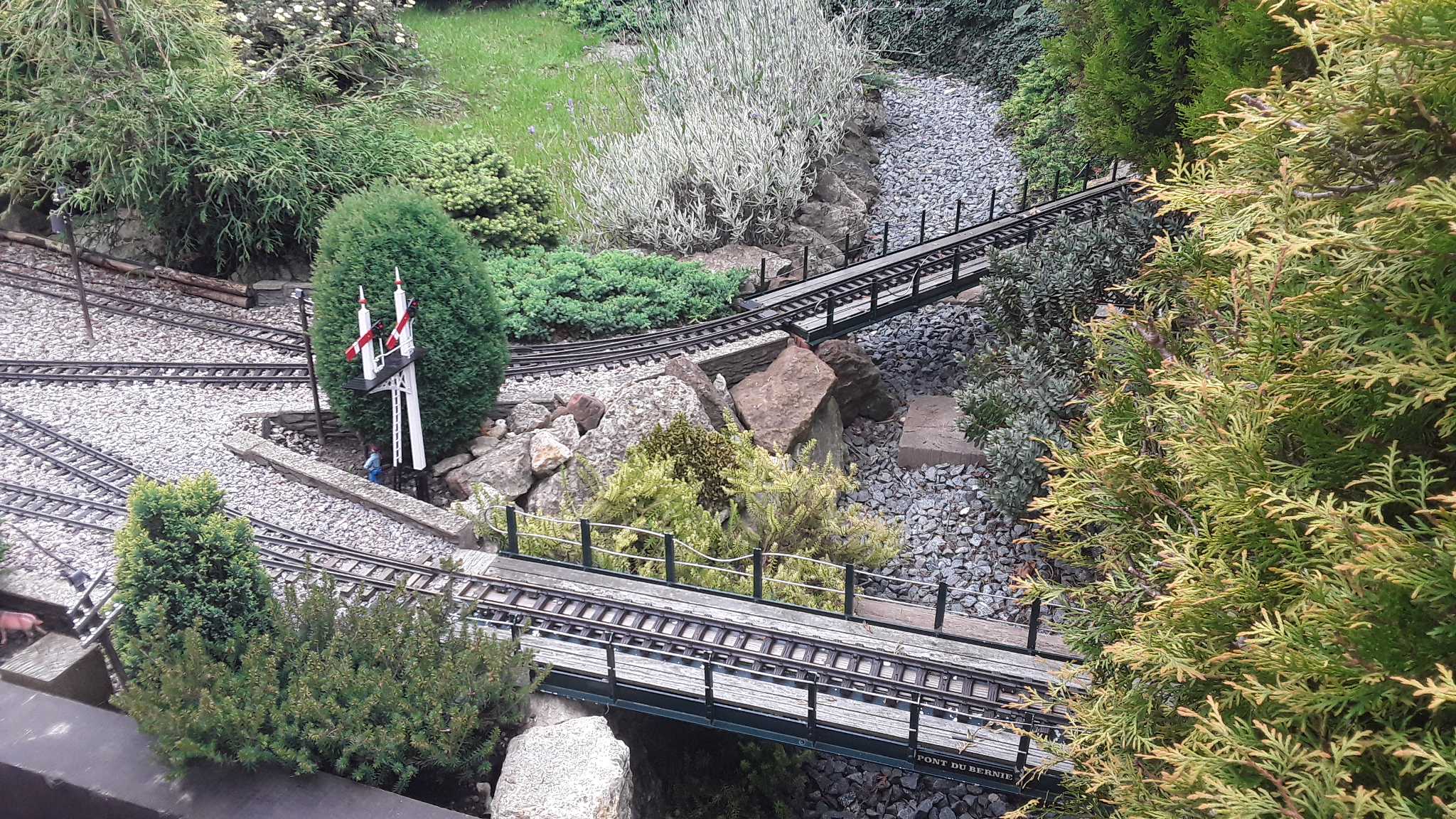

Phil as I am about your age I (read my knees) decided that crawling around on the ground was for the birds, so I went the elevated baseboard route.
While not through the garden it does gives me a chance to walk around the garden and I did plant out underneath with flowering plants to give some colour.
Doing this also allowed me to call on my old HO skills to create believable scenes on the baseboard which do not require weeding.
https://ringbalin-light-railway.blogspo ... -2023.html
The baseboard frames https://ringbalin-light-railway.blogspo ... ework.html
To keep everything low maintenance I use artificial turf for my pathways, only had to crawl around once. https://ringbalin-light-railway.blogspo ... ayout.html
Bit of scenery https://ringbalin-light-railway.blogspo ... cross.html
I started min in 2019 and have not regretted my decision to go elevated one bit especially after open heart surgery.

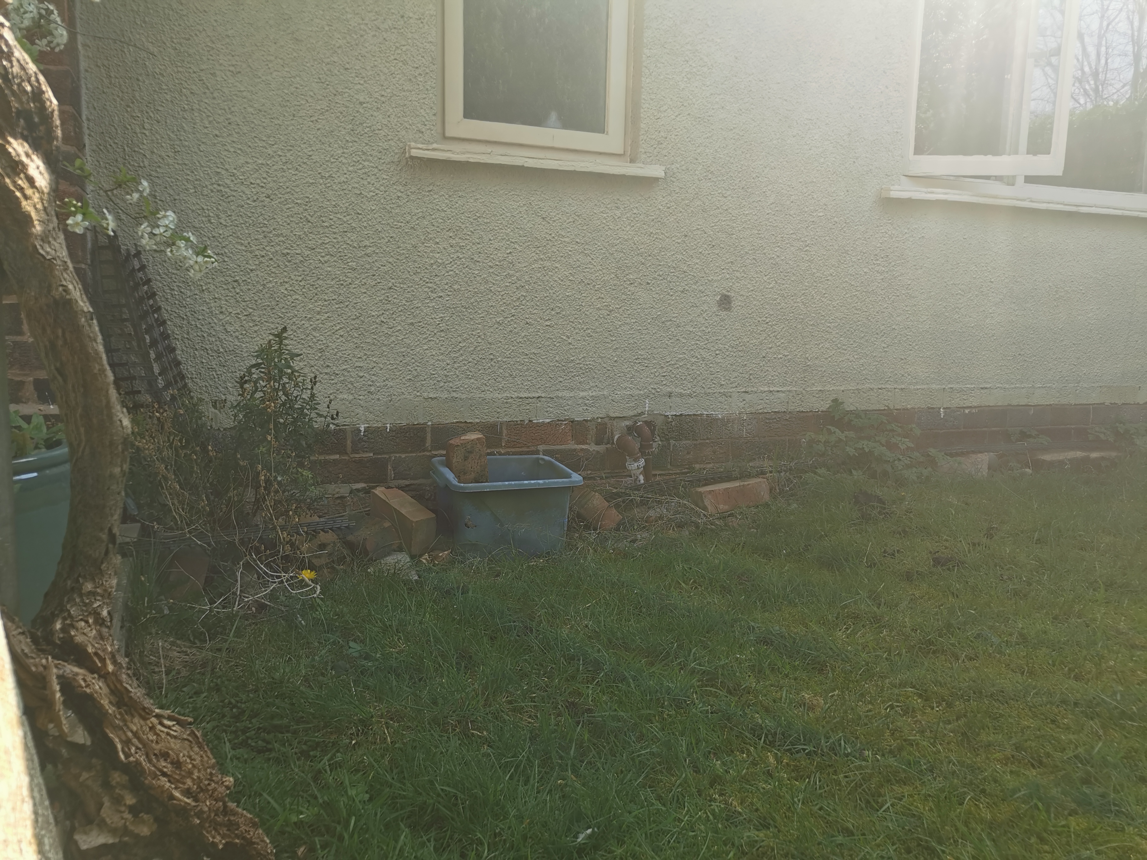

Some better weather, so a couple of photos, and more musing:
Side of bungalow
Side of bungalow
The choice is to either come off the patio (next post/photo) at roughly the level the existing track is, or at the height of the top of the first brick under the rendering. - This would probably make the end of the line being adjacent to the edge of the present patio.

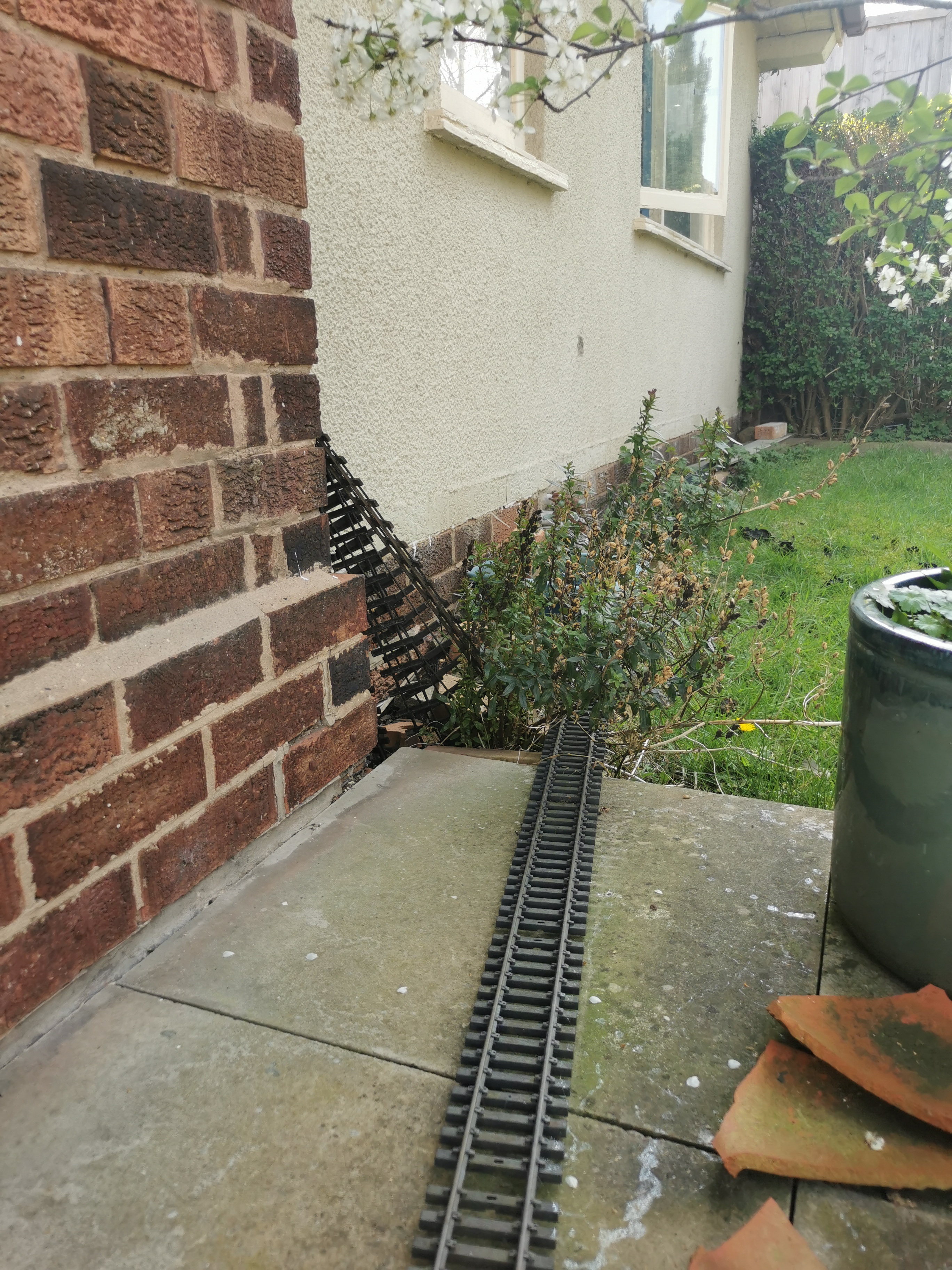

View from the patio:
View from patio
View from patio
This shows the line would be 'three bricks' above the patio, 4-5 bricks above the grass. - About 3-bricks,by the time you get to the path running down the side of the garden..

FWIW, in my case that would be the worst of all worlds, too high to kneel and too low to bend! Of course, it really depends on your personal flexibility, but 10 years ago when I was your age, it didn't pose me any problems and I wasn't expecting that it would. How wrong can I be?? :roll:
