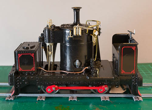

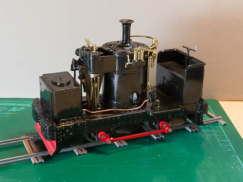

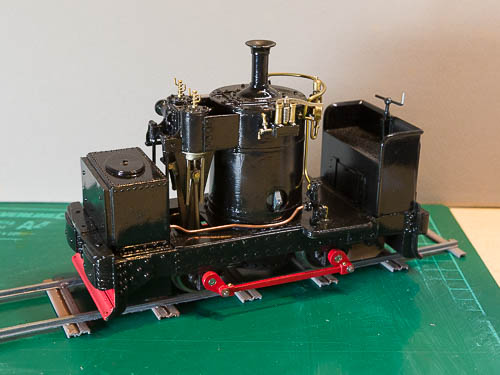

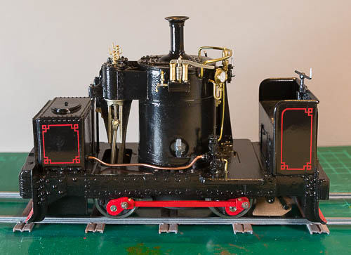

Post by Paul_in_Ricky » Thu Jan 15, 2026 1:51 pm
After watching too many dreadful ‘tutorials’ on Cricuts on YouTube I think I’m now up to speed on the machine on cutting vinyl.
I’ve been primarily trying to create some lining for my Slaters De Winton.
The lining has trickily complex small corner detail that’s at the limit of what the little Cricut machine can achieve. So it’s taken some experimentation to get the best possible result.
Using ‘Smart vinyl’ in the default configuration the corner detail lacked consistent geometric accuracy.
The first issue to address was the play in the vinyl and it’s tendency to curl up whilst being cut. Fingertip pressure, as previously discussed, helped. The final best solution I’ve found is to mount the vinyl on a mat and also fit a thin spacer in the guides to remove any play.
Although Cricut only list one replacement type of blade for the Joy, it’s possible to buy third party blades of different types from the likes of Amazon. Some YouTubers recommended the use of the 60deg deep cut blade for fine detail, so an order was placed for a set. I found the 60deg blade even worse for my lining than the the default, so I tried a 30deg blade and the results were better than the default. It maybe that for curved work that might be reversed.
The end result is about as good I think the machine is capable of, not perfect, but from normal viewing distances very acceptable.
Using transfer tape made transferring the lining to flat surfaces pretty easy. Despite my reservations the ‘weeding tool’ is actually very useful, not only for prising unwanted vinyl off the sheet, but also for burnishing the transfer tape onto the lining and again onto the final surface.
Fitting it to surfaces that have raised detail is pretty difficult. I found that cutting holes in the transfer tape after the lining was on board made fitting easier. Going over larger details needed careful cuts in the vinyl that will be tidied up with a dot of paint later.
Final task on the lining is to find a suitable lacquer or varnish to overcoat and protect them with.
Thanks to everyone helping along with this.

Great result Paul. I’d suggest the slight imperfections are only really noticeable if you deliberately point them out, otherwise it just looks like a very neat job.
I’ve had good success with Humbrol spray can acrylic satin varnish. The solvent doesn’t seem to attack the vinyl and the finish is a nice hardwearing satin sheen, a good base for any further weathering. I know some people report it can go on cloudy but I’ve never had that issue. Spraying on a warmish day and with low humidity should prevent clouding. A test on something other than the model would obviously be a good idea!

Post by Paul_in_Ricky » Thu Jan 15, 2026 4:09 pm
Thanks Dursley,
Yes, Humbrol will be my first test. I've got some spare lining on various bit of plastic to test sprays with on the actual loco and know the perils of spraying on wet days BTDT.
Just a couple of tiny details to add before it's finished.
I'll practice weathering a LOT more before trying it on this, it's been a long difficult journey to get this kit so far.
