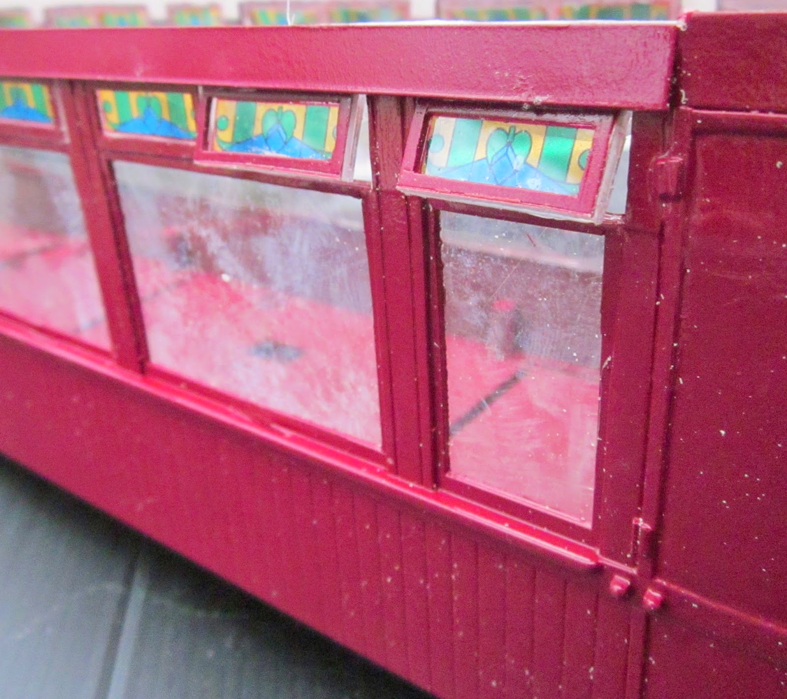

Probably a bit more complicated than you need, but I printed stained glass designs on to self adhesive clear acetate sheet and stuck them on to 1mm thick clear acetate for the top lights on my Leek & Manifold(ish) coaches
More info here (about 2/3 way down)
https://riksrailway.blogspot.com/2015/0 ... sharp.html
