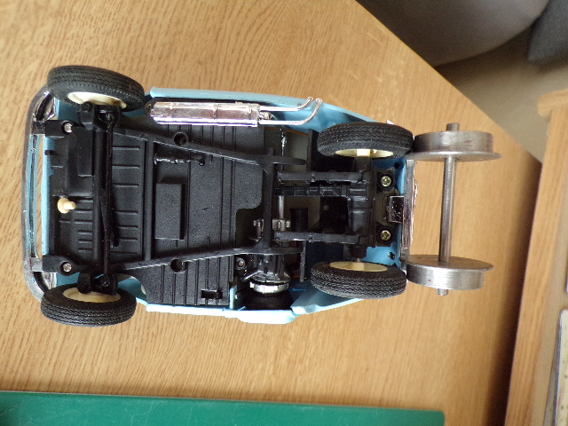

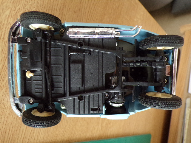

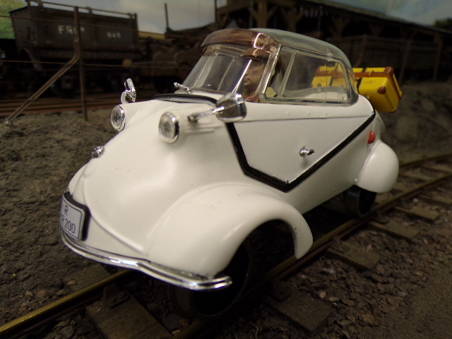

Although I recently posted pictures and description of my Fairground Organ build, I had by-passed another of my road to rail conversions.
Attached are a couple of images showing the 'before' view of the donor vehicle's chassis and, despite it appearing to show a perspective difference in wheel gauge, it is in fact dual gauge as built!
Can you guess what it is yet?.... I'm looking at you, Drew!

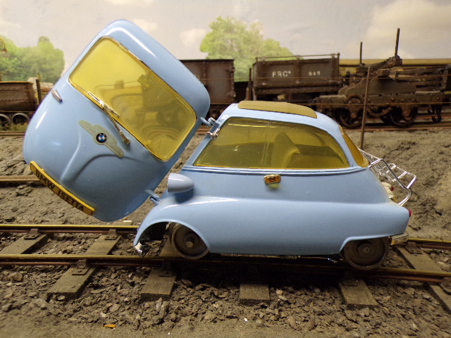

That's an easy one. Its a BMW Isetta. The four wheeled version . What is intriguing is how will you fit a motor gearbox into a very small space . You must have a mini motor setup ,or the car is the Isetta Tardis variant.

Too easy Chris, must try harder!

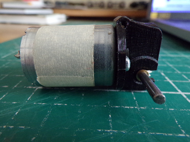

It is a very small vehicle to fit everything in but I have managed to put a standard 6v motor and gearbox driving the front wheels and five AAA batteries at the rear underneath the engine cover. It looks tidy but I can only fit a driver figure by major surgery to his lower parts so he straddles the motor. So far I haven't done so, and with the tinted windows it is less important, but will get done soon....
Being a die-cast model it is quite heavy so runs very smoothly with Phil P's R/C installed.

Another great conversion, Peter.
A pity the motor shaft doesn't extend out of the top of the motor - you could give the driver a rotating hat ....

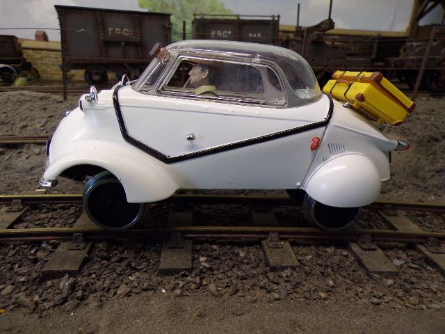

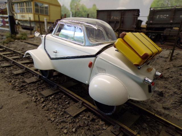

Whilst browsing for something else I stumbled upon this comment from dudeface and Aaron. I had completely forgotten about it, despite reading, and usually commenting, on all your messages.Old Man Aaron wrote: Tue Feb 20, 2024 4:38 amNever realised they built things without wings. Old and weird, just how I like a car.dudeface wrote: Tue Feb 20, 2024 3:00 am Big fan of funny little cars myself, especially Messerschmitts... (Try making one of those into a railcar!)
The reason I'm replying after all this time (Feb 2024) is because I have recently completed my latest build and was about to add it to my thread anyway.
What a coincidence....
The original is a three wheeler, as shown on the original picture, so the rear end is too narrow to take the 32mm wheel gauge. To accommodate this I had to take an angle grinder to the side of the die-cast model and add extended wheel arches (quartered round top from cosmetic bottle) which don't look at all out of place.
Driven by a tiny motor with axles either side through a built-in reduction gearbox. Rechargeable batteries, RC Trains Rx, 2 way switch and charge point. And why not???
Do you think it's time I sought professional help?
Well I think it looks brilliant Peter. You have somehow brought it to life onto a 16mm garden railway that for me doesn't look out of place.
- GTB
- Posts: 1719
- Location: Australia
Neat work on the rear end conversion. No idea if anyone does a diecast model, but the real contraption came in a 4 wheel 'sports' version as well. It was the hoon's version, with a 2 cylinder motor and about the same horsepower as a ride-on mower (20hp).Peter Butler wrote: Thu Jul 24, 2025 10:17 pm The original is a three wheeler, as shown on the original picture, so the rear end is too narrow to take the 32mm wheel gauge.
