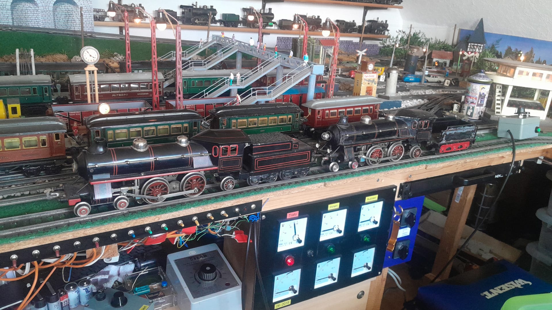

Here it is behind the 24V version that also has the correct tender.
This tender is of unknown origin and will have to do until I find a correct one.
