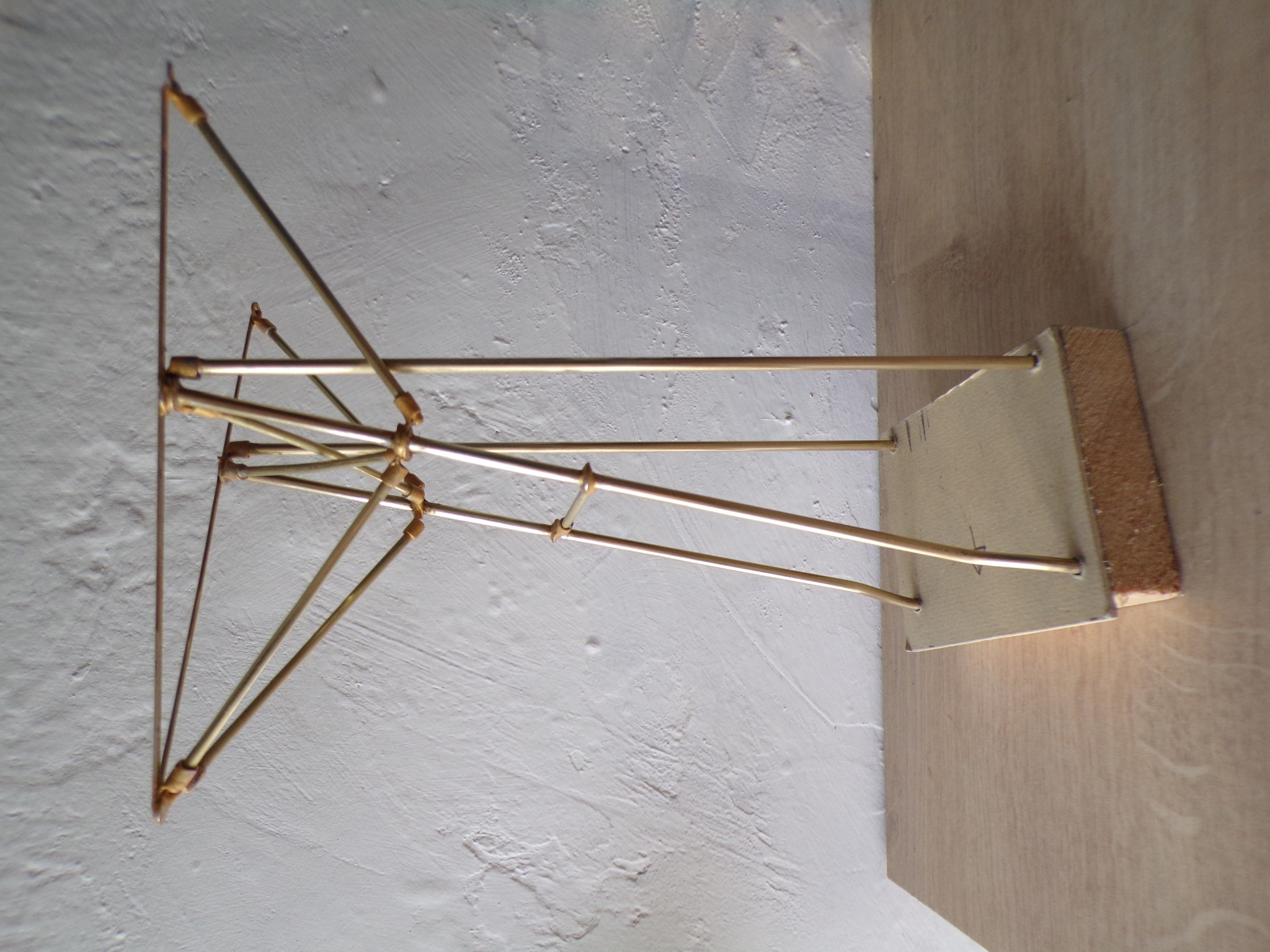

Towards the end of the build I had to face the construction of the support for the canopy above the driver. This could easily have been its downfall as I struggled to find a way of soft soldering brass rod in such a way it remained strong enough to withstand handling. Bear in mind this 'thing' stands about 11 inches tall and is no lightweight!
Eventually I came up with using electrical cable crimps, the ones with screw holes for securing to contacts. Having stripped off the plastic covering, these can be soldered to brass rod and hooped around uprights at various joints and soldered solid.... very strong.
A jig support was constructed away from the model and the whole framework made....
