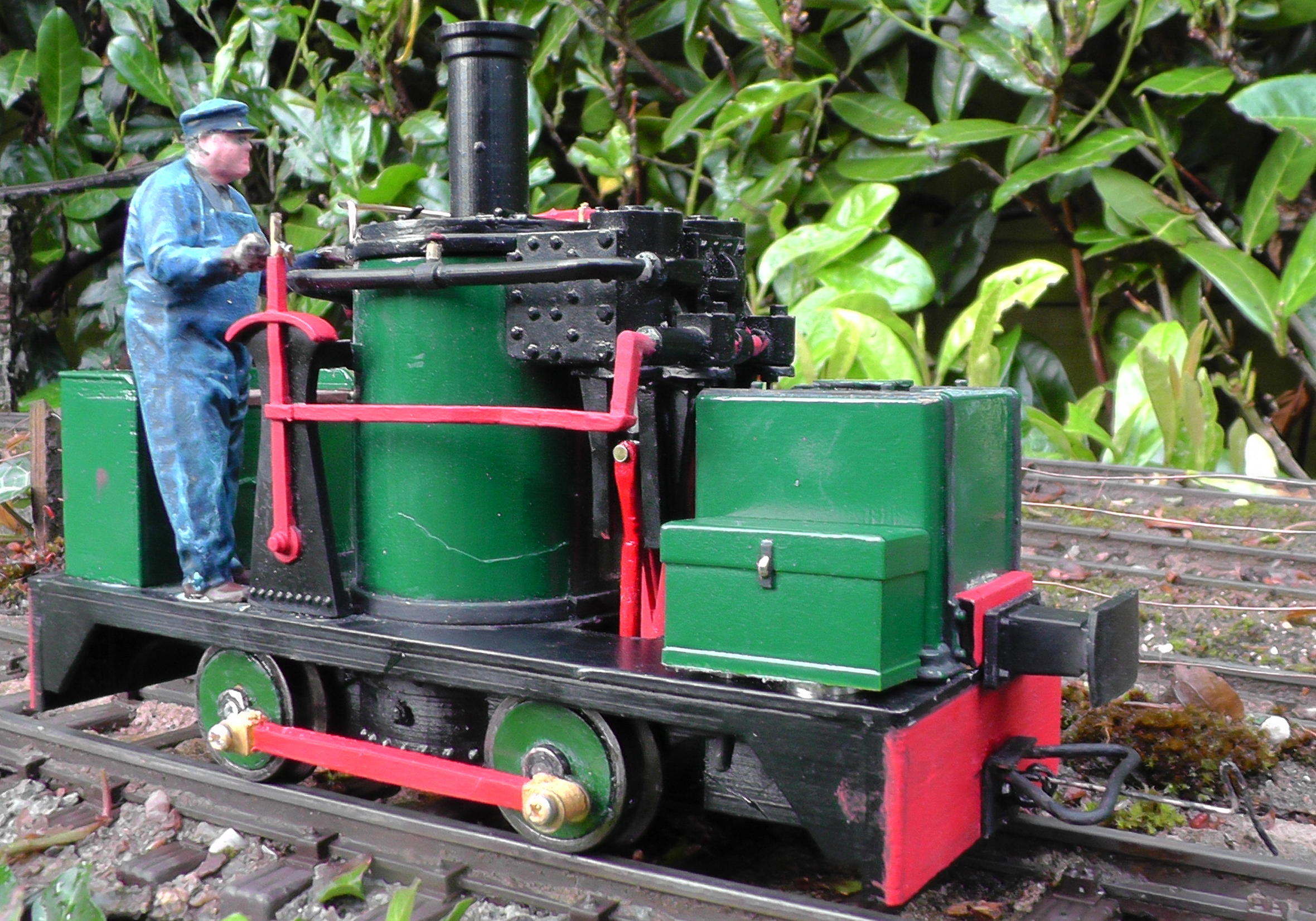

Post by ge_rik » Wed Aug 21, 2024 8:02 pm
This is v3. As a result of this build, v4 should be slightly improved.
I think this must be my most fiddly scratchbuild so far. Because much of the gubbins is on-show, there's not much room for the behind-the-scenes electrics, and so a fair amount of tweaking and adaptation was required. Also, unlike most of my builds so far, I had to do a lot of the painting before assembly.
There's still a fair bit more to do - mostly pipework, nameplates, number plates, buffers, couplings and a few minor details. Nearly there!
I wonder is Mk 5 will include an operating reversing lever with animated driver? Might be a step too far...... :shock: :? :lol:

Post by Peter Butler » Wed Aug 21, 2024 8:22 pm
Lovely job Rik. Just watched on youtube before finding your post here. Everything seems to be working as it should and looking fine.

ge_rik wrote: Wed Aug 21, 2024 8:02 pm Because much of the gubbins is on-show,....
Hi Rik,
the loco looks great.
I also would add a small solenoid or friction mechanism (brass strip behind the wheel) in order to move the reversing lever correctly.
With all these things exposed, they need to be correct.
This is what makes these locos interesting. You can see the whole mechanism working.

Now added pipework, buffers and couplings - plus as much lead flashing as I could squeeze in. Seems to be able to haul a decent load, but I'd like to add more lead if I can. Better to be too much than too little is my motto.

Post by philipy » Fri Aug 23, 2024 4:40 pm
Very nice end result, Rik. :thumbright:

Post by Peter Butler » Fri Aug 23, 2024 5:41 pm
Looks the part and performs very well with that load on.
