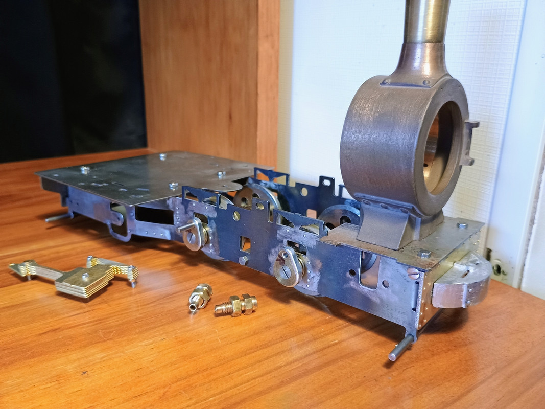

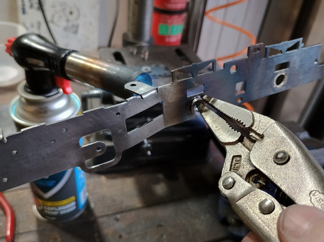

The paint was rather stubborn, but eventually wire wheeled away. Annoyingly, the axle bushings were soldered in, requiring a torch for removal.
The "victory" kit is compromise incarnate. This is not a complaint, but an observation. I'm told the loco is scaled entirely around the Roundhouse Billy smokebox, which puts the loco at 1:16th scale - squarely between 16mm and 7/8ths.
The huge reverse bend in the frames is to let the trailing wheels negotiate 600mm radius curves on 45mm track. I have another loco for 45mm sojourns, and R1 curves have no place in my life.
I could straighten the frames out, but if I start changing proportions, I won't stop till I've made the kit redundant.
The loco at 1:16th looks pretty good with other Roundhouse-based 16mm models. I'll just call it a twelve-ton model rather than a seven-tonner.

The headstocks were modified in the usual way, silver-soldering screws into them for a flush front face.
The sharply-etched brass overlays were then soldered on. IP Darj. couplings were cleaned up and fitted at my usual 20mm height.
The kit was missing two of it's 35mm driving wheels, but standard RH 33mm wheels do the trick, running in my usual ball bearings and requisite brass axle spacers. You'll notice the previous owner drilled the wheels. None too accurately, but it won't be noticeable.
Speaking of drilling, I've compromised on a simplified rivet layout, owing to the inaccuracies of the frame.
Using different pins this time, they have a much more domed head than the rather flat ones used in the past.

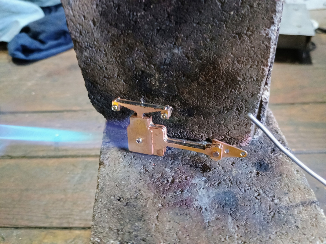

Rather than say, whitemetal castings, the pony axle detailing is achieved by soldering layers of 0.9mm brass together, then filing to shape.
