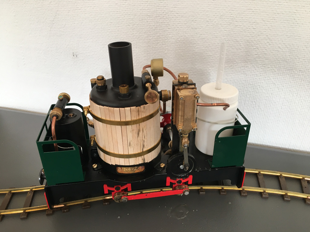

To do test runs indoor I made a condenser. The copper pipe used is 3 mm, just screwed in.

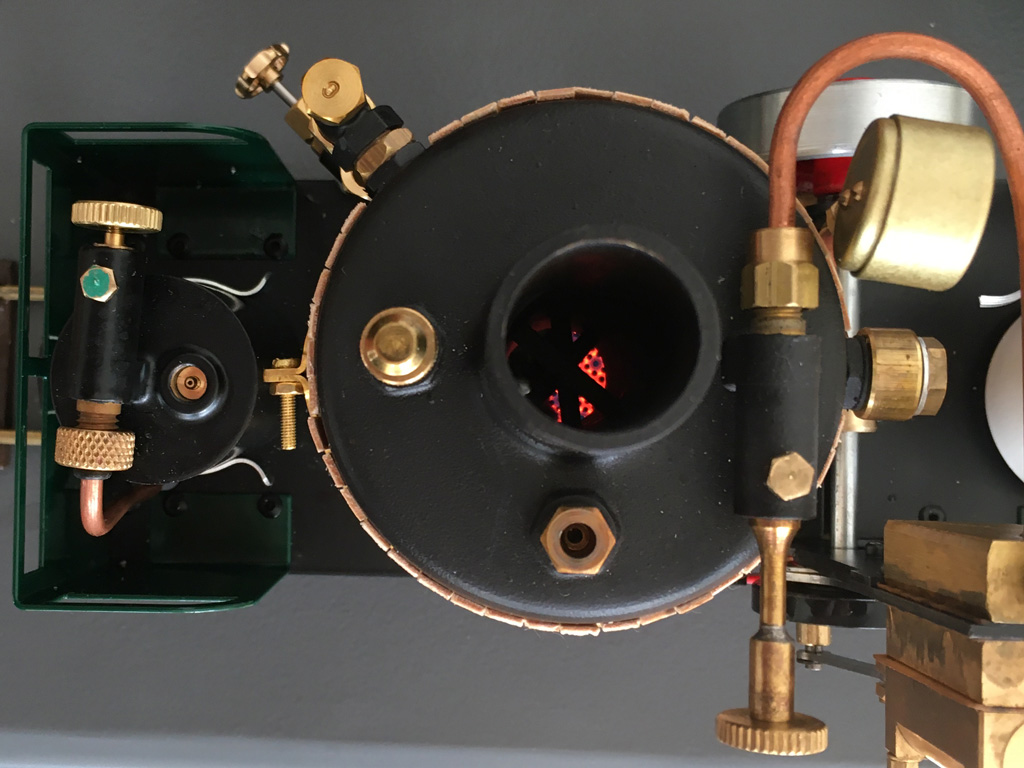

Being used to noisy burners, it took some time to figure out that the ceramic burner is totally silent. Only a very small turn of the gas valve is needed. The burner starts with a blue flame and then turn into glowing red.
Don't look down the chimney! :shock:
I don't see any reason to lift the boiler from the footplate with washers. Maybe Mamod has made the holes in the frame larger?

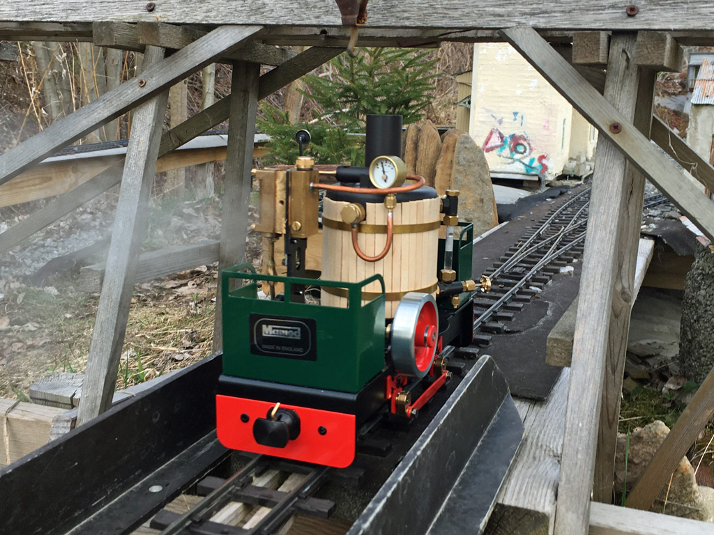

Haven't done any explicit pull tests. Load has so far been six small LGB wagons with metal wheels and metal buffer couplings, so heavier than the originals. Running fine at a small layout with very tight curves, ie. Faller e-train track 36 cm radius.

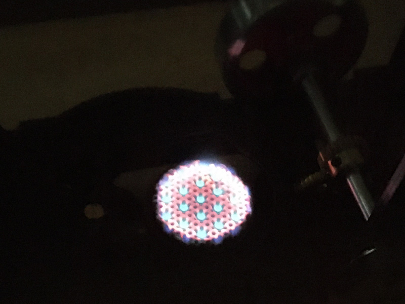

I'm no longer able to make the burner glow red. It now burns with a blue and yellow flame, and it is not nearly as efficient.

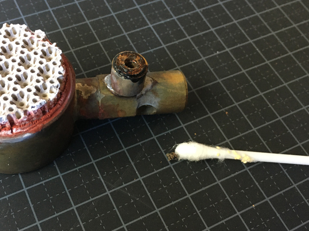

Problem solved. :lol
A spider had made a nest full of eggs in the burner tube between the air holes and the burner. The gas jet had blown a small hole in the nest causing the gas to light the burner, but without sufficient air to burn properly. I cleaned the tube with a Q-tip and the burner got the red glow again.
rebelego
Posts: 211
Location: Norway
Re: Mamod Brunel - Mark 3
Post by rebelego » Sun Jul 14, 2024 9:17 am
For the records ...
This is what the choked burner looked like:

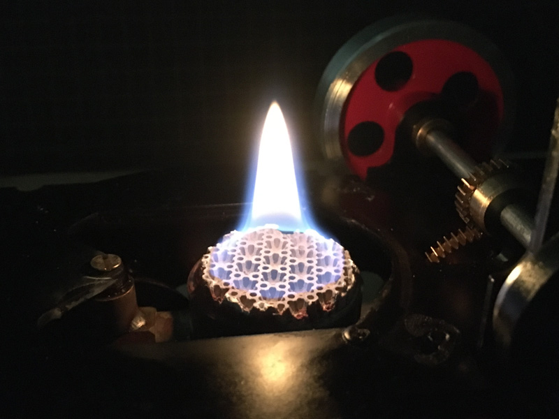

This is about what it looks like when burning properly:
