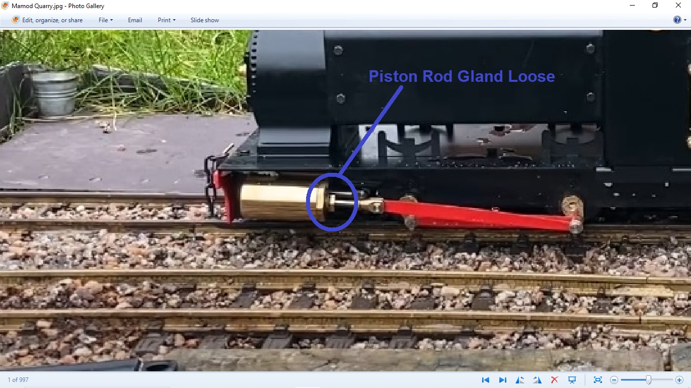

I received my Mamod Quarry loco after replying to your earlier Facebook posting, and looking at your video again, I see you have the same problem as I found on mine - the piston rod glands are too loose.
Do these glands up finger tight so the 'O' ring is being slightly compressed against the piston rod.
Not in their lubrication instructions. Turn the wheels until the piston rod is fully extended then put a drop of steam oil on the piston rod against that gland. Similarly turn the wheels until the piston valve rod (above the piston rod) is fully extended rearwards then put a drop of steam oil on the piston valve rod. Turn the wheels until the piston valve rod is fully extended out the front end of the valve block then put a drop of steam oil on the front end of the piston valve rod.
The boiler plug on the boiler backhead is the standard Mamod thread - 1/4" x 26 BSF

It’s back with them again now. Steam chest on the left pouring steam out at any psi >20. I suspect there’s a warped or inaccurately machined surface in there somewhere.
One piston rod gland came out mid run.
The thing that baffles me is that it was fine on blocks but as soon as it was on the rails the problems started.
Nigel’s Leaking Quarry Loco
