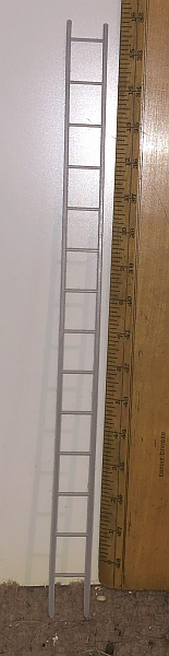

This shows a ladder I've just printed with it, flat on the bed, which is 220mm long and the sides are 2mmx1mm with 1.1mm diam rungs.

I haven't tried printing things flat on the bed without a raft - but something like a ladder seems like a good subject to try it out on.

The problem is of course the dreaded elephants foot.
I've done a lot of digging around and found most of the answer to be the rest time for the first few layers. It slows down the whole print tremendously but having a bottom layer count of 3-5 and Rest after Retract of around 40-50 seconds allows the resin to flow and settle down so that it doesn't get squished out as it cures, which is what causes the problem. It doesn't eliminate it completely but only creates a small lip which is fairly easy to remove.

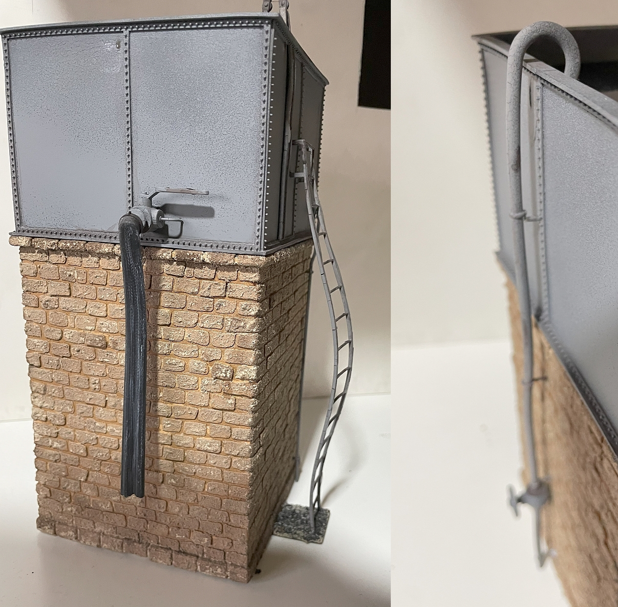

I've been really positive about the Sunlu Water Washable ABS-like resin, because it gave me superb results.

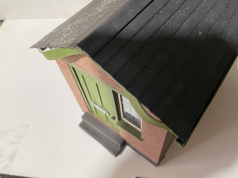

HOWEVER..... After I finished the Water Tower, I moved on to some winter maintenance of other buildings, one of which is the little signal cabin from Bench Junction. Having been outside for about 6 years 24/7/365, it needed a few bits sticking back on, etc. The barge boards at one end had dropped off and disappeared so I thought I'd print one V-shaped replacement, rather than messing about cutting styrene sheet. That worked easily and a couple of drops of superglue and some paint and job done.
Running out of space to keep them I took them down to the shed, which is cold and damp but watertight, and put them on a shelf out of the way.
That was three weeks ago.
Yesterday I went down to get something else, and to my horror this is what I found:
I think that even when cured and painted, this resin is extremely hygroscopic and has absorbed lots of water with the result that everything swells.
It is very obvious on thin items, but in fact the tower and tank sides are no longer flat either.

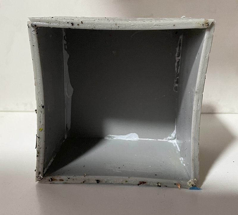

Just to complete the sorry tale, I did say in one of the conversations at the time with Trevor, that I would put a dummy building outside over winter to see how it stood up... this is the result:
Again, it has absorbed water but because it is constrained at the corners, the 4 sides have all bowed inwards!
So the lesson is: Don't use this stuff for anything that might get damp.
