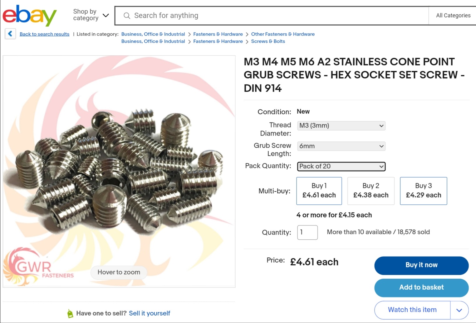

In addition to the .stl files you will need:
For the V1 motor block:
  • 4 x M3 square s/s washers (from eBay)
  • 4 x 6mm M3 s/s grub-screws (from eBay)
  • 2 x 4mm dia s/s shafts (from MFA Como
  • 2 x 4mm bore bevel gears (from MFA Como)
  • 1 v 918D301/1 gearbox motor (from MFA Como)
  • 4 x 4mm brass bearings (from Essel Engineering - email and ask for a special order)
  • 2 x 4mm bore 16 tooth timing belt pulley (from eBay)
  • 1 x T2.5-180-10 10mm wide 180 length looped timing pulley (from eBay)

For the V2 motor block:
  • 8 x M3 square s/s washers (from eBay)
  • 8 x 6mm M3 s/s grub-screws (from eBay)

Post by ge_rik » Fri Dec 15, 2023 7:57 pm
Here's examples of the additional items I got from eBay
