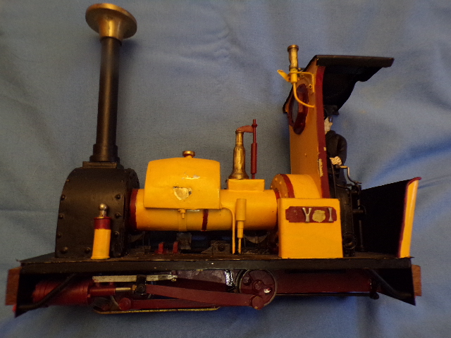

It has a 32mm gauge scratch-built chassis, but the motor has expired. The bodywork is brass and shows signs of wear. The paintwork is a little rough and needs attention throughout. So, some drastic action is called for....
I tried Nitromors first, but to no avail! However, the paint could be chipped and sanded off the brass as it had no primer beneath. This is it now with an etch primer awaiting a top coat....

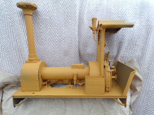

Continuing with the Emett loco a coat of filler primer has been applied. This will disguise most of the earlier paint issues and various bumps and injuries suffered during its lifetime. Some of the brass fittings are masked, others removed...

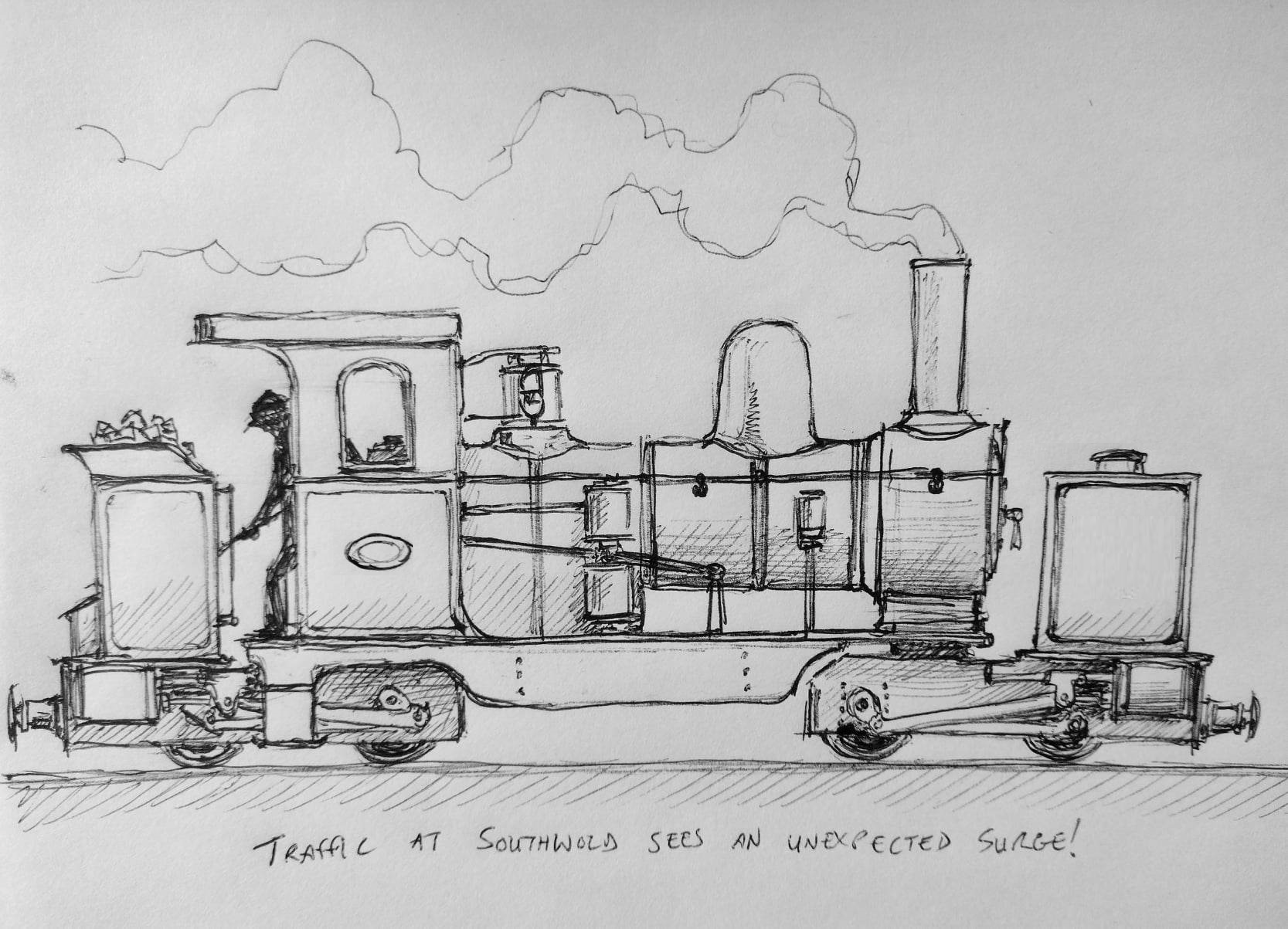

I'm sure you remember the wonderful 'Stratfordised Baby Garratt' design by Theo Jalil and shown in the thread 'DVLR No. 5' by Dr Bond, well, I expressed my interest in building one at the time and have now begun the project...

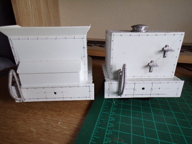

Continuing with the Garratt, more detailing to the water tank and bunker. View first of the outer faces of both units...
Secondly, a view of the inner faces of both ...
And a view of the boiler tube set into position awaiting cab etc...
Rivet detail has been added along with steps, fire iron brackets etc. The batteries are in packs, one either end in the tank and bunker.

Emett is my passion and I couldn't resist concentrating on its return to health. In many ways I felt the need to restore this loco as it had a historic connection to me from some years ago. I knew the maker and wanted to put it back to working order.
The previous pictures show it as acquired with earlier restoration paintwork, possibly by Peter in later years when he was less able to do it as well as he would have liked?

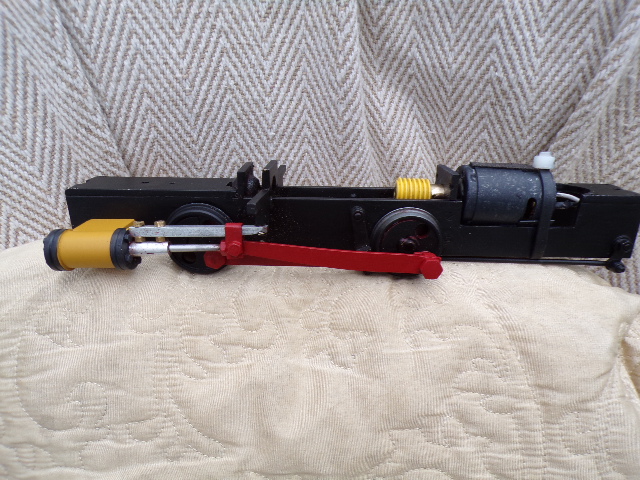

During the stripping down of component parts I tested the running, which revealed a dying motor and stripping gears. The original 3 rail pick-up skate had to be removed and the whole assembly cleaned, fettled and re-painted...
The coarse brass gear wheel was showing wear from the original steel worm, so a replacement Meccano plastic worm was fitted to the new 12v motor. It now runs smoother and will be powered from a trailing wagon with R C Trains control.

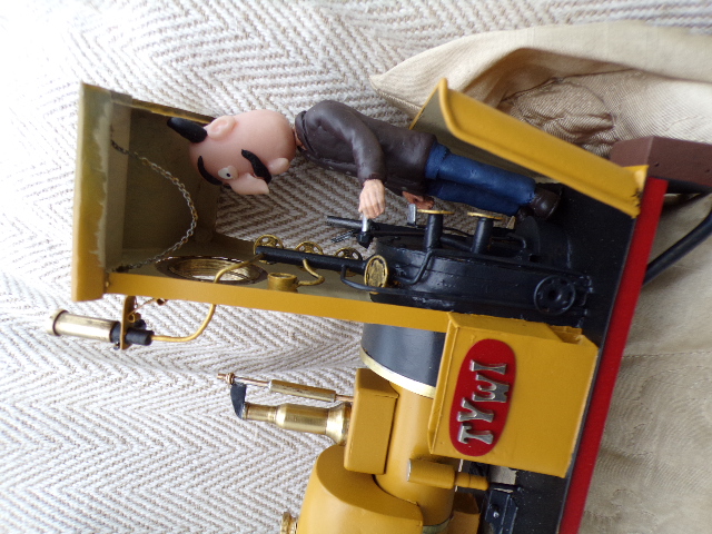

The bodywork needed several repairs which showed up after the paint was stripped. In those early days Peter had used what material was available and leaned on his experience in boat-building. So, the saddle tank had been carved from balsa and covered with very thin brass sheet, which had been beaten into shape. It was splitting and needed restoration so I coated it with Milliput, smoothed to shape and painted all surfaces with filler primer.
Brass parts have been cleaned and polished and the original driver figure given the 'Emett' treatment. This meant the attachment of a more appropriate head, resulting in the need to shorten the body to fit under the cab roof. About 15mm had to be taken from his legs, although after a short spell in intensive care, (at least 5 minutes), he was able to stand on his own two feet again!..

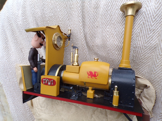

I am fully aware that this is repair/restoration, and not conservation, but it has brought this model to life again.

Agreed Rik, I think Peter (the builder) made an excellent job of capturing the style.
This is the 'Nellie' locomotive which ran on 15" gauge, passenger carrying railway at the 1951 Festival of Britain Exhibition. It is easy to see the influence this locomotive had on Peter's model. Peter named his model' Tywi', Welsh for the River Towy, which runs by the village where he lived.

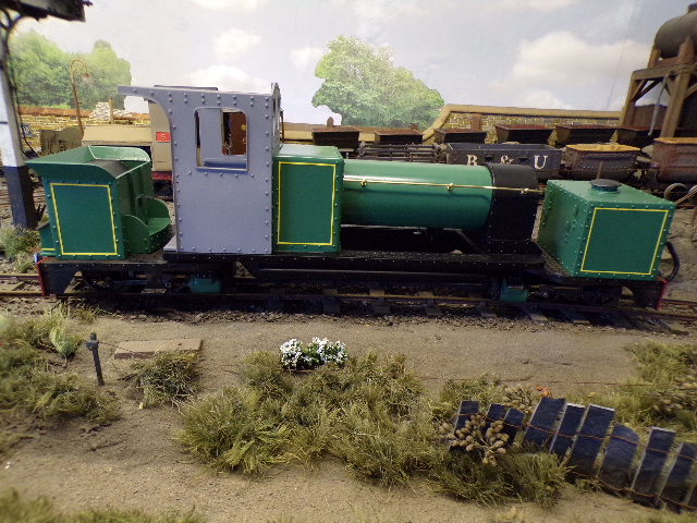

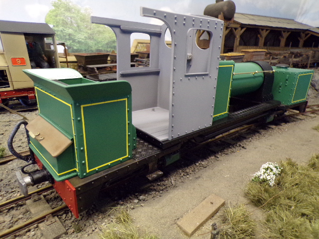

Post by Peter Butler » Sun Dec 10, 2023 11:24 am
An update on the Garratt....
Much of the bodywork has been painted, other than the cab, and some pipework added. I have been concentrating on the cab interior fittings, gauges etc, but can't install them until the cab interior has been painted. The spectacle rims have arrived from Keith but the same applies to fitting them.
Yellow lining, boiler bands and handrails fitted, light weathering and matt lacquer finish...
There are many more features still to be fitted and I have prepared them ready for attachment at the appropriate moment.
