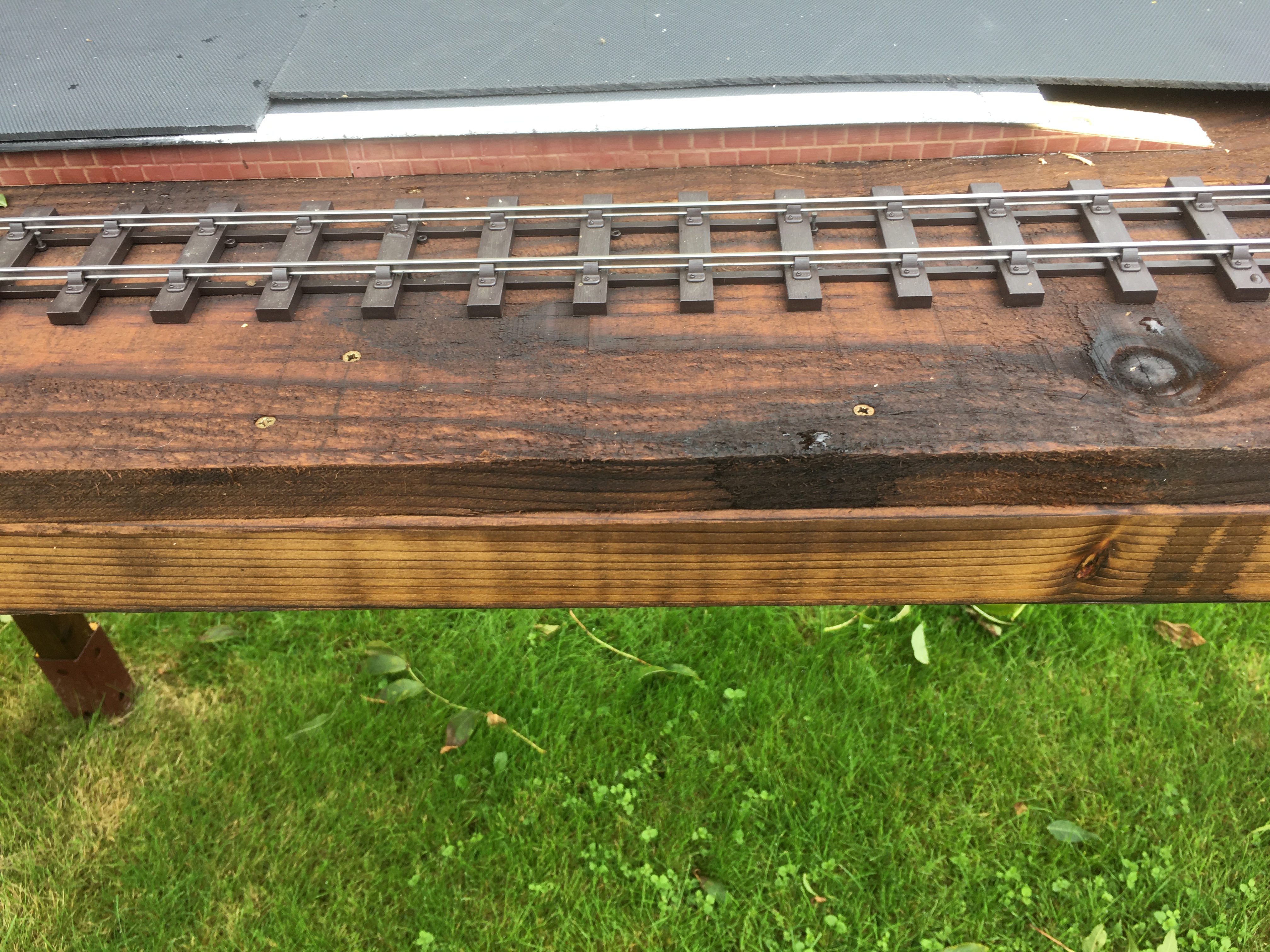

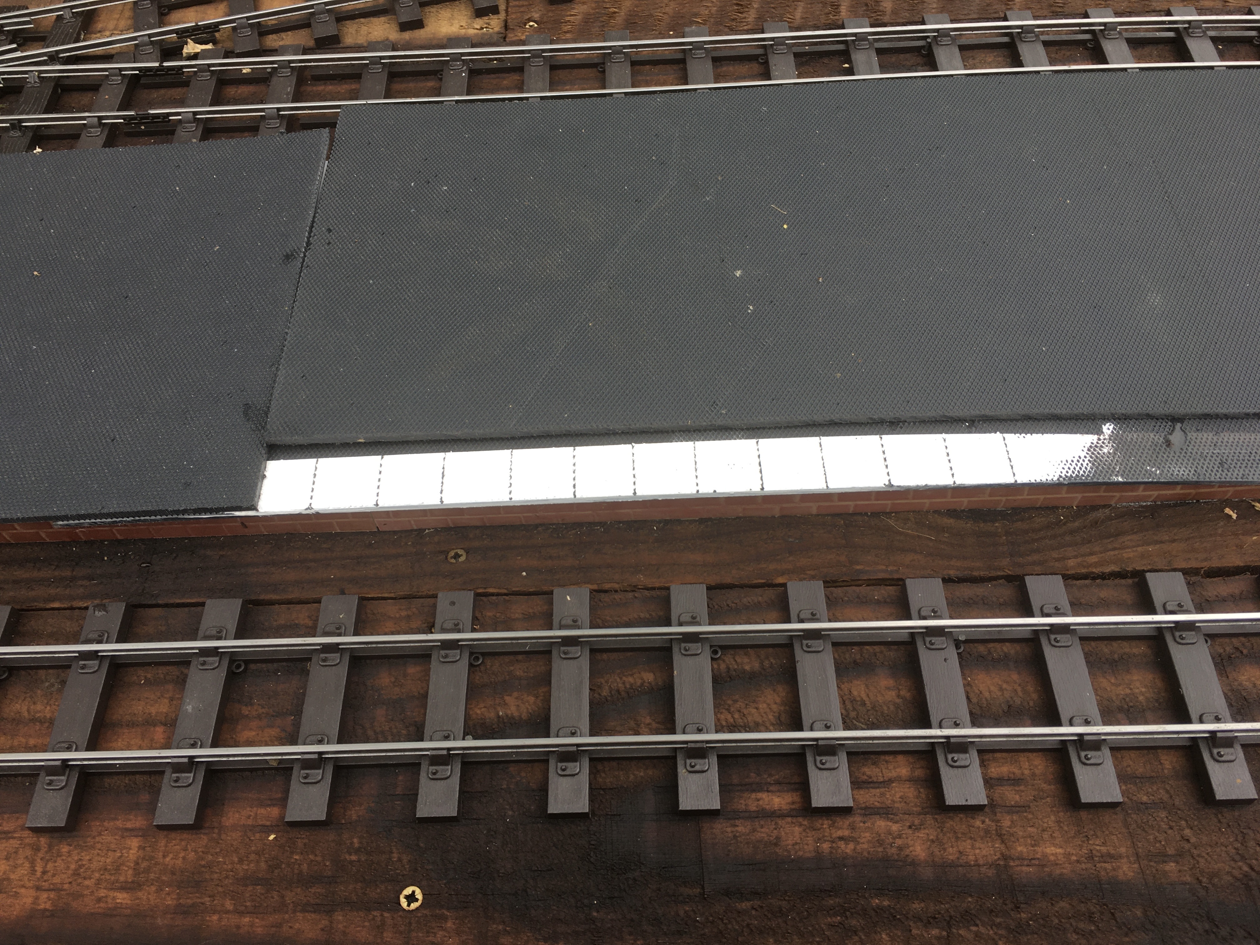

Platform experients.
The recycled plastic sheet I am using for the platform surface is textured, a bit of a regular geometric pattern but fine from a normal viewing distance. The material does not accept glues, the surface is a bit 'oily'. I wanted to get an edging so have been playing with various ways of doing it. in all cases I masked off an area of a spae piece of the board
This shows the result of several coats of exterior wall paint straight onto the board. It is difficult to fill in the pattern and the paint creeps under the edge of the masking tape into the diamonds!
In Peter Butler's thread there has been discussion of filler putties, I have Perfect Plastic Putty and car body filler putty. This photo shows the result of two coats of PPP followed by two of the paint, much better filling of the pattern and a much better edge, BUT the PPP is not water proof.
In both of the above cases I scribed across the finish to mark individual paving stones quite successfully.
Two layers of Holts Cataloy scraped on, allowed to dry fully then sanded lightly before two coats of paint. The masking tape mostly pulled off leaving a good edge, scribing across the white band caused lumps to chip out of the Cataloy, a knife drawn across did not give a good line, simplest to use an HB pencil. I quite like this version, only 18' of platform edge to do.
Lastly a view showing the platform face but not the detail of the white surface.

- Posts: 5723
Just out of curiosity I searched Google to find more information about the use of white lines on platform edges. I already knew they were introduced during WW2 for safety reasons on commuter lines etc. However, there were instances where they were not required and I doubt very much that narrow gauge lines would have needed them at all? Many NG lines had little in the way of identifiable platform at the time, let alone edging!

Thanks Peter,
I think it will probably look better with some sort of edging rather than just the black plastic. Maybe some grey paint would be better than the white, I'll have to look out for some match pots to play with. Having said that, the Cataloy paste is grey!
