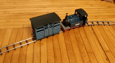

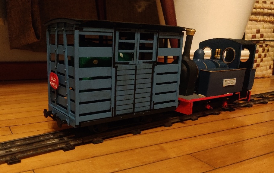

Testing out the new cattle wagon after doing some electrical work on Thornas, and certain flaws in the design and construction of the latter are becoming evident with more running time. The frame and cab floor are both splitting around holes that should be at least reinforced and more likely bushed, the motor mounts need redoing, and the fly cranks are slipping. The shortcomings of 3D printed parts are really coming out-- though to be fair the loco was originally intended to be an unpowered prototype. A redesign of the chassis with motorization in mind is in the works.
With side rods damaged and removed, poor THORNAS struggles to shift just one cow.

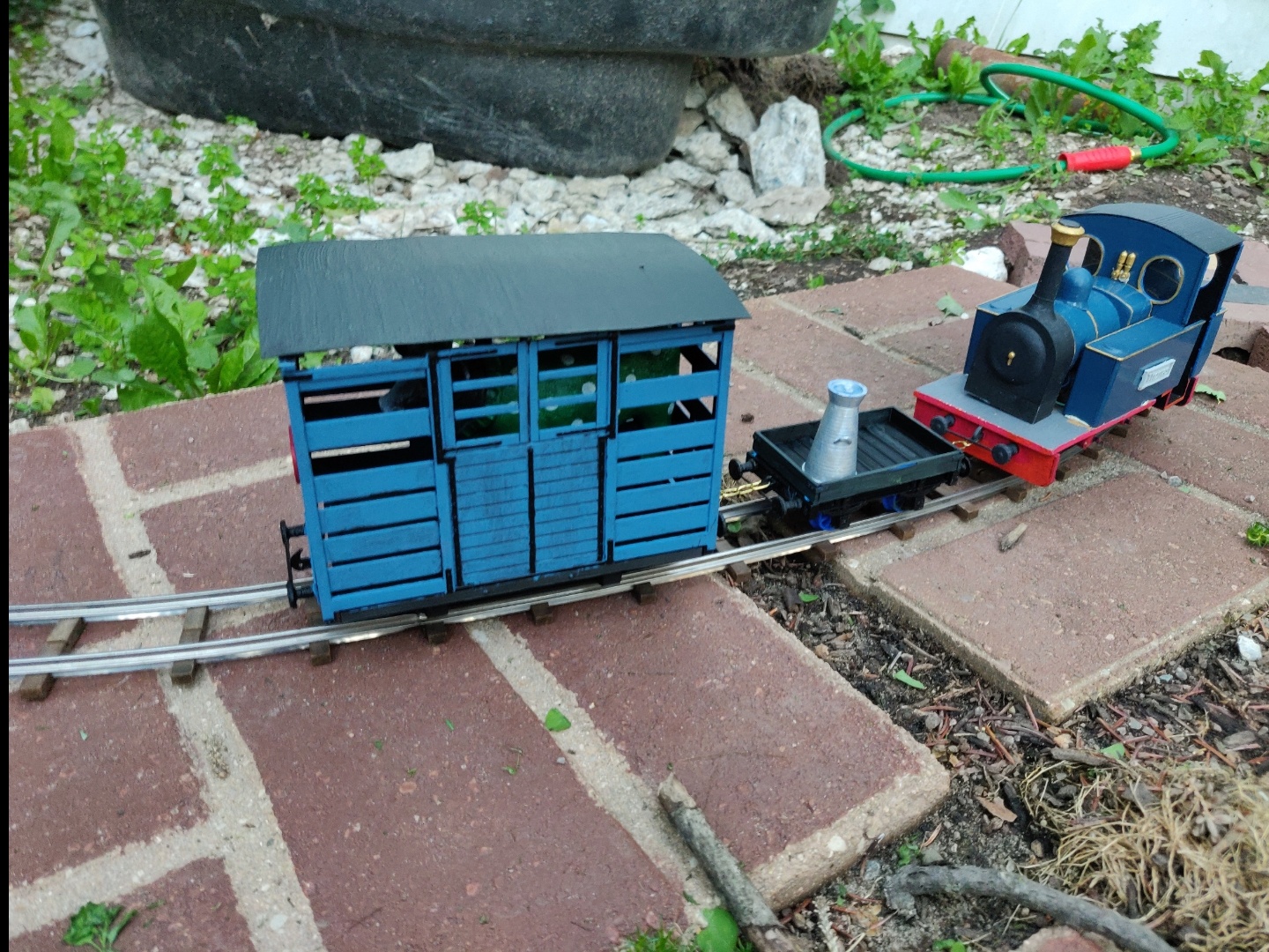

THORNAS poses on a section of temporary track, showing off the new full service dairy train and the state of construction on the patio area.

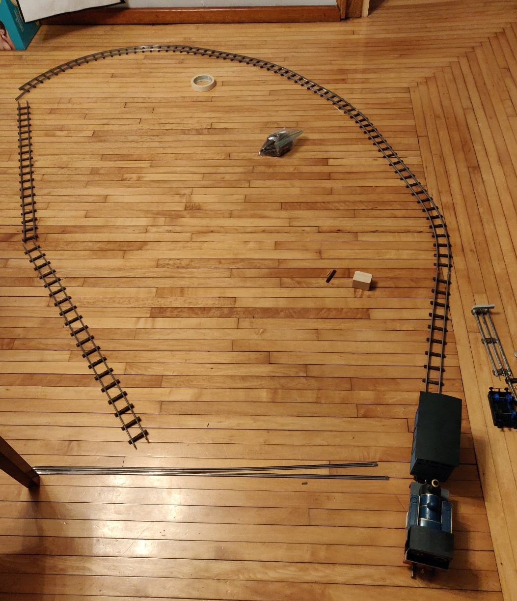

I got so excited to play with track outside that I decided to spend a bit of time preforming the curved sections to fit the eventual plan. Might be jumping the gun a bit since I don't have the earthworks anywhere near finished, but the track plan is small enough to build in the dining room and bring out later. Need to finish forming a few more straight sections into curves and smooth out the track a little more, but this will hopefully allow me to run some trains and spot any major trouble points before completing earthworks. Next I think I'll mock up the ponds to make sure the curves are laid out correctly.

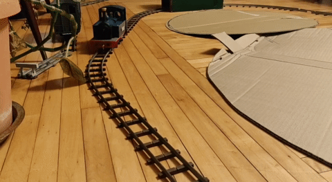

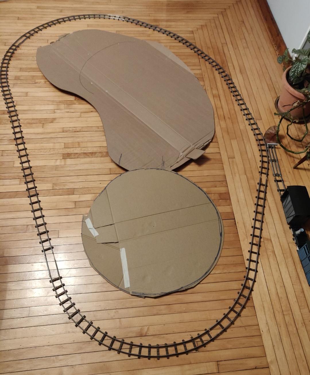

With the ponds in place, the track plan becomes a bit easier to visualize.
Just finished the full loop including the traced mockups of the ponds, and I had just a foot and a half of track left over. Need to clean up the sleepers in a few places and need to fit some permanent rail joiners (just toothpicks for now). First full lap with and without a wagon went well except for some rough joints and a tangle with the local flora.

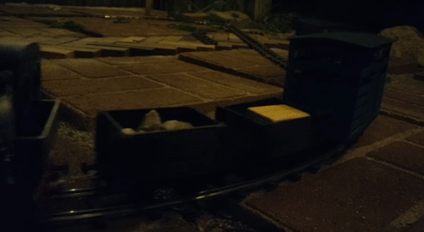

Evening freight on the NVT tonight. We were enjoying the nearly-complete patio so I laid down the track temporarily and had our first outdoor running session. Still need to iron out a few issues with the track and some poorly weighted rolling stock, but Thornas put on a good show.
The stone wagons from page 1 have returned!
Very happy with the speed and power, but could use some more weight to improve tractive effort.

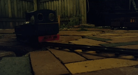

A couple of tealights were pressed into service as the firebox and brake van glow. I think I'm going to need to fit some lamps for nighttime running... What would Mr. Spectre have to say about that!
