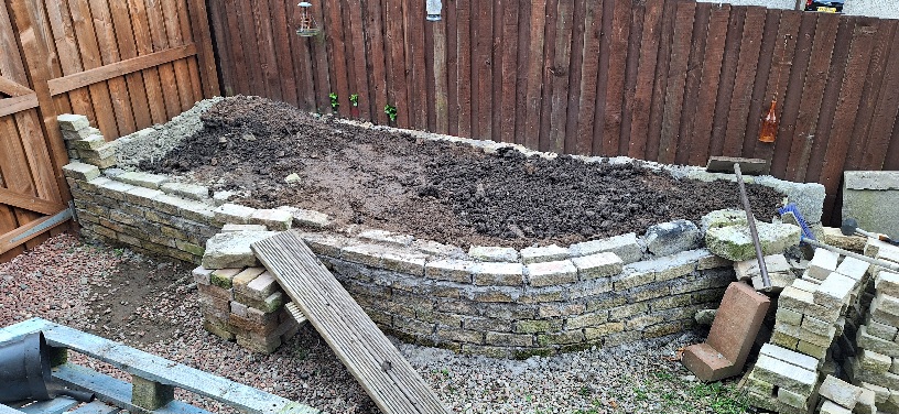

Lots of sweary words, thank goodness that's the raised bed cum return loop and steaming siding back filling complete, some flaming job it was shifting all that fill material by myself.
I left the final coarse of bricks off, one so I didn't damage the top line of bricks, but mainly because it meant I didn't need to humph the wheelbarrow up the extra height, I'll not miss the work that has gone in to this part of the line.
My wife took a video of me emptying the last barrow of fill material, but I cannae share it with sound.
Now I just need to install the shuttering and cast the track bed.

Post by ge_rik » Sat Aug 12, 2023 7:14 am
DafyddElvy wrote: Fri Aug 11, 2023 8:53 pm Lots of sweary words, thank goodness that's the raised bed cum return loop and steaming siding back filling complete, some flaming job it was shifting all that fill material by myself.
You paint a vivid picture. Having made raised beds I can empathise ... :lol:

I would drive in some metal spikes, dexion, whatever you have, and cast with that in the bed. - Your fill will settle!

Phil.P wrote: Sat Aug 12, 2023 11:36 am I would drive in some metal spikes, dexion, whatever you have, and cast with that in the bed. - Your fill will settle!
Do you know what, that is very good advice (not sarcasm) I'm getting some 10mm rebar to cast in the concrete base, I'll get a little extra and drive that in to the ground, thanks.
