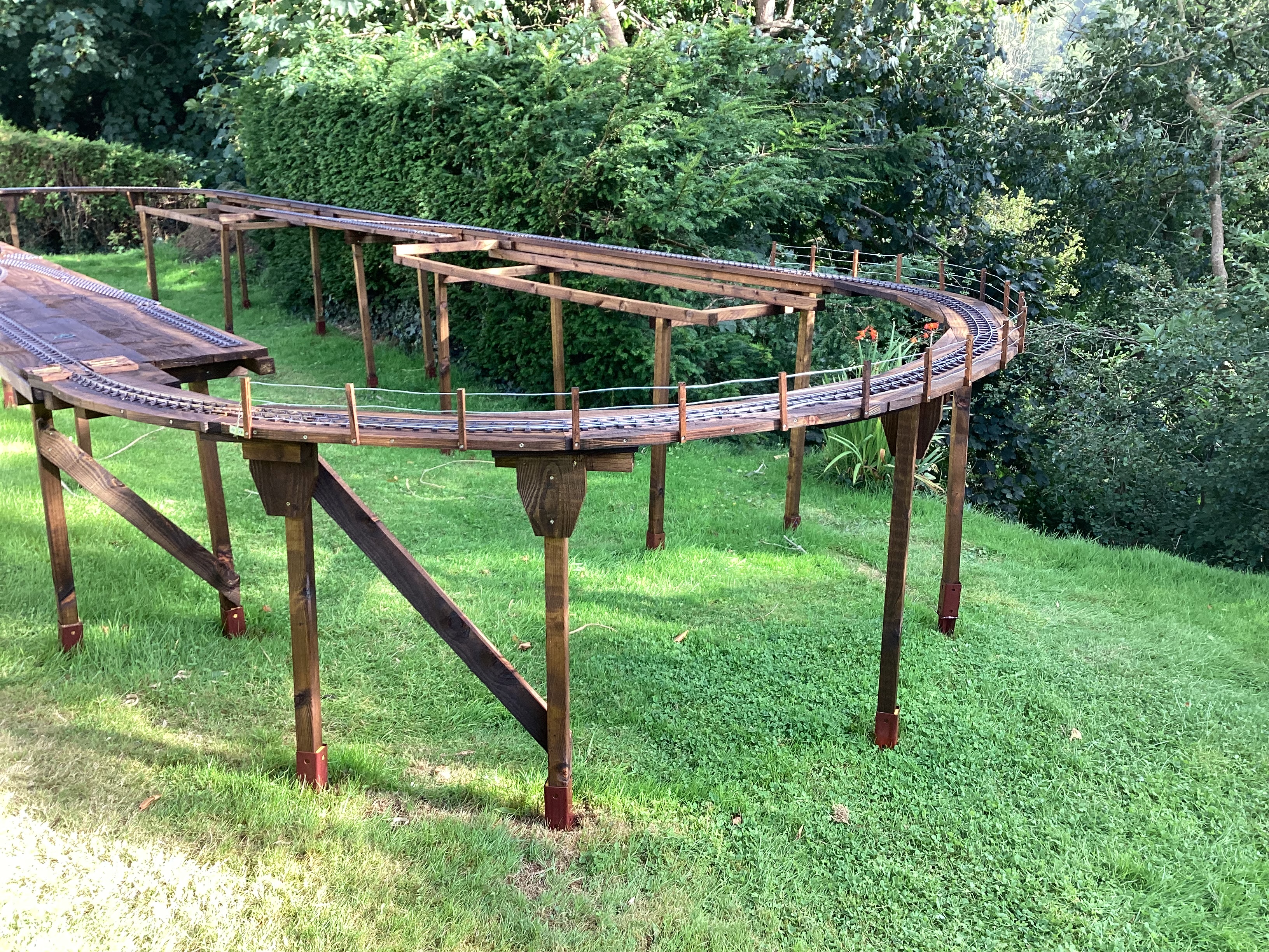

Working towards being able to fence the line I have been adding bits of wood to extend the width of the boards of the curved ends where the track gets perilously close to the edge.
The first photo shows the raw pieces added:-
The second after adding a coat of creosote, the extensions blend in much more:-
I have been preparing 12mm square section beech to make the posts. I shall drill the posts to accept galvanised wire once I have cut them to length. There may be quite a lot of them to do! I intend to screw the posts to the outside edge of the boards. Will see if it works.

gilfachphil
- Posts: 455
This should work:-
The posts were cut to length in groups of eight using an end stop on the radial arm saw then drilled with four holes each using a jig clamped to the table of the pillar drill, a total of 87 were prepared. They were dropped into a bucket with some creosote and then drained and left to dry a bit.

- Posts: 5726
Looking good Phil... we can do speed trials now on your Wall of Death!
