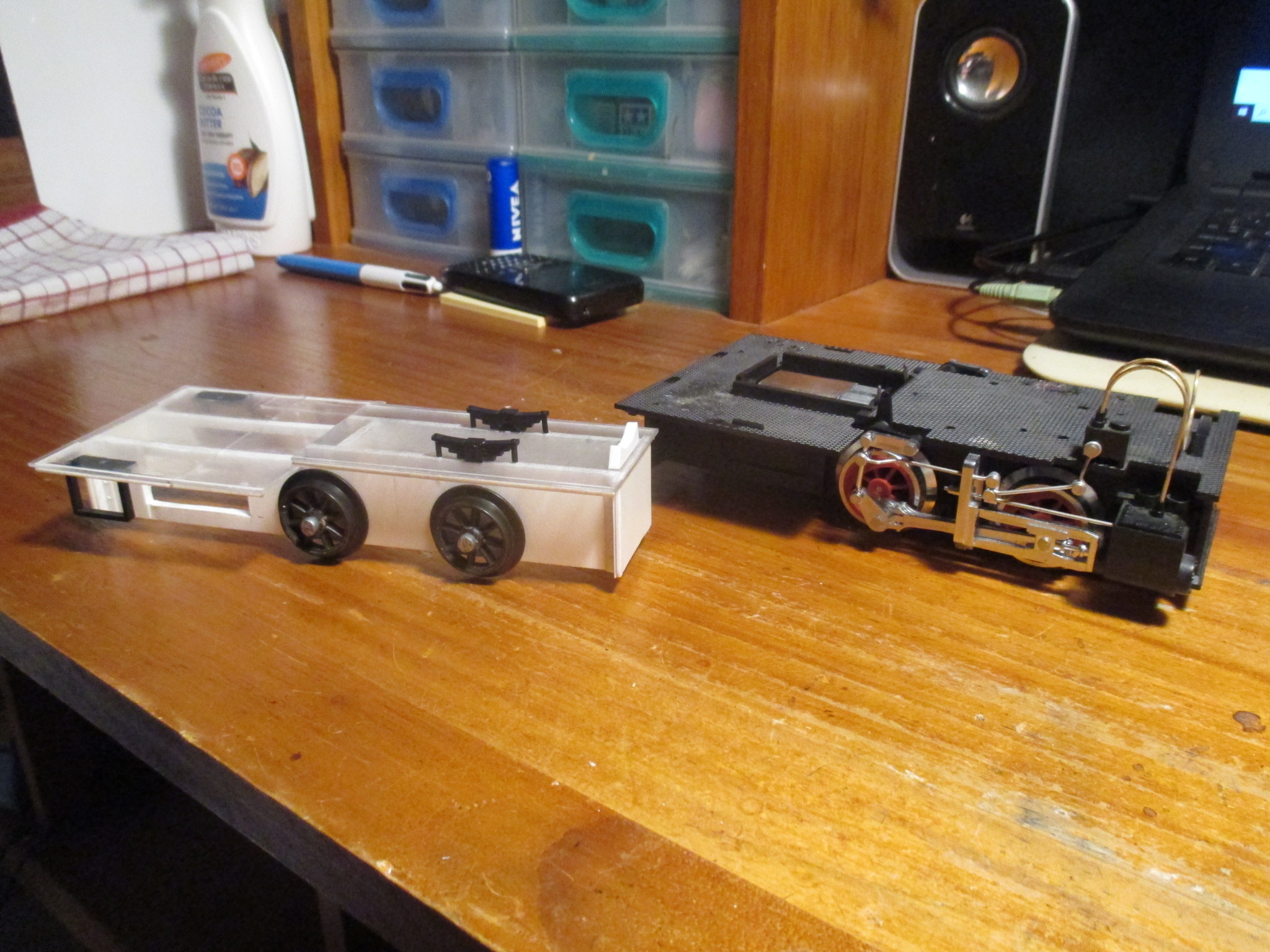

I have a pair of LGB Koppel 0-4-0WTs picked up for cheap, the chassis of which I plan on bashing into a Koppel Mallet somewhere down the line. This leaves me with a pair of redundant bodies.
From some rough measurements of the motorised chassis, a dummy set of frames were cut from foamboard offcuts. The footplate and just about everything else is also leftover material. The wheels came from a NewRay (?) toy bogey wagon, and the axles are cut down nails. The springs and steps came from the donor loco.

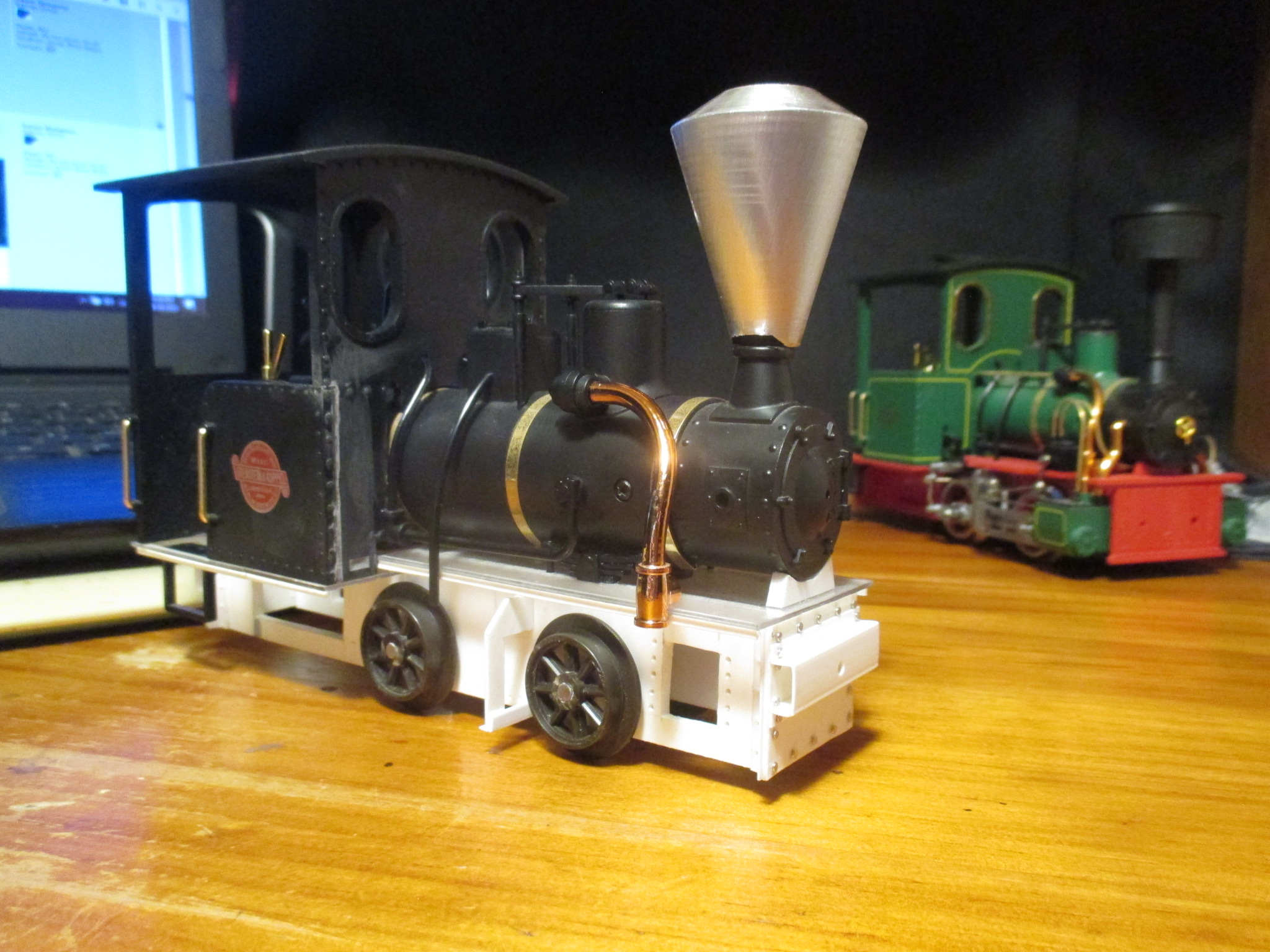

Scratching cylinders and motion is more effort than I'm willing to put into this project, and I think encouraging nature to obscure the missing bits would be far more interesting.
The ridiculous lower cab extensions were cut away and tidied with Squadron putty. Some detail parts were removed and their mounts filled in where appropriate.
A pair of "near enough" motion brackets and half-dismantled couplings were scratched from styrene scraps. The frames were made to look as though they'd been robbed of their cylinders.
The chimney was turned from a 4" long lump, of 2" dia. aluminium bar, that I had previously used as a camshaft bushing remover/installer.
Because it wouldn't be one of my machining sessions without some obvious sequencing mistake, I found the lump was slightly too long to drill through the centre with the drills on hand. I couldn't turn it around in the lathe chuck and drill from the other side, as I didn't want to damage the finished end by gripping it in the chuck.
In hindsight I could've used some brass strip as soft jaws, but I digress. I had to drill from the other end by hand, which of course means the centre hole is oversized and not perfectly centred.
The point of all that is to say, when I put the now-redundant bushing puller to good use as chimney-making barstock, I found that when I finish-turned the bottom of the chimney, I'd started cutting into the off-centred bore. On any other chimney this would be game over, but for a boneyard loco, it looks like the base of the chimney has rusted out.

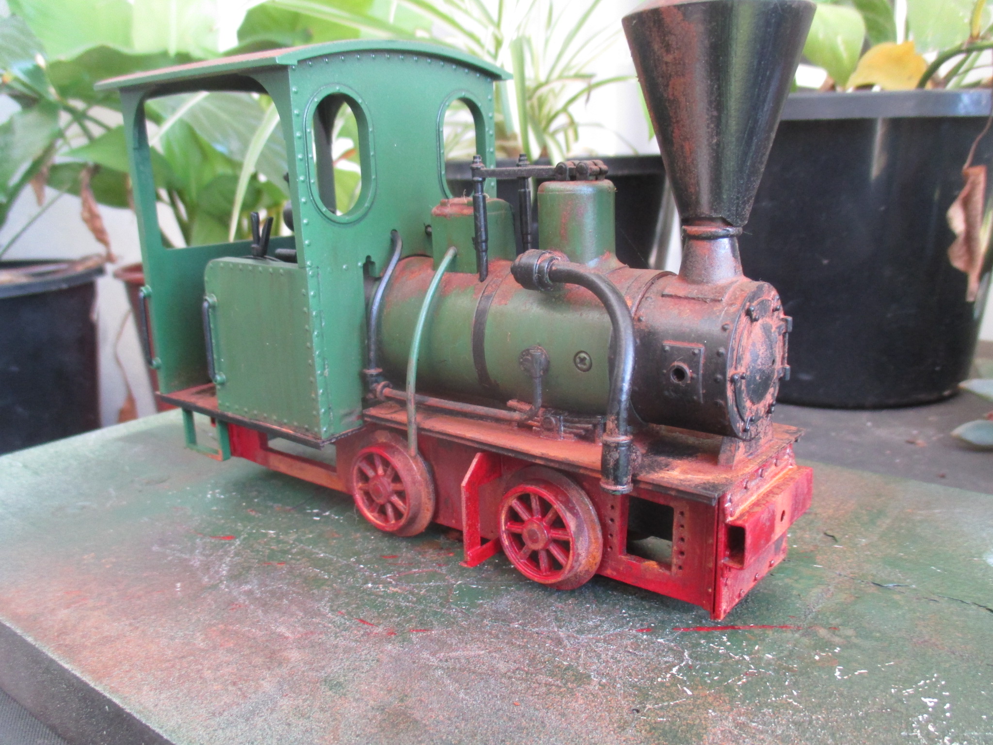

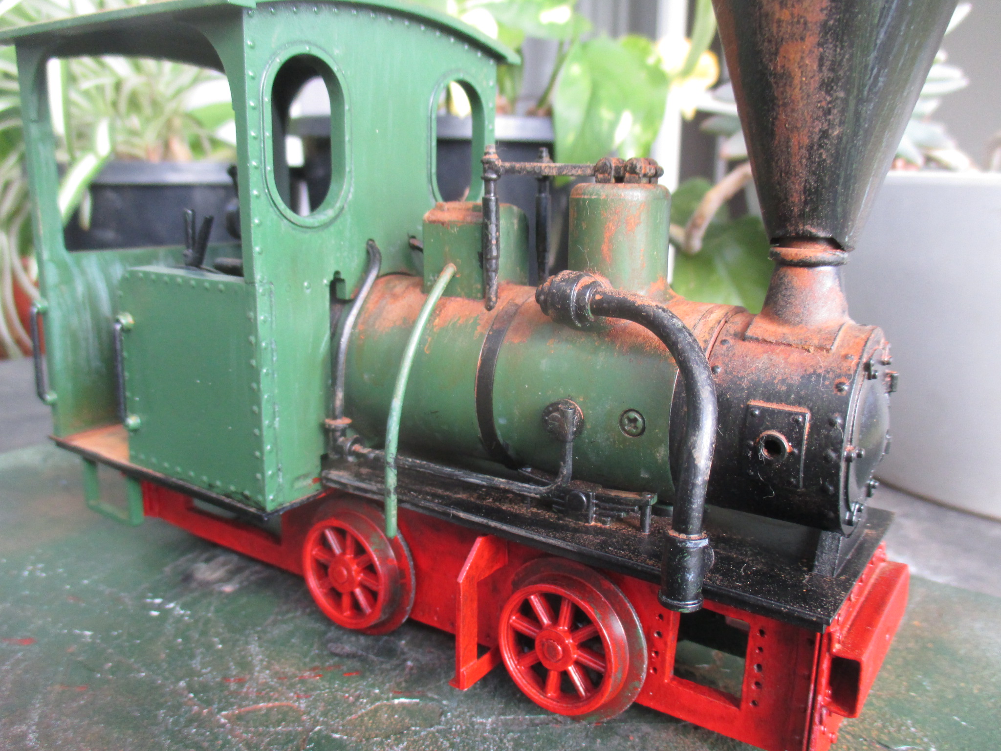

20/06/23
For whatever reason, my vision for this forlorn loco is of faded black, with green and red showing through chipped and peeled areas.

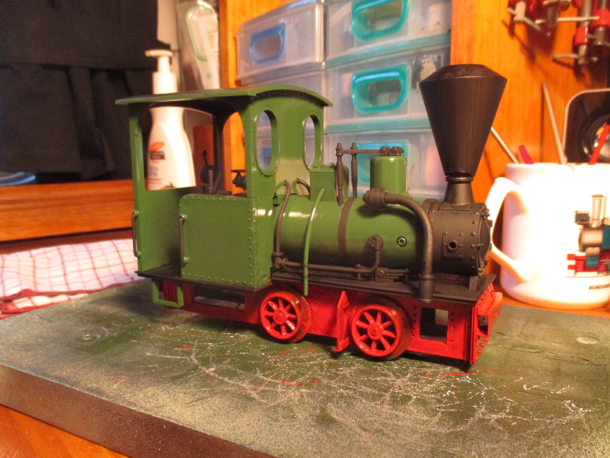

After a coat of black etch primer, the loco was spraybombed with green enamel. The rest was picked out with Tamiya red and flat black, as soon as the green was dry to the touch. I'm not fussed to let coats harden or even cover properly at this point, as little of this will be seen when I'm done.

22/06/23
Back to the modelling.

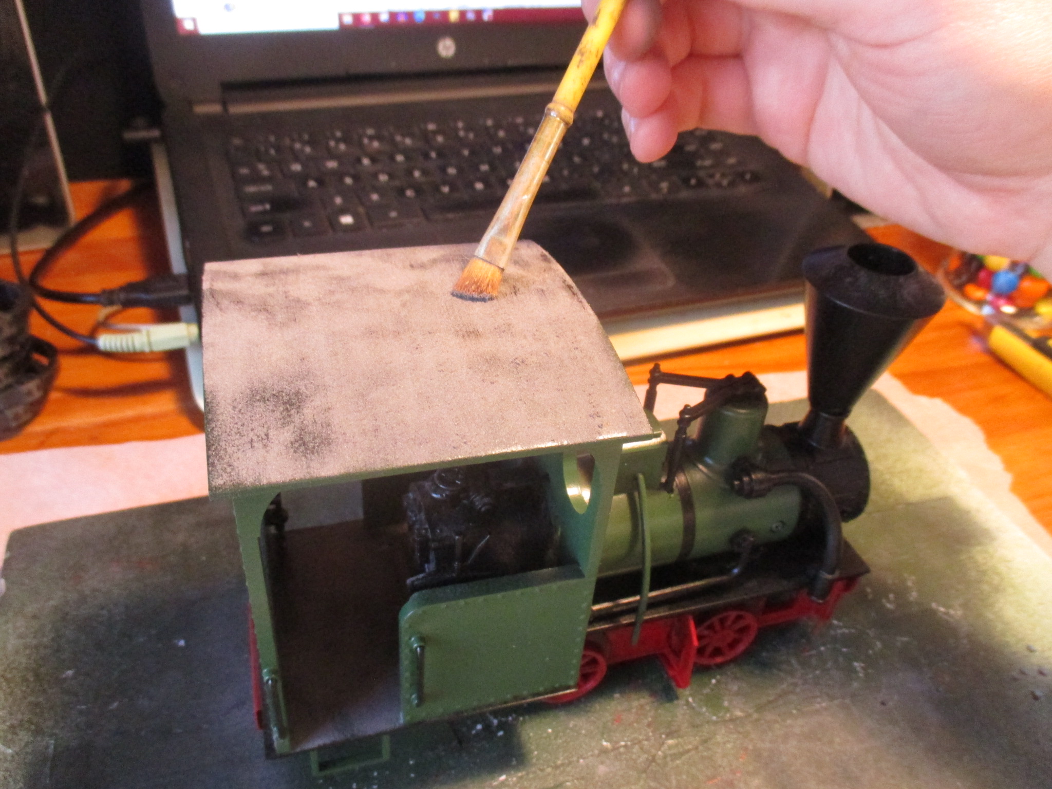

The roof was given a coat of clear spray paint, and fine (consistency of dust) iron powder sparingly sprinkled over it. This was done over a piece of kitchen paper to catch the excess, which was knocked loose by a gentle rapping against the model. A soft but stiff brush was used to streak the iron particles in the direction of rainwater runoff.
I'm aware of real rust modelling products that use two or three different substances to create the effect, but a packet of iron dust from chemistry suppliers on evilbay, goes much farther for a tenth of the price.
The clear paint I used came from the back of the cupboard, because rather than being "matt" as advertised on the tin, it's gloss. This doesn't matter as it'll be clearcoated when finished. It also dries far too quickly, meaning I can't "streak off" much excess iron powder before the paint touch dries. I usually use a cheap gloss enamel spray for this, but I'm out. This means I have to work in small sections of the loco at a time, rather than doing the whole thing at once.
Will get another can of enamel when I have the chance..
The iron powder was then soaked with vinegar using a fine mist sprayer and left to dry somewhere shady.
Once dry, you'll find the iron has started to rust. At this point, the rust is likely very orange-looking. If you're modelling very new rust, you could stop there.
The more times you hit it with vinegar, the darker and older the rust will look. As always, it pays to test on some scrap first.
Don't bother with water, or you'll take weeks to get a result. I don't know if it's the clearcoat or what, but there were a lot of white water marks left by the vinegar over the painted surfaces.
24/06/23
Cotton buds wet with alcohol removed these marks, and proved ideal for feathering edges a bit and removing excessive rust.
3-4 sprays of vinegar later, and it's looking very nice. To my eye, the rust is still a bit bright. Another coat of clear will tone it down. If you missed anywhere when applying the iron earlier, now's the time to apply some more to those spots before the clearcoat dries. But for something I'll paint over, this is fine. Most of this rust will be covered up, only showing through peeling black paint, and will lend the still-adhered black a subtle rust-blistering effect.
It's been some years since my last go at real rust, and I'm figuring it out again as I go. Referring to my old blog post has been helpful.
I've used the salt-chipping method in the past, but have never used hairspray to get a peeling effect until now. More to come...

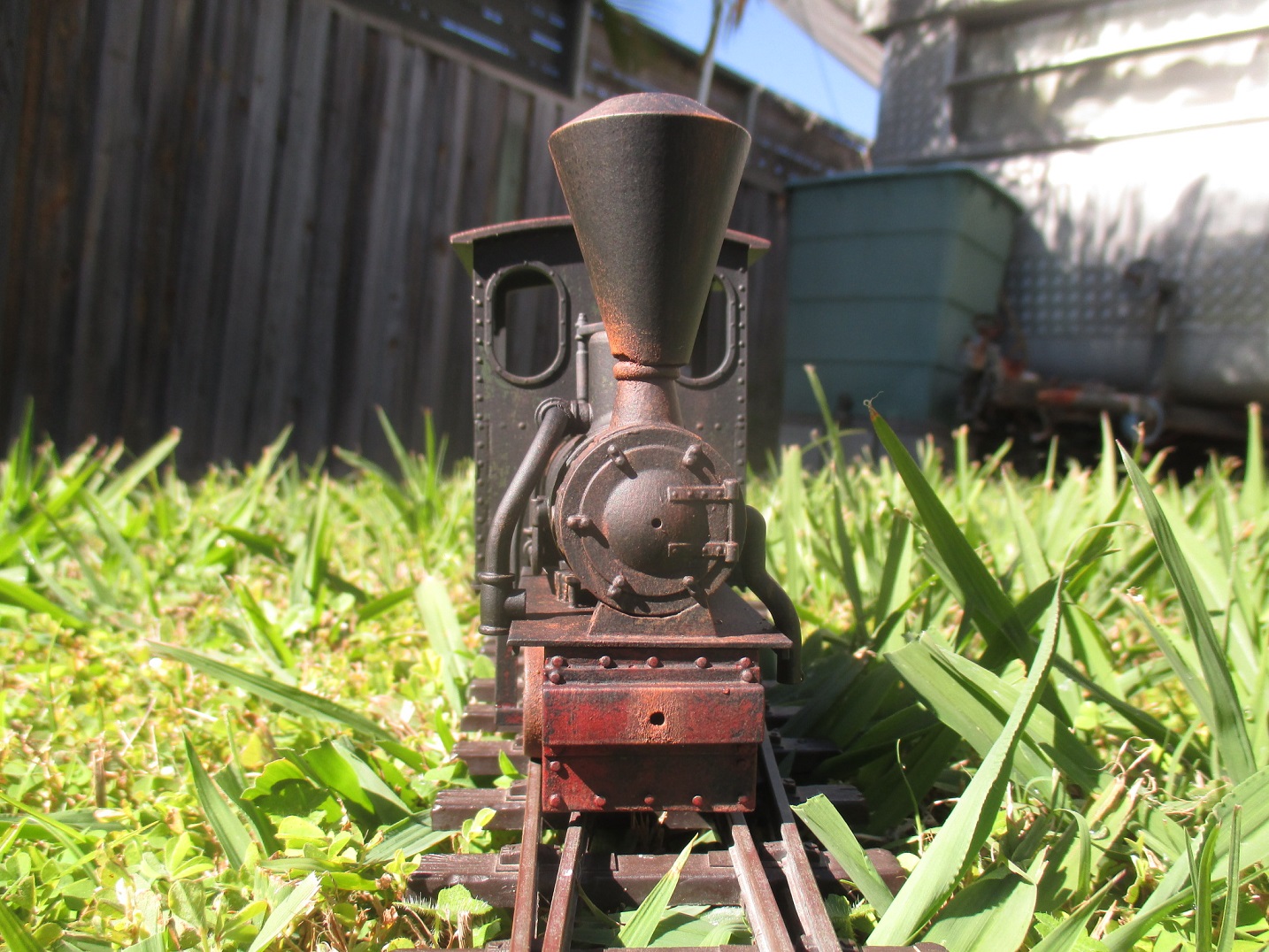

10/07/23
Here's an excellent detailed guide on hairspray chipping. It does a better job of explaining things if you aren't already familiar.
After sealing the previous acrylic paint with an enamel clearcoat, the loco was given two even coats of cheap hairspray. This was left a few hours to fully dry.
I then topcoated the loco with a satin black aerosol enamel. Matt, satin - sheen doesn't matter because it'll all be sealed under a clearcoat in the end. I just used up what was getting low.
Enamels aren't ideal for hairspray chipping, but I got away with it on the weathering test dummy Stainz. I try to avoid using the airbrush whenever possible.
After topcoating, the paint was left to barely touch dry. I then scrubbed at it with paint brushes and water.
Short, stiff and preferably thick bristles are preferable - think the toothbrush-like bristles of extremely cheap and nasty small paint brushes.
A toothbrush will also work, but it's a bit over-aggressive for what I wanted. Here's what I've ended up with.

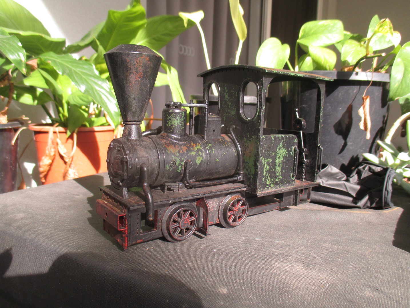

For lots of things, you could stop right there. But I felt there was a little too much underlying colour showing, so after another clearcoat to seal what I'd done so far, the hairspray and black paint was repeated to cover up some of the green and red again.
After that, it was various washes, drybrushing and spot-applying more rust to stippled-on clear enamel where needed. It's been one of those "10% weathering, 90% fixing your mistakes" jobs. Lots of corrections, even more overcorrections, and of course correcting those corrections..

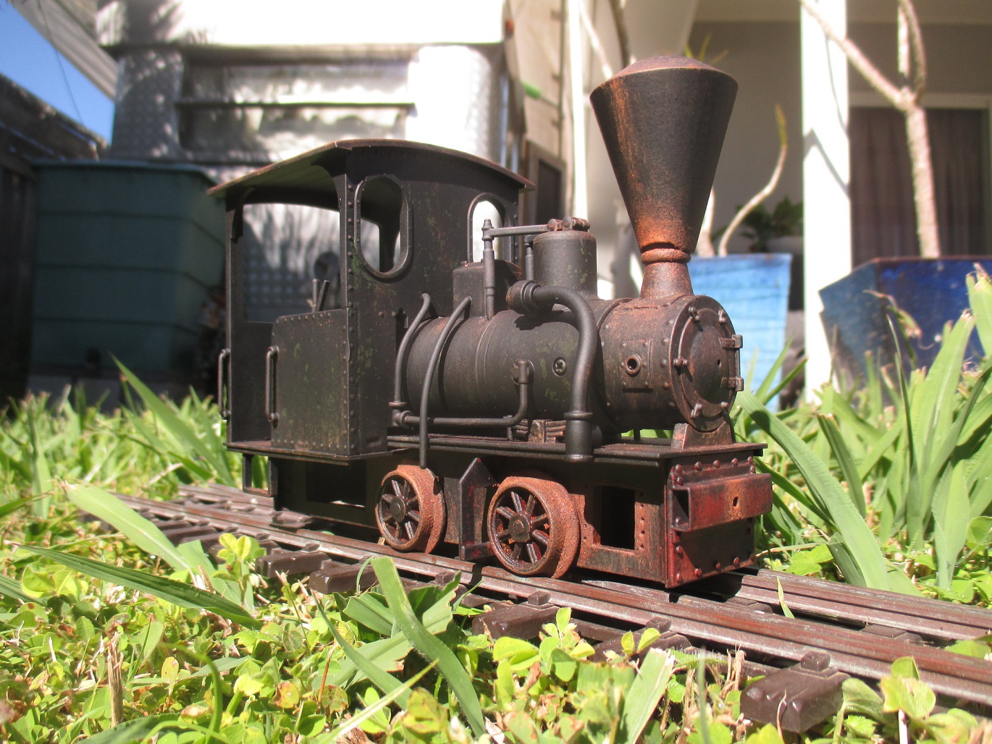

Since these photos were taken, I've finished the loco over the past couple of weeks.
I took some photos this morning, but looking at them through the computer screen now, they're rubbish. I will use a better camera tomorrow..

Forgot I had a swap meet to attend, so "tomorrow" turned into "the next day"..
Once I can get some moss, shrubs and decrepit wagonry around it, I think the little Koppel will settle in nicely.

That's some impressive weathering Aaron. I've not heard of that technique before (or if I have, I've forgotten all about it).
Re: A Krusty Koppel
I agree with Lonsdaler, that is really nice weathering. It looks like it's been there for years.
