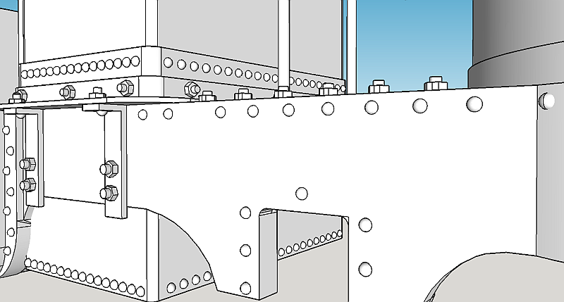

Sketchup drawing screenshot:
Screenshot 2023-05-26 21.14.02.png (82.07 KiB) Viewed 118540 times

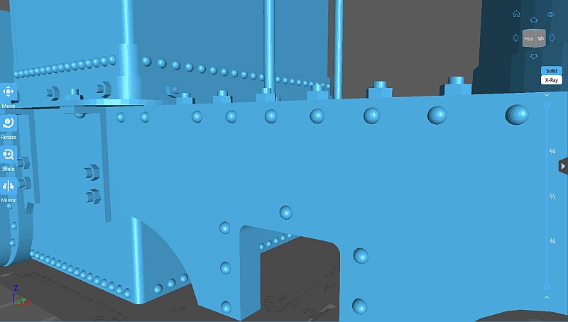

Chitubox screenshot:
Screenshot 2023-05-26 21.13.37.jpg (104.5 KiB) Viewed 118540 times

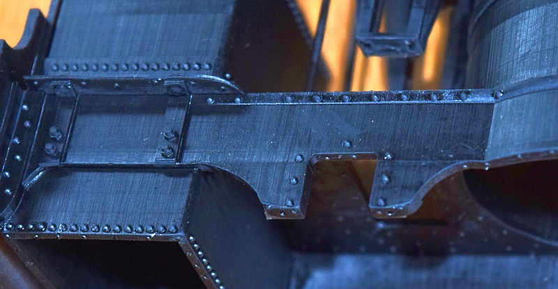

Finished print - look at the row of rivets at the top of the sideframe between the water tank and boiler and you can see that they have a raised border underneath them. It goes right along both sides of the model EXCEPT between the brackets supporting the watertank. It appears to coincide with the edge/thickness of the footplate, which is printed as one pieces with the sideframes but which doesn't exist where the watertank drops between the frames. :dontknow:

The only thing I can think of is that, given that the problem shows up at the same level as the underside of the footplate, it is somehow producing an "elephants foot" type effect which is distorting that layer and subsequent ones, outwards.

Talking about it like this has made me think a bit further. The underside of the footplate is printed in thin air, which obviously can't happen, so I have a forest of supports to hold it whilst the thickness builds up and gives me a nice clean smooth, visible top surface - the quilted appearance of the underside doesn't matter once the model is the right way up. I'm now wondering whether the attachment of that many supports is actually swelling the layers with the support ends in and pushing them sideways.
However, if that IS the problem it seems strange that it doesn't also occur on the water tank which is printed similarly with a forest of supports, plus it also shows up on the curved section of the frames which doesn't have a forest of supports inside.
