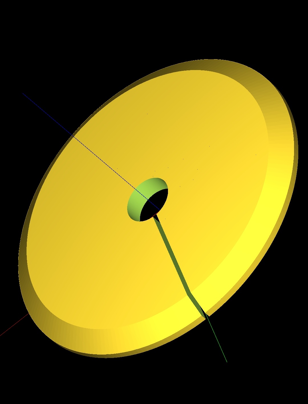

Ooh, is that what's going on with your Dougal? I'd be happy to try my hand at some STLs for 3d printing, it seems like a simple enough thing to model. I should just need the diameter(s) of the wheels and the diameter of the axle. I would do it as a parametric model so different wheel and axle sizes could be created from the same model.
- drewzero1
- Posts: 871
- Location: WI, US
Re: LGB point frogs
I've sniped myself already. Here's an OpenSCAD script for a 3d model possibly approximating Rik's fix. I've used generic measurements from my own stock, but if you measure yours I can easily create some STLs and put them up somewhere.

}- Attachments
- Screenshot_20230518-234317.jpg (112.35 KiB) Viewed 11093 times

Now that looks like a really neat solution. Full marks!
I must get the hang of OpenScad. It's perfect for this sort of thing.
