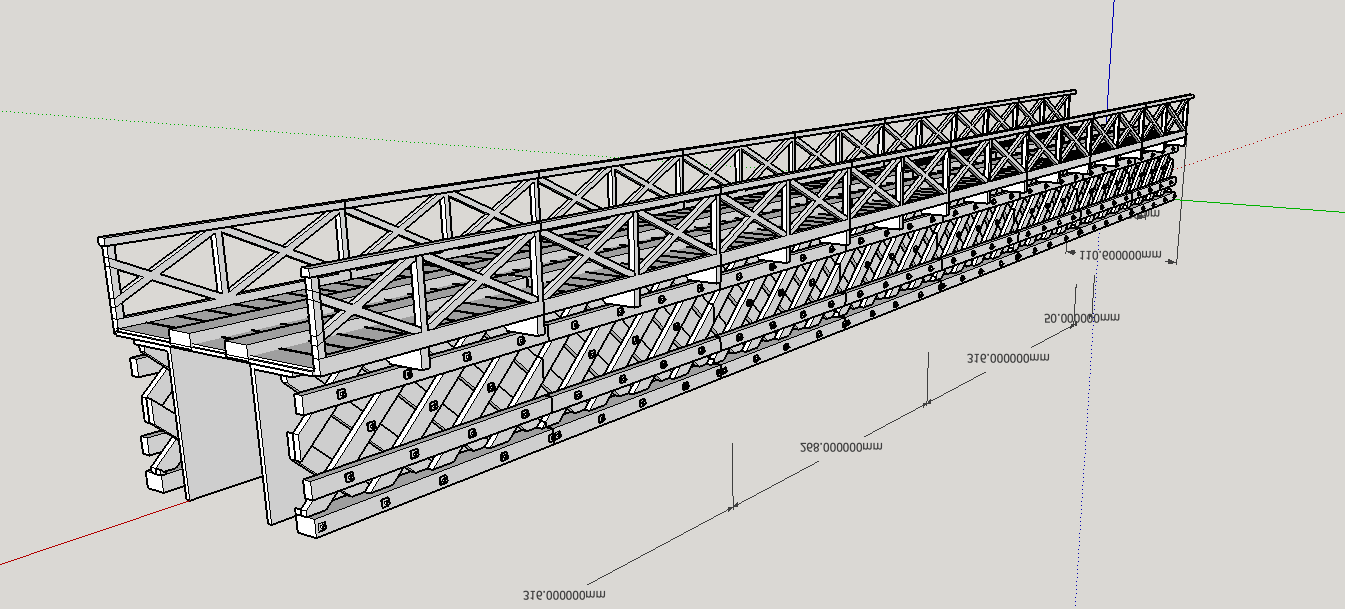

The 3 D model to show you what it will look like:

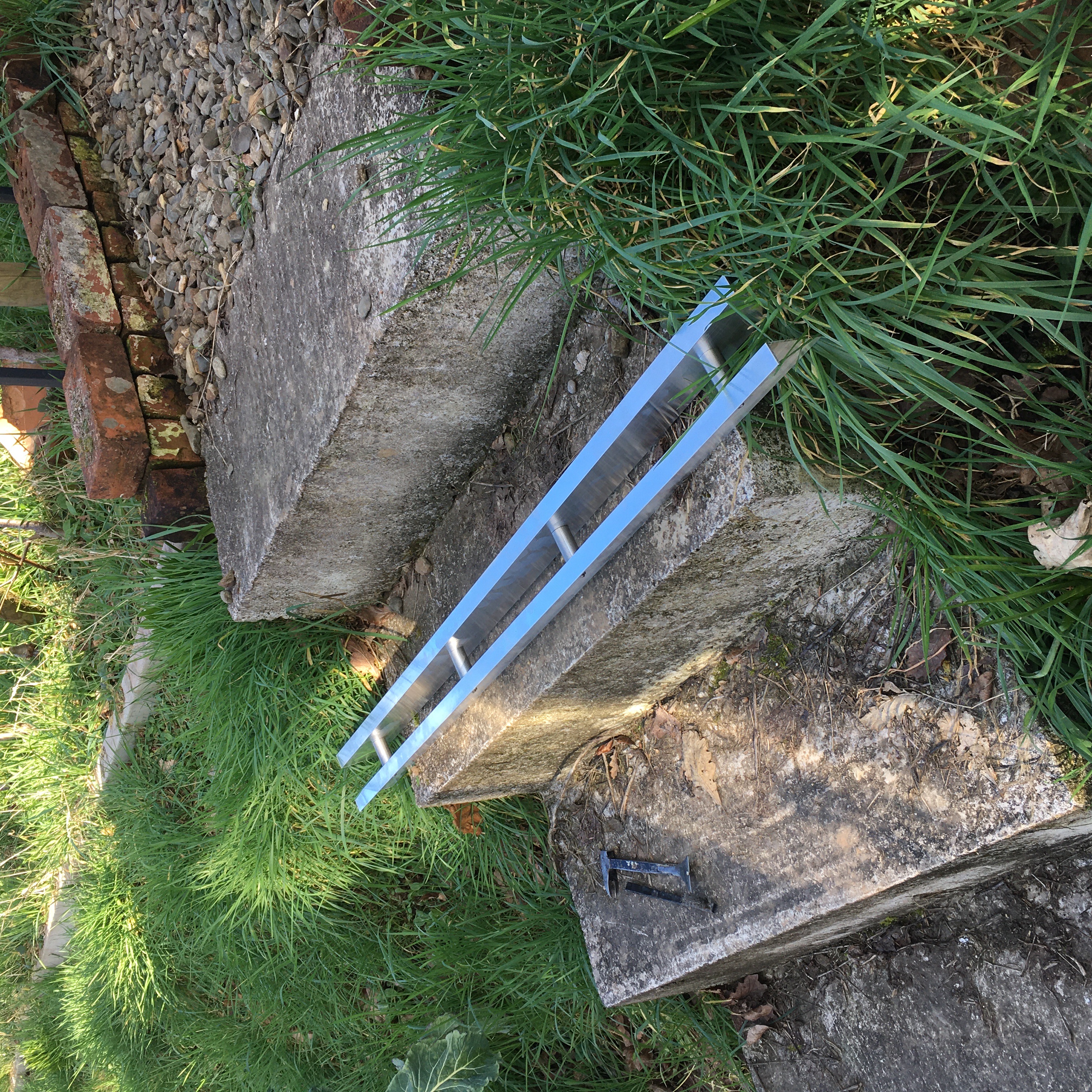

It is to be a composite structure, the strength being provided by an alloy sub structure which will be encased in a filament printed skin. The alloy substructure and the gap it is to fill:
The alloy is 20mm x 60mm angle 2mm thick, fixed 45 mm apart using 4 stainless tube spacers and nuts and M6 bolts. The track will be mounted on a printed planked deck, with longitudinal sleepers printed into place. I think I will print the chairs on at the same time. ( I am currently extending the track using ABS printed chairs. The trick is to wash the chairs with acetone which reinforces the inter layer bonds. )

That is a lovely bit of drawing and the print should be equally impressive. Looking forward to seeing it in due course.

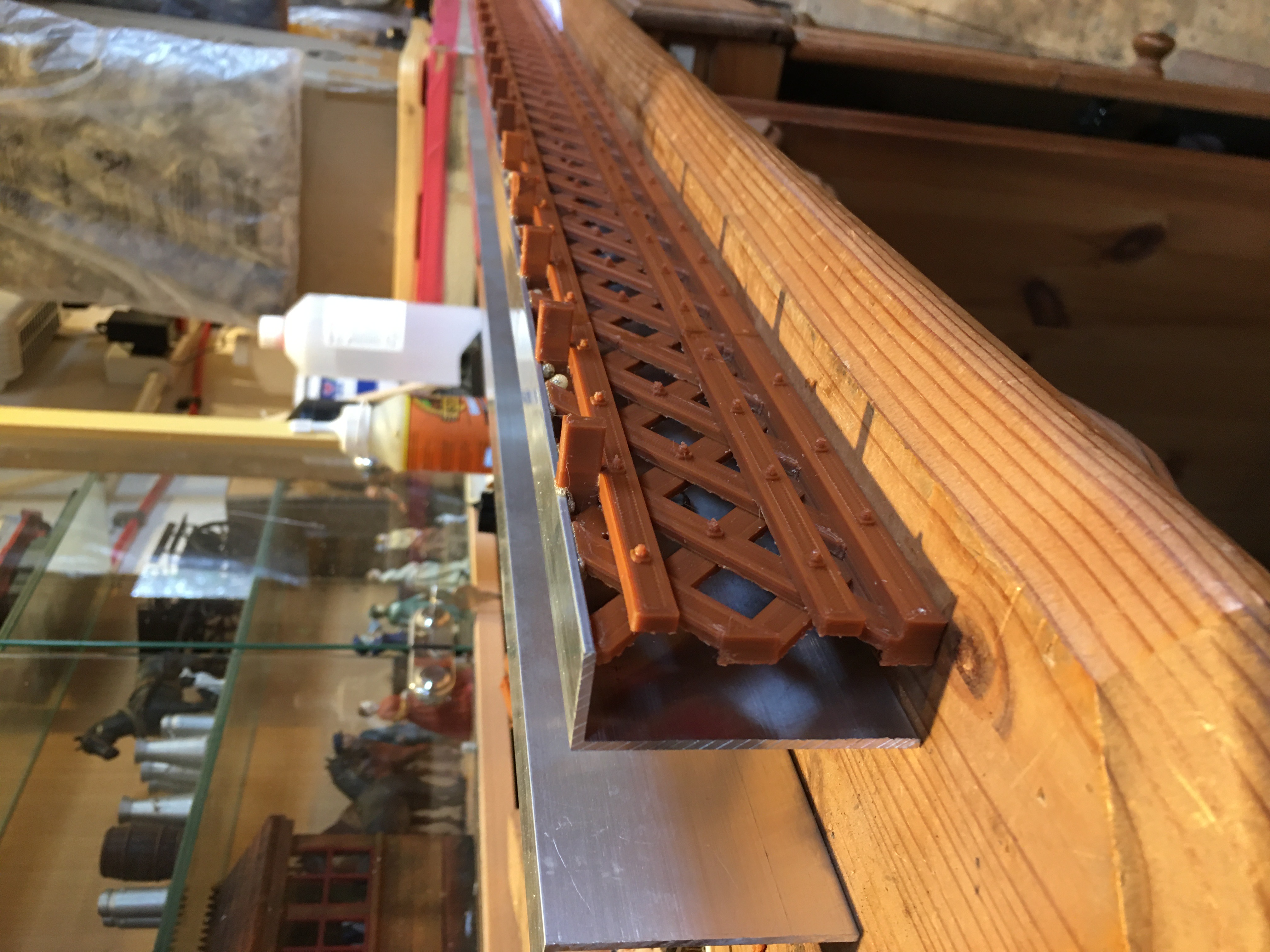

The trelliswork cover for one side of the bridge is now printed and bonded onto the aluminium frame:
That was printed in 8 sections, 2 at a time flat on the bed of the printer. I used the "tree like" supports which enabled the true shapes of trelliswork to be printed. 4 sections of the trelliswork for the other side has been printed. Later in the week the decking should be in the printer.
I used gorilla glue to attach the trelliswork to the alloy, and acetone to bond the sections together.

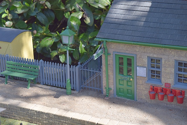

...and here it is in my gallery entry, as of a couple of weeks ago:
It has all been out in wind, rain and shine, summer and winter, 24/7/365 for 5 years. The lamp post is drunk because it got kicked by a rampaging dog. The platform is growing a nice crop of moss and everything is a bit splashed, of course, but those are the only sign of defects.
Come back in another 15 years for the answer to the third part of your question!
I detailed my build of this station and all the ancilliary items, back in April 2018. The platform face, platform lamp, bench, windows, doors, fences, gate, fire buckets, gutters, downpipes, drain grille, 'way out', etc, are all printed in PLA ( Trevor uses ABS which should be even more durable):Phil.P wrote: Tue Mar 07, 2023 12:48 pm 3D printed components, I wonder what they will be like in 5, 10, 20 years?
The modelling is brilliant, it is the resistance to the elements, that concerns me.

I have concerns about that to.... my only experience with Gorilla glue is when separating parts of a kit which someone else had built using it (foamy residue is a clue). It snapped apart with little resistance! How it works on two Gorillas bonded together is something I haven't yet tried.Phil.P wrote: Tue Mar 07, 2023 12:48 pm
Will also be interested to see how the bonding of print to aluminium, holds up..
Especially after a few heat-cold cycles?

I have had 2 pieces of PLA glued together with "plastic magic" lying out on my layout in the Australian sun for 12-18 months now with no sign of deterioration as of yet.Phil.P wrote: Tue Mar 07, 2023 12:48 pm Looking good..
I am *still* concerned about the longevity of 3D printed items, especially in the garden. - I know printing yourself, you know the type of filament you have used, but we mere-mortals, buying a kit with 3D printed components, I wonder what they will be like in 5, 10, 20 years?

Firstly let me comment on the gorilla glue.Peter Butler wrote: Tue Mar 07, 2023 2:43 pmI have concerns about that to.... my only experience with Gorilla glue is when separating parts of a kit which someone else had built using it (foamy residue is a clue). It snapped apart with little resistance! How it works on two Gorillas bonded together is something I haven't yet tried.Phil.P wrote: Tue Mar 07, 2023 12:48 pm
This glue has a long history as a boat building adhesive. The original version was a patented glue called "Balcaton" - which I used about 30 years ago to make a cold moulded dinghy. It is still in my garage. It isn't a "structural" adhesive in the way that epoxy glues are but it is still a useful adhesive. When the patent ran out (time expired) it became a generic glue that anyone could copy. So it arrived as this version of gorilla glue. It is a foaming polyurethane glue, moisture cured, and totally waterproof. So I have no qualms about using it - but sensibly. For example I bond the track to the concrete trackbed with it and use bricks to weight it down while it foams. I can prise it up it the alignment is wrong but otherwise it stays put - even if the ballasting is delayed for 6 months. I don't think it is suitable for assembling a plastic kit, not because it lack strength - but because as it foams it is going to go everywhere and be difficult to get off.
Now let me comment on the use on the bridge. In many ways this is just temporary, as the build progresses you will see that the top flange of the alloy angle is going to get encased in the ABS components. IF it does let go, the components are not going to be able to go anywhere. The ABS components will be welded together and may be able to slide along the length of the bridge as a unit, but they won't be able to move apart. At the risk of repetition - the ability to weld ABS with acetone is the main reason I use ABS. For me, that ability counteracts all of the difficulties in printing in ABS.
I have no doubt that the structures I am making will stand up well in the outdoors. You have seen how many complex and large structures I have made - I am very confident that I haven't wasted my time or my money!

That station looks brilliant and (having followed your posts) is one of the things which has inspired me. I am not there with the detail yet - but I have added guttering to my latest models!philipy wrote: Tue Mar 07, 2023 1:18 pm Phil.
Come back in another 15 years for the answer to the third part of your question!![]()
