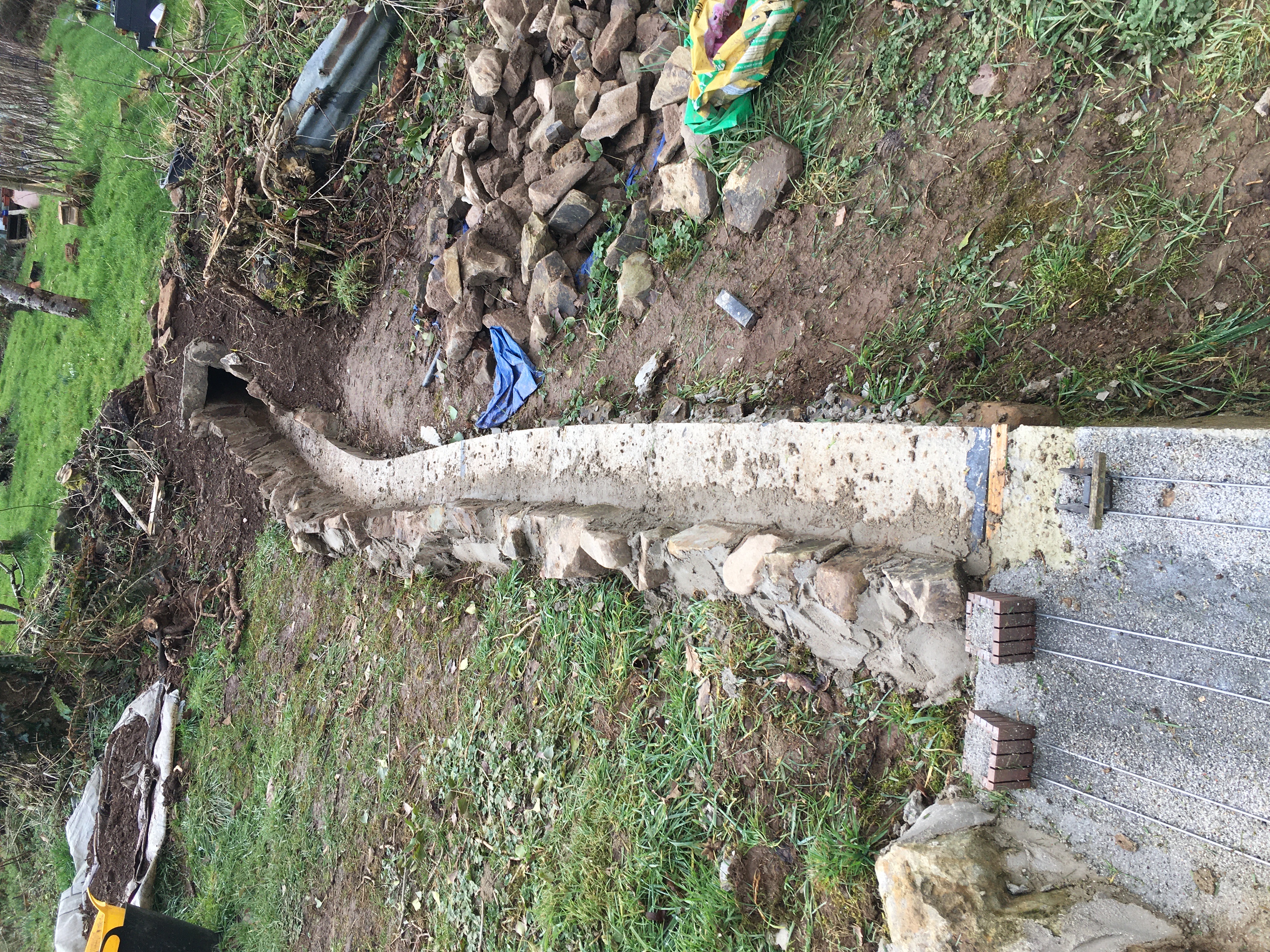

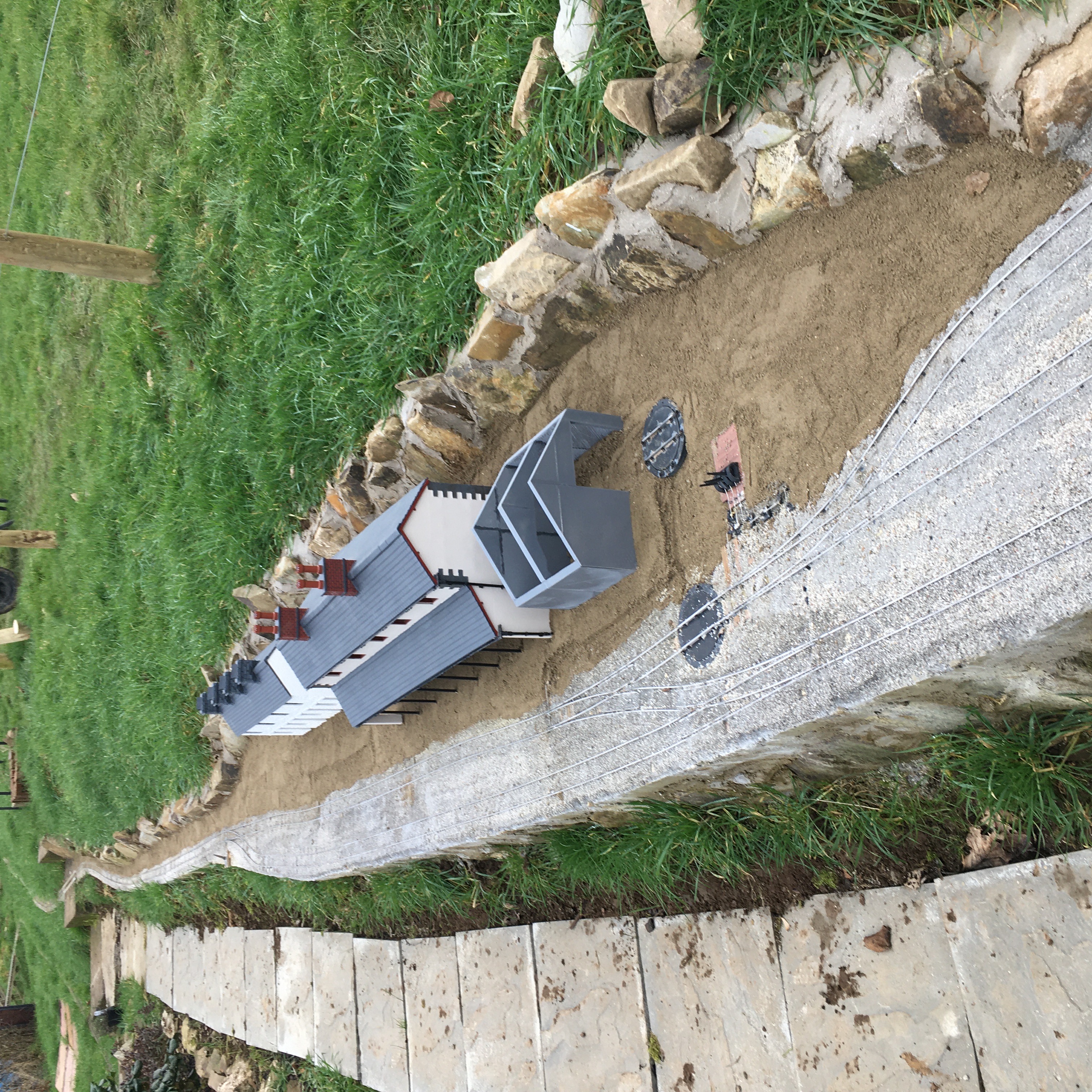

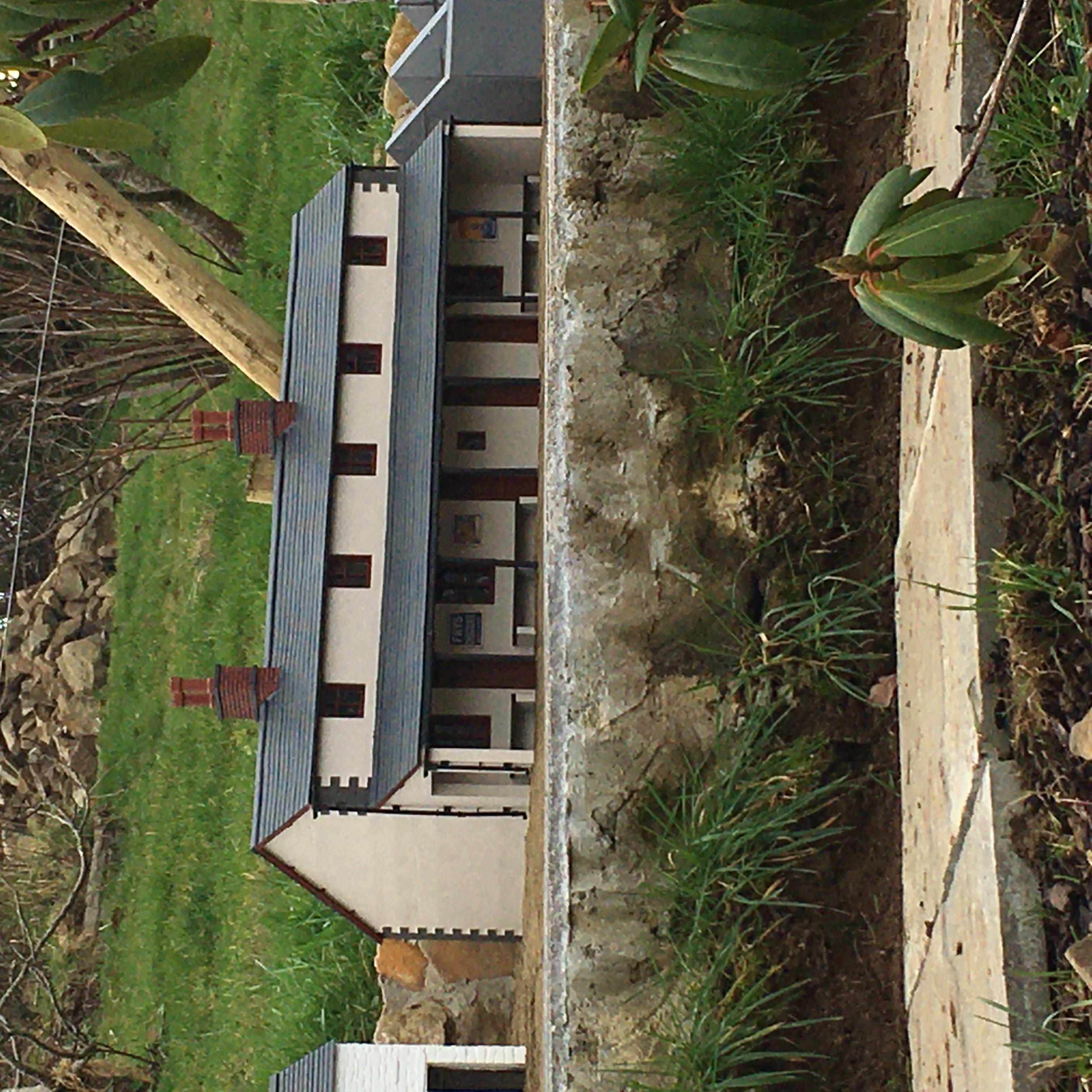

The station building is now finished and installed on the railway:

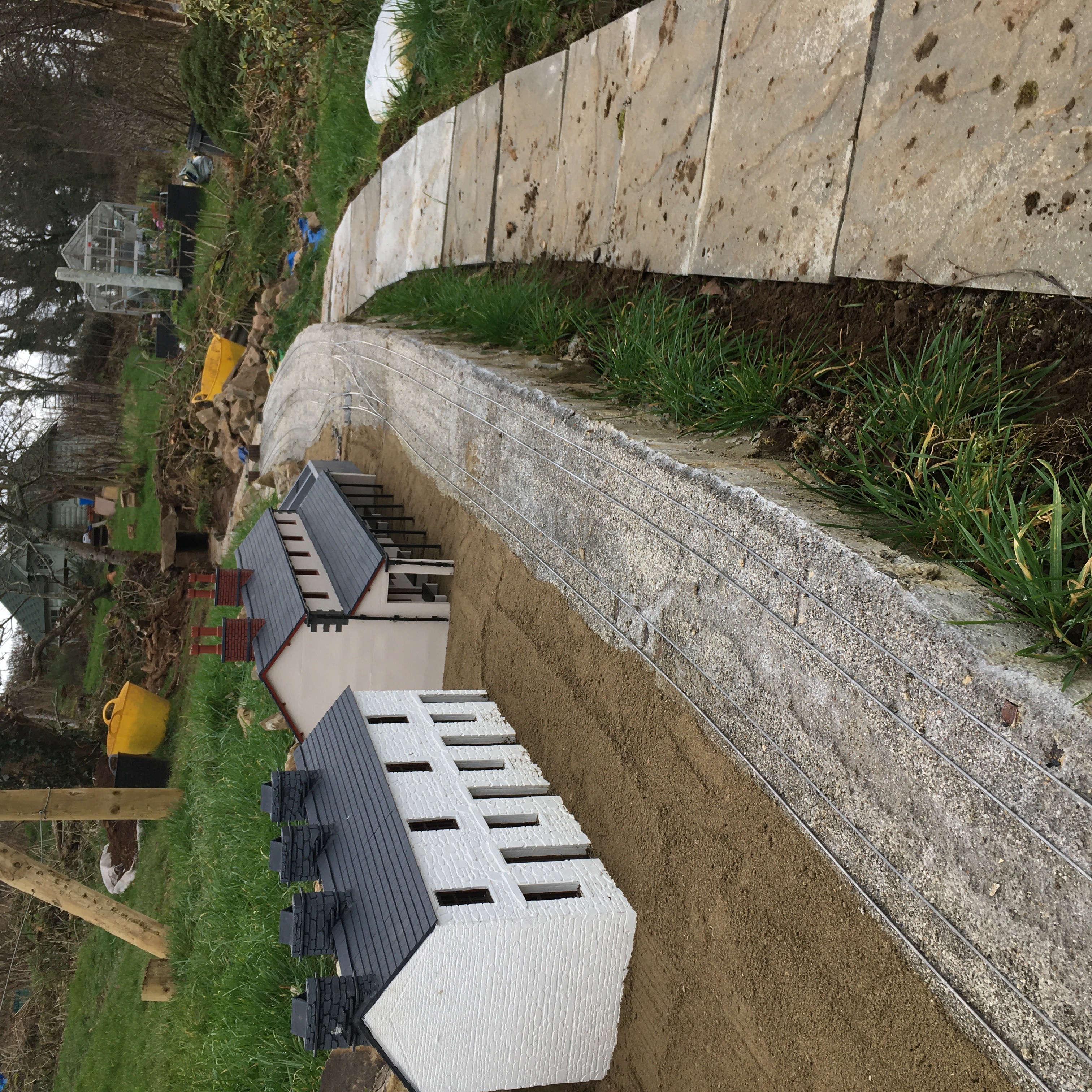

The goods shed is temporarily in place to mark its footprint in the station area. All three buildings are set in dry mortar and levelled. I am looking for a damp night tonight. and from the other end:
I made the tunnel yesterday, and you can see the its mouth in the distance. The tunnel is made from old bricks, with paving slabs for a roof. I am going to hide the bricks by cladding the entrances with stonework , and extending that to edge the cutting each side of the trackbed.

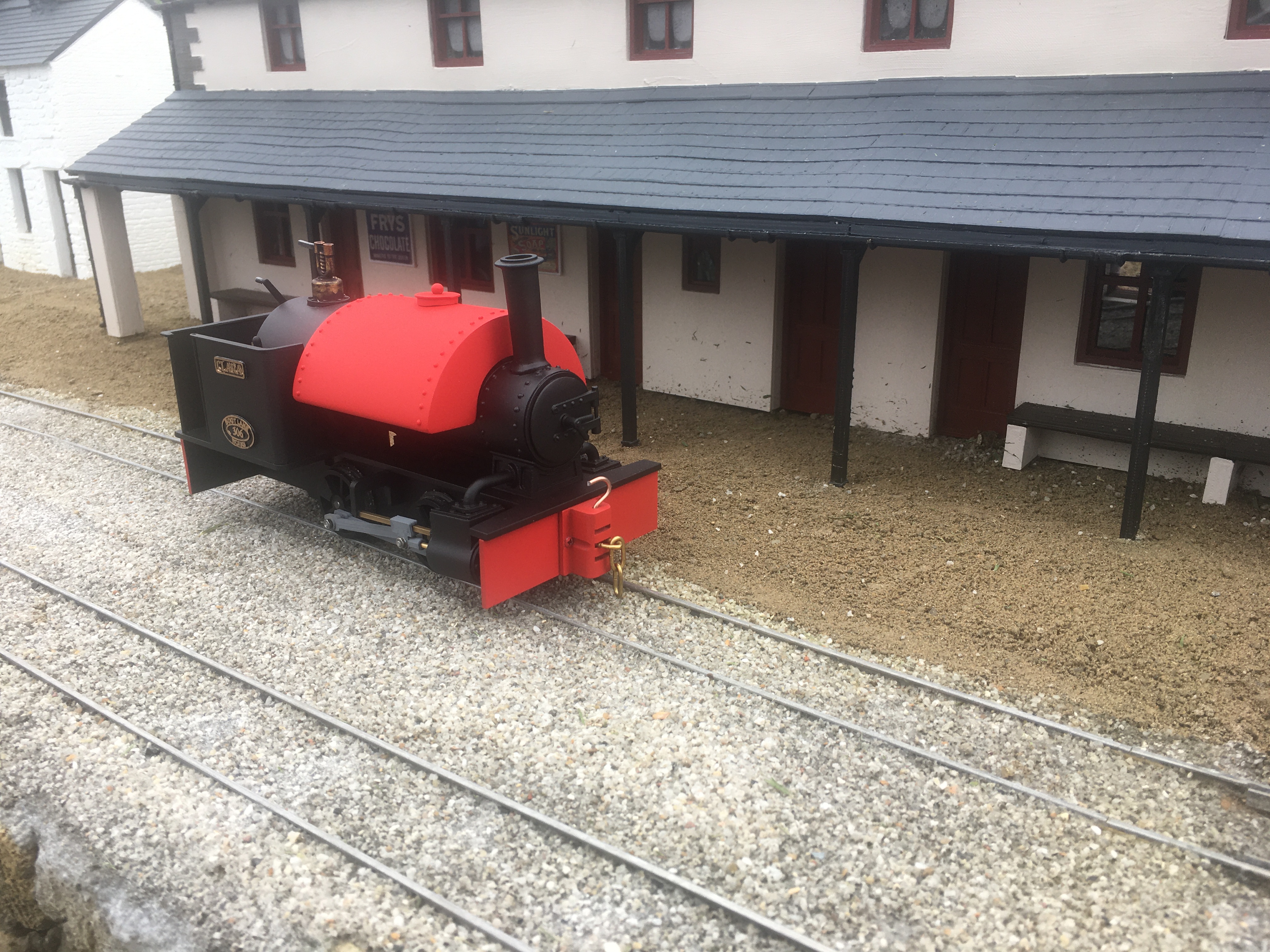

Finally a low level photo which shows some of the detail:
The adverts were printed onto self adhesive photographic paper, mounted on a printed backing, and varnished. Just need some customers to occupy the seats under the veranda.

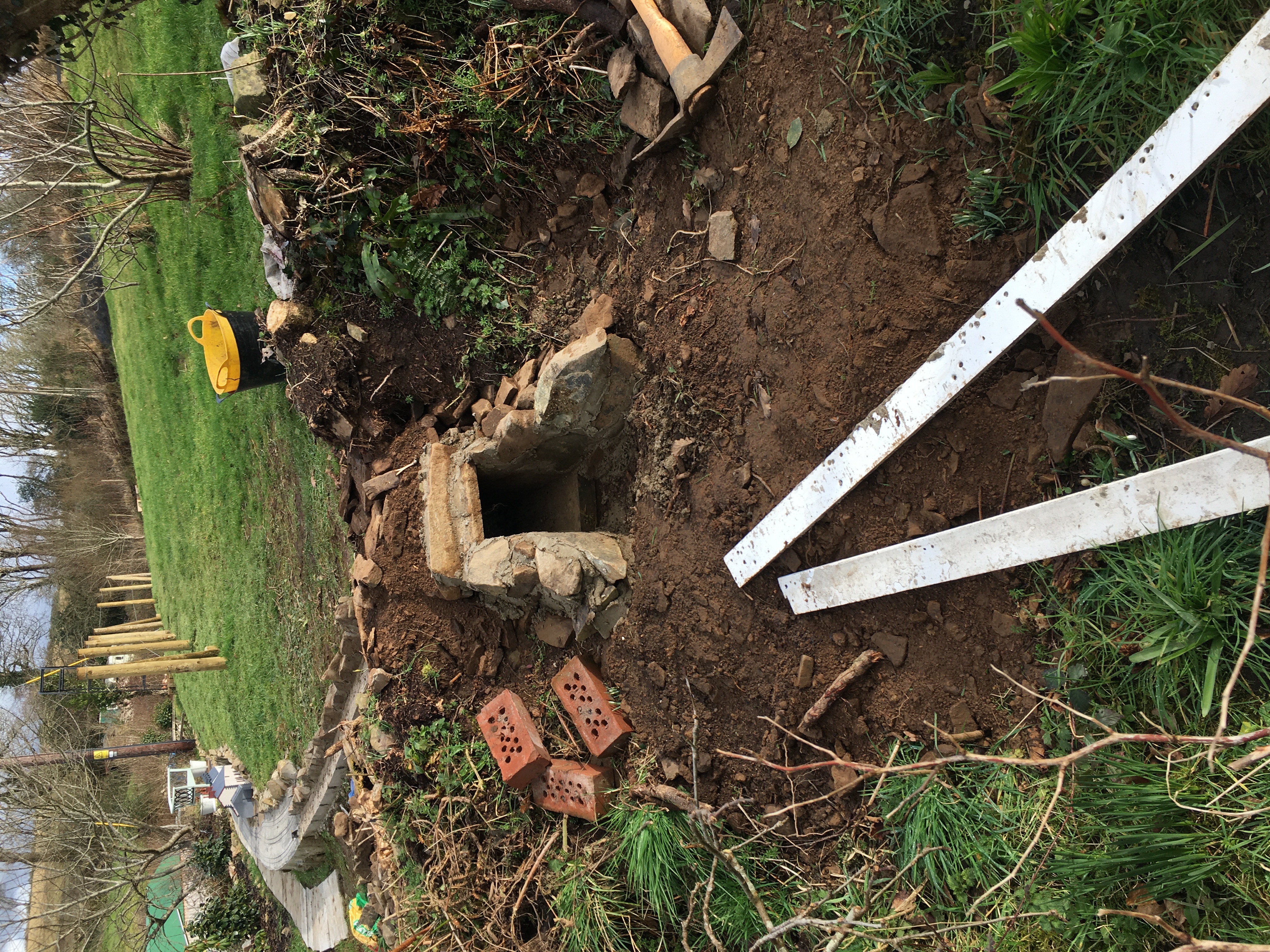

The weather has broken for a few days - we are getting drizzle here at the moment, so progress is temporarily slowed down!

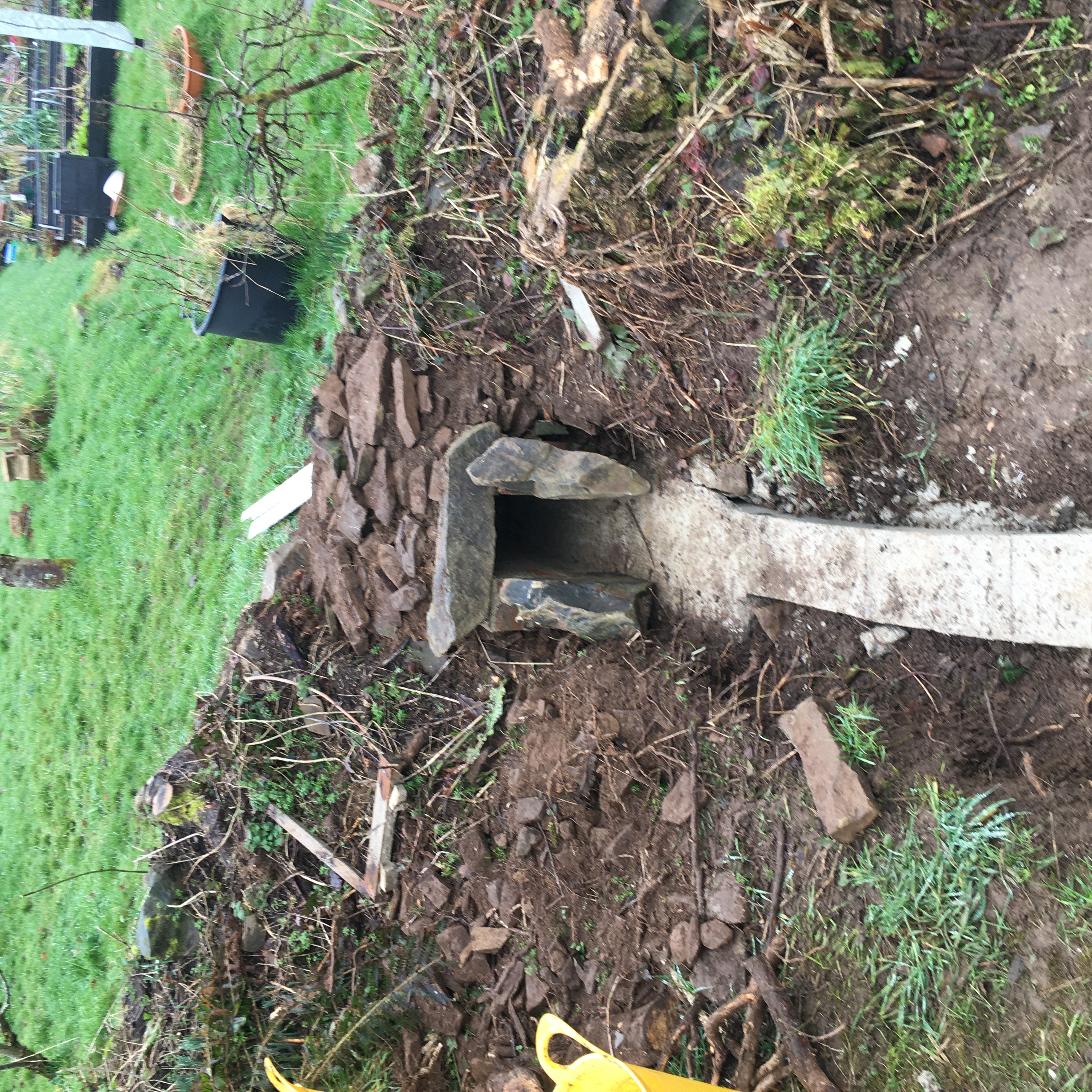

I managed to start to recover the tunnel before it got wet, and to select some rocks from the pile to start the cuttings leading to the down hill end of the tunnel:

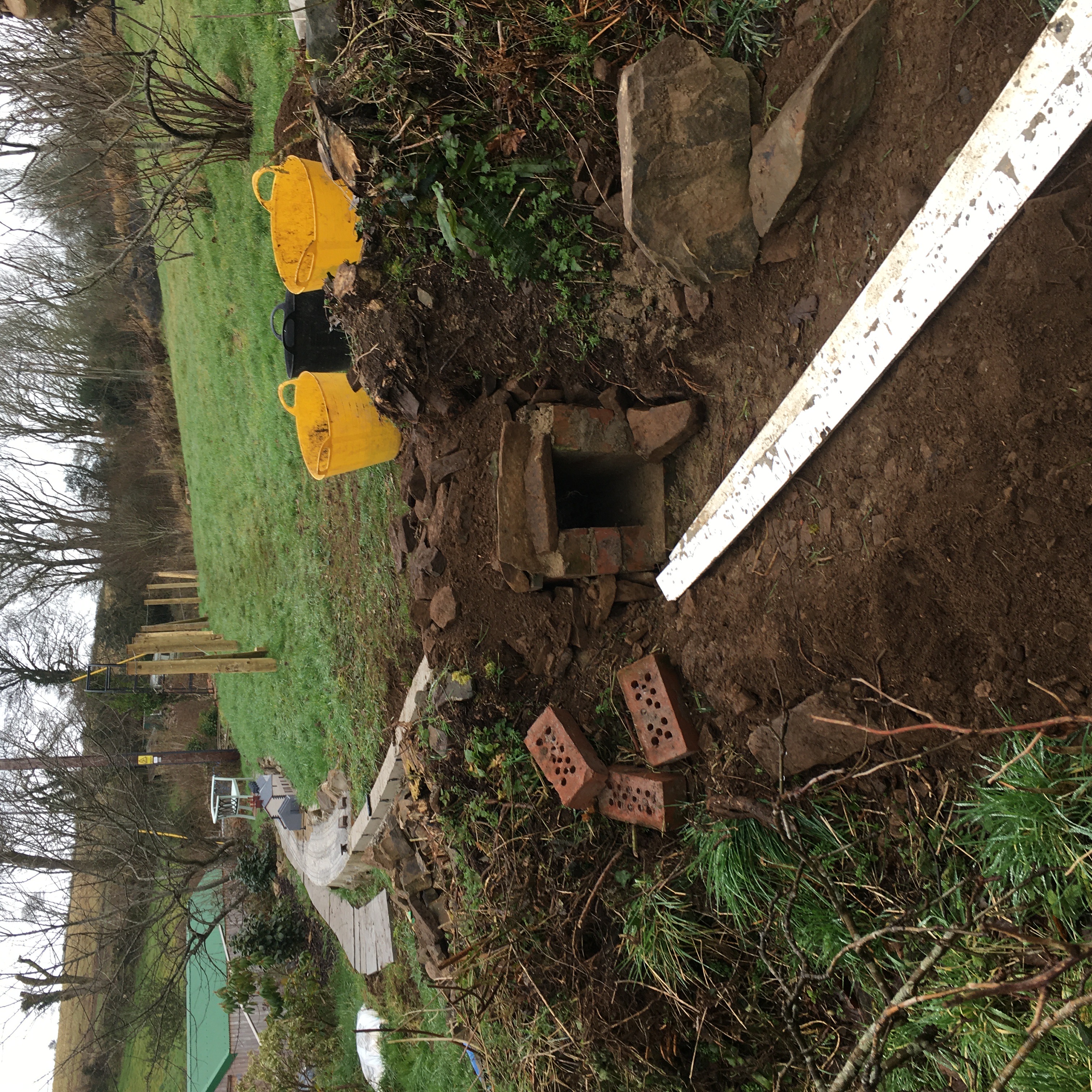

The other end of the tunnel is quite bare at the moment:
All that soil I pulled onto an "embankment" needs sorting out - some will go over the tunnel, and some will remain as a reduced embankment ready to take the plastic shuttering for the next length of trackbed leading along the bank. I had envisioned the embankment having a stone facing and the brickwork of the tunnel being hidden under stonework as well.
