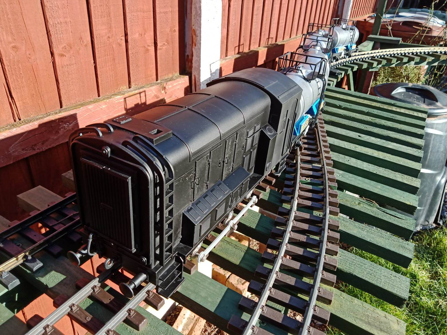

Phil.P wrote: Wed Feb 08, 2023 10:24 am “…how have you altered the proportions?”
As delivered, Diesel measured (in mm) 168H x 115W x 324L but its wheels appeared to be undersized and the running plate too low, which also appeared to exaggerate the length of the overhangs at each end. I thought it looked a bit weird.
To sit comfortably with my existing rolling stock (and track) I needed to cut 20mm off the height and 12mm from the width (from the centre of the body and 6mm plus from each side of the supporting chassis moulding). To adjust the proportions to more like a Class 08, I then needed to lose a fair bit of the length too; say 20mm plus, off both the front and rear overhangs. Helpfully, the original cab appeared too long anyway, so building a new, shorter cab wasn’t a problem.
I was limited in where I could remove ‘featureless space’ from the body sides, so the front overhang wasn’t touched (and the wheels are still too small, of course) which makes the revised version look, perhaps, a little long in proportion, with roof sides that aren’t as steeply pitched as you’d expect from an 08 (see above).
I’m sorry, this answer is probably unnecessarily long, detailed and tedious (but I’m not writing it again).

Post by Phil.P » Wed Feb 08, 2023 2:06 pm
Not tedious, at all.. After all, I did ask!
The shiny-black model looks 'wrong' to me, but I don't know why..
A waft of matt-black, and rail-dirt, from a couple of feet away, would probably help?
I mainly asked, as I don't see the joins! - Which is the point, I assume? :lol:
If I can get over my 'fear of failure' I would love to have a go..

I feel suitably chastened. So, just to illustrate just how off-the-scale nerdy I can be, here’s the amended, annotated plan / cheat sheet / mood board / user guide, I assembled as the rebuild began.
Not followed exactly, of course, for all the usual reasons (too hard and/or mistakes). I’m not pretending to be making any sort of accurate model here, just something that looks the part and fits in with the rest of the stuff.
The drawings are hardly altered, it was about establishing the differences between the original and Diesel at the size I wanted it to be
Phil.P wrote: Wed Feb 08, 2023 2:06 pm "...matt-black, and rail-dirt, from a couple of feet away, would probably help?"
Well, I agree. If you’re not constrained by the dimensions of existing rolling stock, tight clearances on garden railway bridges or whatever, you can as you say, embellish and repaint or weather Diesel as it is. It doesn’t have to be chopped up and resized.
