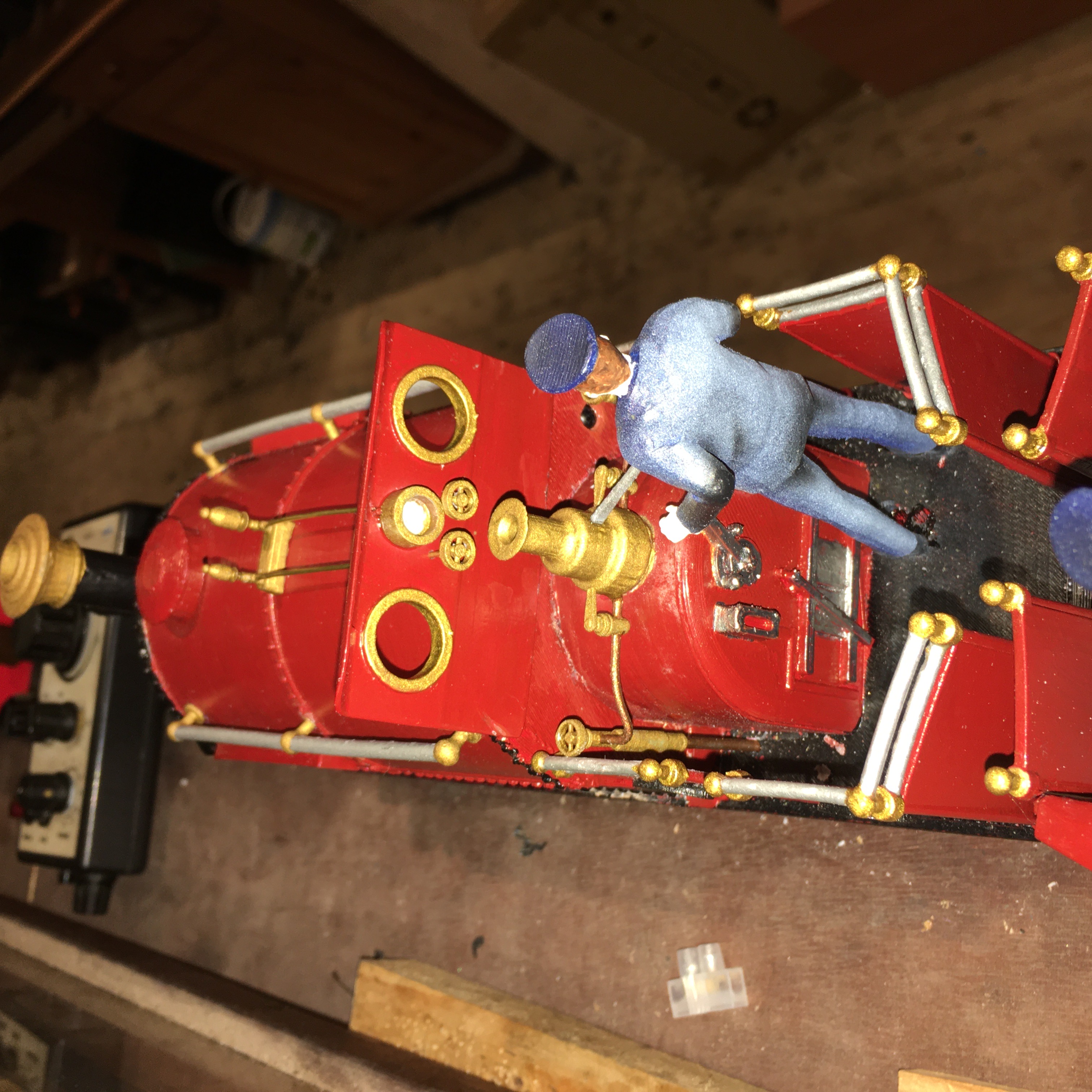

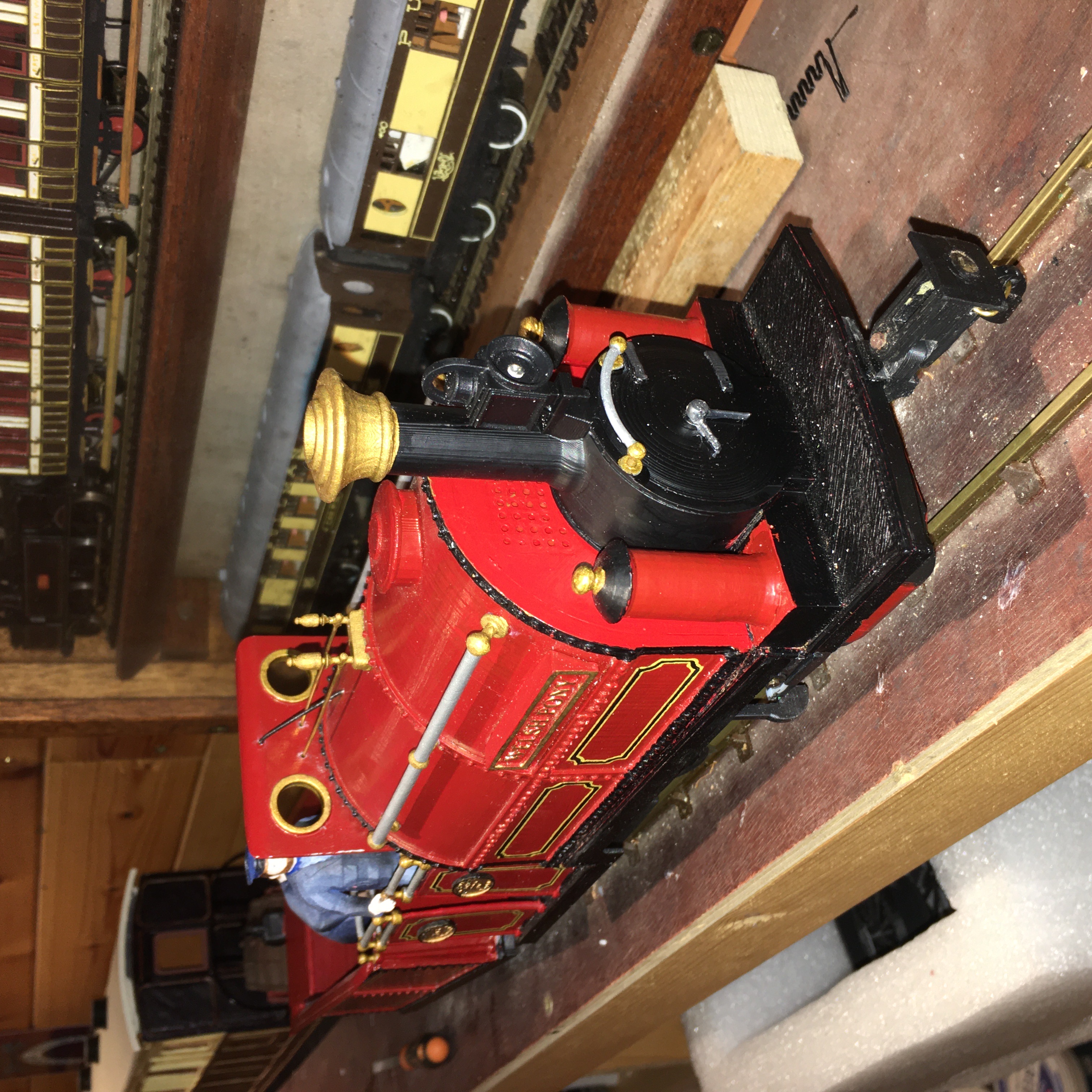

While I have it in bits I have made some "improvements".
Firstly replacing the crossheads and their guides. I am now using an "engineering grade" or "ABS like" resin in the resin printer. The results seem significantly better. The components are more rigid, seem stronger, and cope with drilling tapping and filing. One wheel wasn't running true - so I sorted that. I also remade the coupling rods on the filament printer - the originals had worn journals. I have added brass bushes to the new ones:
Having created a passable model of the Ffestiniog loco lamp, and having the RC receiver that can control them it was an obvious addition:
Of course that chimney top isn't quite circular. So resin printed chimney top, safety valve cover, injectors, and tank handrails were obvious improvements. Since the sound card has the twin whistles for Welsh Pony - I had to make and fit whistles!

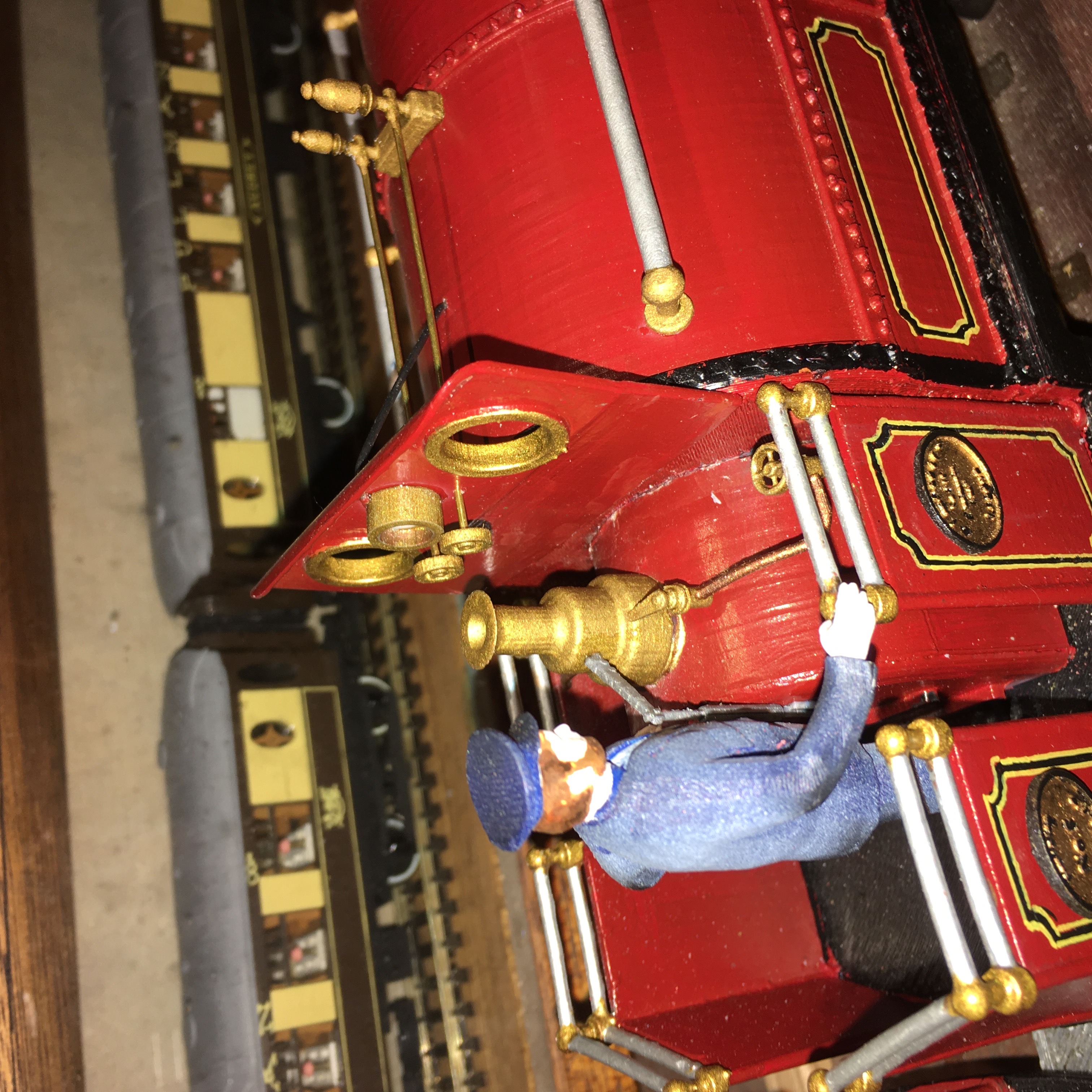

So with all the "improvements" in place:
I suppose I need to video it running so that you can judge whether the sound card is an improvement!
