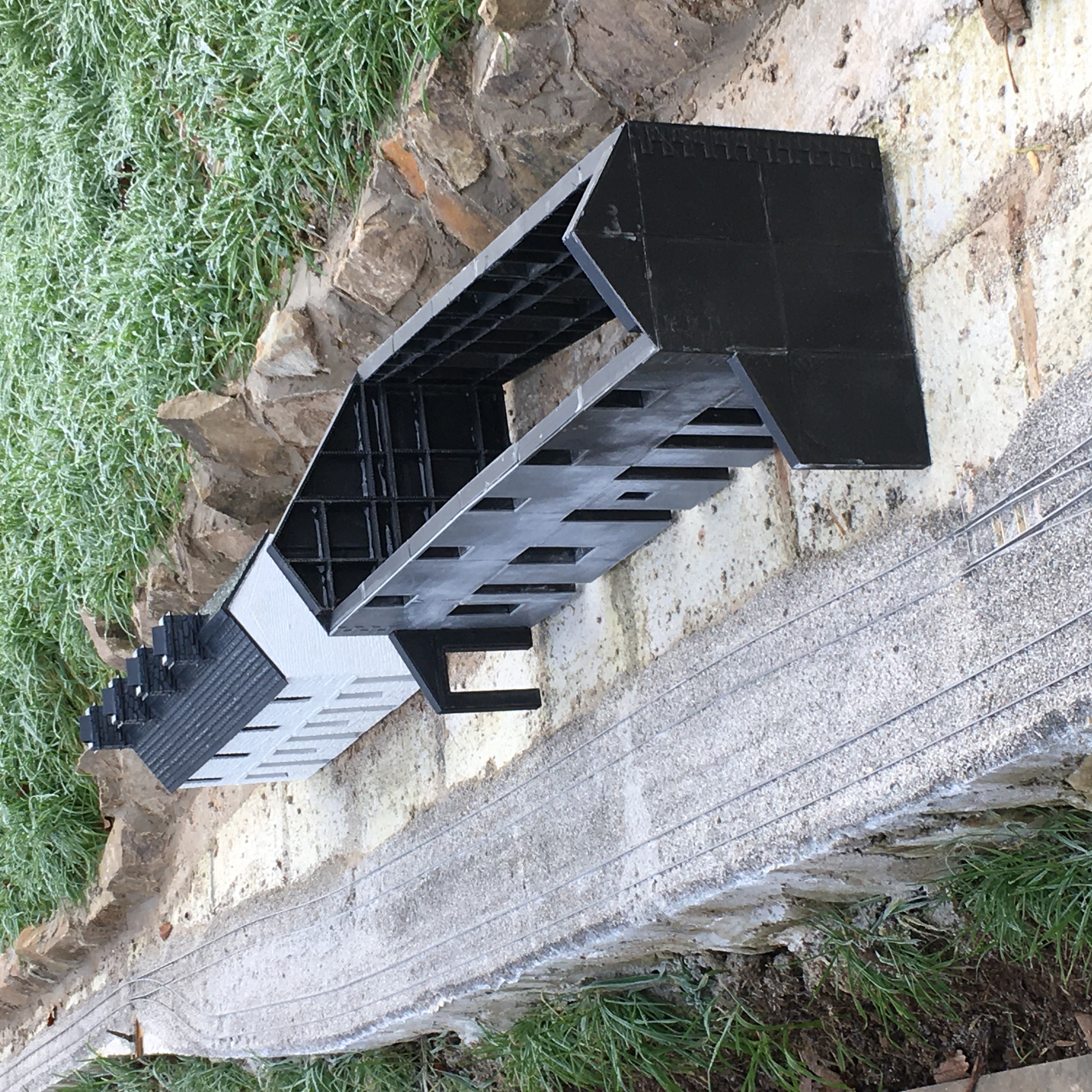

The station building progresses:
That is the front and first end printed and assembled. I'm currently printing the second end. The face consists of 6 pieces, each taking about 5 hours to print, and the frame behind it is 4 pieces, each taking about 7 hours to print.

There are four sides printed now and this is what it looks like roughly where it will go:

The veranda is now printed and assembled:
Now on to the roof.

The front part of the roof is now printed and fitted into place:
That was 72 hours of printer time.
Now on to the rear of the roof - which looks like it will take twice as long to print.

Post by Trevor Thompson » Wed Jan 18, 2023 8:16 pm
All the roof sections are printed and assembled:
The chimneys are currently printing.
I should be painting it tomorrow!

Post by Trevor Thompson » Fri Jan 20, 2023 8:56 pm
The chimneys and ridge tiles are now fitted:
And I have started the painting.
As an aside I should say something about the printing of the chimneys. As you will know by now I work exclusively in ABS - and I am getting perfect distortion free prints - every time. I now understand the cause of the distortion I was suffering - it was caused by the print cooling too quickly. I now have a thick layer of wool insulation enclosing the printer cabinet - and the distortion has gone away - even in UK winter conditions. The chimneys were an 18 hour overnight print run when the outside temperature was -3C, in a workshop which was unheated apart from the woodburner which ran out of wood at 1800!

Post by Trevor Thompson » Sat Jan 21, 2023 1:55 pm
I can understand you avoiding ABS. I have wondered again and again if I was being stupid persevering with it. There have been a number of times when I thought I had the distortion issues sorted only to find that I hadn't really.
This time I am convinced I have actually got it fixed. For example the chimneys are perfect, and the ridge tiles which were printed on edge have really smooth surfaces.
A photo of the insulation around the printer to show you just what I have done.
1inch of wool allround and 2 inches on the top. And one part raised so you can see what is underneath:
